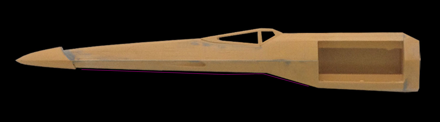

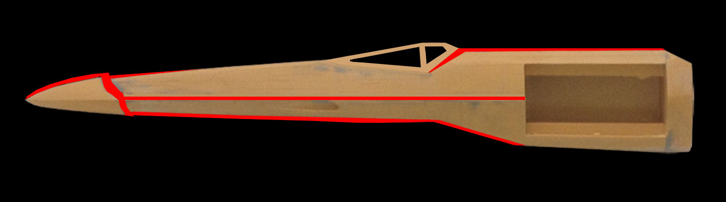

I have a Captain Cardboard and compared to a hero or pyro I find the fuselage height isn't quite tall enough, so I'm padding out both halves of the fuselage with styrene sheet. The fuselage also dips down where it meets the nose on top which need correcting, and the nose is small compared to Red 2, which I'm hoping to get a bit closer to.
My raw Captain Cardboard
Areas I'm bulking up to get closer to the Hero Red 2

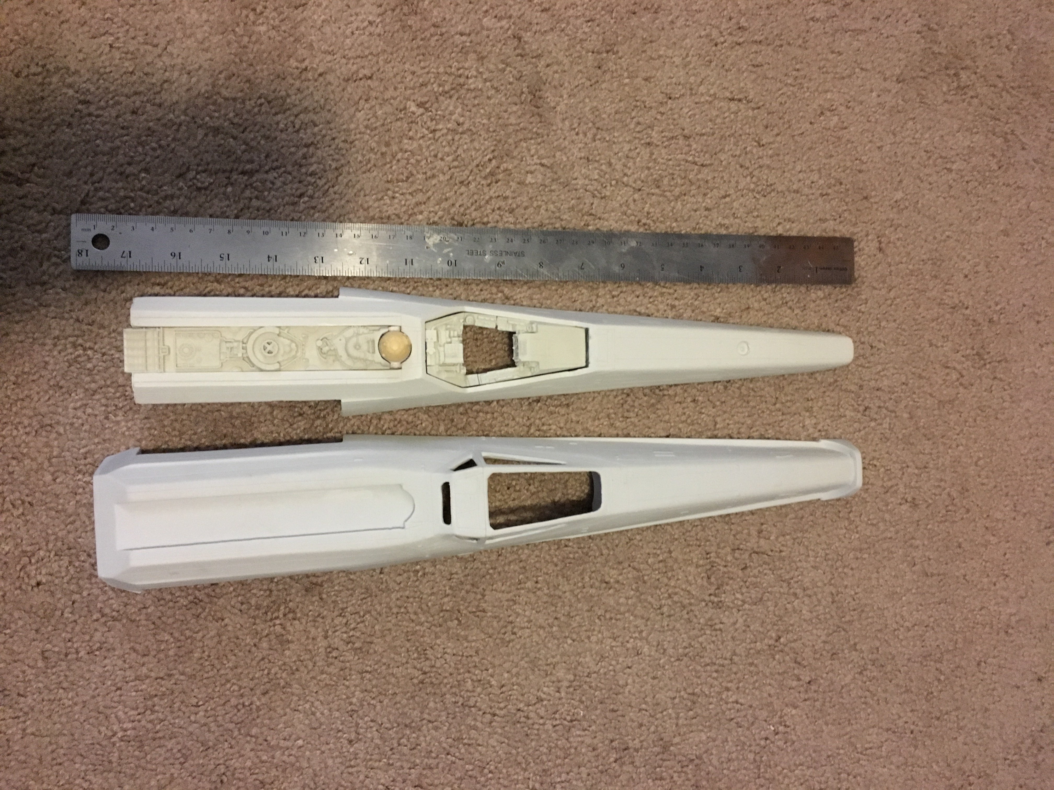

I'd consider the CC to be the least accurate of the studio scale x-wings. It IS a nice model, but if you want the most accurate x-wing out there, you'll want a Salzo V4.
In these pics you can see the size difference between the CC fuselage and the Salzo V4. The difference is actually quite dramatic.
My honest opinion is that the Salzo is the more accurate kit by FAR, but the CC is an easier model to build.

Makes me think I should "re-skin" the whole fuselage in styrene, maybe with a new cockpit included, not separate.
That would also help with the other thing I was worried about: how to re-sculpt the proton tubes Red 2 size. It;s easier to start from a shape cut from styrene, than Dremeling the shape into the raw resin.

If you change the fuselage that much, the stock s-foils from CC aren't going to look right. Those proportions are going to have to change too.
Just food for thought...
Personally, I'd build it as-is.
Was mentioned before - this is more of a legacy kit now. A marker point in the history of the hobby and the subject, and an indication of how far we've come. For what it's worth, it is - at least a bit, and dare I say - historical...
