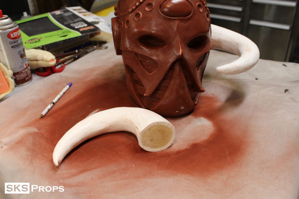

Frazetta Death Dealer Helmet - I received a question the other day concerning the horns and how they were cast. To keep the weight down I rotocast them in the mold with some 65D and back filled them with smooth-on expanding foam. This made the final casts very light but extremely rigid.

TFS with us your tuto concerning the horn (good to know).:) You're right to keep the helmet that way, makes it more real (the forged by hand look).
