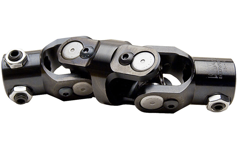

...Just came across this thread.
I think you're overthinking the Spine. Occams Razor.
Just use U-Joints. 1 connected to the next, until you make up the space from the Tailbone, up to the Skull.
It will bend in any direction your Spine can.
