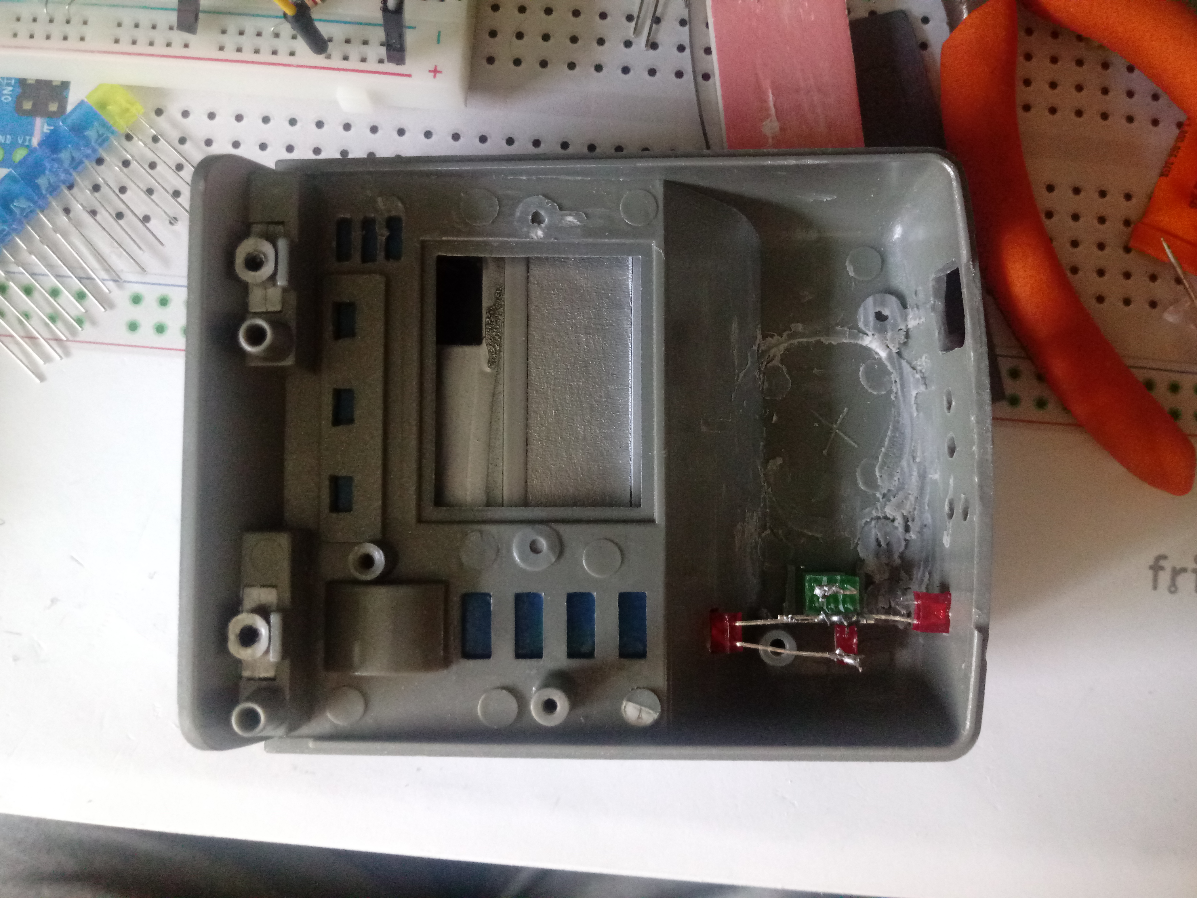

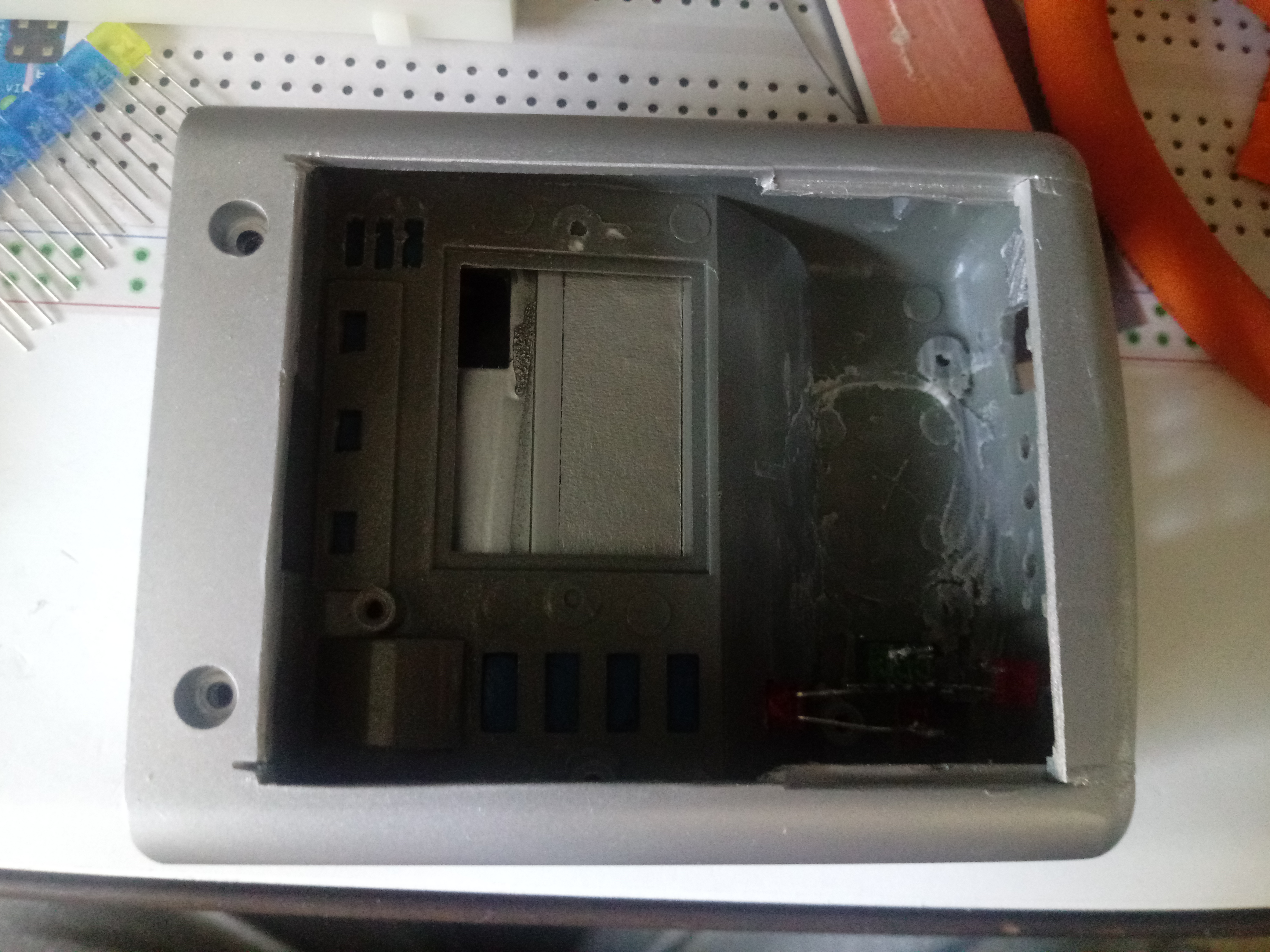

Well, updating this to let y’all know, I’m planning on making a Mark VI version of the playmates tricorder. Wish me luck, I’m gonna have to scratch build the hand scanner lol
Re: Another GMProps playmates Mark VII Tricorder
So here is the start of my work. I’m gonna be using Arduino for this one...IF I can learn how to program this the way I want [emoji23]. I think I have it covered, I’m receiving some ATMEGA 328’s sometime soon to work with as slaves.

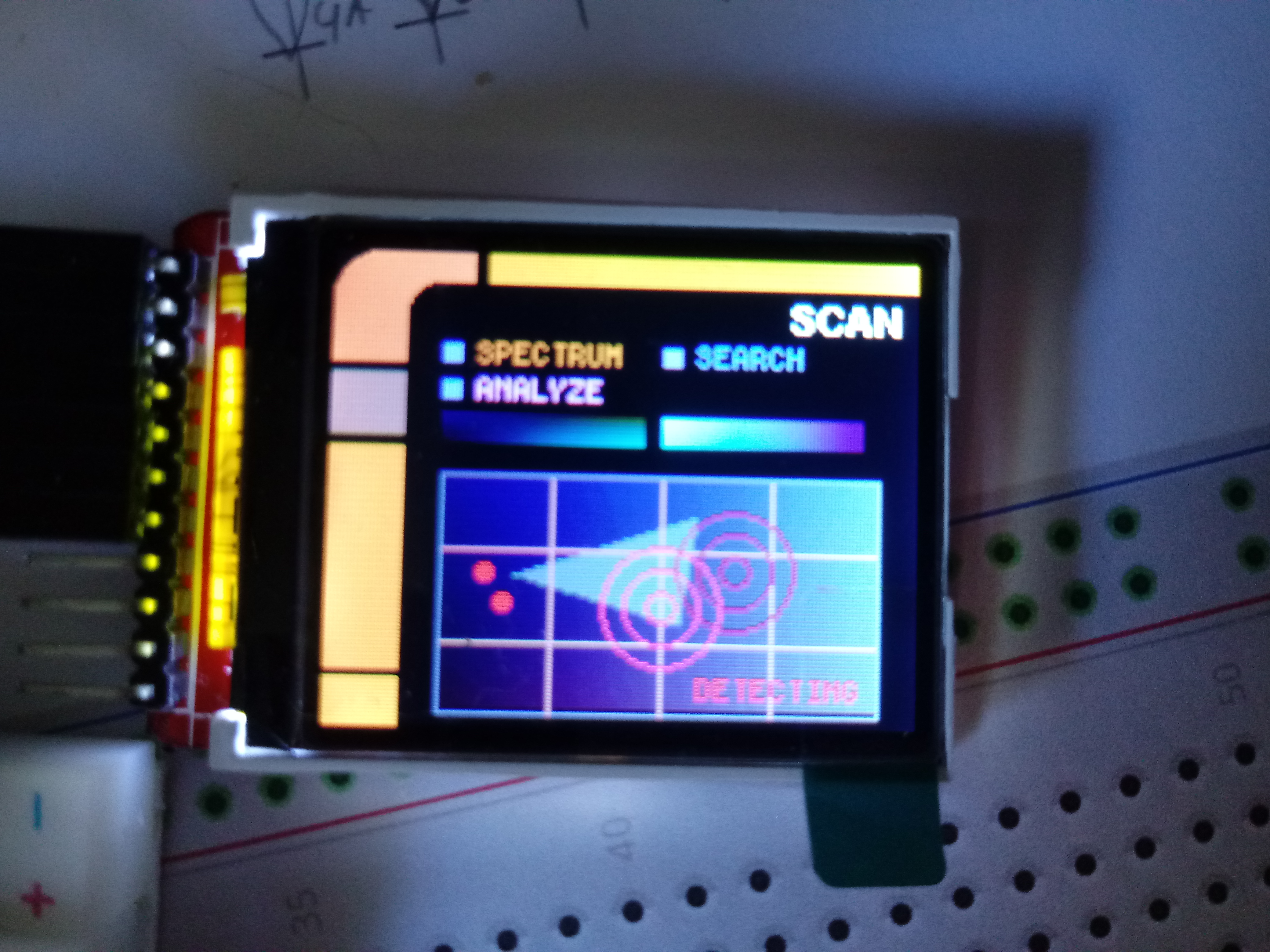

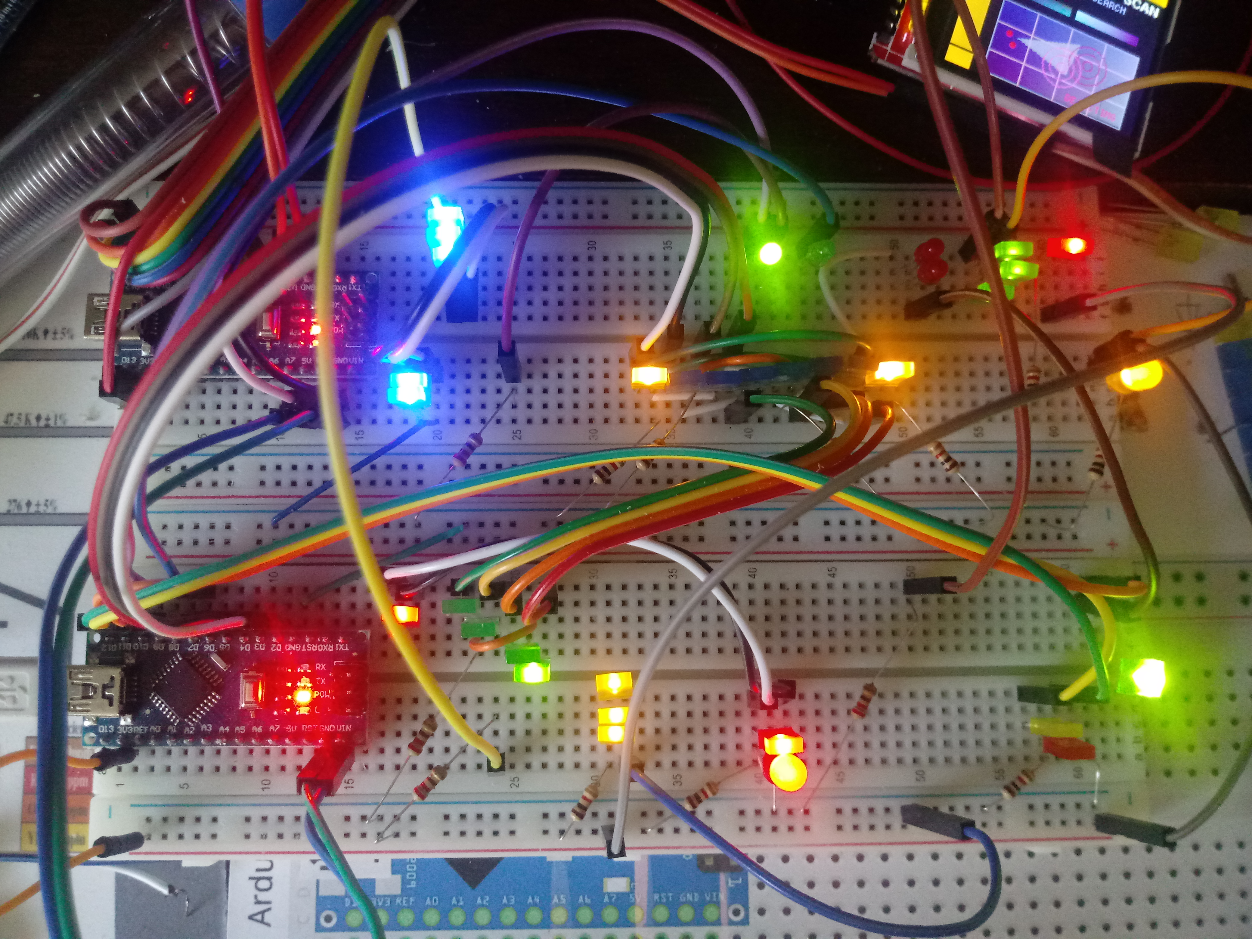

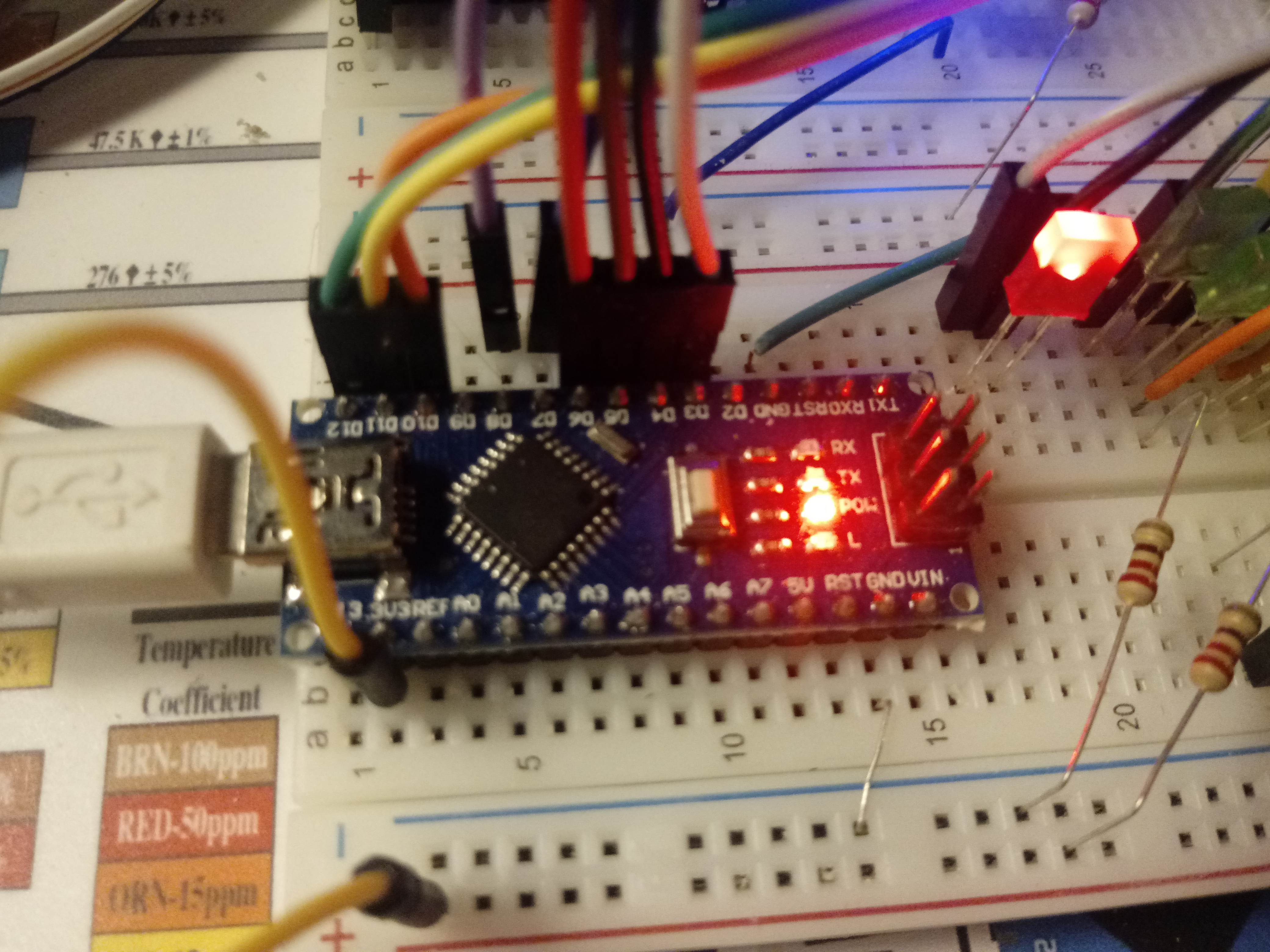

I am using an Arduino Nano with all the lights and blinkis for my Playmates TR560 upgrade. This is just a little homemade project because I can't really afford any of the professional kits. With Arduino, I can do a multitude of blinkies and whatnots and I even have my little LCD screen that I am generating graphics on but that is currently on its own Nano controller.
It took a while to figure out the code for the Arduino Sketch but with a lot of trial and error (and very little and unfriendly help from the Ardiuno community) I figured out how to do it. And all running of of one Nano controller.

Depending on what you want it to do, you should be able to run it on the Uno by itself. I wished I had some atmega controllers but I am making due with the Nano. It's hard to see but I still have 5 ports available on my Nano to add soundcard controller that hasn't come in yet.
The Uno is a bit too big for this project (can’t afford the nano yet). So I’m looking to solder a micro controller to a PCB board and go from there.
I got the Nano knock off I guess. It uses the same processor and it only cost me $1.35, free shipping. (AliExpress and eBay). Works perfect for what I wanted to do. But the code/sketch will work on the Uno as well.

So, my question is, what functions do you use to make all of the blinkies go simultaneously instead of going one after another? I’m curious!

I just use Millis Intervals. No Delay functions as it prohibits the LEDs to run simultaneously. Here is a short video of it here.

Yes, the viewscreen/LCD is already animated but I need to add some more graphics. Originally I wanted to have the 'Device Input' buttons functional and change to different animations, but as I mentioned, so far, no one on the Arduino forum has been kind enough to help me figure that out. So for now, it will just display animations by itself.
