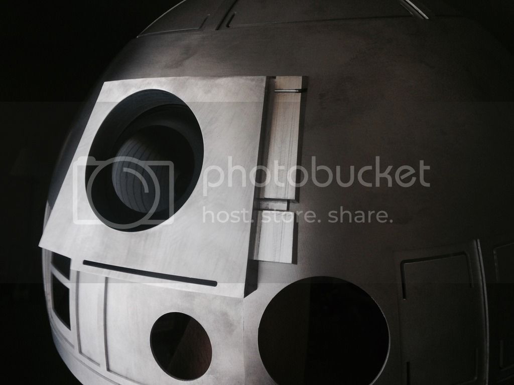

I decided a few months ago to take on this project, an ANH R2. This is something I thought would be fun and could involve my two young sons. This will be built to the newest club spec (and the most accurate). The idea is to use aluminum where I can, with some wood and resin to save on costs and weight. I'll be doing lights, sounds, and basic movement. No fancy opening panels or gadgets. I'd like kids to be able to hug this guy without too much trouble.
Hopefully I end up with something like this:
This will be a slow build but I'll try to update for the exciting stuff. It's actually all pretty exciting!

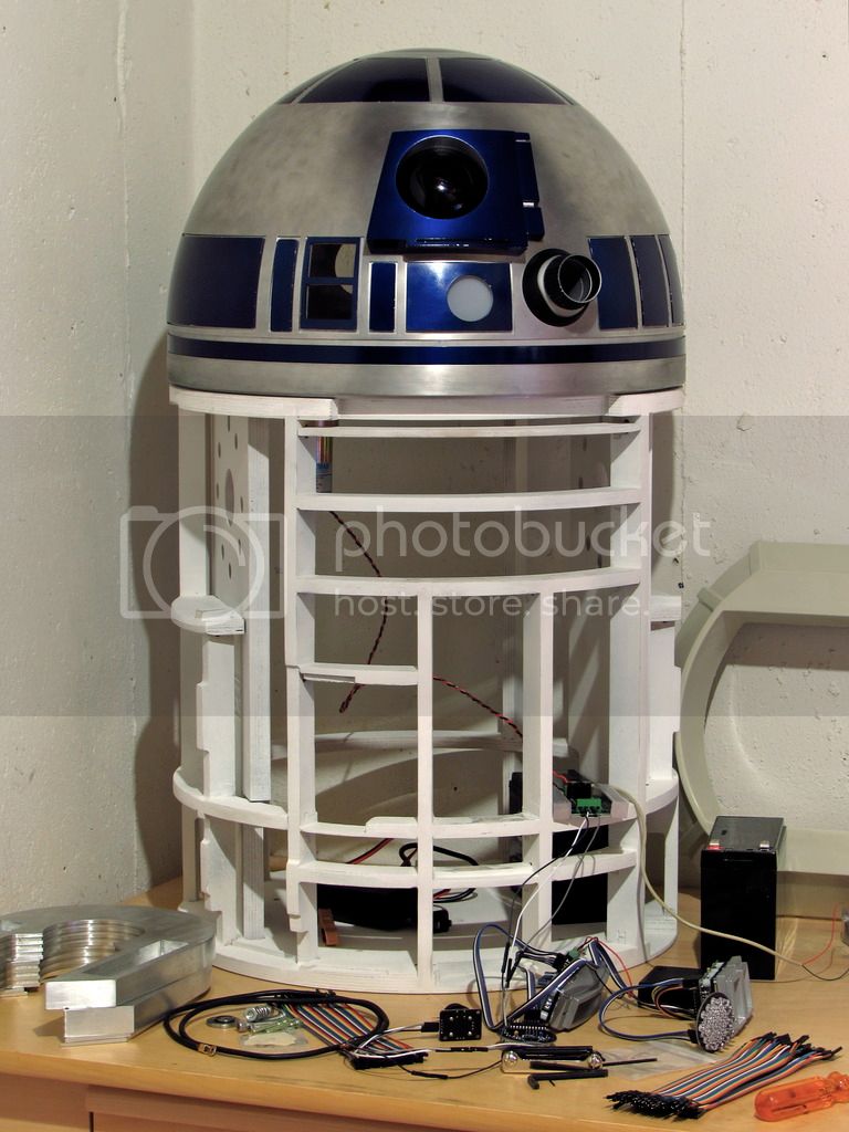

What electronics system did you go with especially for the dome rotation?
I'm going to try to keep things simple with the electronics. The dome system is just a Pittman motor, WorrParts drive wheel/bracket, and a Syren 25 board running at 12v. It's wired up to a little arduino joystick for the time being. Ultimately I want to use an Xbox 360 controller for everything.

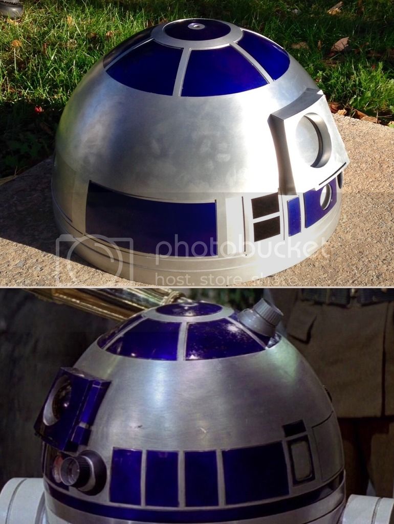

Not sure which one mine most looks like. but i'm happy to say it's all metal ( don't go this route unless you want to be broke, but i found the material easiest to work with).
and it still works after a few years, which is rather amazing. mine is just basic though. he doesn't even have a light up HP.
This is his second head. as the first one used JB weld that leaked all over the place. the second one uses E6,000 and it's MUCH nicer to work with and just as strong.
It's also his second batch of frames. we took these frames to a car place to be painted. I forget what they did to it, but it came out GREAT compared to what I could do to the thing.
I went though one head rotator after the wires got ripped out somehow, as well.
