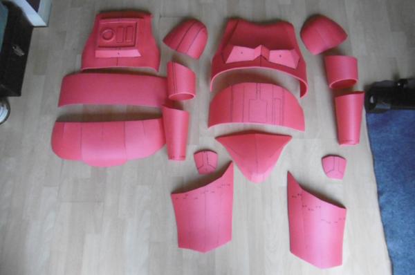

Update? Oh, go on then...
Thigh armour glued together (had to add in extra foam so I could fit my thighs in as the template was a bit snug) Made a start on the shin armour ( bottom left of pic)

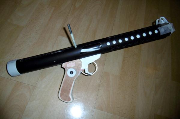

Concentrating on the E11 blaster pipe build today;
created the muzzle, bolt, end cap, wooden handle and started on the magazine housing (made from 1mm styrene)

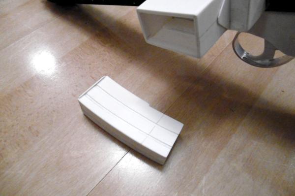

Thanks for watching - it's sloooow progress, but progress none the less.... More done on the E-11 (with rebuilt magazine housing plus more;
Grip has now been epoxy glued on, with some pins drilled into the barrel and grip to help and keep it all nice and sturdy. The long bolt will be cut down and become the charging bolt 'cocking' handle (that's not me being rude, that's what it's called...)
Close up of the grip and attached magazine housing. Grip has a working trigger using a simple technique of pin through the trigger to hinge and a spring from a pen to make it, err, spring back into position... Also have created the selector switch with 'safety', single shot and full auto
Trigger release lock close-up
Return spring is a length of solder that I twisted round a thinner tube to fit the barrel - it's a bit too thick though so may look for an alternative
Close-up of front sight and barrel - need to add some hex nuts to the front
Trigger guard made from 10mm wide, 2mm thick aluminium strip and bent to shape
Scratchbuilt 'cut down' magazine
