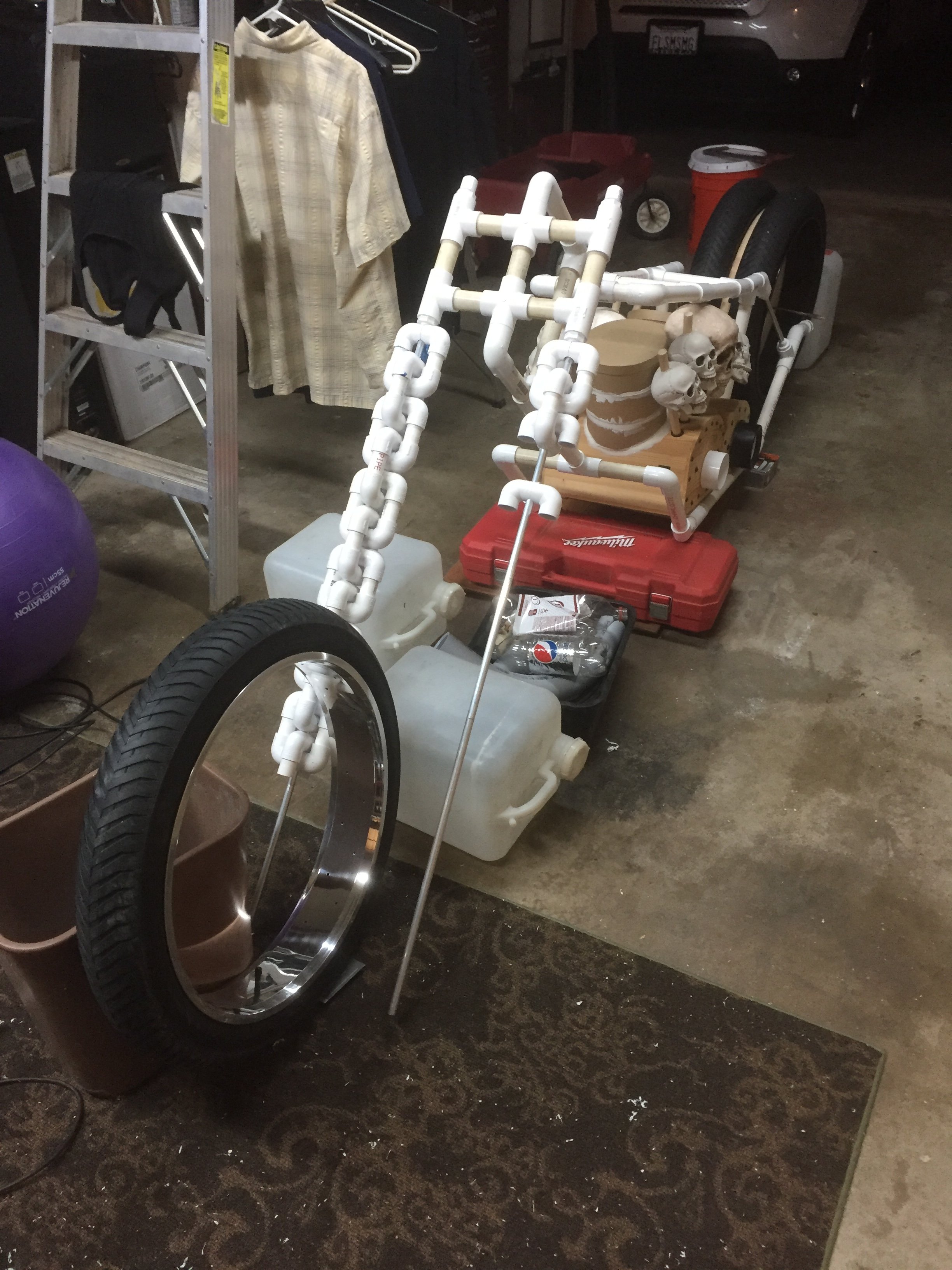

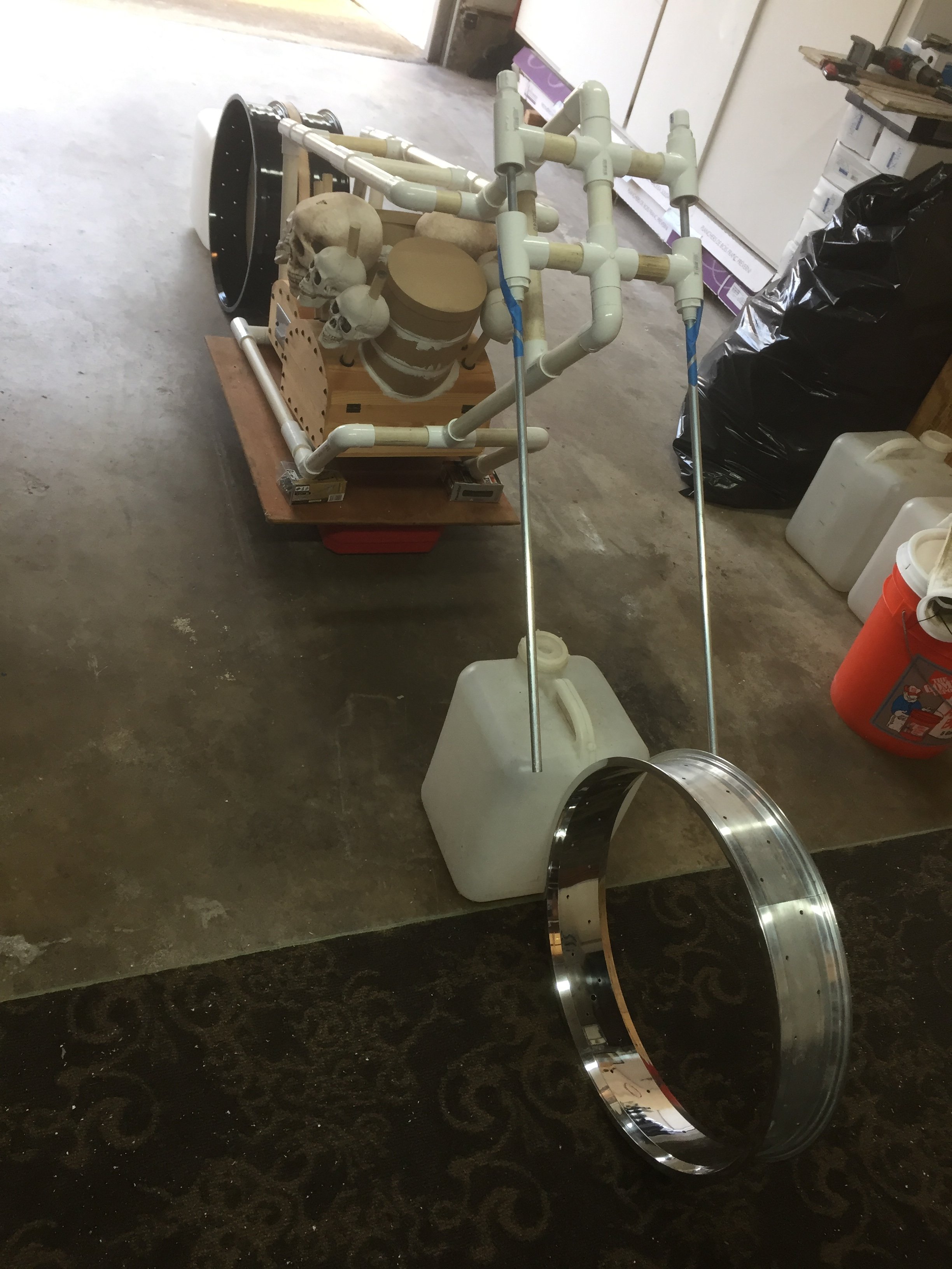

Here's some progress pics
This is after 35 hours ... I figure it will take until the first of the year to complete and most likely 300 hours .. just want to make it as close as posdible

I've been working on the Hellbike for 35 plus hours so far,didnt draw plans its in my head ,frame is 1 inch PVC with some aluminum tubing,wooden dowls in the fork and rear suspension,real aluminum rims withsolid wood for the frt wheel blade insert and center of rear rims to make a solid wheel,will finish the 2 rear tires off by filling the gap in between the 2 with foam and then add a tube cover to attack the tires in the middle of each tread,will be maing Gas Tank, Frt Head on fork and Rear Fender with foam sheets for lightness....
The bike with roll on hidden casters so the wheels can roll without supporting the weight of the bike and the steering works....will install removable Flames to cover rear tire and suspension jus tlike in the movie out of acrylic sheet, plastic cylofane in red,yellow, with leds ....and a clear front fender behind the tire with the same Flame design....hidden speaker for true Harley sound.....engine details in worbla plastic so it can be painted chrome.....

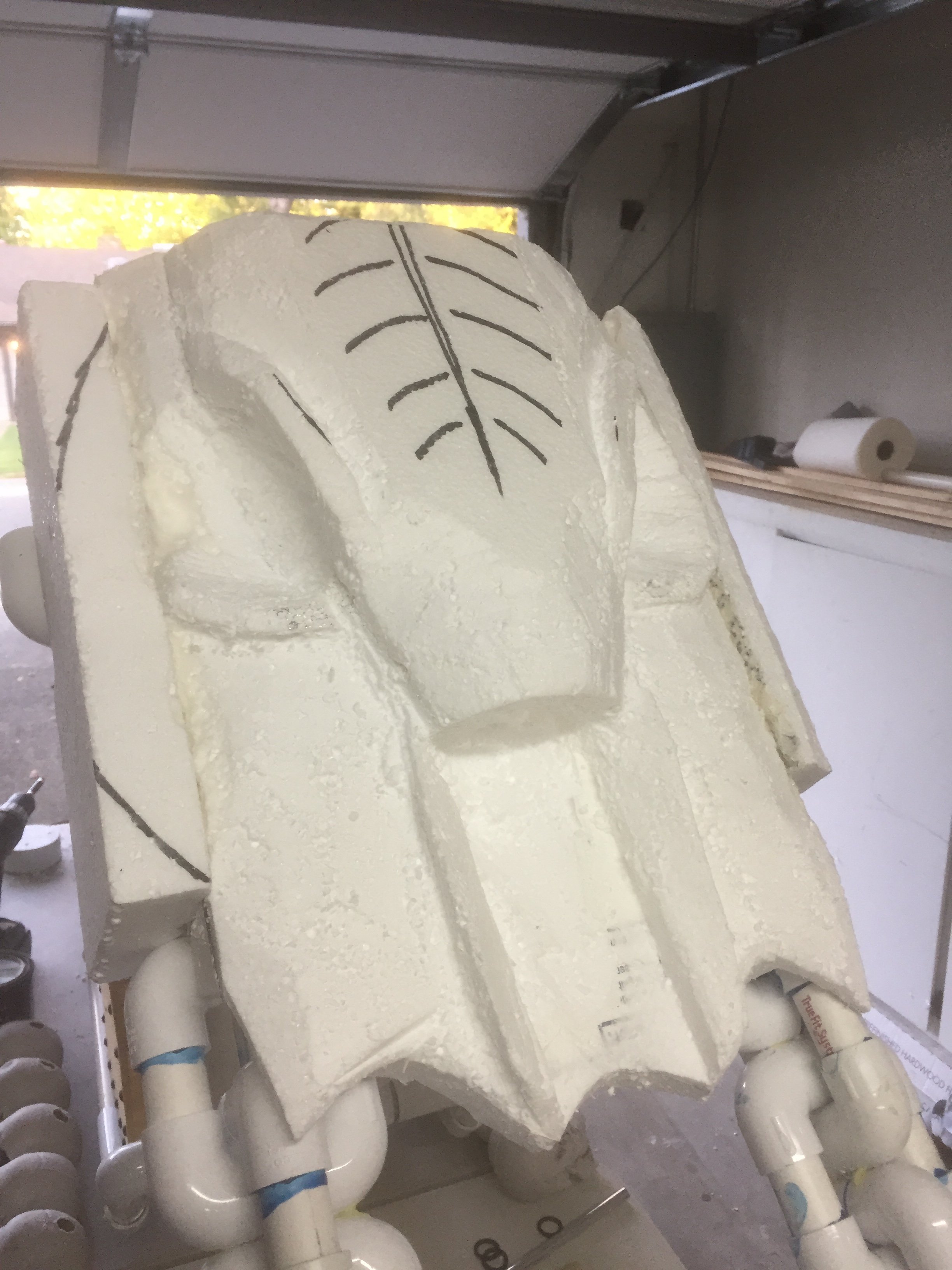

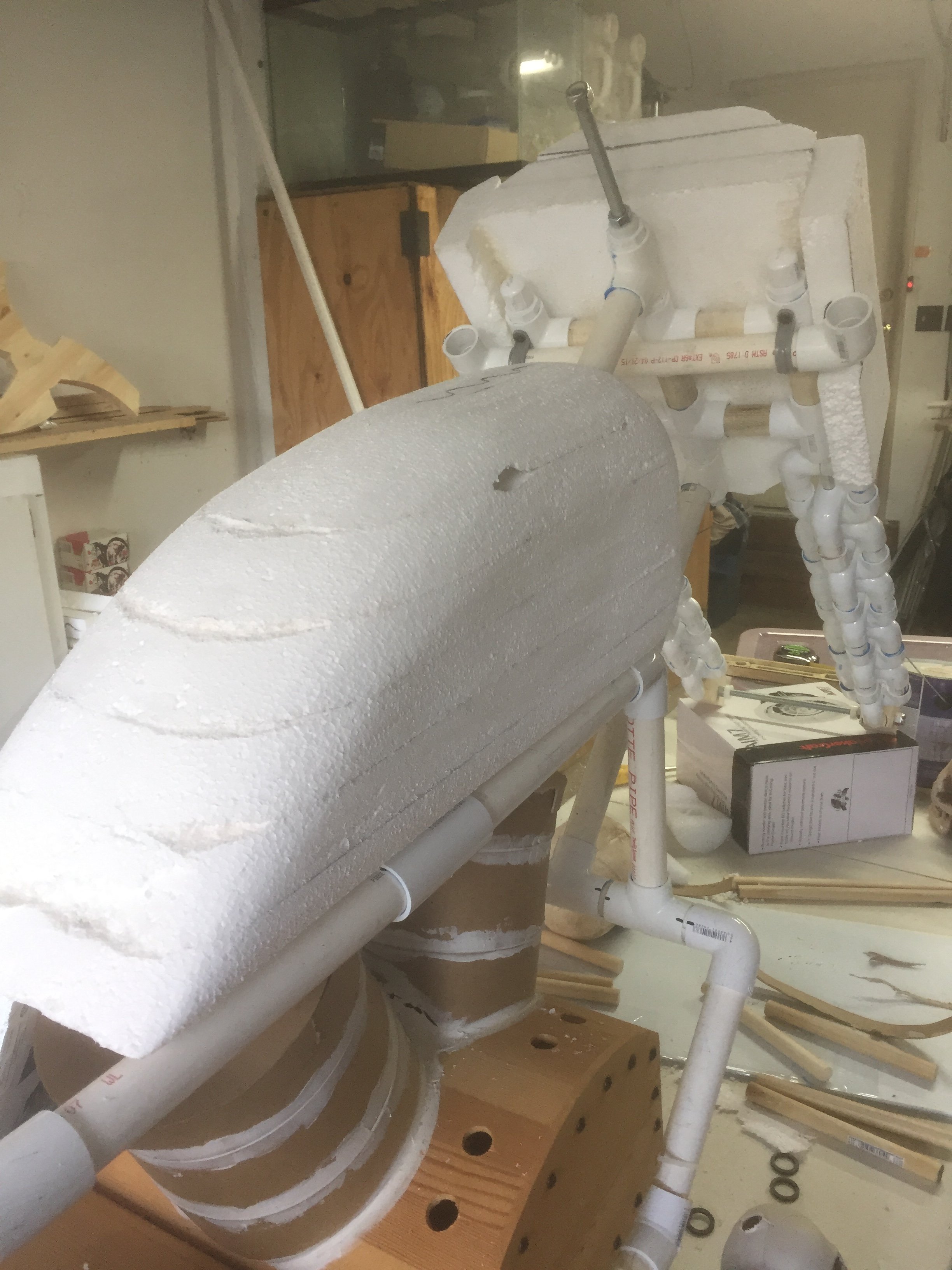

Another 4 hours of work... Frame complete...Engine sinstalled... Started carving gas tank

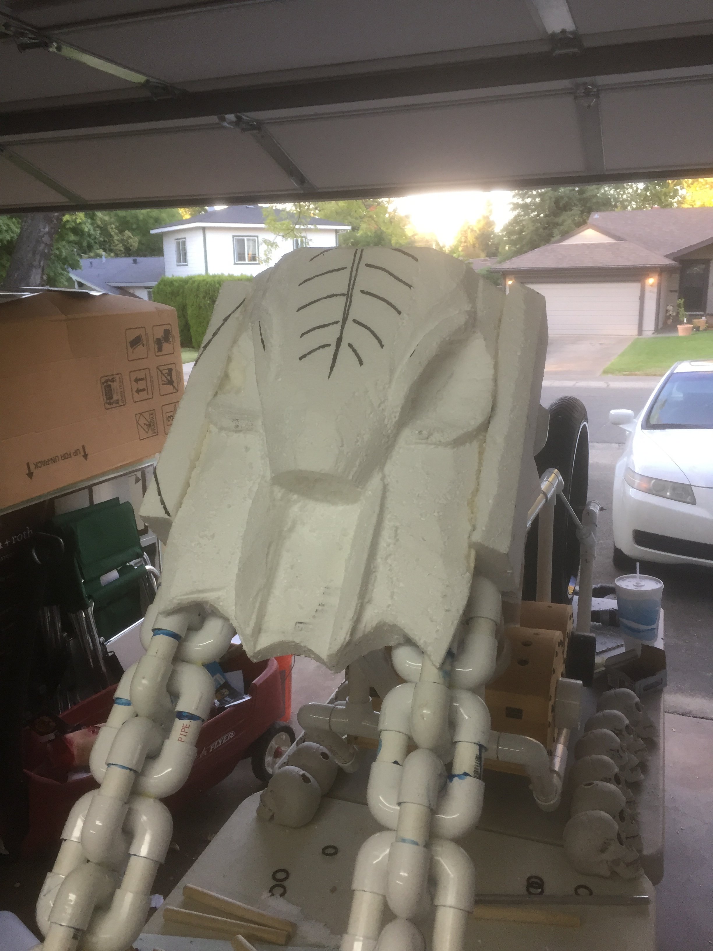

Heads taking shape tanks waiting to be sealed then filled and sanded before painting
