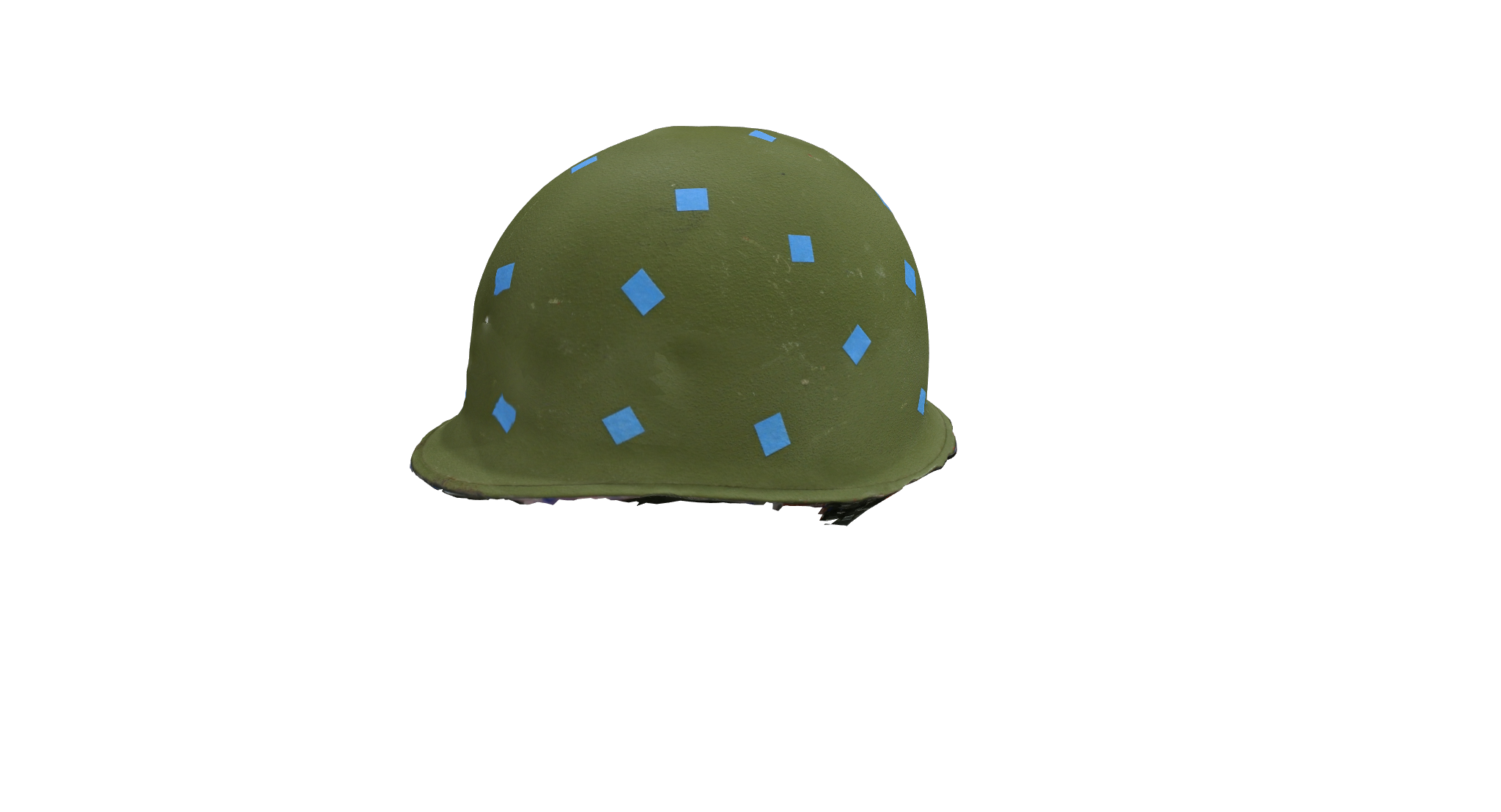

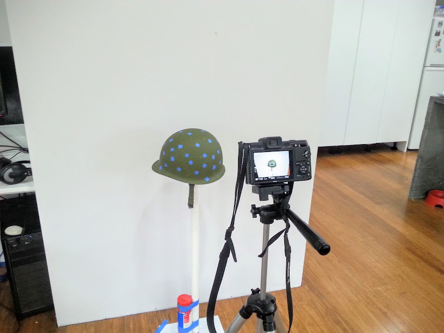

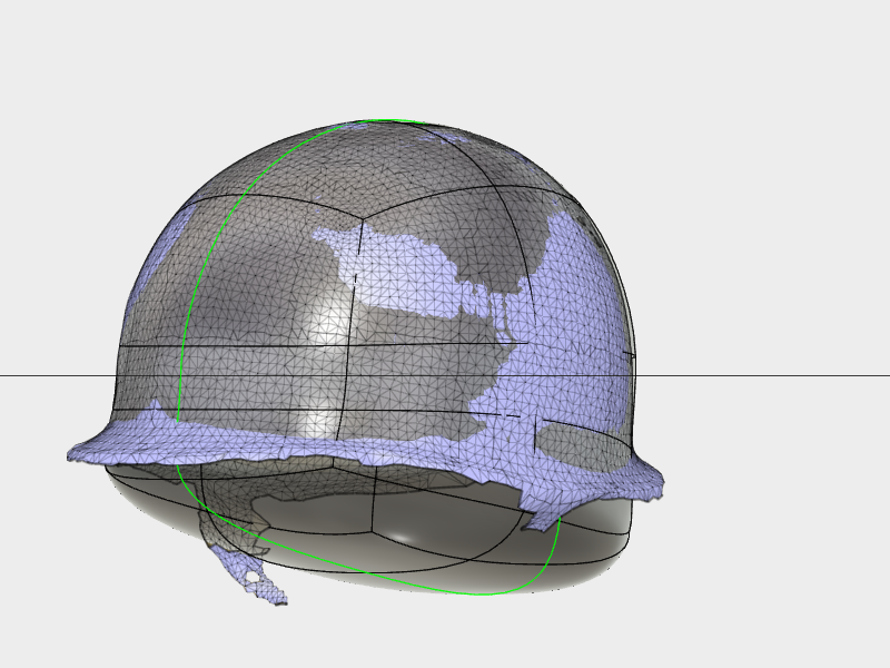

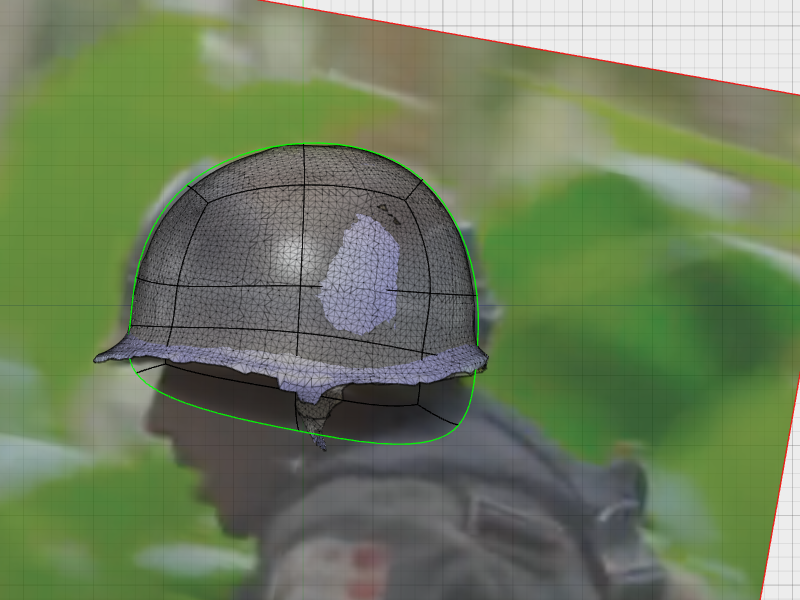

Im really extending my skill with this helmet, Although the pics look fairly accurate I dont want to risk spending all this time and other peoples money to have something that is crap. I have not done anything like this before, my new plan is to;
download 123catch (take a bunch of pics of a RL object and the software turns it into a 3d object), So take a bunch of pics of my M1 helmet then use the 3d helmet.
Go to fusion 360 and make a 10mm thick outer with maybe 5mm clearance and cut it to shape. (still wanting better pics of the back of the helmet)

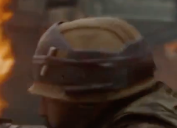

New trailer, new shots of the helmet! Finally a clear look at the details on the back...should be helpful:
Screen Shot 2016-11-10 at 4.54.27 PM.pngScreen Shot 2016-11-10 at 4.54.37 PM.pngScreen Shot 2016-11-10 at 4.55.51 PM.pngScreen Shot 2016-11-10 at 4.54.47 PM.png

I know what I will be doing this weekend, you can just make out the back of the helmet :D :D:D :D :D :D :D :D :D :D
Looking back I dont think its quite as rounded at the back. more filleted angles. I will just do a mirror for the other side, Hey Im at work at the mo are there any more angles of the holes on the otherside?

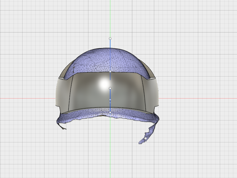

I know it dose not seem like much but Im sure you understand the importance, After working on it Im ready to export it to 360. I have it scaled to about .4mm percision, still a few bumps and what not that are not on the helmet but its good enough. To scale it I took a bunch of measurements from the scratch marks to scratch marks and side to side to ensure its scaled, Next is building an over lay that I can cut out the shape of the armor.
Im just So excited it worked, this was my second attempt the first was not so good had holes and weird stuff going on.
Back to Design of the holes on the right side of the helmet(if you'er wearing it) re lego man and card. I see 4 small vertical rectangles on top and one hole the same size as front holes but with the middle filled in so you only get each side of the rounds. Im not sure if all the helmets have all the holes/vents? Looking Thain's pics on page 10 you can definatly see them and they are quite small on the top, and on one there are more than one lower hole. For the time being I will plan on making 5 holes (4 top and 1 at the bottom split).

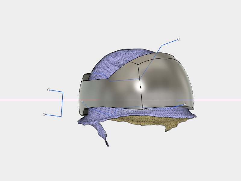

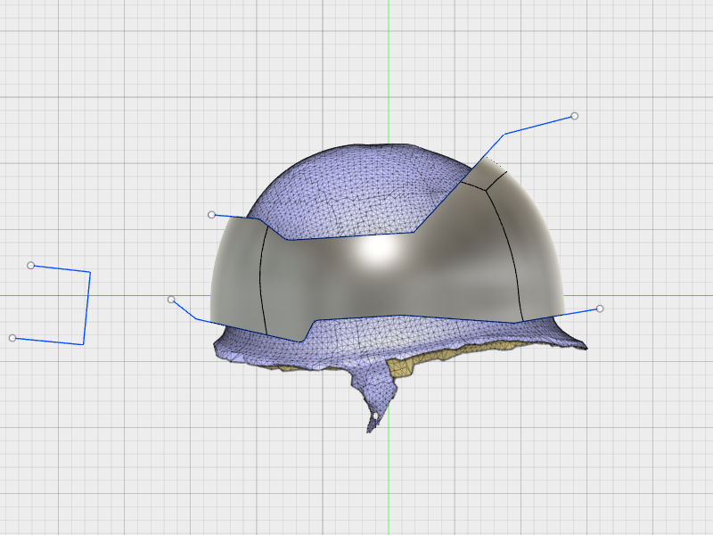

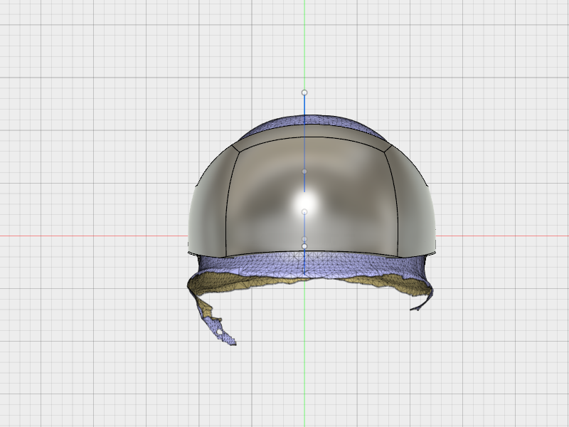

Progress, I have the main shape done, possibly some tweaking later. I will continue tonight, I have my sisters birthday and I need do some house chores before we go.
Rebel Helmet M1Mk2 armor1.pngRebel Helmet M1Mk2 Armor2.pngRebel Helmet M1Mk2 armor3.pngRebel Helmet M1Mk2 armor4.png
Still a bit of editing to get the holes and back piece. I feel much better about this version. I plan on giving the armor a 2mm buffer between helmet and armor.
