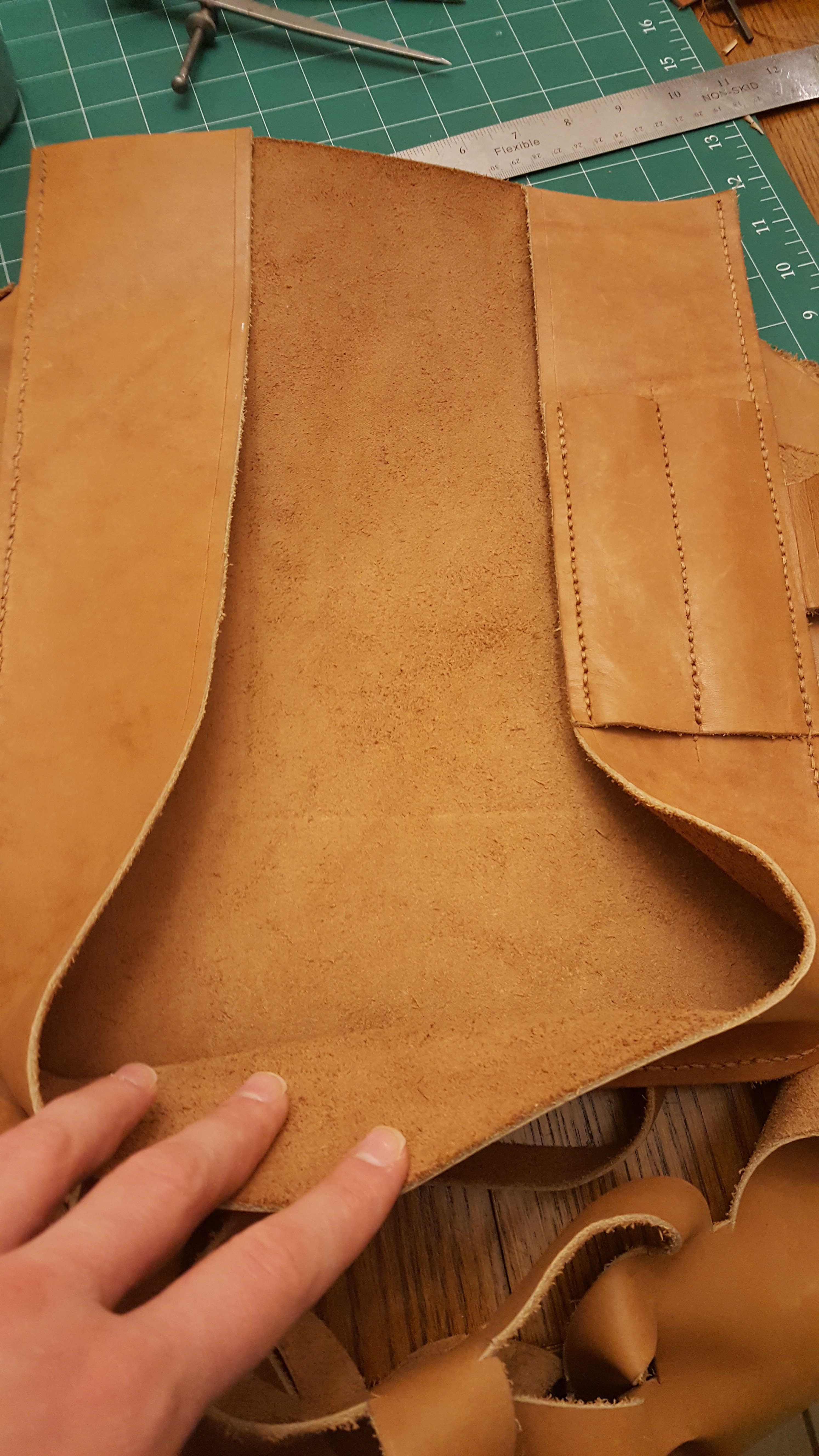

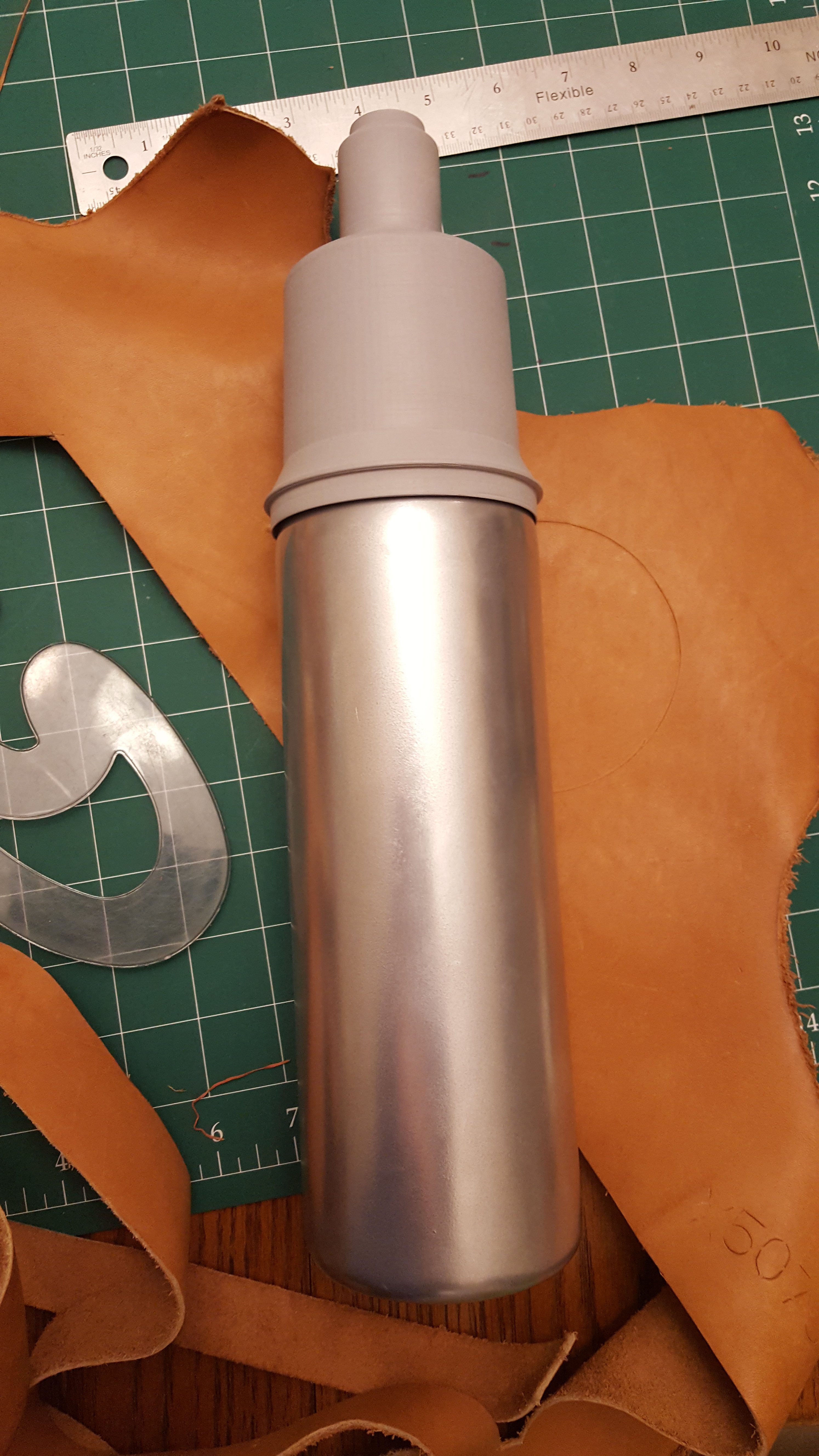

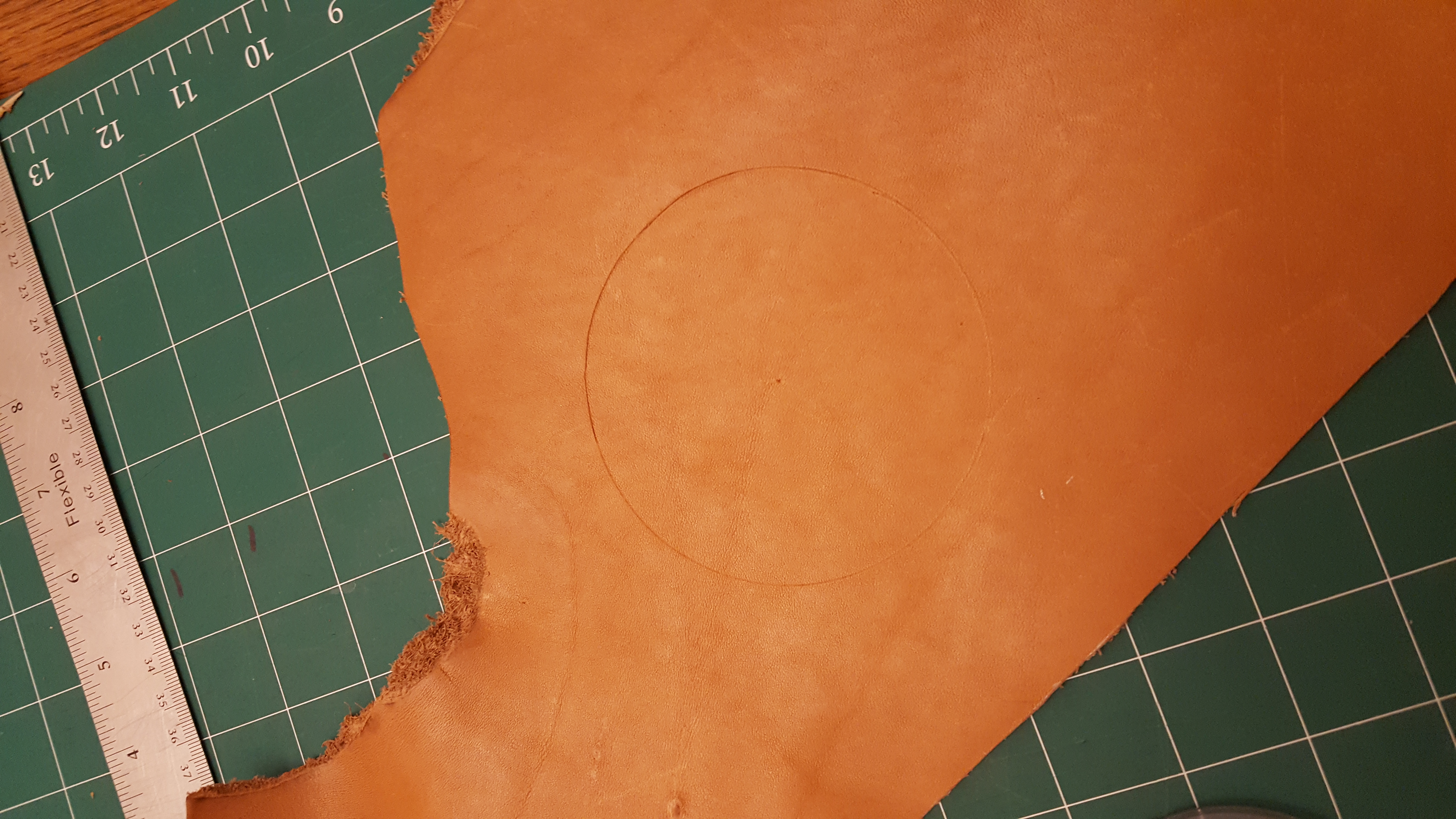

Starting on the leather cup for the bottle that sits on the bottom of the cannister. To get the circular bottom I measured the diameter of the bottle and added half an inch for the 1/4" stitch allowance all the way around. I set my trusty leather compass for exactly half of that measurement and hey presto!

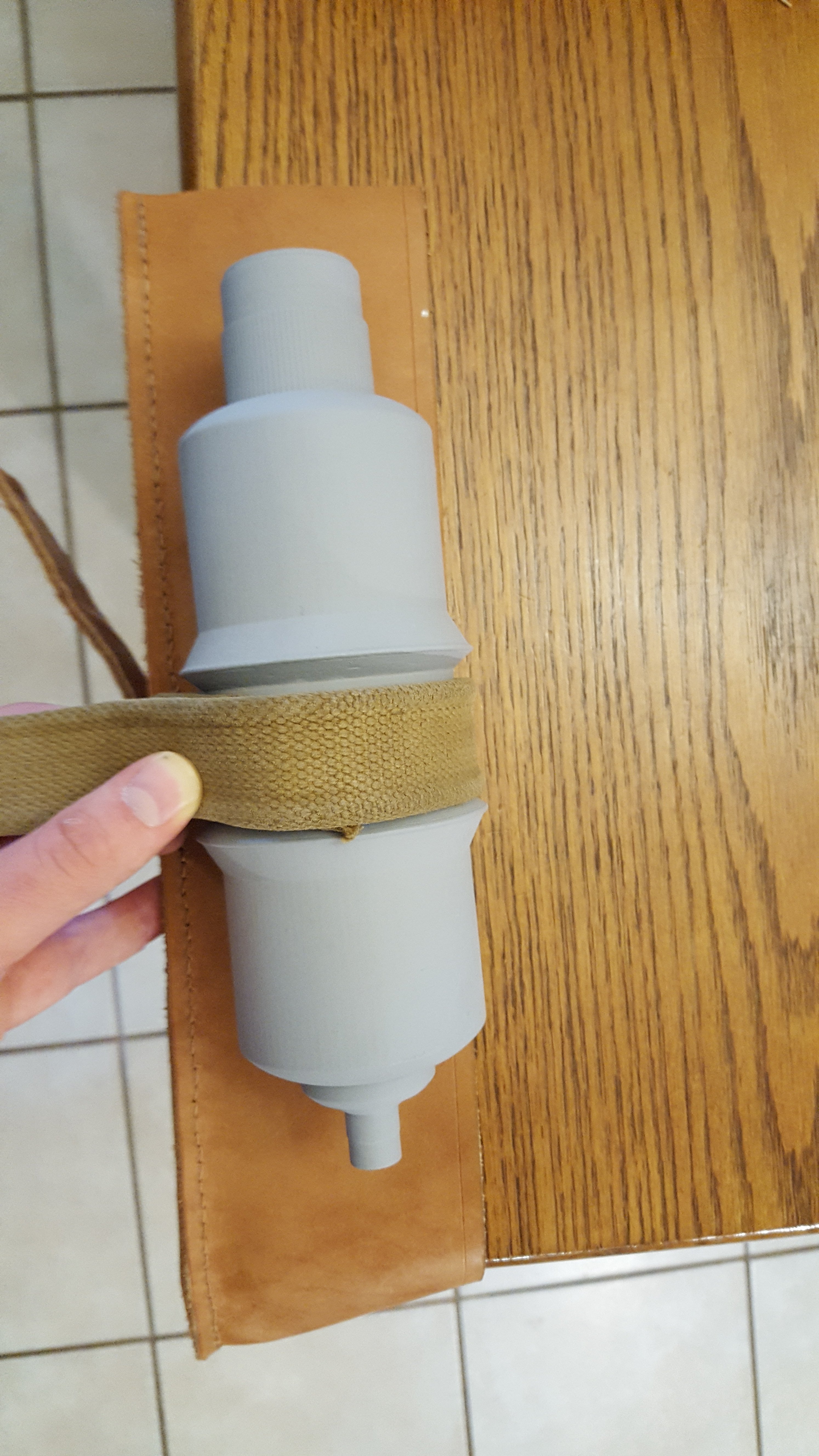

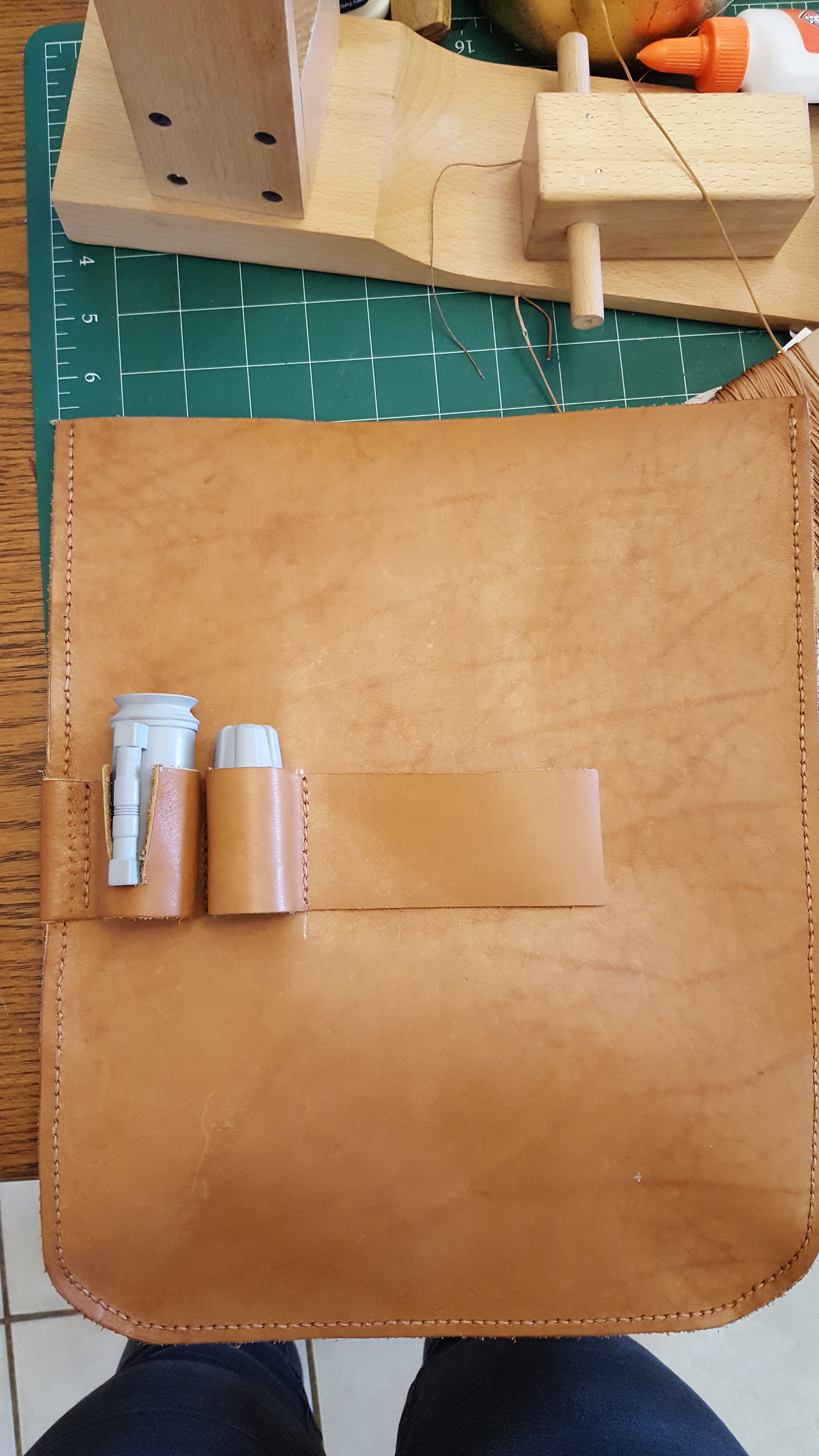

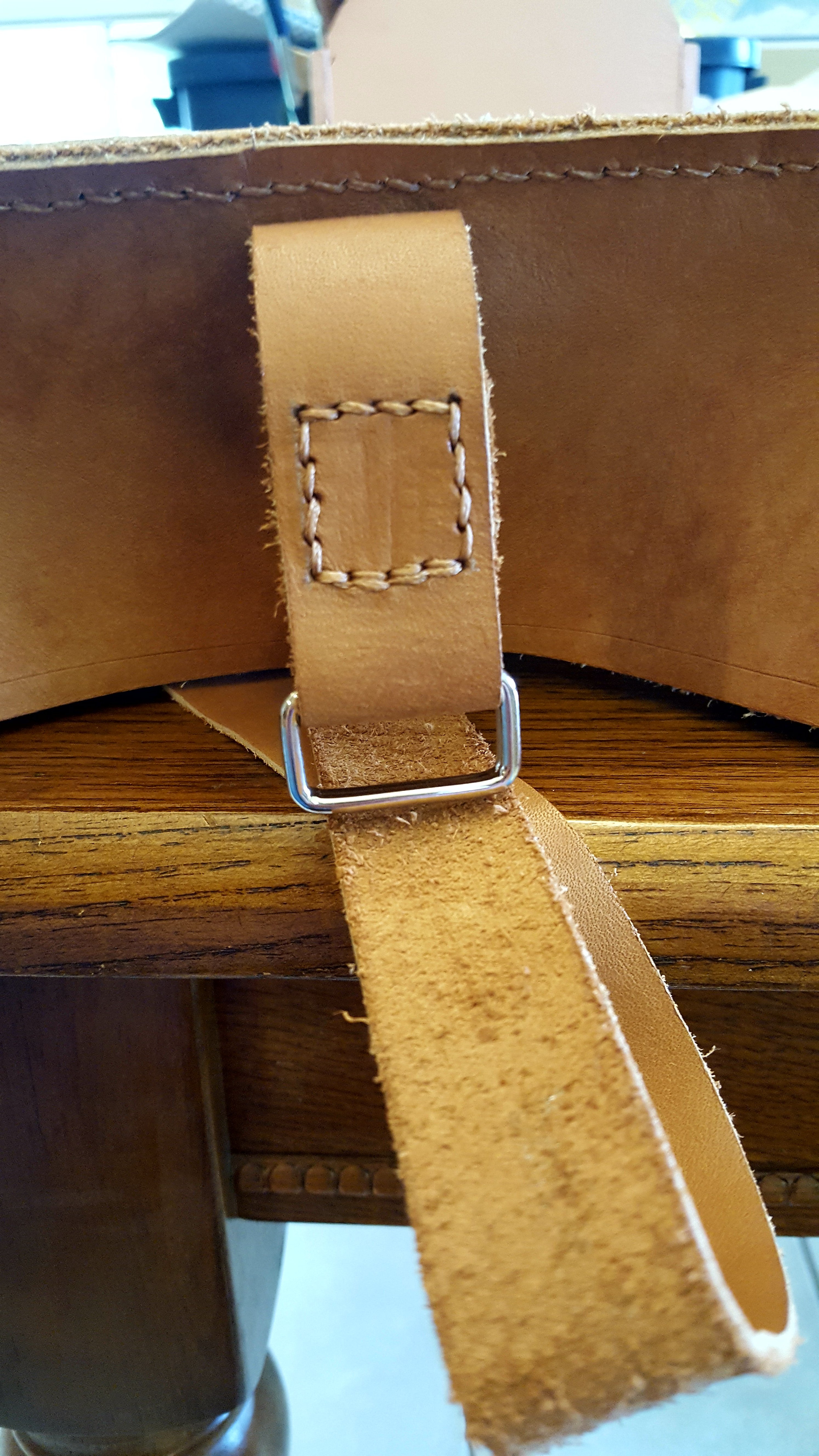

Sewed the strap onto the bottom of the bag for the big water bottle, and I'm currently sewing the strap for the greeblies on the front down.

Yeah, sewing what in what order has been the most challenging part so far! I'm going to add the little loops(?) for the greeblies on the face of the bag, then the side water bottle strap next. I'm thinking I should probably add everything that needs to be sewn to the back panel before I attach it to the bag, too.

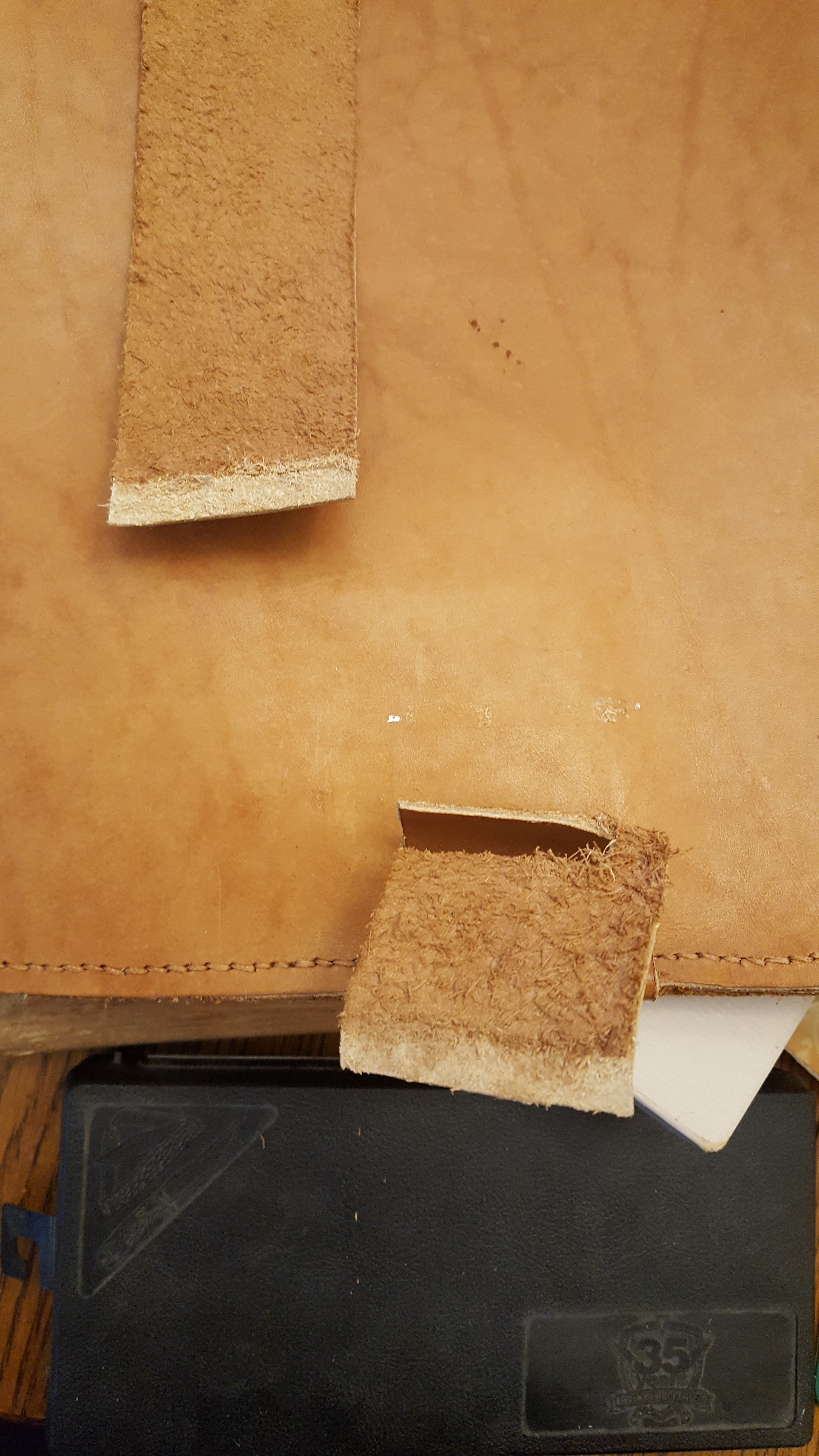

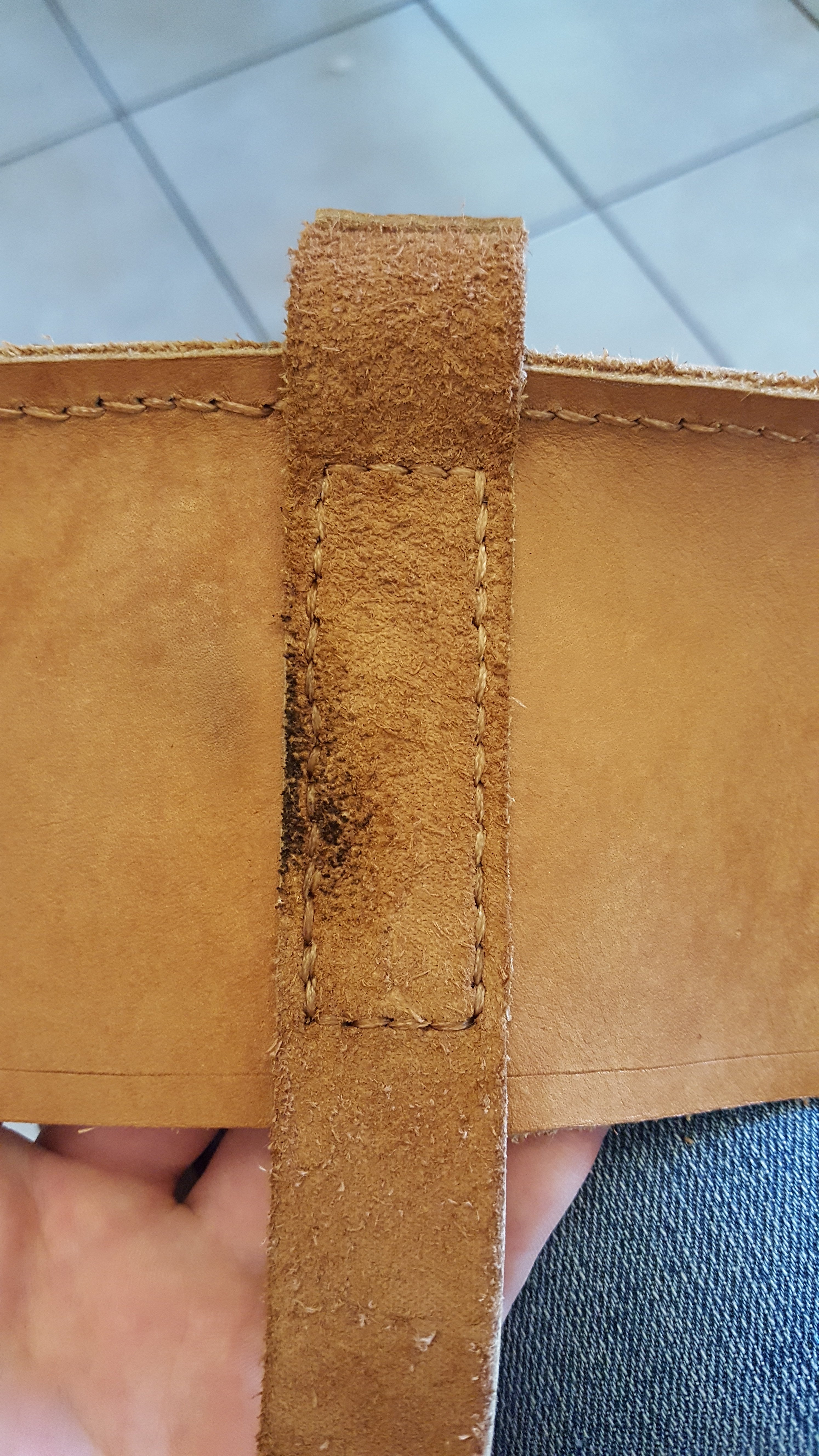

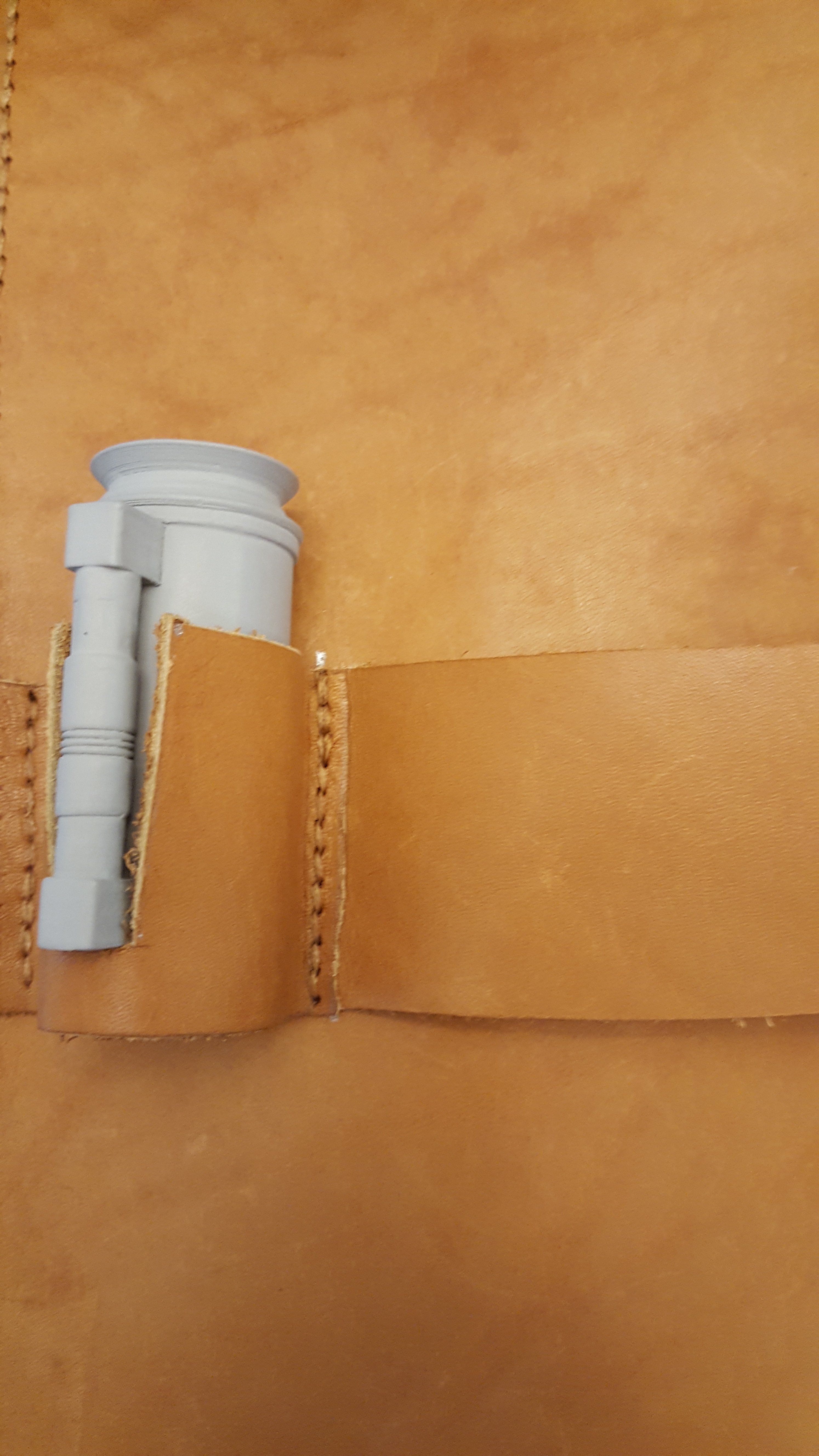

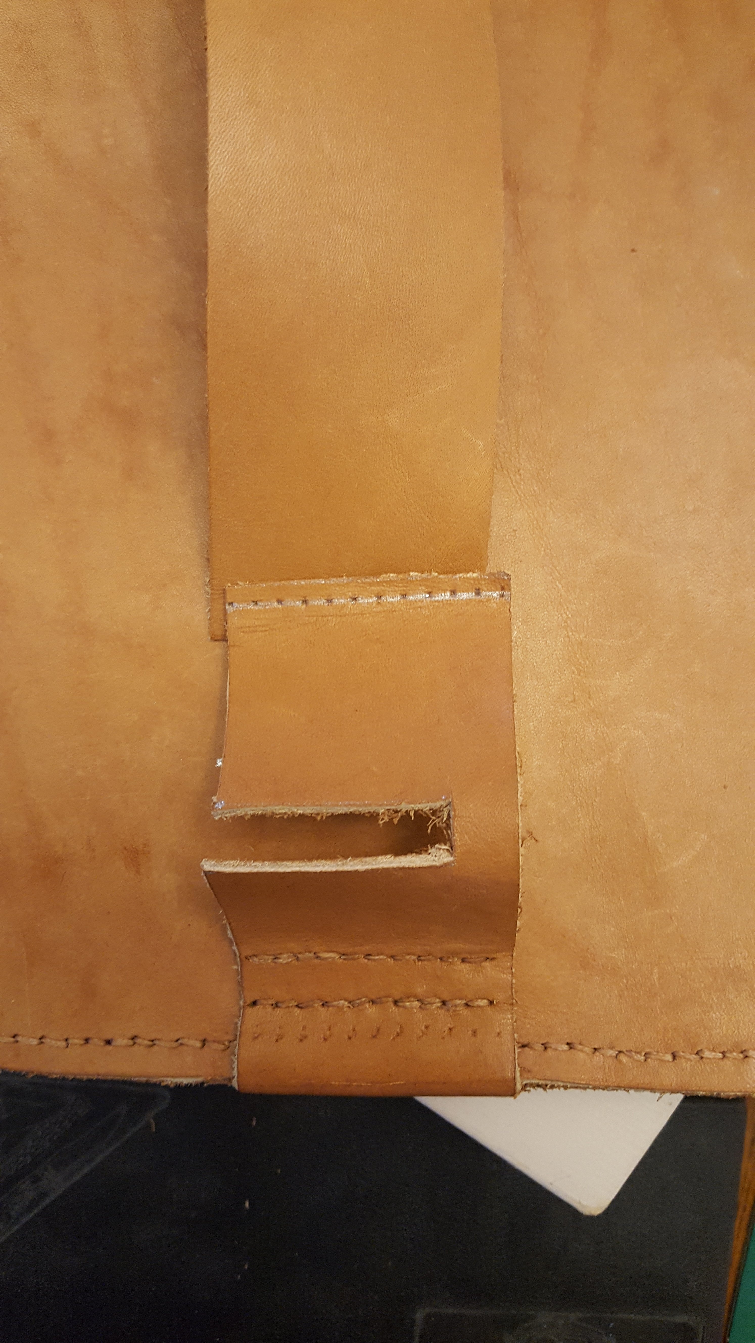

On on an update for the bag, I accidentally cut the strap for the greeblies on the front too short. Soo, I cut another strap to the same dimensions and had my mom skive the end pretty thin. I'm going to sew it onto the same seam that will make the first loop. I think it will work, anyway I'm just hoping it doesn't show too much.
Here's the problem...:(

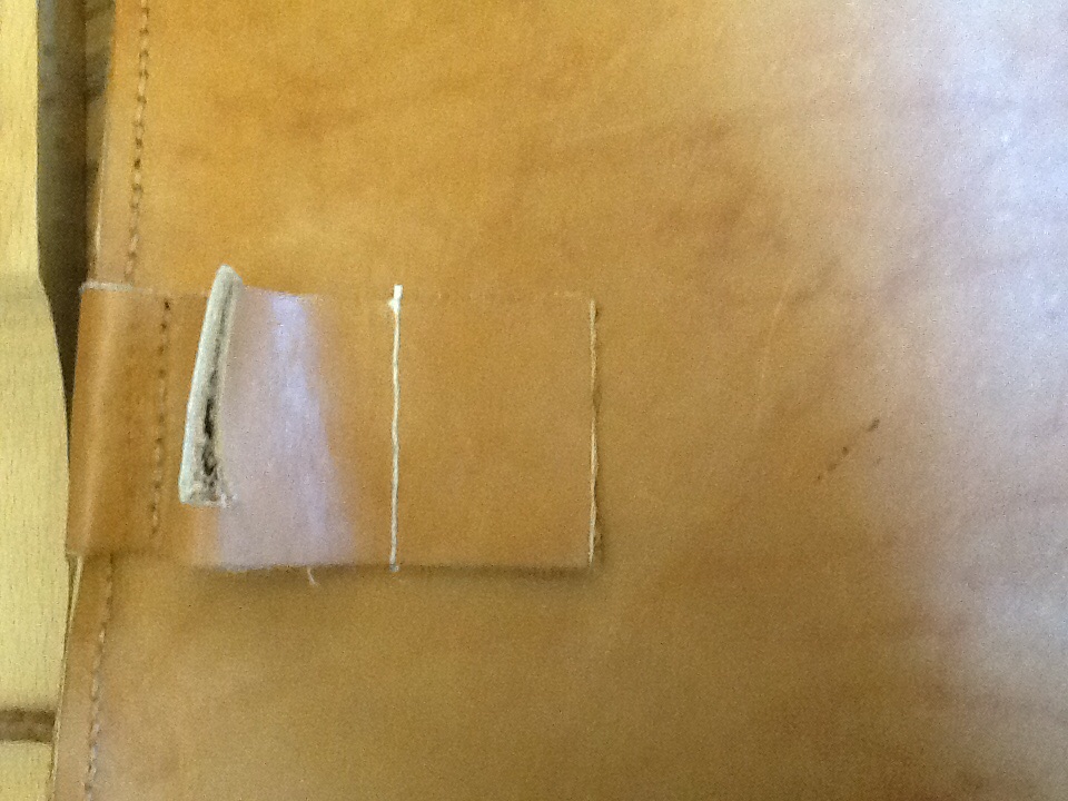

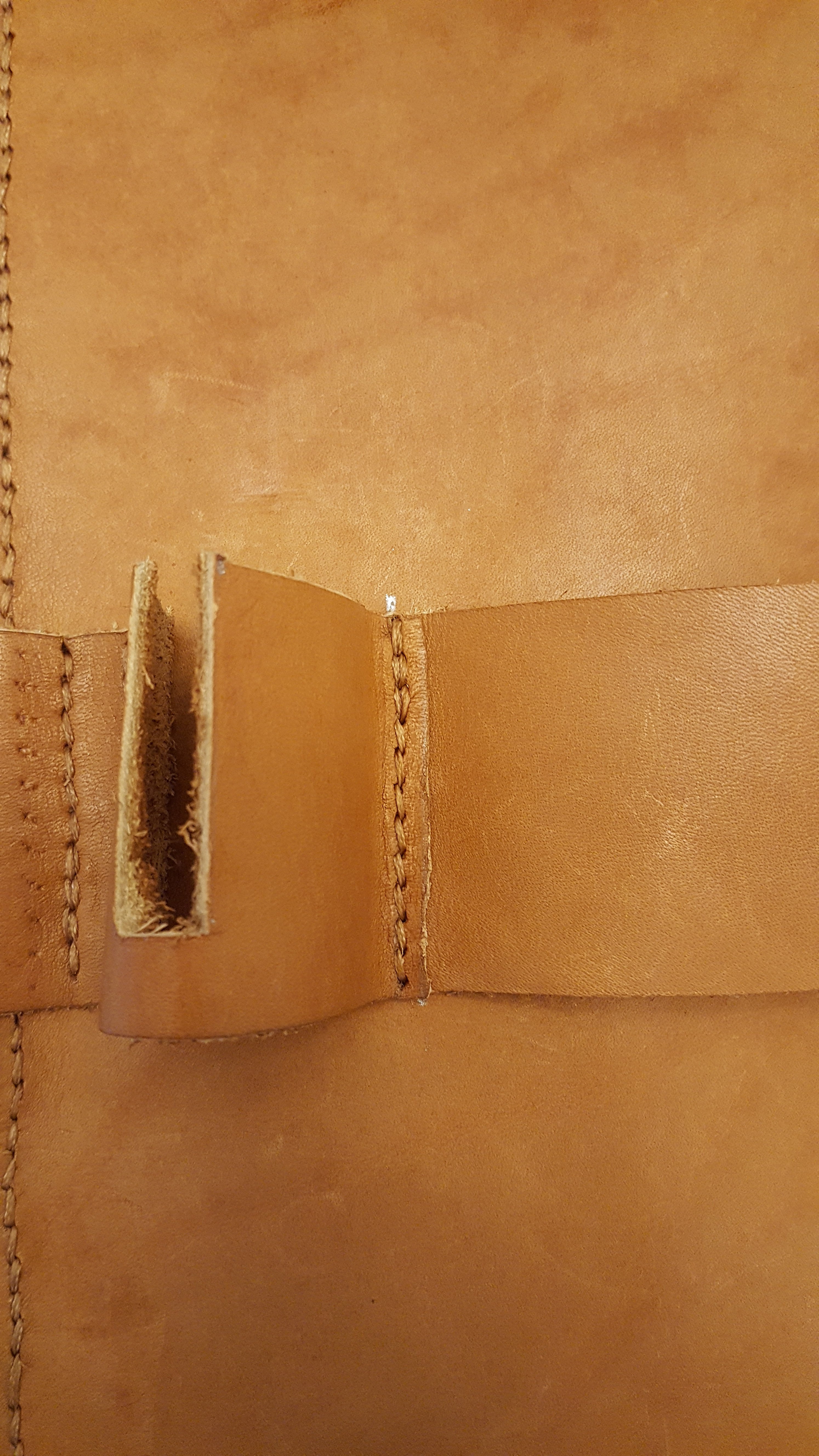

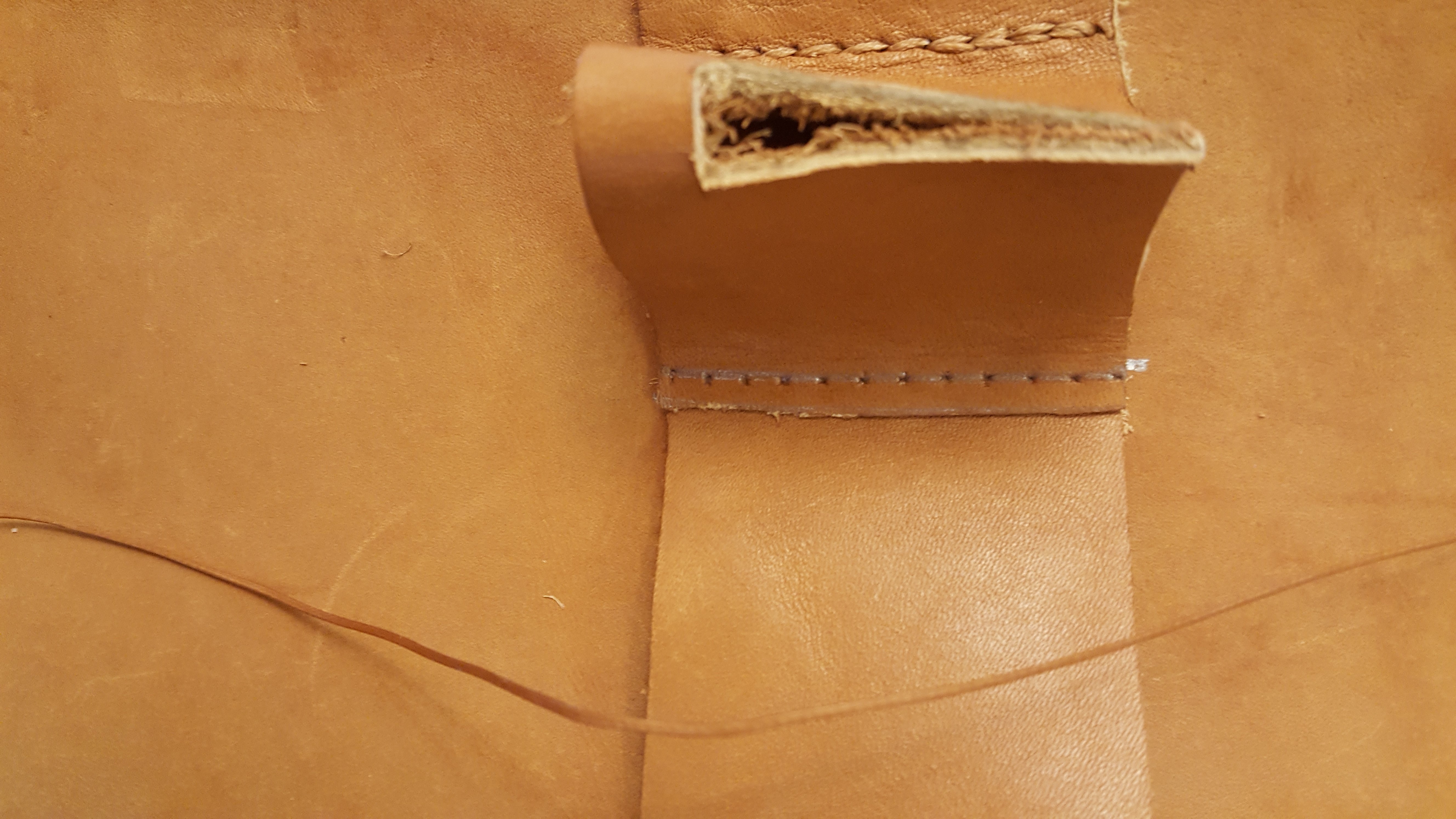

So, i fixed my above mentioned problem with a patch of sorts.
So, as this pic shows, I cut an extension piece for the too short strap. My mom, who works in leather, skived the ends of the two pieces to thin them out.
I used a special double-sided tape to stick the two skived ends together and to the face of the bag. The tape was strong enough that for that small a space I didn't need to clamp it, which would have been difficult anyway.
Here is the result, with which I am most delighted. It exceeded my expectations for a patch, and will be almost invisible when the second loop for the other greeblie is made.

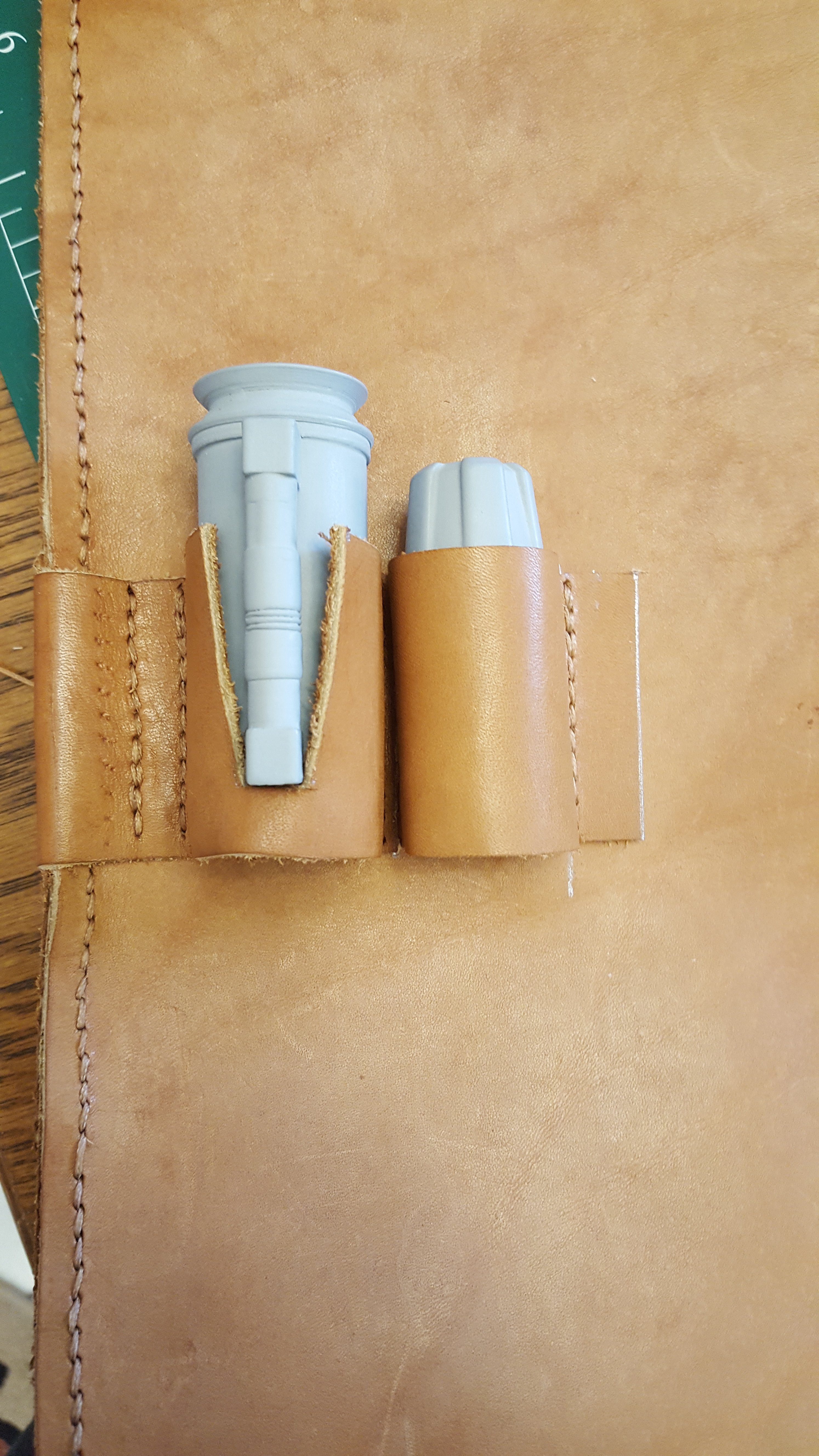

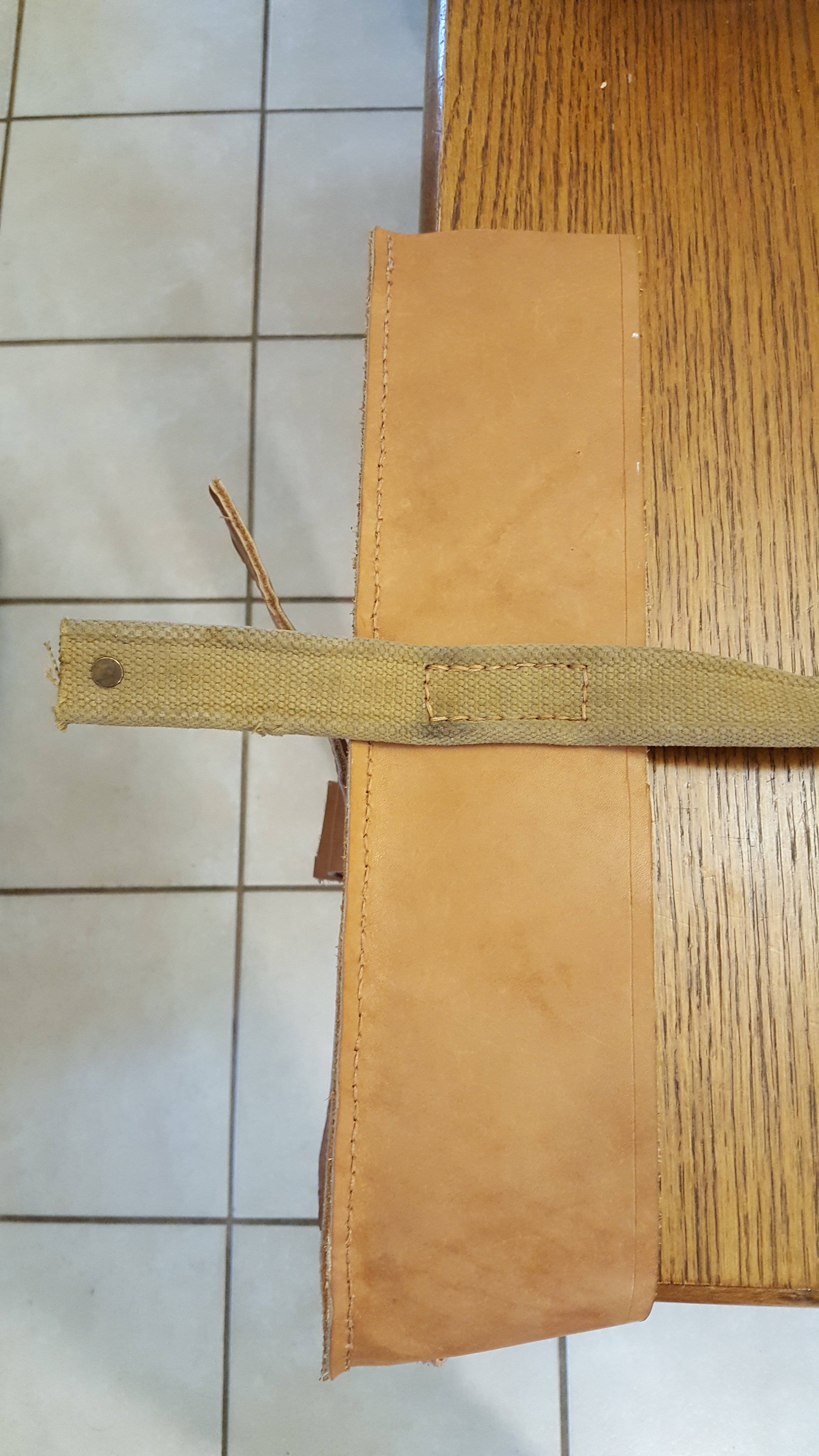

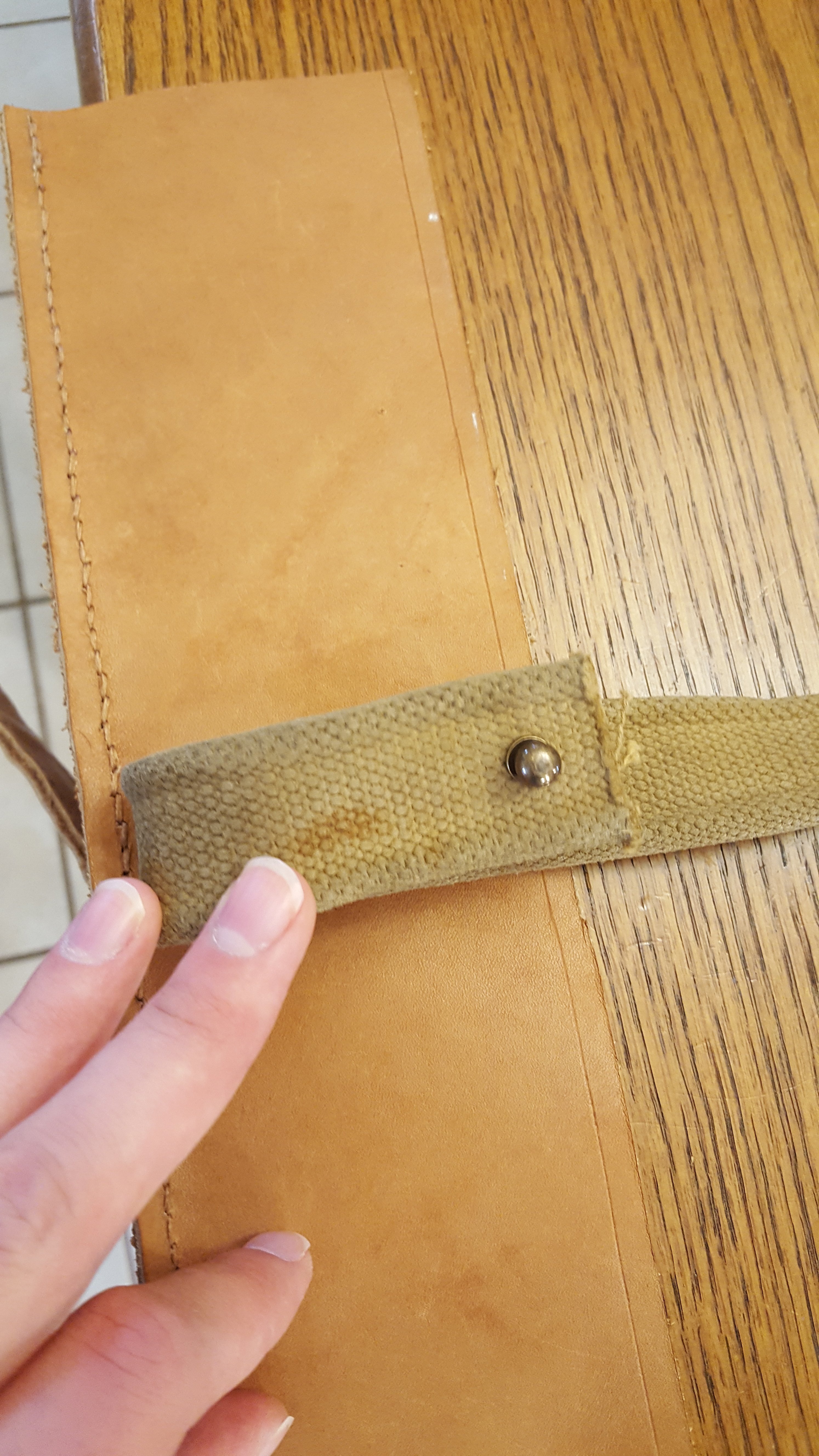

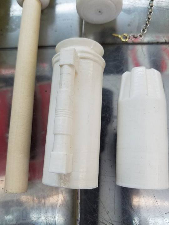

One thing that I am going to do differently in my next build is that instead of notching out the strap for that canister, I'm going to use a coping saw and cut a slot under that thing on the front of the canister so it will actually act like the "clip" it's supposed to be.
I notched that strap out on three separate builds and NEVER got it to lay the way that i wanted it to. This time I'm taking a new approach. :p
I thought of that, but I was worried about it breaking off. I think it really is a clip IRL, tho.
Although, on one display picture I have it does look notched out. You can just see where the top of one side of the notch didn't lay flat.
That's true. But don't forget that there are several costumes on display all over the world. Not all of them are the hero costume, and I'm sure many of them have 3d printed or resin cast replicas of the greeblies which are solid and don't have a clip feature.
If my "clip" snaps off, I'll glue it back on. No trouble. That's what Mitre Bond is for :)

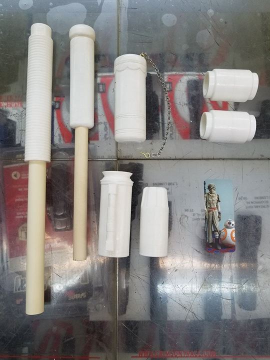

Just received a fresh set of backpack greeblies from Ian Martin of Dejarik Creations.
My first set of greeblies were a gift from my RPF Angel, but when i needed more to make subsequent backpacks I turned to Ian..and these things are fantastic! I cannot recommend him enough if you want to do your own backpack build. He makes the side and bottom bottles too (the bottom one is functional) but I had already purchased those two from him months ago so i just needed these to complete the set.
These are some of the smoothest 3D prints I've seen, and Ian has taken care to do a stellar job of cleanup before shipping them.
NOW I can begin on Rey backpack V4.0!
