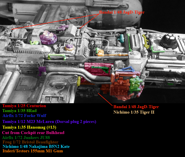

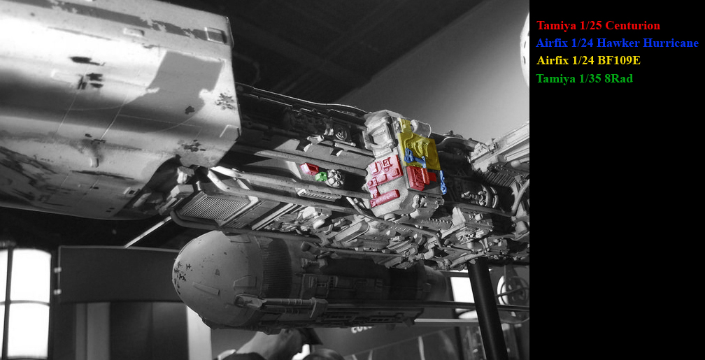

I've started some part maps that are "Tie Killer" specific. As of now they are just a start with some areas of the ship I haven't even explored yet. The intent is to identify parts or configurations specific to this bird. the good news is I keep finding new parts all the time which is really exciting for me. Please feel free to chime in with any knowledge, corrections, or identifications that others may know. I don't claim to be any sort of expert, just a passionate model builder. I'll add more maps and identifications and corrections as I go. These photos are taken from publicly posted photos on Flickr of the Neisen Tie Killer that were displayed publicly a while back.

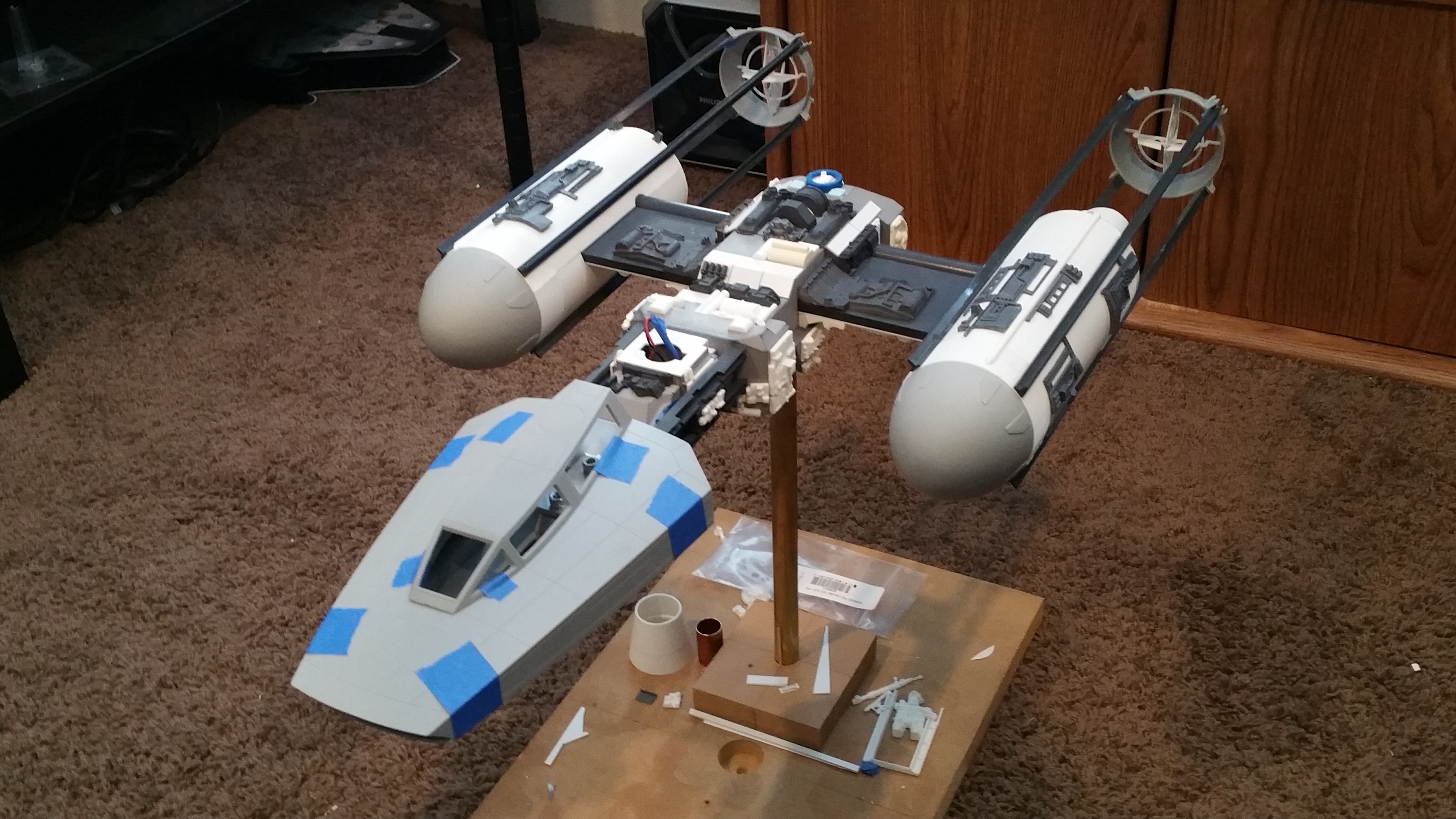

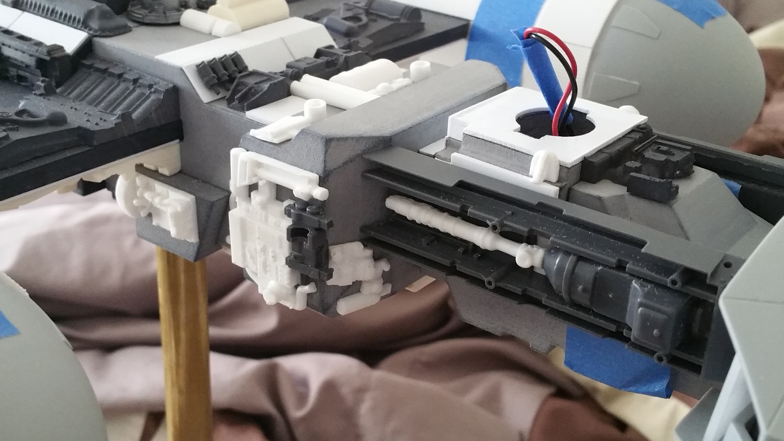

Right now I'm in the process of mocking the ship up to see how it looks and how everything will fit based on the marriage of 3D design and model kit parts. Not much is actually glued together yet, hence all the tape holding it together. Iv'e been modding the upper neck, slightly widening it so the 8rad side walls will fit properly, redoing the droid socket to fit the astromech more snug, extending the droid socket back, and lowering the very back so the Sealab tubes will fit in the crevice.Still need to sand it up better.

Meanwhile, I decided to look over the Centurion kit one more time last night and found that this piece is a match and just cut down from the original piece. It's located on the protruding starboard side side wall. I can't believe how much they used the centurion on Tie Killer!

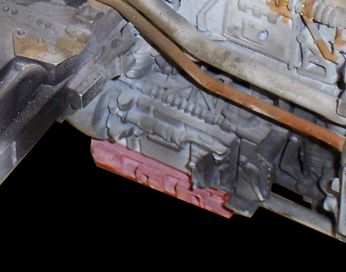

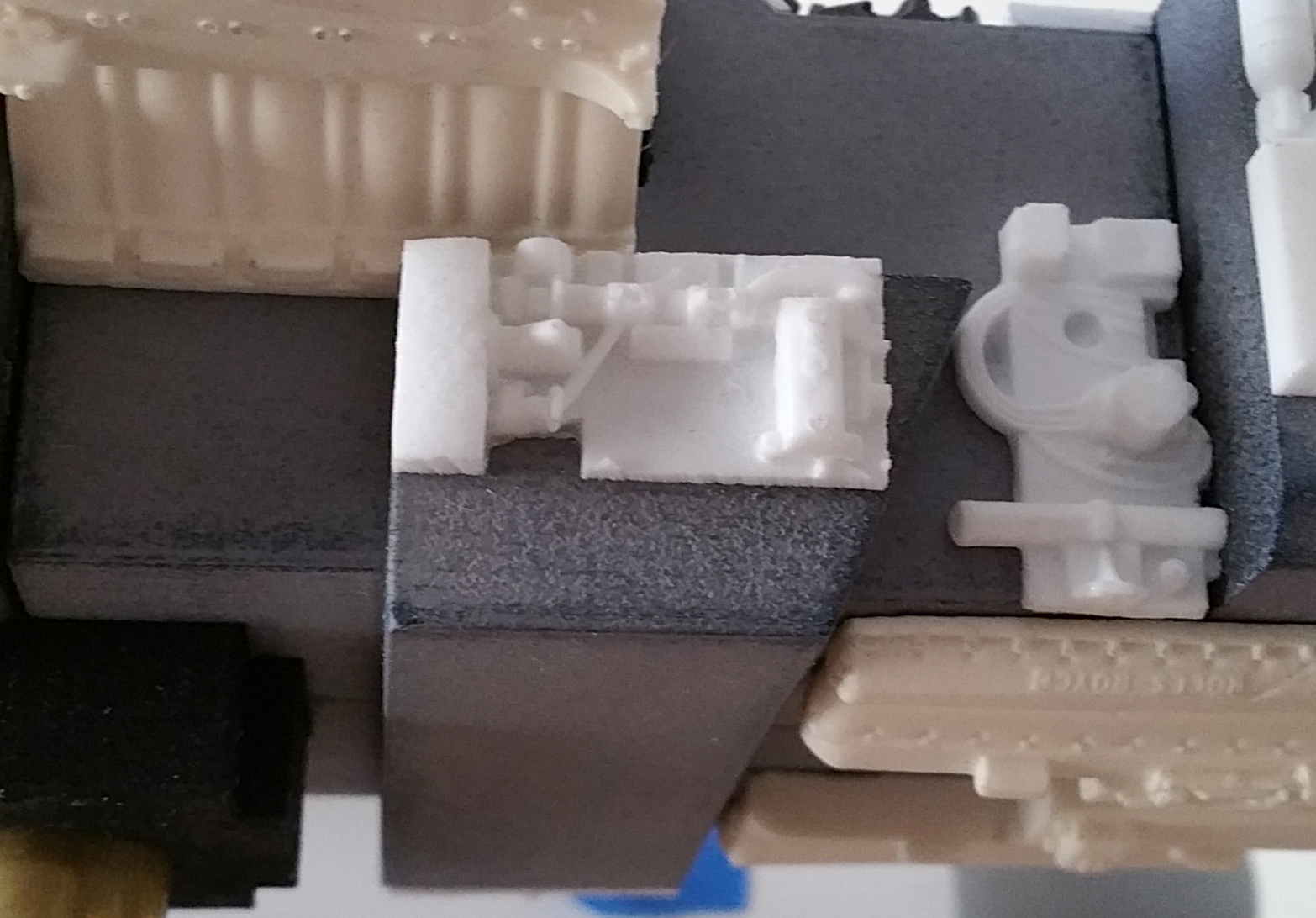

So, the more I study this ship the more I've realized that the rear bulkhead or I should say portions of the rear bulkhead are used quite a bit. The Centurion is used more so. the same few pieces are just chopped up and used all over this thing. Here is some progress I've been making. I use Silcast II for my casts which comes out white and makes it difficult to see the detail until it's painted.
I especially like this little assembly of the PDR, Tiger, and F4 strut. I love how intricate it is.
the other side uses part of the PDR to fill in the space below, but this side is different. Can anyone identify the higlighted piece? My guess is it's part of a larger piece cut down.
Any help would be greatly appreciated.

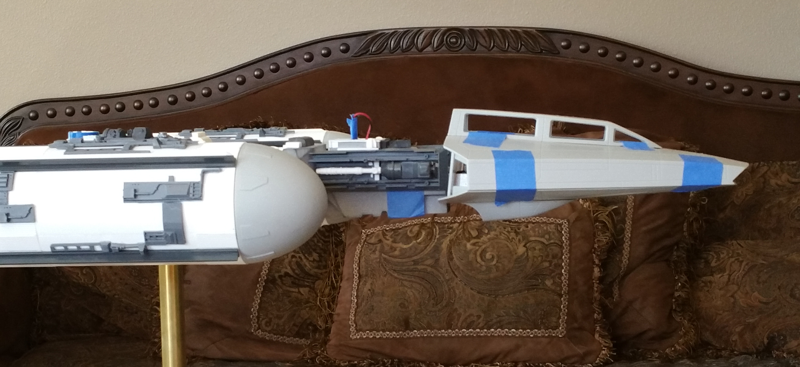

So I've been mocking up the Y to see the overall look and for my taste I wanted the cockpit profile to be a little more level. It had a slight downward angle, or I should say it has a slight natural downward angle due to its shape. Since there are 2 screws that attach the cockpit to the metal armature I decided to glue a little wedge with .20 mm styrene which would lift the nose up slightly. I liked the way it came out.
I realize I should of taken a before photo, but here is the cockpit profile now.

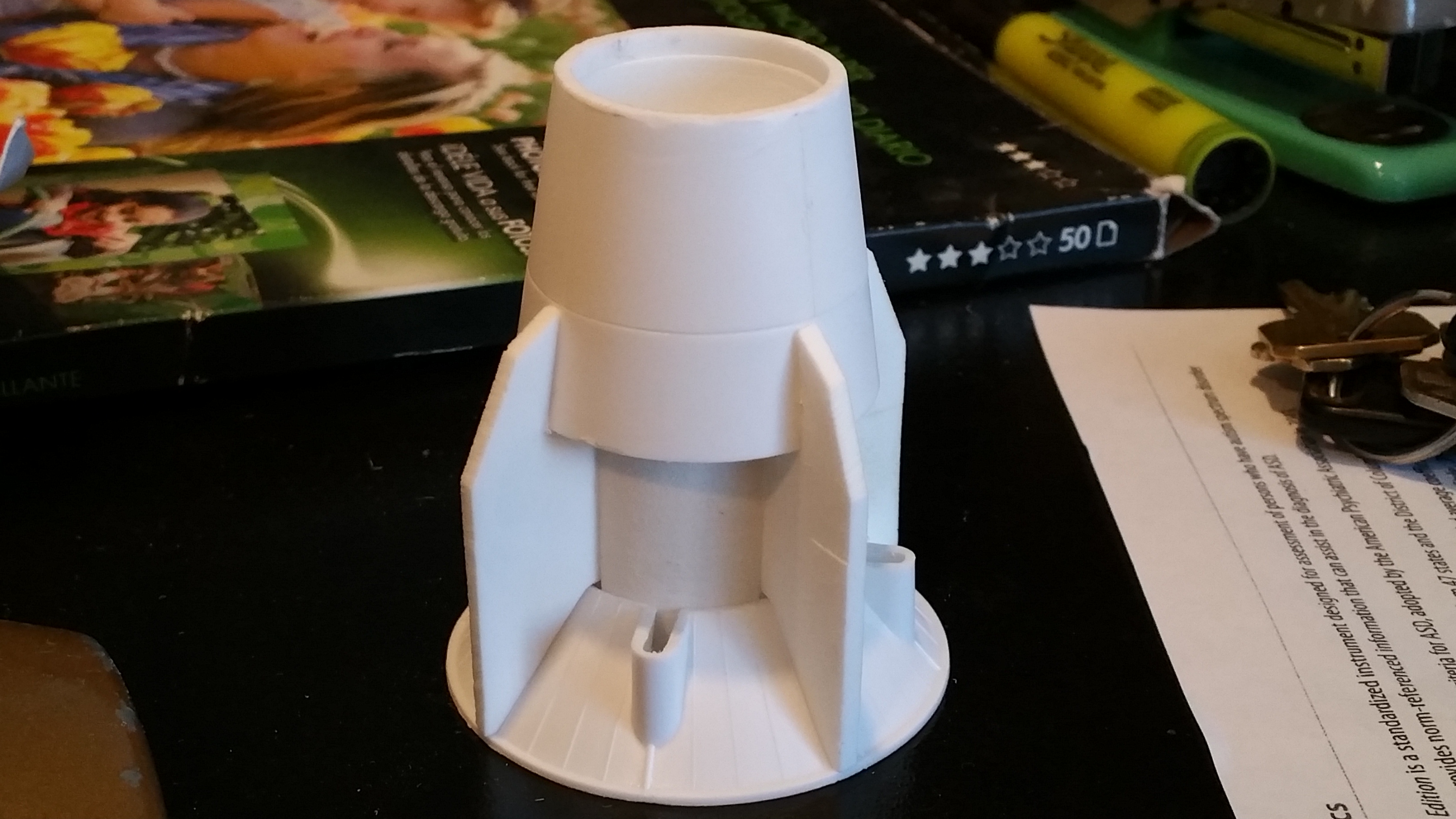

Started work on the engine nozzles while I've been waiting for more kit parts to come in. I used Stephan's engine core 3D file and made my own fins. Time to put some greeblies on them.

Your "highlighted" area for the side is 4 parts. 25pdr, and 3 small centurion parts glued on top.
