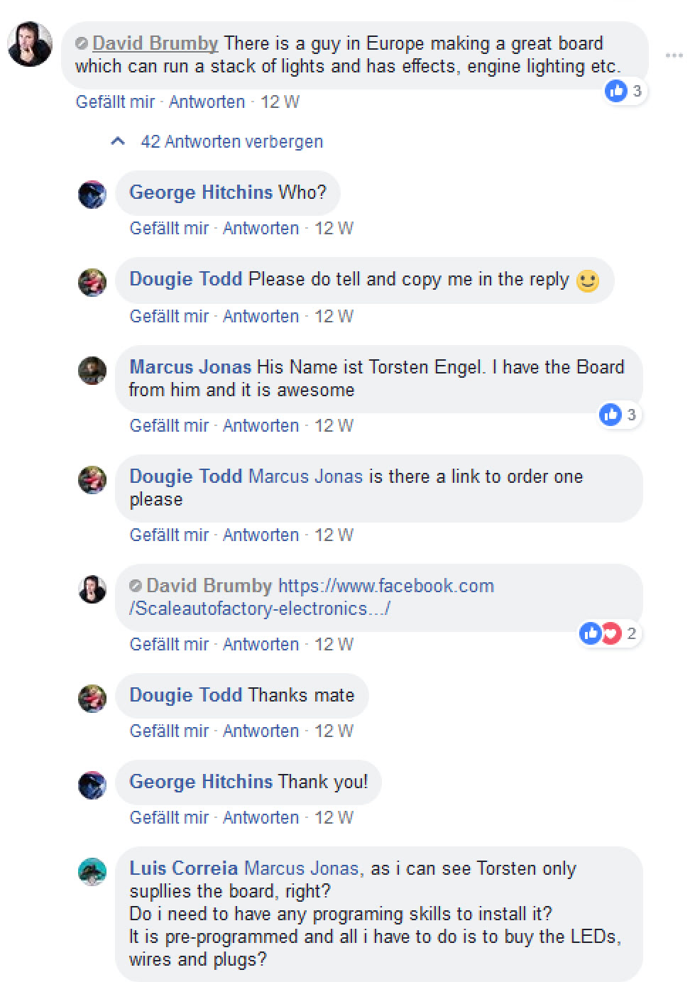

gedmac66 Take a look underneath the entry from David Brumby - real name David Woods and he has lots of fake accounts...
I will respond to your mail asap.
I'm not seeing the info, either. Did you have some customers file bogus Paypal claims to get their money back after you sent them their lighting kits?
Only one after 3 month he buy it...
in the facebook you can see comment from David Brunby (real name David Woods) and Sam Beattie (fake account from David Woods).
paypal has decided to get the money back without asking me about the problem - this is to much risk for me to sell more boards via paypal.

General Info: i have closed down my production of board - you can read the full story on Facebook:
https://www.facebook.com/groups/261858980820153/permalink/616543865351661/
Paypal believes more liars and cheaters. I'm out of business now.
