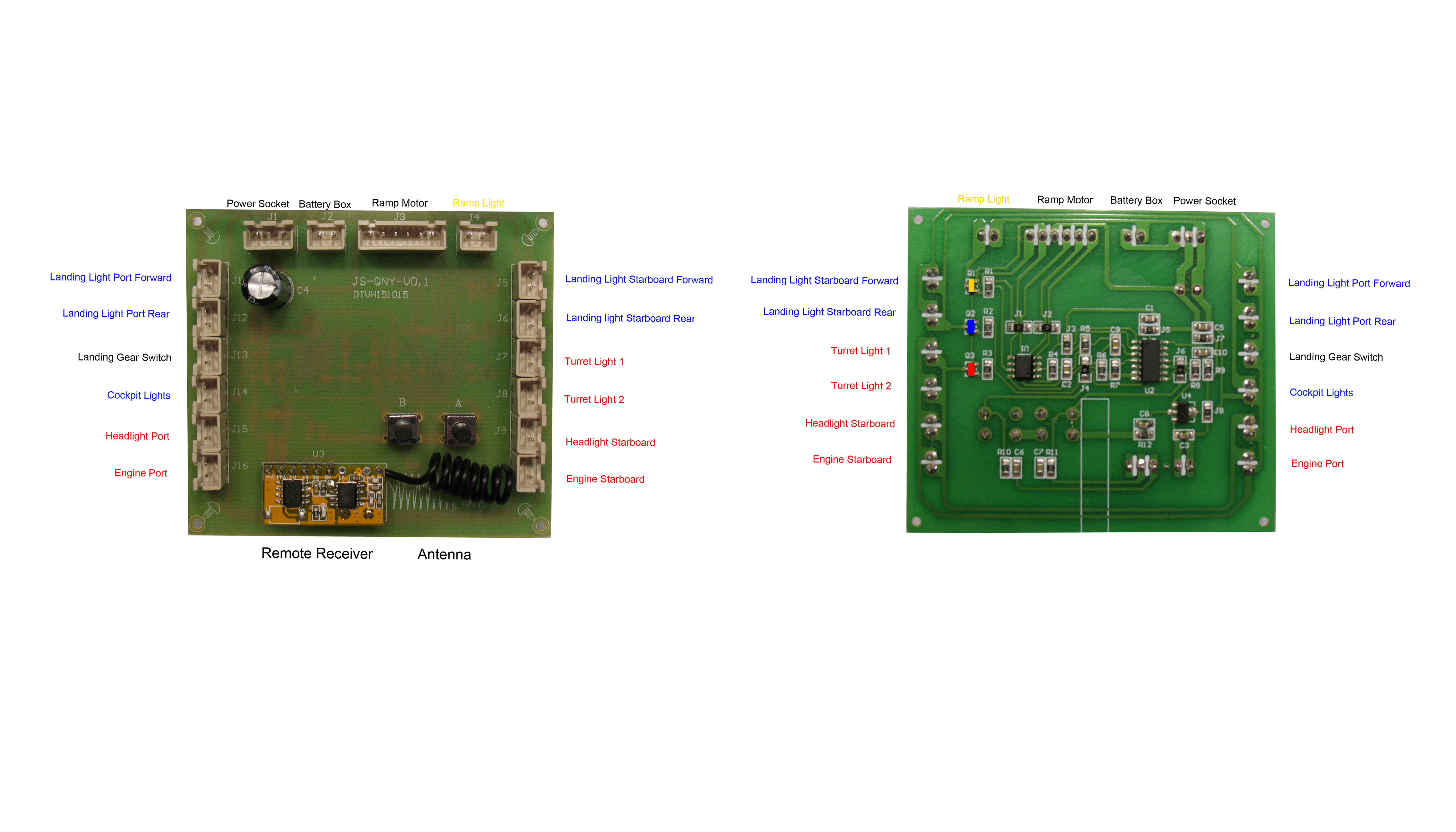

For anyone wanting to know which transistors control which lights on the stock Deago control board, I made up a simple color coded diagram.

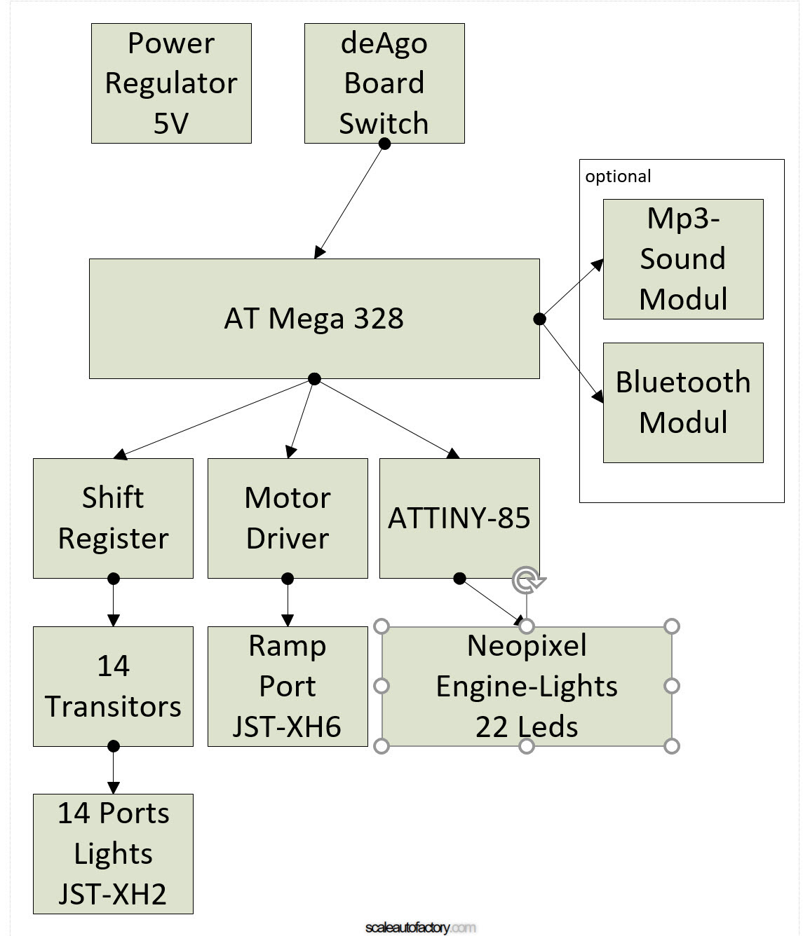

Is this something that you plan to make available for purchase? - Yes
Is it to be more robust than the anemic Deago board? - Yes
Could it be made to have extra sockets for additional lighting? - Yes

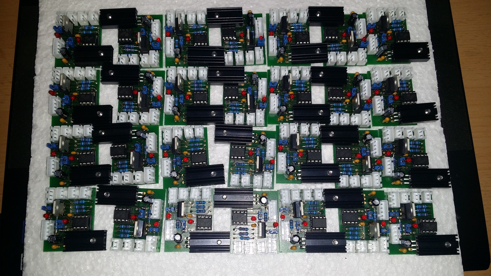

Arduino nano
14 Output channels
Ramp
can be switched on/off by deAgo Remote Control
Optional
Bluetooth + Android app (no IOS, because of the useless and stupid apple development stuff...)
Sound (mp3 files)
tengel07 ,

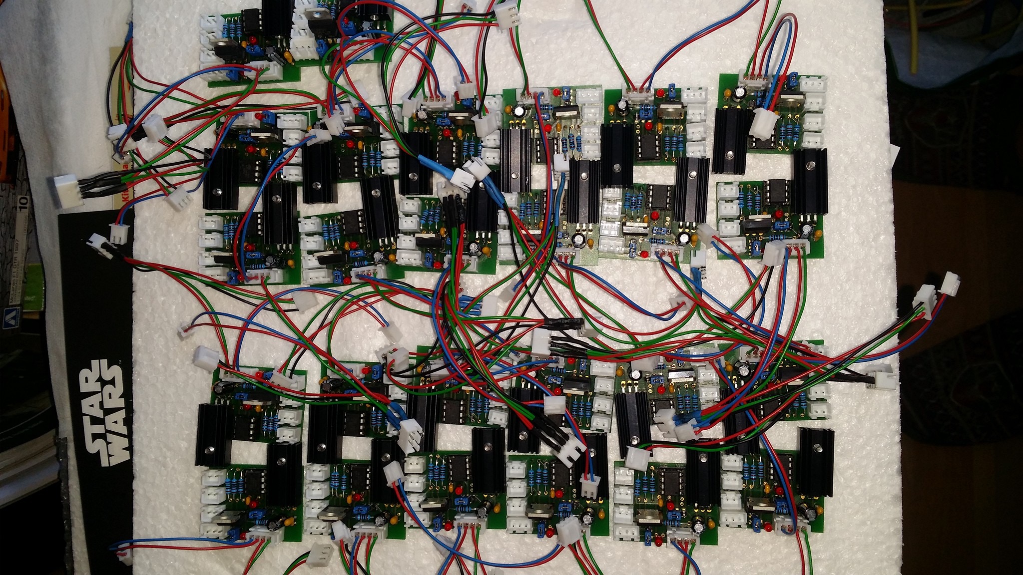

All sold ? ... when , how ? Do you plan to make anymore ? How many , and for how much ? . Your post #64 - I'm interested in this product ( not the Optional extra version ) .
Are these the boards posted in #66 ? .
Please clarify if possible . Thanks .

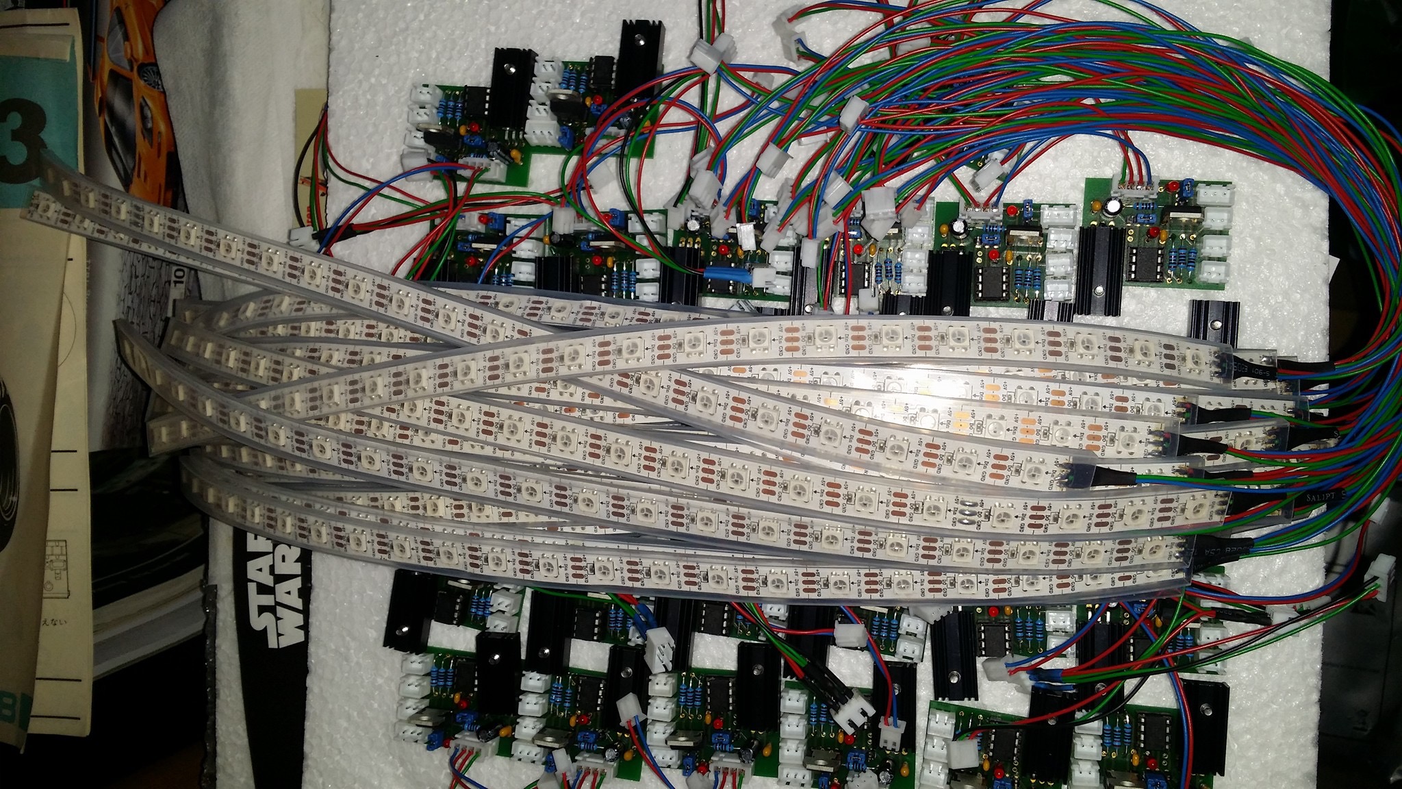

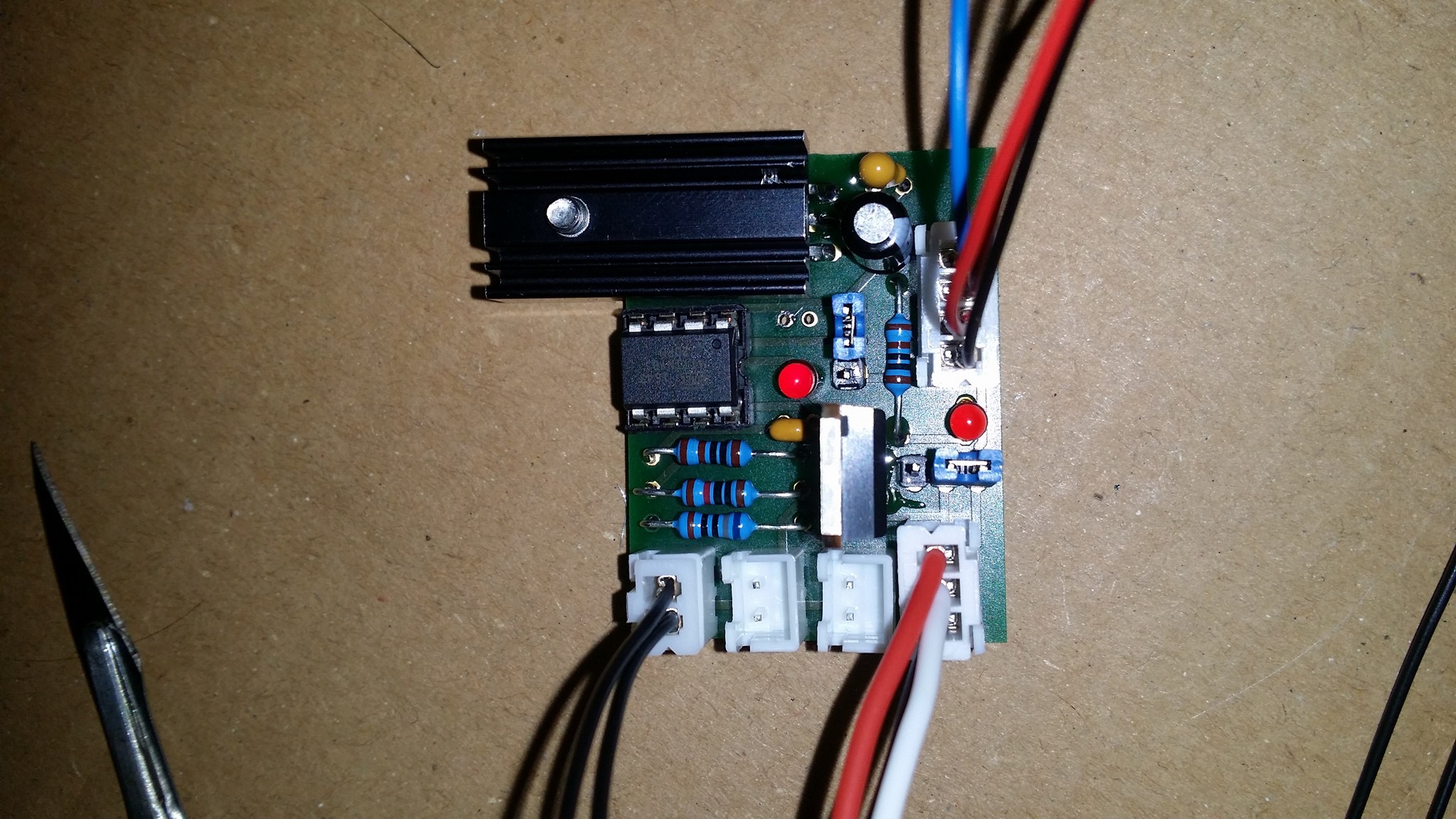

No, the boards in #66 provides only a flickering engine light and 3 additional connections with 5A max. Current for additional light.
The deAgo replacement board will come end of october - stay tuned, i will post updates here.

works with the 9V power supply and with battery also, the cable provided in Issue 57 is also used.
it is possible to select the voltage on each of the light port separate - voltage of power supply or 5 Volt by jumper.

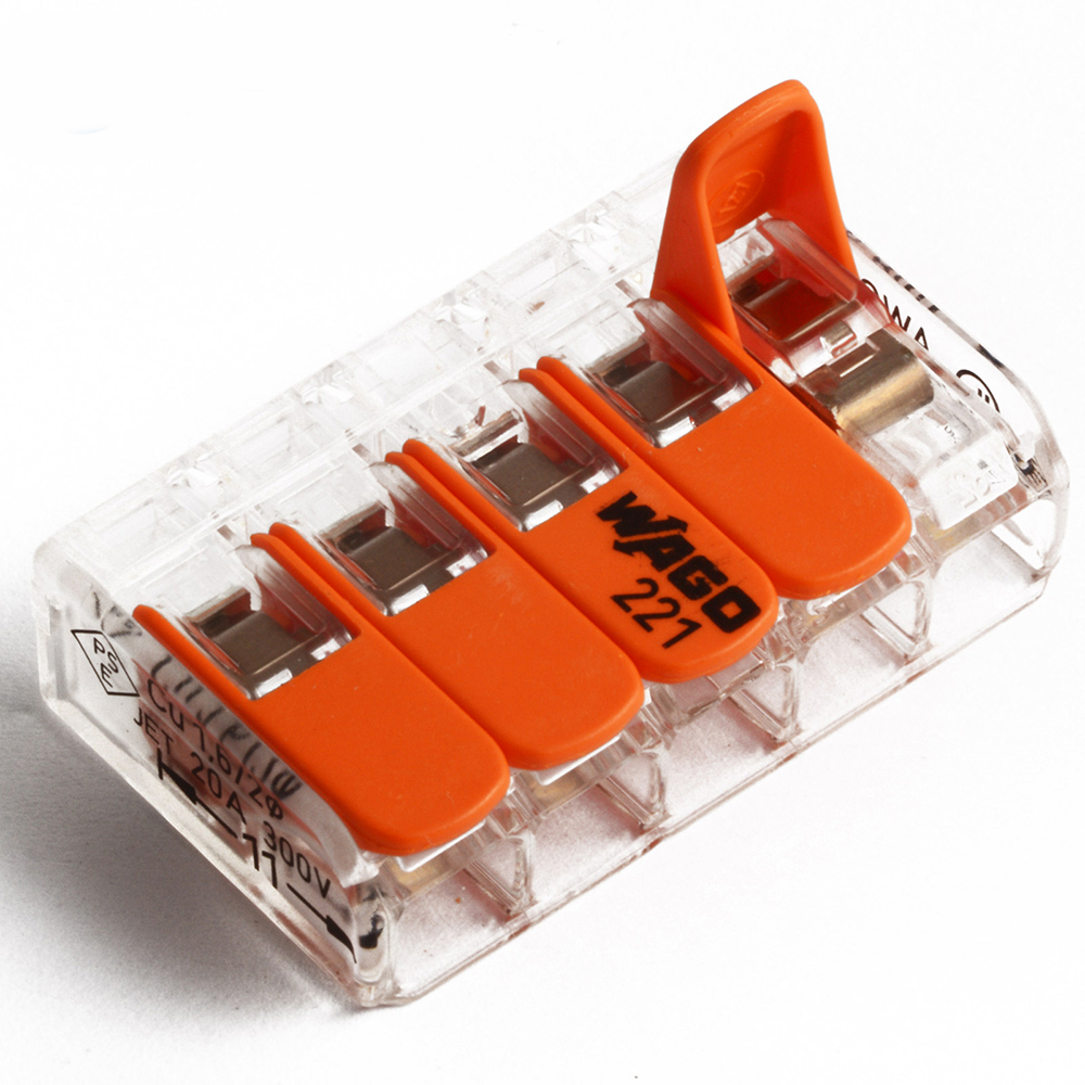

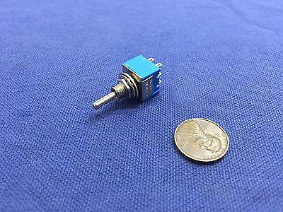

I've considered ditching the stock control board and remote altogether because I've already had one control board fail on me. One solution I found was the Wago 221 wire connector (pictured below). You could simply run the positive and negative wires from the switch into two of these within the Falcon. Then cut the plug connectors off the LED wires, strip, and insert the wire ends into the Wagos. All positive leads into one connector, and all negative leads into the other. As for the ramp, it could be wired to a well concealed momentary mini toggle switch (on) off (on) and installed somewhere on the ship. Hold the switch down until the ramp lowers, and hold the switch up until it retracts.
No remote. No control board. No worries.
No ramp and no landing lights.
Used the landing light ports for extra cockpit and turret Leds. I cut out the landing gear pressure switch and spliced the wires together.
View attachment 754531View attachment 754533
Thanks, that sounds just what I need.
Don't need a ramp switch so this should work great. Just ordered some from Amazon.
