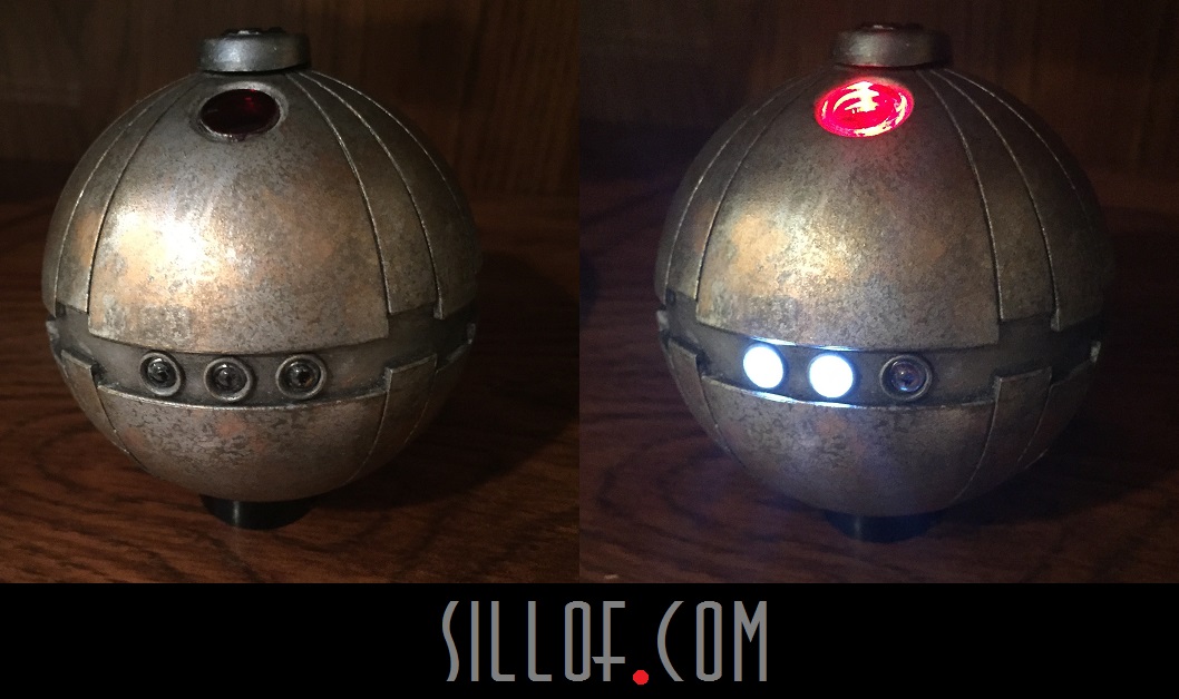

THERMAL DETONATOR
Nothing too original here. I was actually at Disney at the first Star Wars weekend when they sold this. I bought a few immediately with the same idea everyone else has had. I painted it with a base of silver, misted a gunmetal, sponged on rust and brown, did a black wash and then used 3 different rub n buff colors. I masked off the electronics so it still works. Of course the hot potato game was under $10.

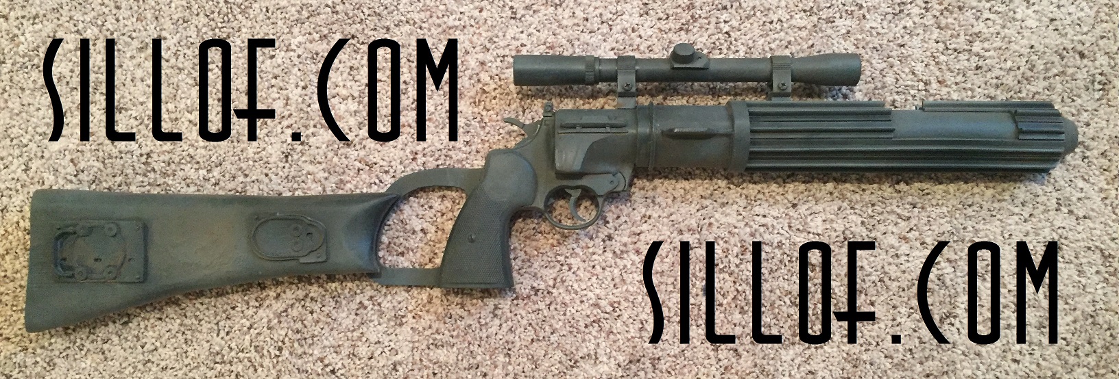

My ESB was actually built before the above ROTJ. Excuse the poor quality of the pics they were taken about 7 years ago with the cameras of the day.
an old crosman 357 (alreadyhad the gun and thought it look like a webley - it even breaks open at the samepoint) with various pvc parts for a barrel.
boba-fett-esb-blaster-budget-build-esb2-jpg-52082d1302006484
a 10$ tasco scope which I thought had a passable resemblance to the movie scope.
boba-fett-esb-blaster-budget-build-esb5-jpg-52079d1302006474
Scrap wood reworked on a belt sander.
boba-fett-esb-blaster-budget-build-esb1-jpg-52080d1302006478
medium stain - no varnish - actually used a semigloss model top coat.
boba-fett-esb-blaster-budget-build-esb6-jpg-52084d1302006490
Apoxie sculpted the detail and made the stalk armout of plexiglass.
boba-fett-esb-blaster-budget-build-esb3-jpg-52083d1302006487
the Revell part is actually 2 pieces of plexi cutout and glued on a cap.
boba-fett-esb-blaster-budget-build-esb4-jpg-52081d1302006481
I picked up a junk 2 cell heiland on ebay for a steal, bought some resin greeblies, and had an old small belt for the strap.
The total cost of the entire gun is under 30$
