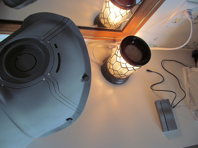

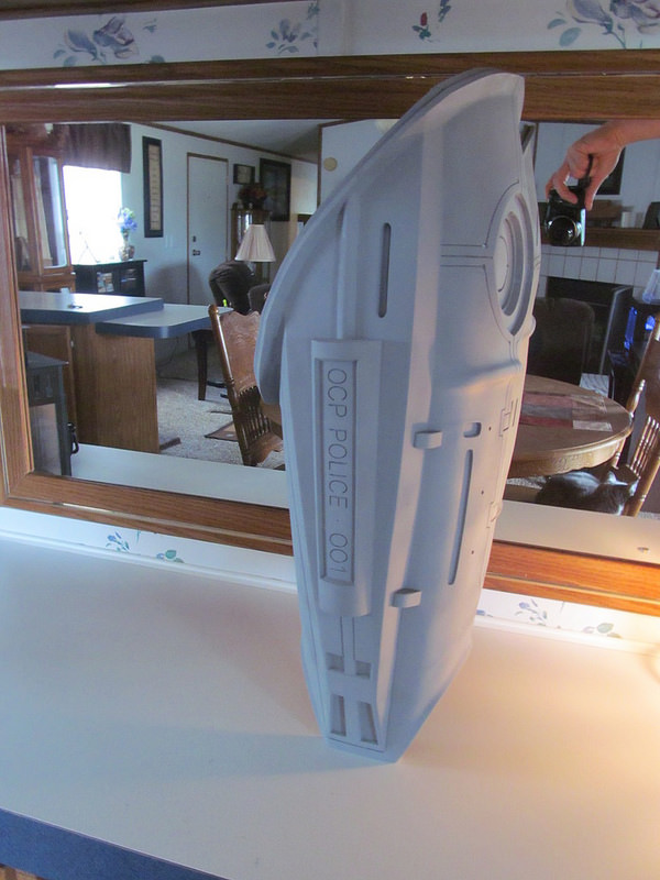

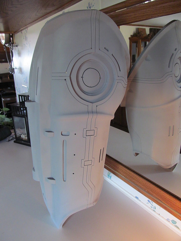

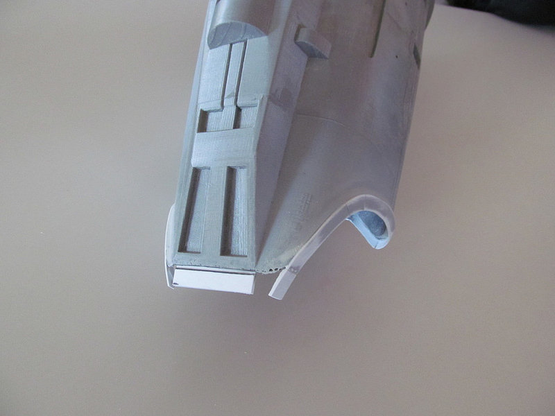

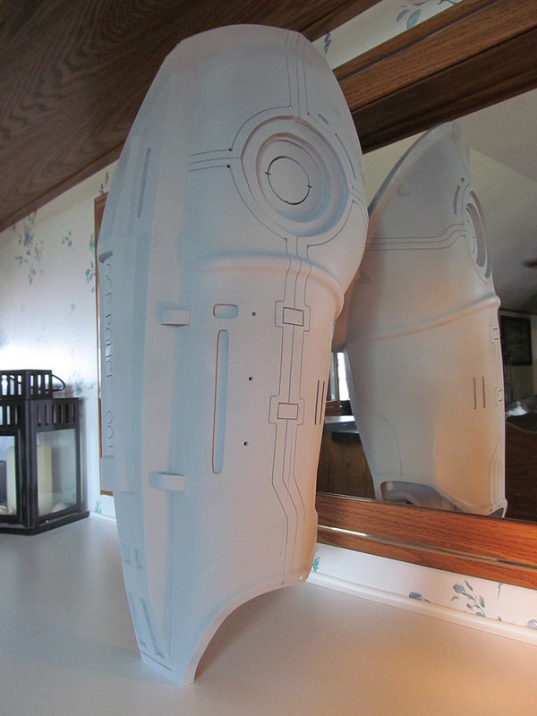

Thank you again guys for your support. I went ahead and decided to tackle the left arm. I figured I would take on the hardest part first. This I believed was going to be the hardest part of the suit to modify and straighten out to look a lot more like what you see on screen and I was definitely right. This was a really hard piece to work on, it was missing tons of detail compared to the other parts of the suit. Pretty much all the lines, vents, etc... were just not there. The model had holes in it, jagged lines, bad geometry etc... So I basically de-mantled the whole entire piece once printed and used it as a base to add in all the detail i desired. All the pieces that were removed were built from scratch using styrene.
It's still not completely finished, i still need to add in the screw detail, a couple other details, and give it another sanding or two but for the most part I think it looks pretty awesome. Enjoy,.....
More to come. I'm doing all the heavy modifications first on every piece of armor, then I'll be fiberglassing everything. After fiberglassing I'll go ahead and do all the major body work, make it wearable and then paint.

Wow, so all those lines/gaps/circles aren't actually lines in the print, they're gaps between sheets of styrene? Amazing work.
Re: 3D printed Robocop suit 1987 build
Thanks, sounds about right. Each line was tediously drilled out with a small bit, compromising the integrity of the print. After each line was drilled out all the lines were filed smoothed with needle files, then backed with styrene. Some of the areas were resculpted with sculpting putty. What you see in the pics has taken me over a week to do and its still unfinished. It's definitely not for the faint at heart but if you want decent lines there really isn't any other way around it. Using a dremel cutting disc is definitely a NO-GO for nice lines in a 3D print atleast for a piece as intricate as this one.

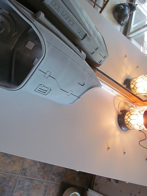

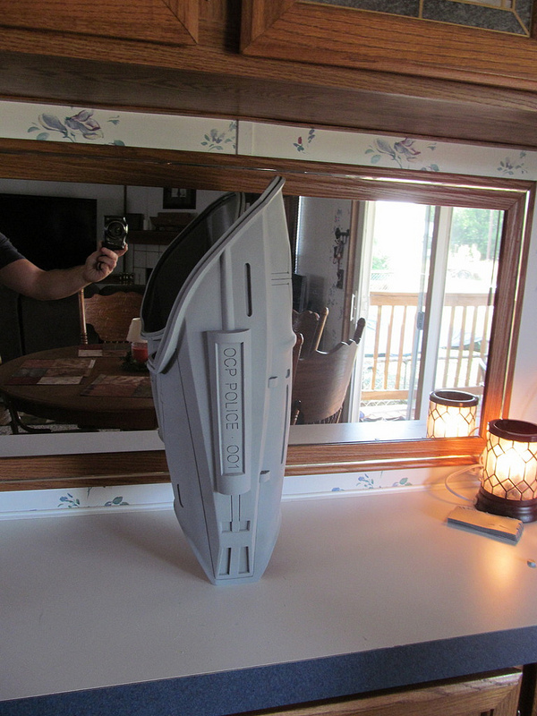

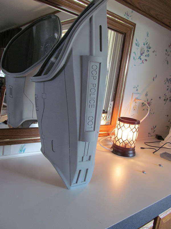

Here's the progress of the modifications on the left leg. It needed quite a bit of work. I felt the legs were going to be the next hardest piece to modify so I went ahead and went to work on the left leg. The model was missing quite a bit of details and had a funny big lip on the end of the leg near the knee. I went ahead and removed the lip and rebuilt it to more closely match the screen used leg.
It still needs quite a bit of smoothing and body work but the major modifications are done at this point. It also still needs the screw detail added in but I'll probably do all the screw detail last on all the pieces once everything is done.

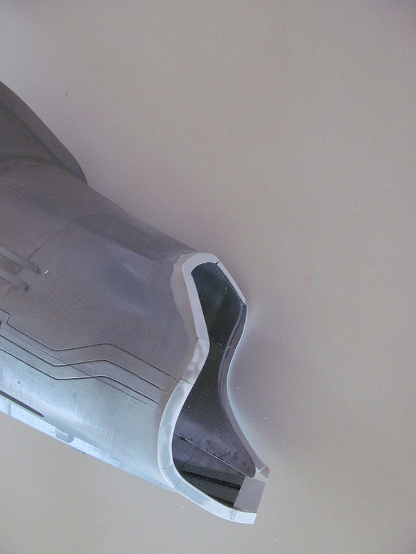

It's been over 7 months now and I'm nowhere near done. I'm closer but still have quite a bit of work. Here is the left cuff with it's finished modifications,
