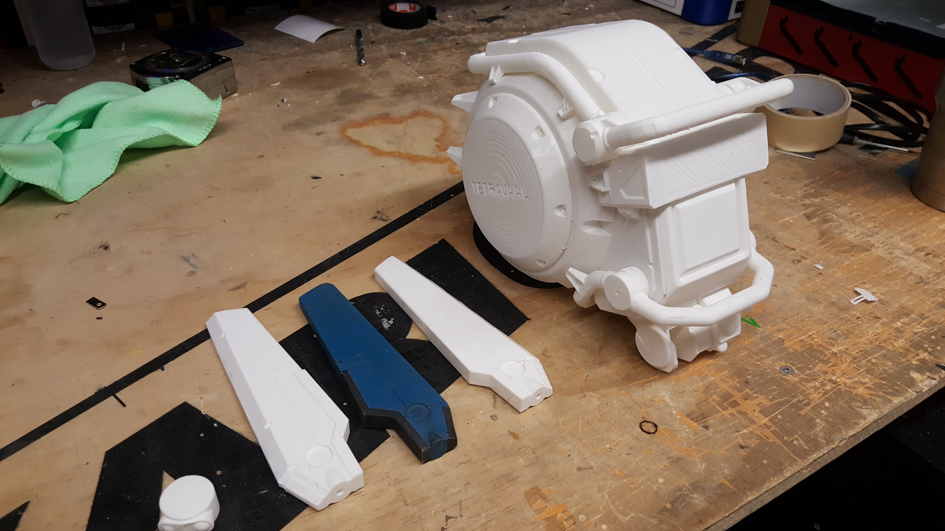

Assembled and painted head. Still needs more work and of course animatronics along with torso. And I know there are some small details not right, for example the orange ear is on the wrong side, that was my bad painting the wrong ear orange before assembly.

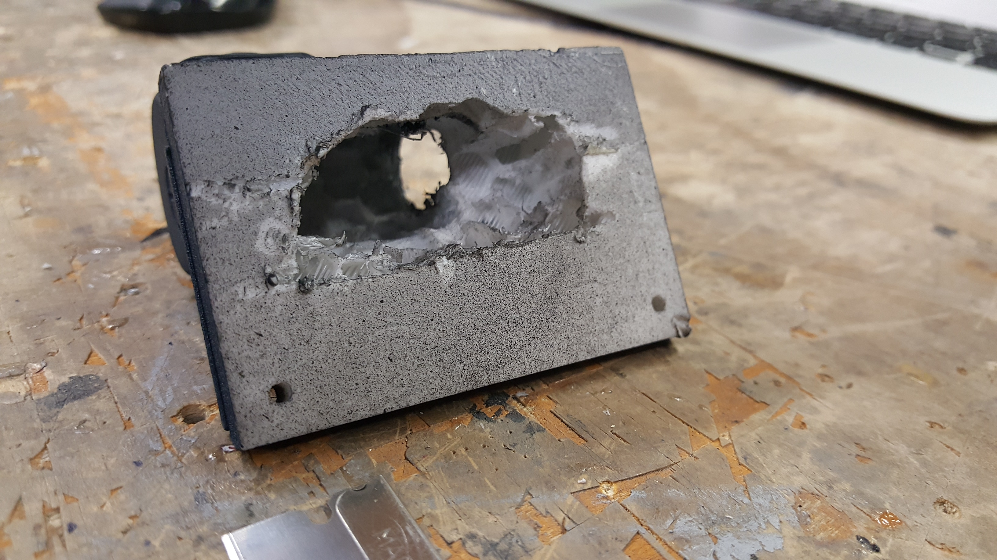

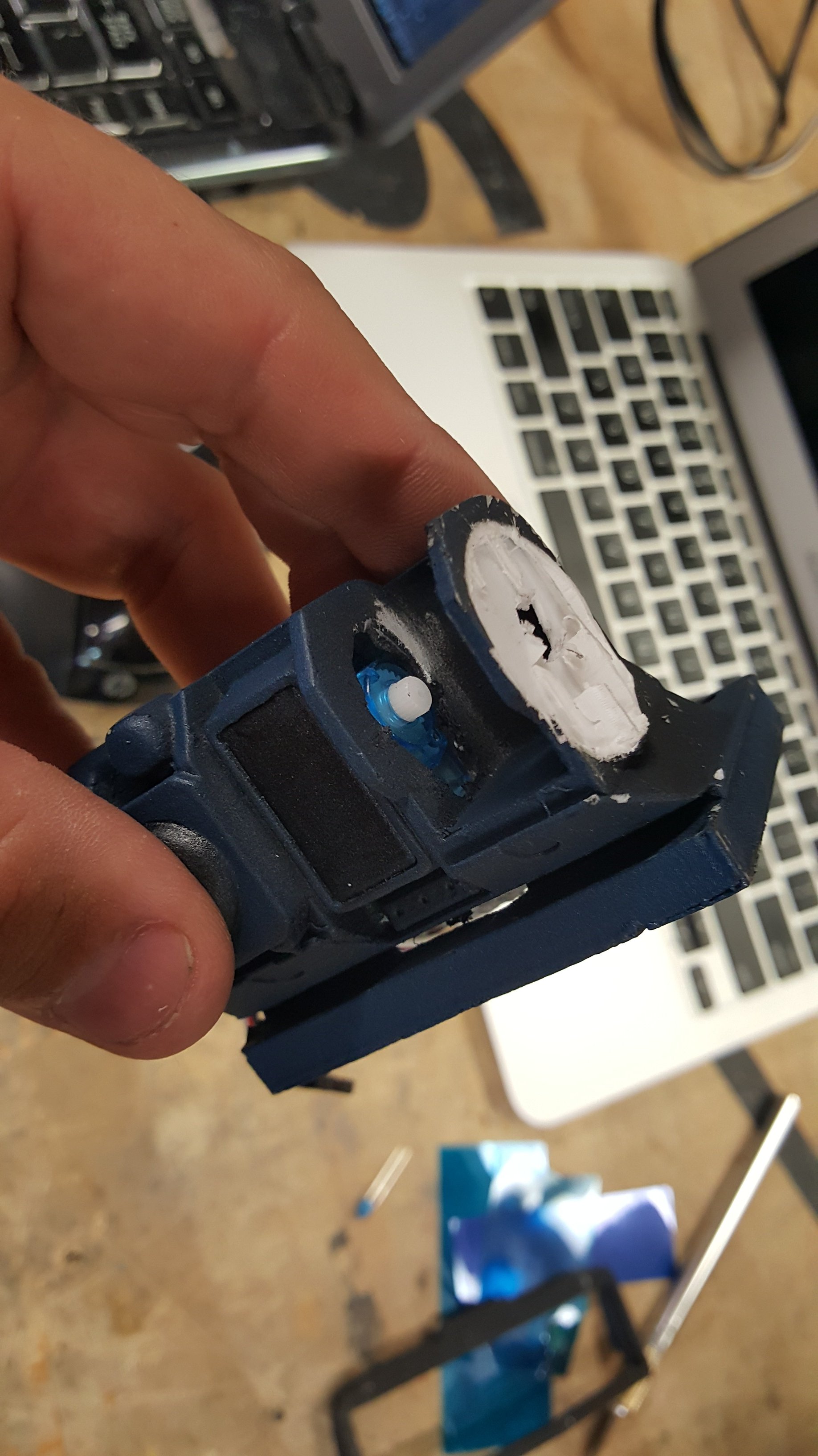

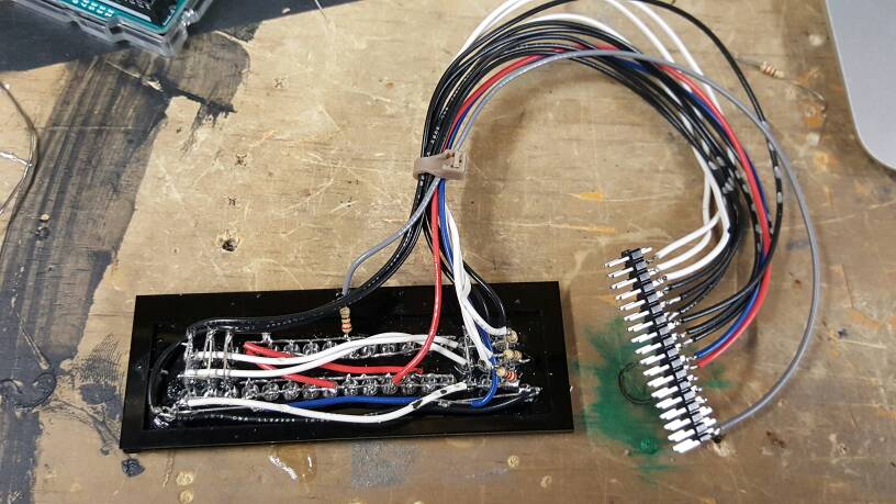

Ok guys here is todays update.... I have added Chappie's Eye LEDs, The three LEDs above the camera and sensors and also a servo for the camera. Here is a quick video.

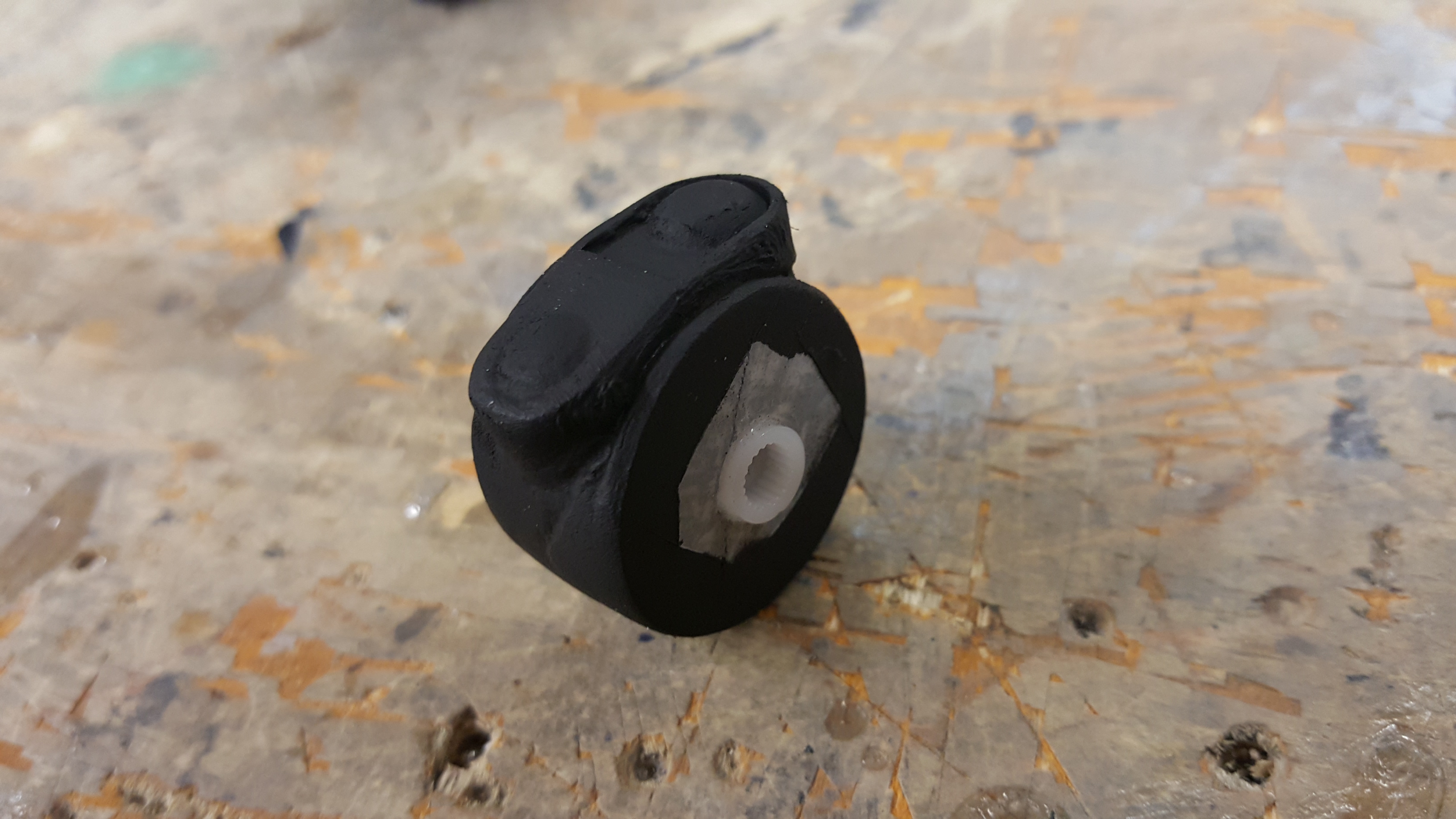

Now Here are some photos of the build from today. For the servo, I had to hollow out the 3D printed main body for the sensors. I did not design these files, so it wasnt easy for me to edit them. So I just went in and did it manually, which I have actually found quite fun. I had to split the camera in half to glue in the servo arm, then had to glue that back together. Then I secured it to the servo through a hole I covered up on the opposite side. I hope that makes sense? The photos speak louder than words..

And here is the led eyes I came up with. Sorry the is the only photo I had of them, they were a pain. And yes I know I have one LED out.

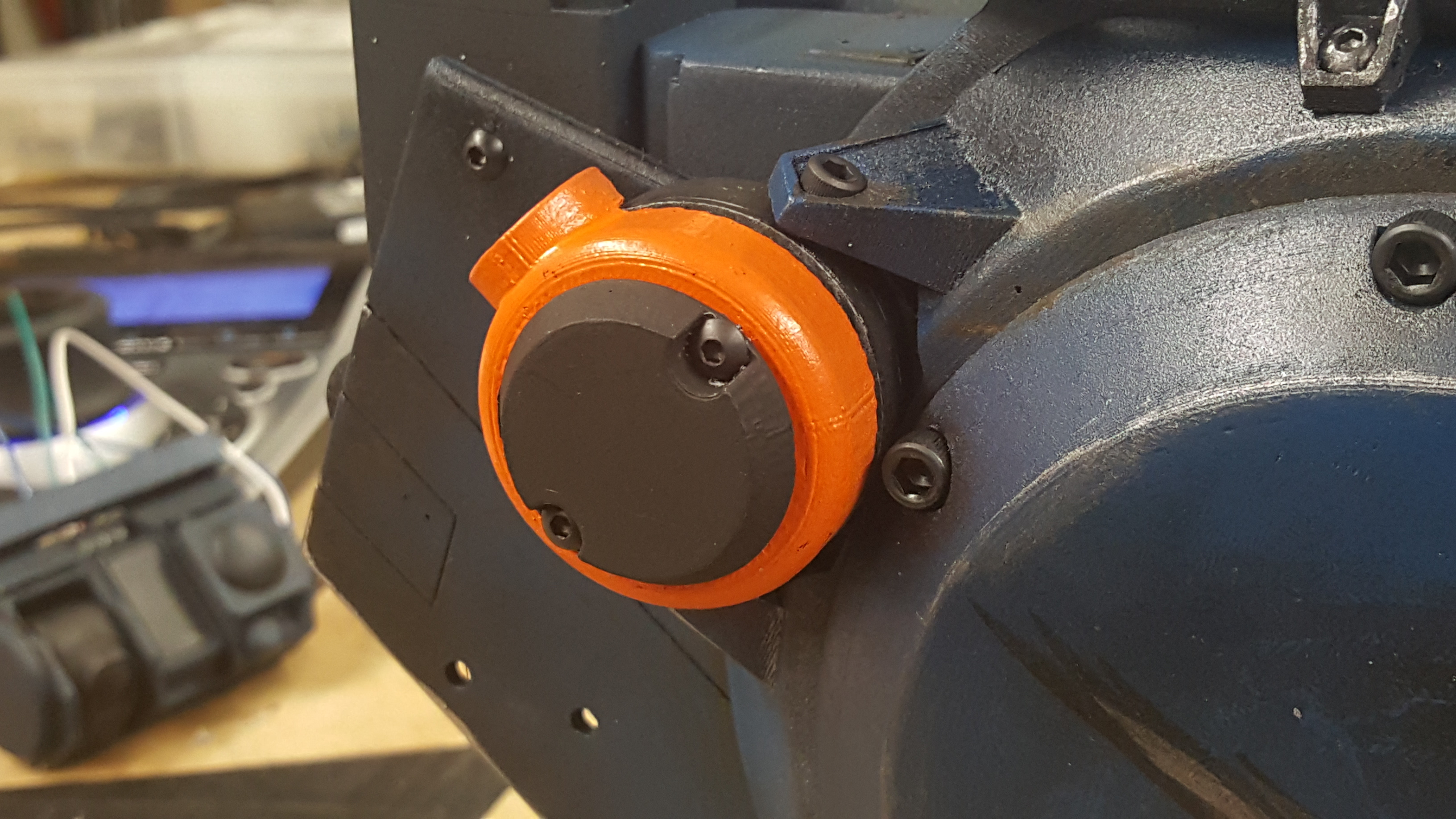

Ok, here is todays update.. I got the Ears/Lip/ and Eyebrow servos installed. I had some cheap 9G microservos laying around, But I am not happy with their performance, plan on ordering some stronger ones soon. But, that being said, you can see the mechanics of how it is going to work.
Here is how I mechanized the ears..

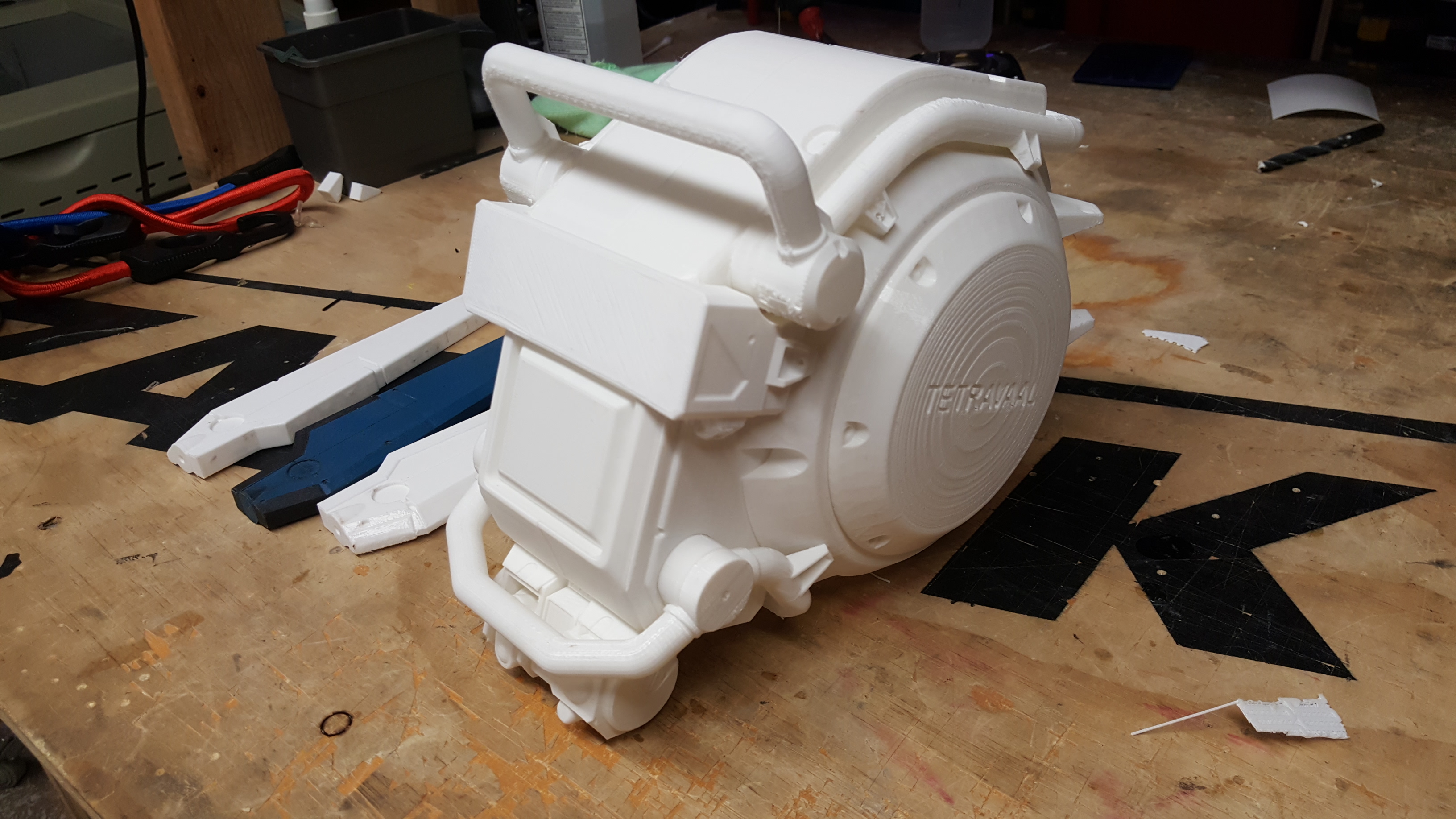

I also need some help finding what hoses these are on Chappie. There is two on either side that run between the head and the body. Here is a couple photos. Any help is appreciated.
