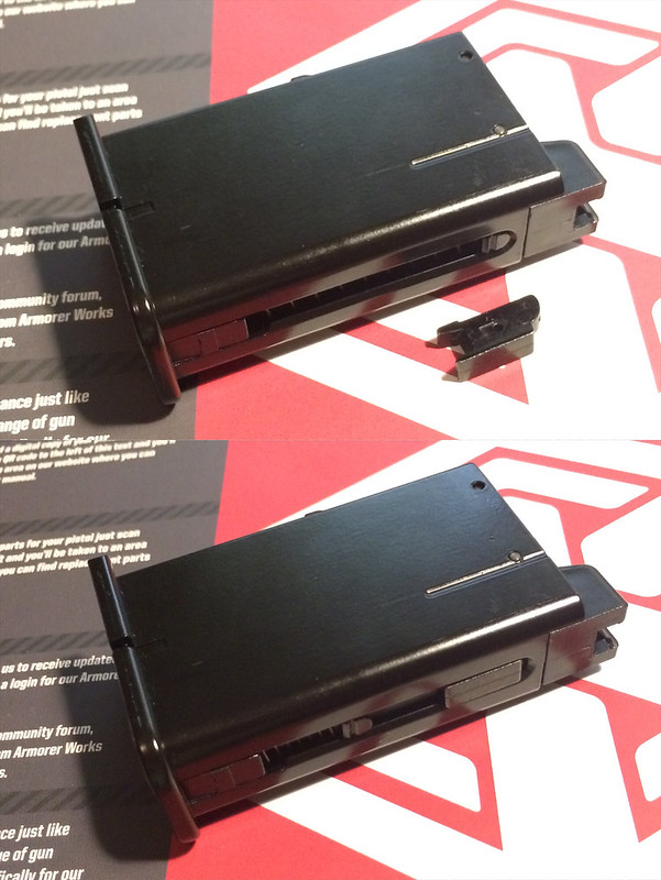

Does anyone recognize the extra piece in the bag with the lanyard ring? No clue what it's for.
That did the trick. I have no idea what that extra bit is for.
Figured out what the extra bit is for! I messaged the company and they said the part was meant to allow the airsoft to function without using BBs, though they weren't clear how. Fiddled with it a bit and it looks like it pretty much just prevents the bolt from locking open when out of BBs:
So, it's an easy conversion from BB gun to "hero" prop. Good for fan films and the like :)
