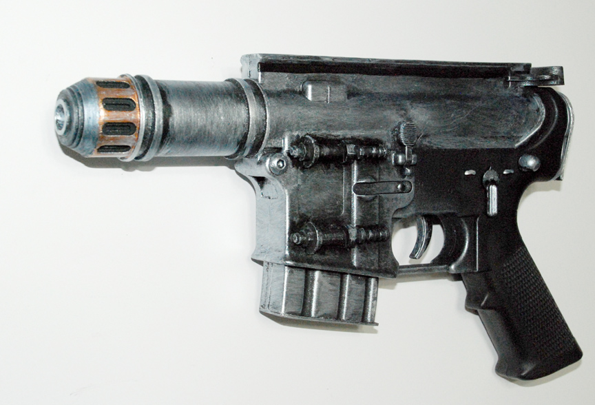

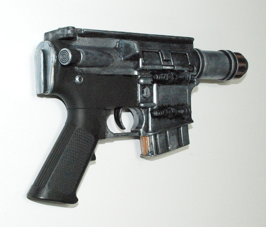

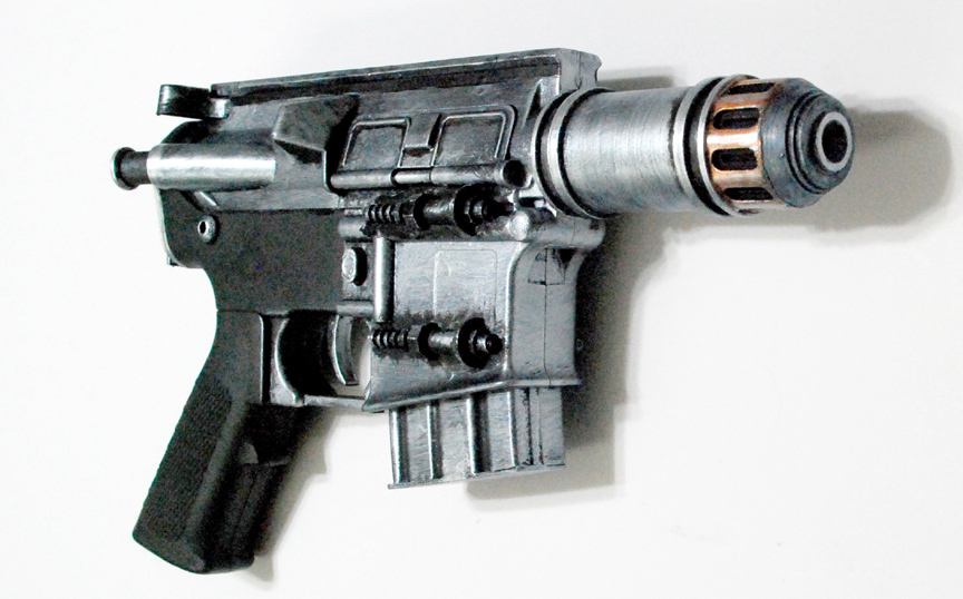

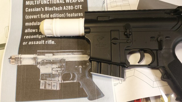

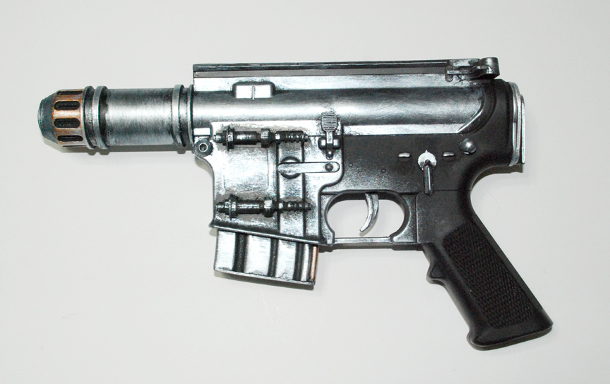

I was asked to work on this blaster too, as Legendary Costume works (my leather people) want to make holsters for Cassian as well as Jyn. Comments and Critiques please, I'm trying to get it as accurate as I can.
20170109_221523 by Mal Keller, on Flickr
https://c6.staticflickr.com/1/356/32104937621_ea74fb8313_z.jpg20170109_221523 by Mal Keller, on Flickr
Looks great Wondersquid. Is that a resin cast off of a custom sculpt for the barrel? Or what material did you use?
The vents on the tip are well defined. That seemed like the hardest part to me.
Thanks Faroth, I cast resin pieces, then machined them to make the tip. It's in 3 parts, the main barrel is lathed, the very tip cnced, and the vent detail was actually cut flat, then cast and rolled to create the shape. Tricky, but worth it to get something I feel is accurate.
Sent from my SCH-I545 using Tapatalk
Nice. I did a low tech version of what you did. I 3D printed the tip with a 10 sided flat surface and the vents. Then bolted it to a drill and sanded it down to a smooth cylinder.
Speaking of which, is that the number you came up with for how many side vents to use? 10?
I did, but when I wrapped it, the diameter was off, so I have 9 vents, it's weird, but it looks like it might be right.

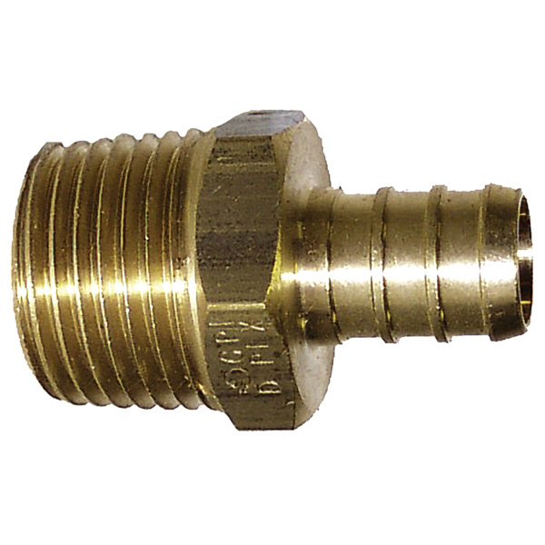

What did you use for the screw looking detail?
Do you mean the four pieces laying on the side? I ended up making a 3D model of them and printing them.

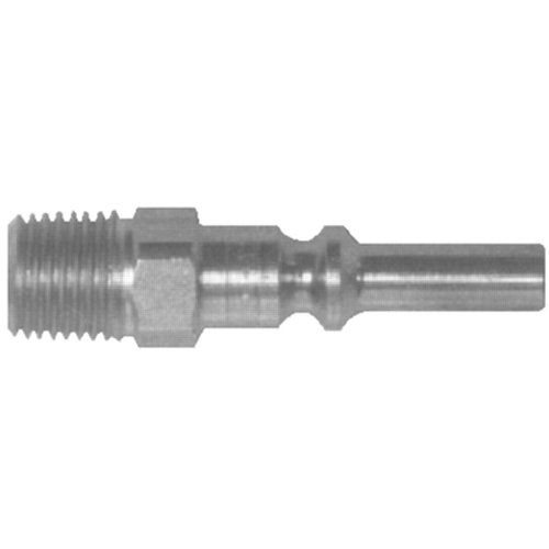

They are some sort of PEX air hose adapter. like this.
However I can not find the exact right type or size. Ones I have found only go down to about 1/2 inch. This is more like 1/8 inch. Also, maybe this is something metric only found in London.

Yeah, I know those parts are easily accessible out there somewhere, but finding the exact right pieces will be hard. They use the same type of pieces for some costume bits and kind of bullets on a belt. I also saw them in the movie painted silver, on the console that they have to pull the main switch on. Some prop guy must have had a bunch of these things lying around and wanted to work them into props.

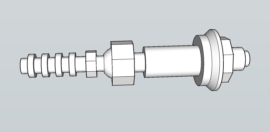

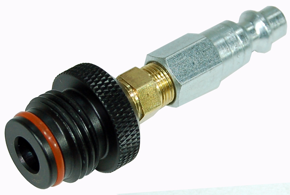

I am now convinced that the side detail parts are some sort of High Pressure Air Adapter for airsoft guns. It would be something they had easy access to with all the airsoft guns they were using. If you look at the 3D drawing below, the left part with the four bumps is the part the hose would get crimped onto. Then there is a slide part to incert the tip on teh right, and a nut to tighten it once the airhose adapter is connected.
I still have not found the exact right part though.
WE-HPA-Adaptor-Valve-for-Gas-Magazine.jpgYou are on the right track! Ive been looking all day. It looks just like this WE HPA Adaptor valve for gas magazine in and airsoft gun. I feel like its just about finding the right brand of weapon. Ill keep looking,
