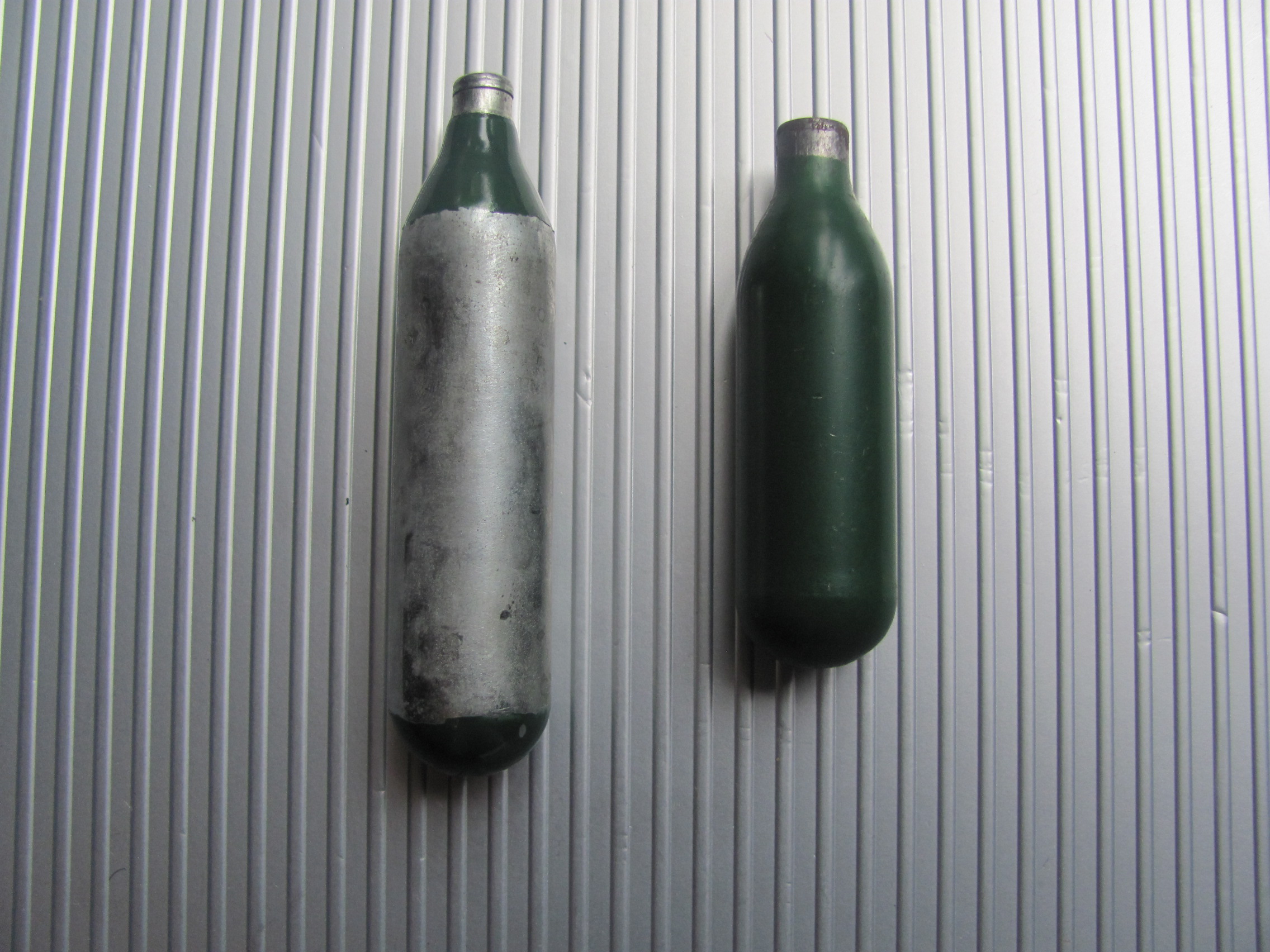

I was surprised to see the size difference

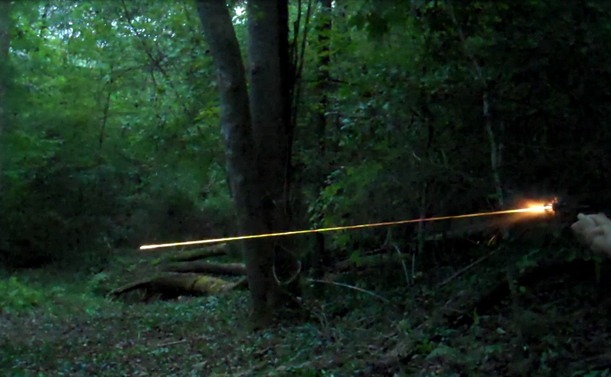

Meanwhile- tracer update. I loaded up some tracers and tried them out. They feed, cycle and work! They are not as bright as the 9mm tracers. The 9mm bullet is a little bigger so there is more surface area at the base of the bullet. The .30 tracer also tapers like a boat tail bullet so it makes the burning surface smaller as well.
For your viewing pleasure...
.30 Mauser
