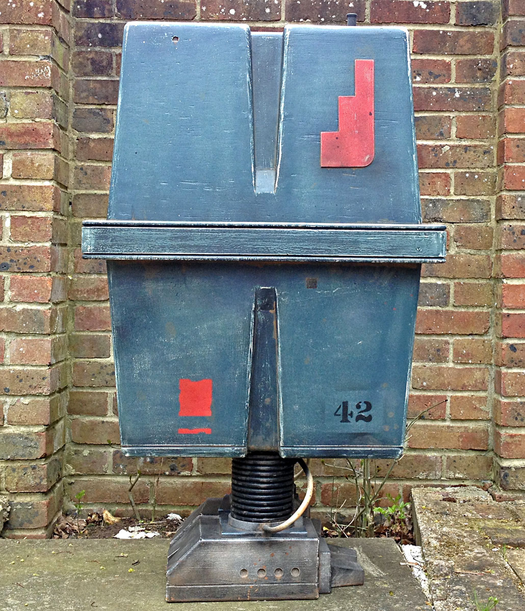

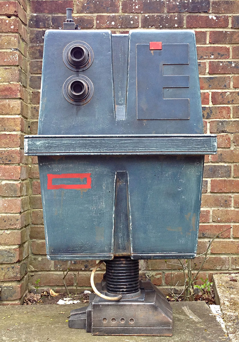

wicked build!! I actually have the first pic saved on my computer from google searches!

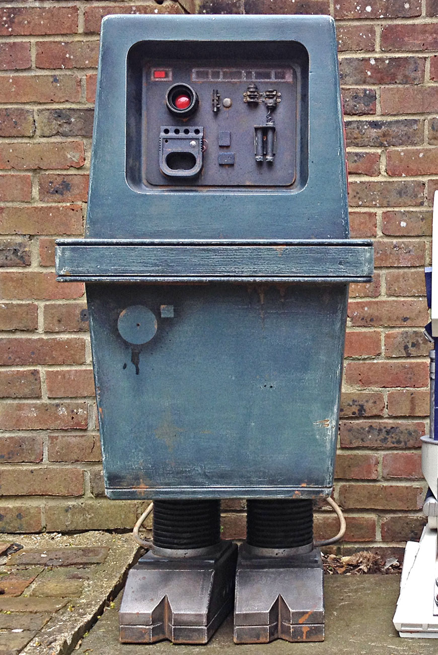

quick question, did u fill the feet with cement? I was curious how top heavy it is? seeing you use yours for storage you must have figured out a solid trick!
your GONK is the best I've ever seen!

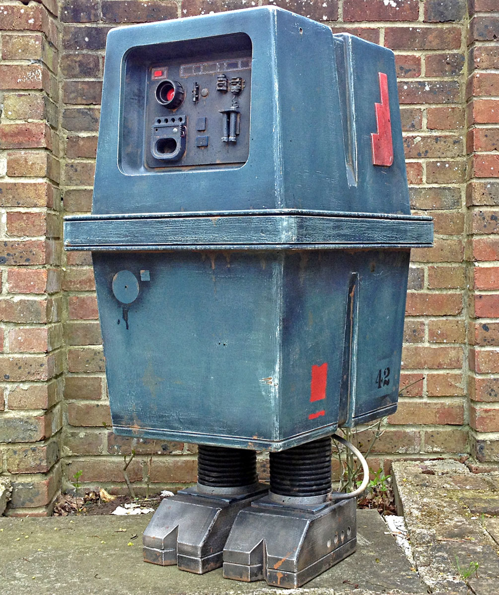

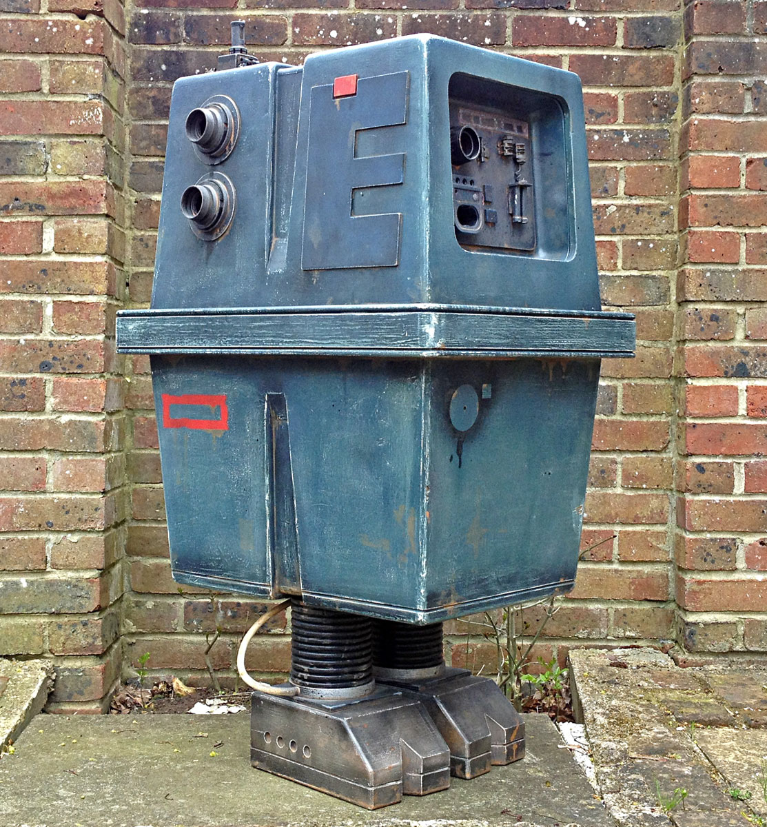

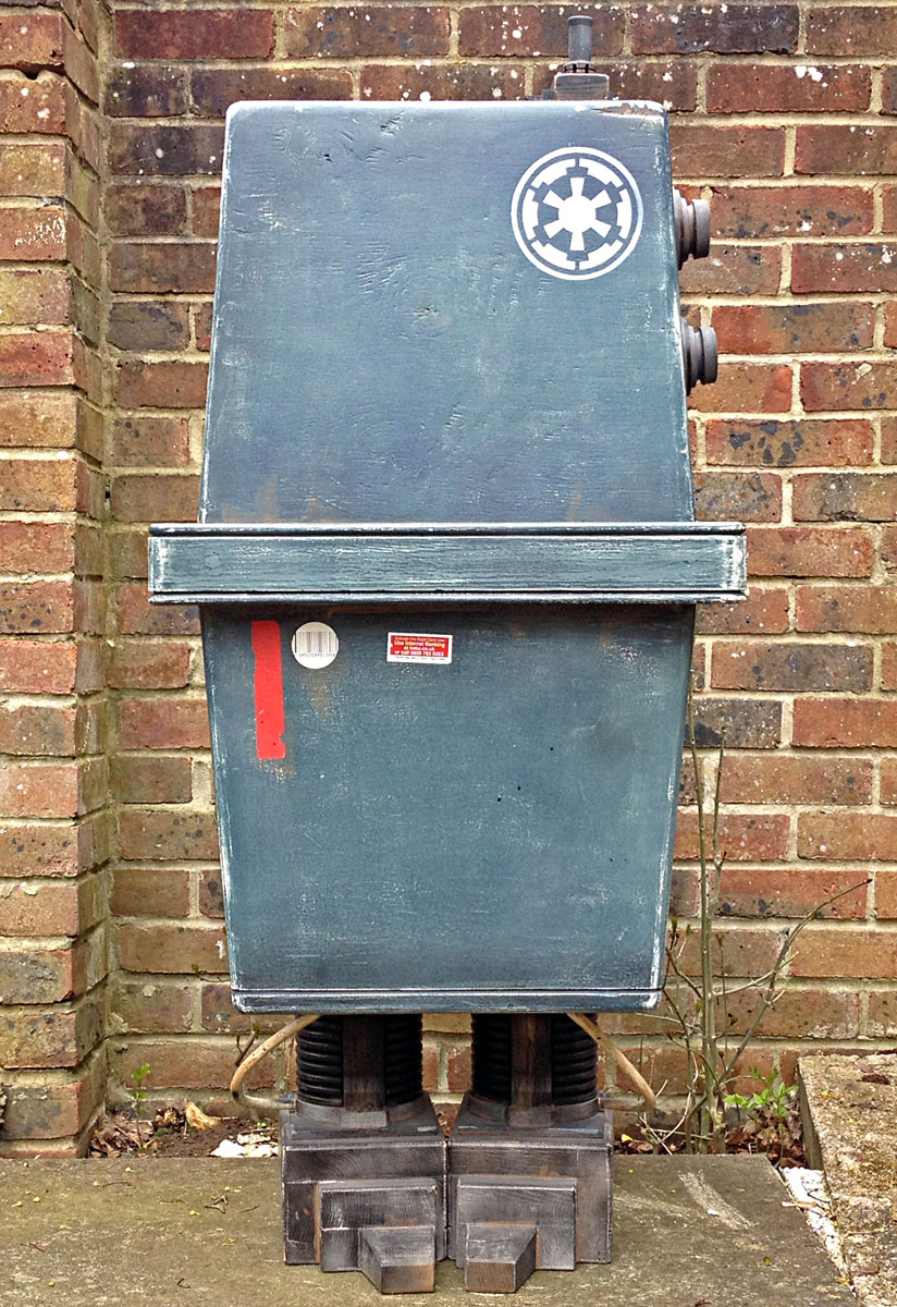

The feet are solid oak, which is quite heavy, they also have a little bit more that sticks out the back for added stability that you can't see, I'll post pics of that later
Turnaround
The foot detail showing the stabilisers
You can still see a lot of the woodgrain but its ok as it's so scruffy.

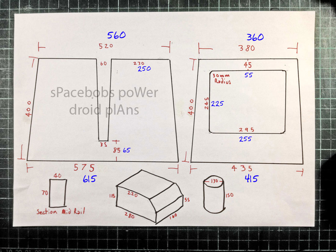

Ok I've had a few people asking for permission to use the plans, and of course you can use the plans,
the unwritten rule is you simply give credit where credit is due, especially online, and if you were to use others plans to make money you would at least fess up to whom it may concern.
Although the proportions on these plans have a lovely look and I'm more than happy for the spacebob gonk to multiply, please remember that the dimensions that I gave are for mine, I have tried to workout how big the real things are but in the end I said it should be just shorter than my artoo (I gave up).
Then I made it a little wider to accommodate the records.
To make it more accurate I would make the overall width narrower, or, make it taller and longer while leaving the width.The hole in the front of mine is too large (if you intend to run a lip around the edge).
I'm working on screen accurate numbers if you wanted to wait otherwise, go for it :)
I like as is... a mix of Toy and Flick.

Here are updated plans with the "more" screen accurate numbers in blue, Cute Spacebob Gonk numbers to fit records in red still. Behold.
Remember the front and back screw to the edges of the sides for this to work right :)
thanks for the update! i just recently converted your older plans from mm to imperial then rounded up or down to the closet fraction. i plan on starting this next weekend
That's why I wanted to get the new numbers out there, because so many people are saying they are starting soon.
Now there is a choice to try to make the size you want.
