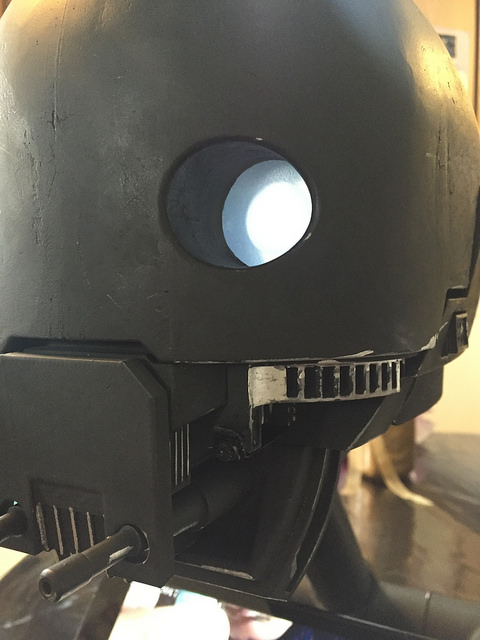

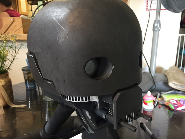

After 12 hours or so I believed the glue had set for the connecting platform in the head. It "snapped" perfectly onto the pan/tilt and aligned with the magnets. Just enough pull force to hold it in place but still removable.

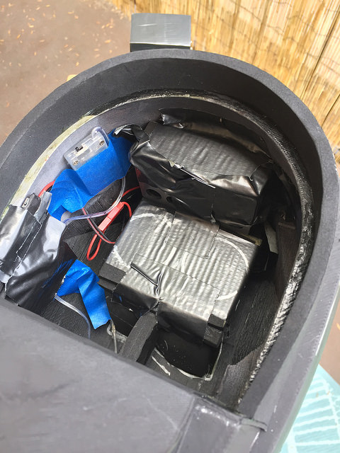

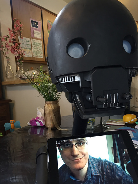

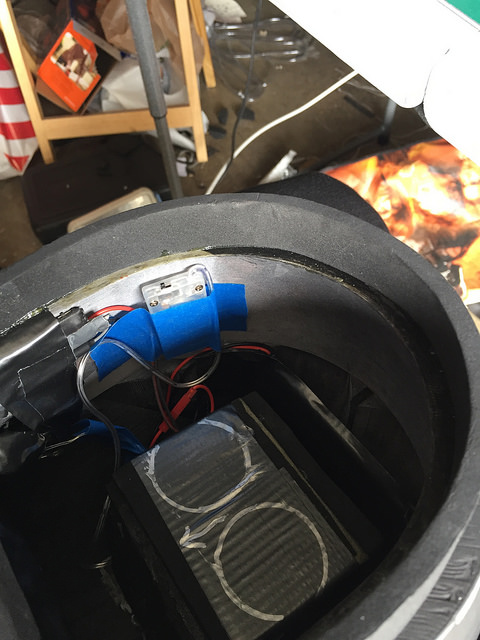

His head is getting full of wires. Beneath the blue tape is the switch for the eye LEDs.

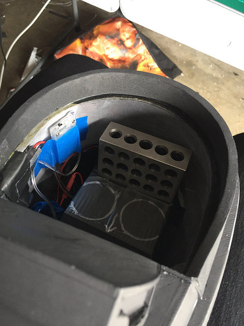

I discovered that the head wouldn't tilt up. There was too much weight in the front. Solution, place my heavy 123 block in the back of the head as a counterweight. This worked great and moved the center of gravity over the pan/tilt.
Securing the 123 block. I kept all of the batteries in the head now to use their weight for balance.
Fired up the POV camera for the first time since sanding/painting and it survived! The field of view is mostly clear with only a little bit of the left tusk showing in the corner.
Really happy with how the weathering is coming along. Here you can see the POV camera, but most people probably won't catch it.
His eyes look great even when they are off.

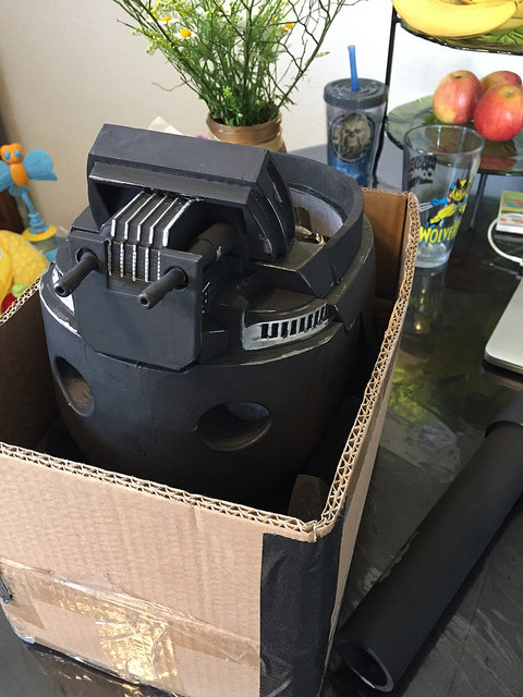

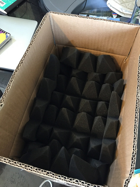

Made a foam filled box for transporting his head. I don't want to leave it on the pan/tilt when not powered so I don't accidentally damage the servos.
Box head.
I am so happy the magnets work as intended. He can pan/tilt, it's a slow movement but better than a static neck.

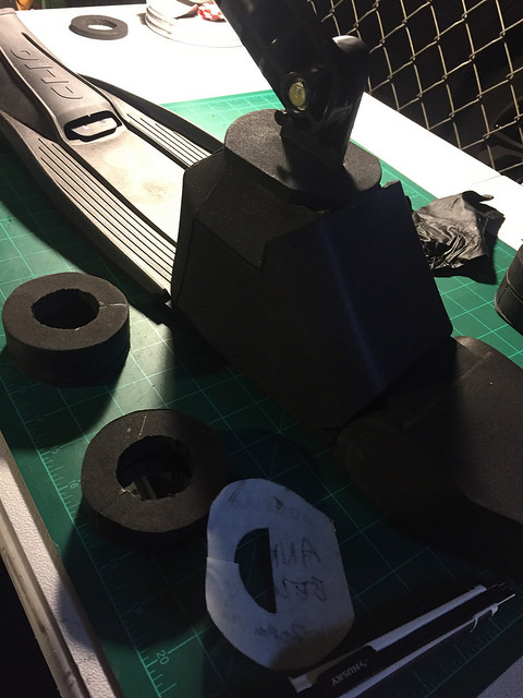

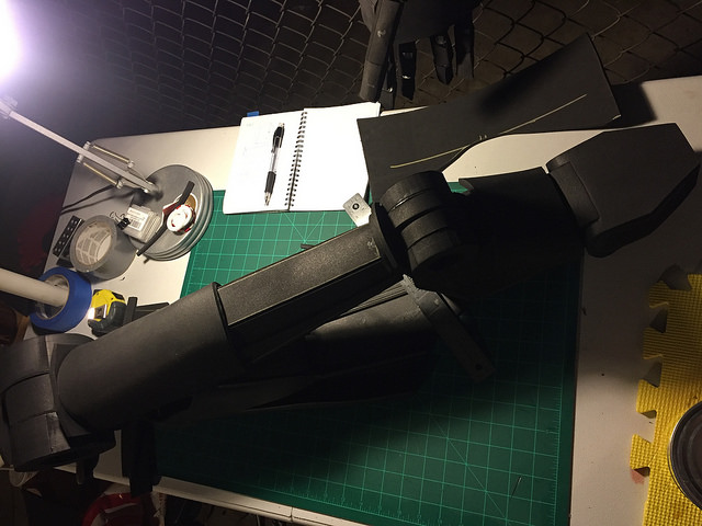

A few hours of work tonight. It's LEG DAY for K2. Not much room on my table but it worked.
Pulled out my foot top template to cut for the ankle.
Thats why templates are good, you can reuse them and not reinvent everything.

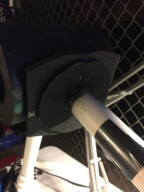

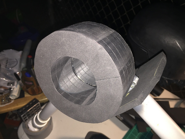

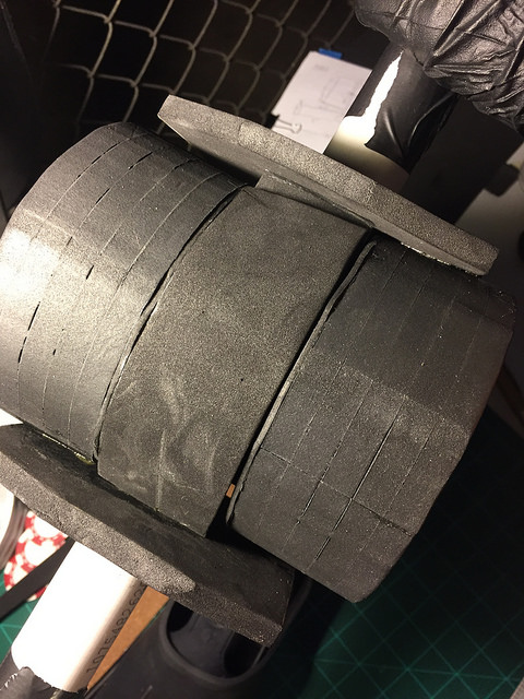

The two joining pieces. Ready for the puck rings.

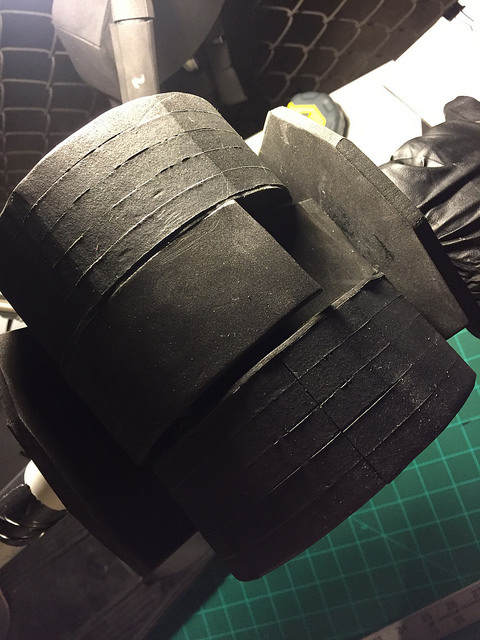

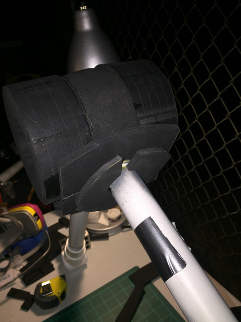

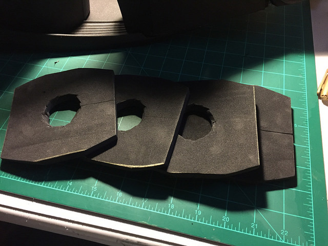

Went together just like the elbow. Glued in two 2cm strips in the middle to close up that space.I'll replicate this technique on the elbows tomorrow.
Sketched out the knee joint plates.

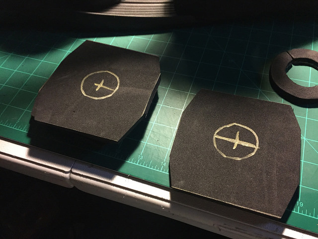

Found the center of these 12cm x 12cm pieces.
Ready to be glued onto the leg.
Again I love how the angles come together on this build. The pieces fit great and don't smash into each-other with the stops in place.
Nice big knee joint.

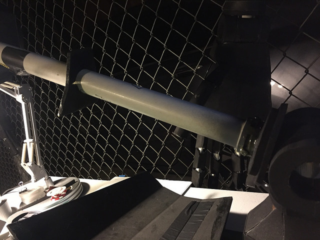

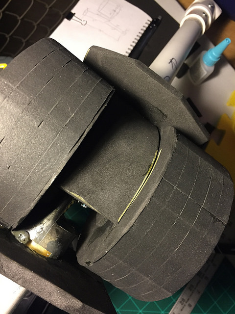

For the front of the knee I hit a problem. The pvc spider joint wouldn't let me use the same technique as the ankle and elbow as this center strip would not pass by the pipe connector area. So I glued a 4.5cm strip down to one puck but a few cm in from the outer edge.
Then the next strip on the other side was against the outer edge. Since the knee locks straight and only bends one way this works.
When the knee is bent there is a small gap but a piece of foam is on the inside.
The back of the knees aren't great. I may try to replicate the front overlap. But this part gets squished a lot when the joint bends. I think some black paint will help hide most of this mess.

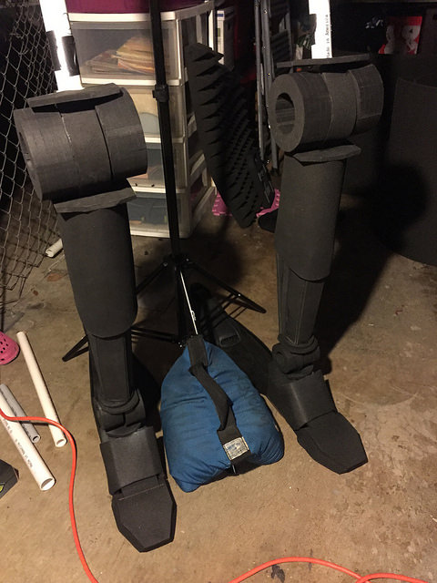

He looks super spindly without his outer skin on the legs.
Right leg joints are done. The left should follow quickly as the design portion is already done. The outer skin will be 18" long and go from a 3" circle at the foot to a 4" circle at the knee.

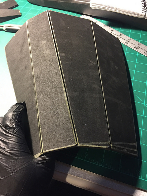

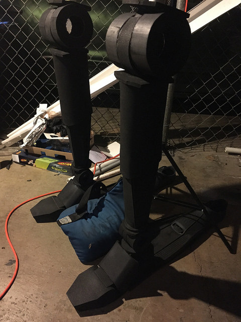

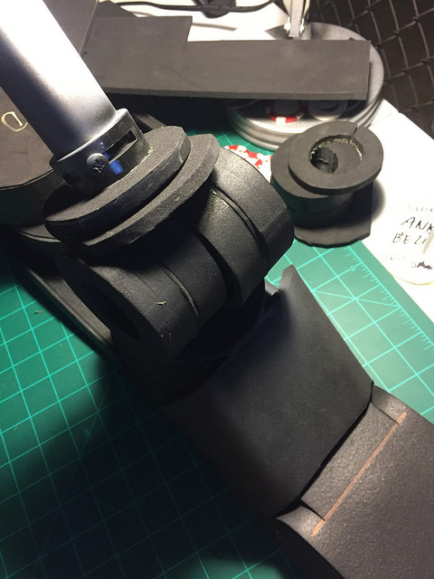

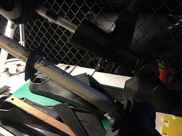

Came home for lunch today and finished the ankle and knee joints for the left leg. Tonight I did another twitch stream while I worked on the lower legs.
Came up with the angles for the lower lower leg. It's very angular.
Cut out some mid supports to hold the top of the lower lower leg.
Glued the support in place 10" from the ankle.
Worked out the angles. 1.75" edges on the front and side with a 2.25" piece on the back.
Almost forgot to make 2, mirrored of course.

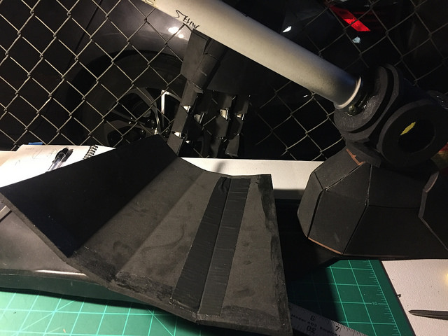

Scored to bend easier.
Waiting for the glue to tack.
One lower lower leg done. Working on the second.
Both lower lower legs finished.

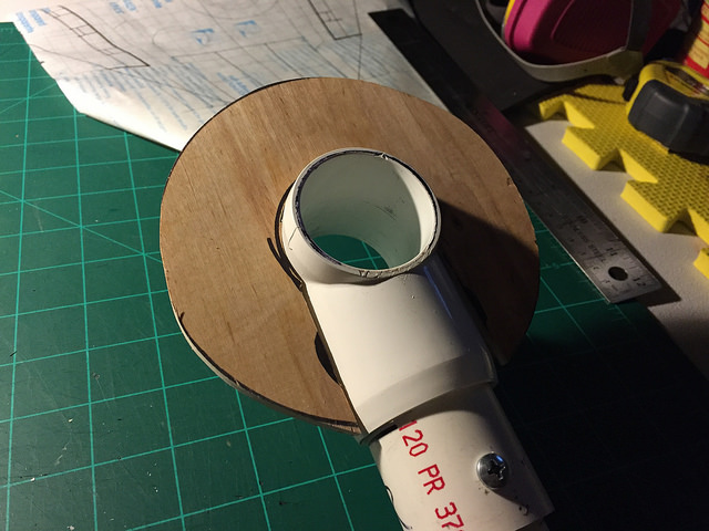

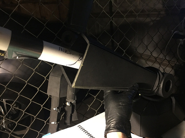

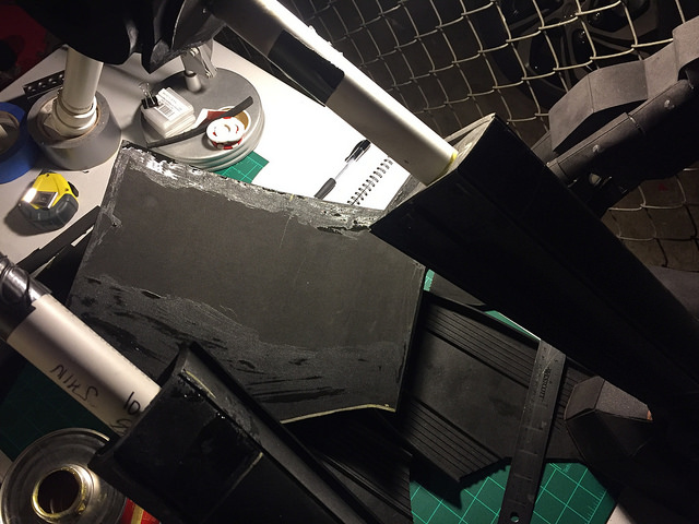

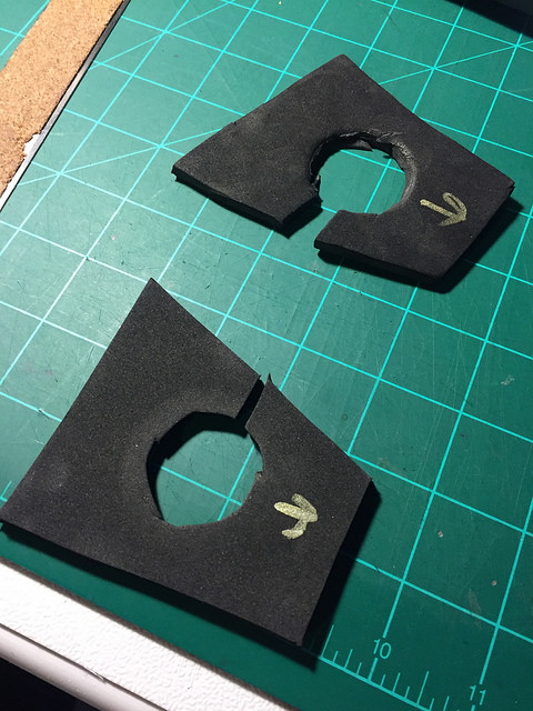

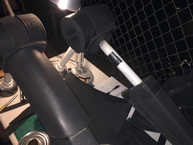

Added a 4" circle to mate the lower leg upper piece to.
Glued it to the pipe and the knee plate.
You can see the curved lower leg upper cover drying.
The piece of foam wraps around the 4" circle. First I center it, then tack it to the other glue spots working around to close the seam in the back.
The back seam is pretty strong. The bottom edge is glued to the lower lower leg piece.

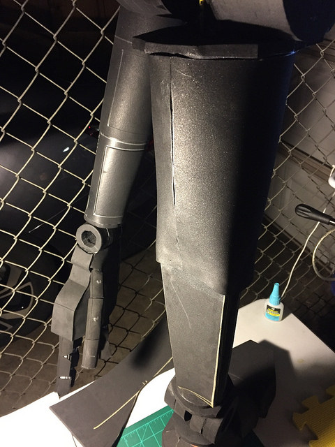

Both lower legs are done.
More skin concepts coming together. I love this stage of the project where things are really coming together.

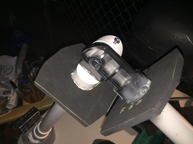

Added a cover of 2mm foam to the pan/tilt head. This covers the degree marks.

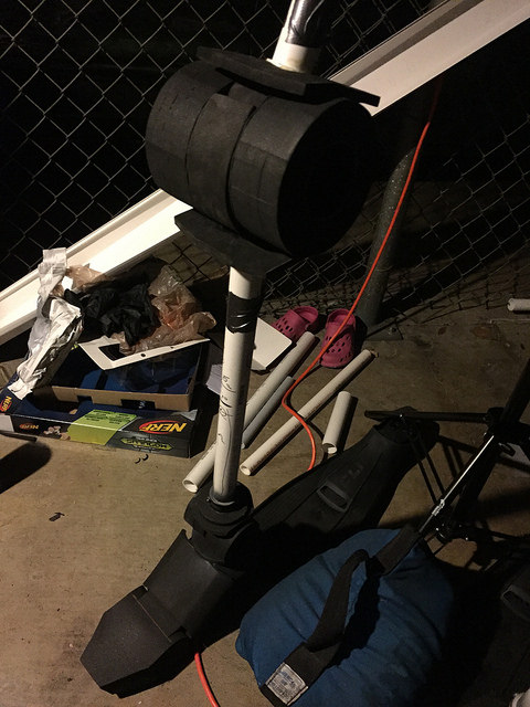

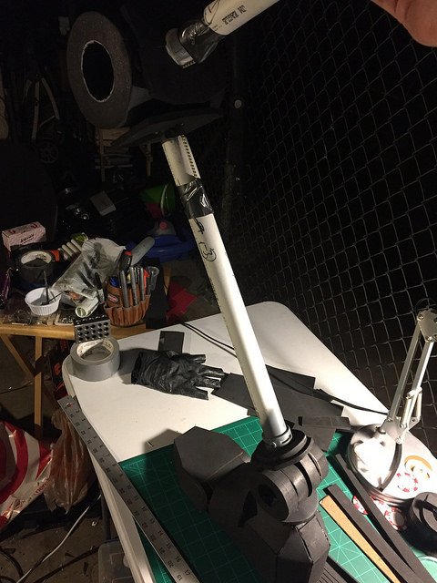

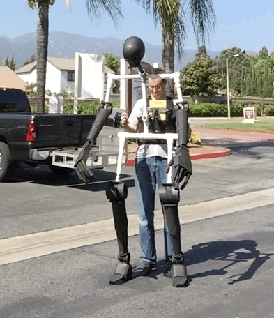

K-2SO took some baby steps today. I'm very glad that I did this as it changed some of the design directions I was going. His head is very heavy and very far away from me. He is building up weight which is a small concern. Also I'm glad that I can lock the knees to have him support his own weight when I need to take a break. I feel like i'm working from the outside in, at least in the black vs white parts of him.

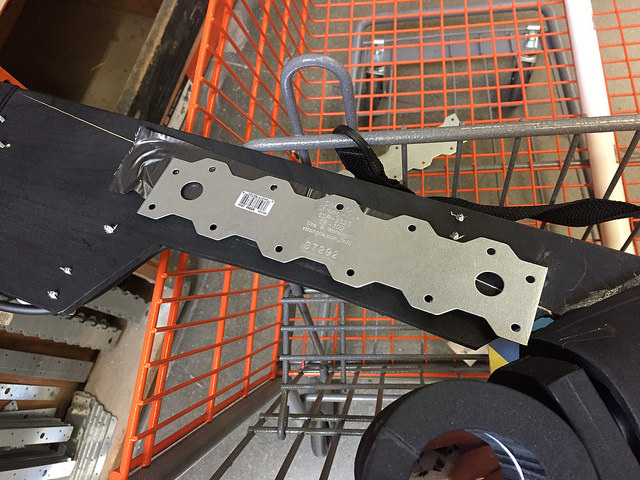

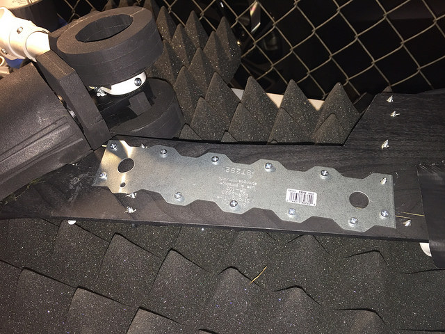

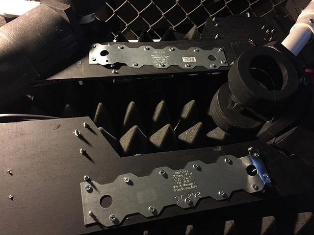

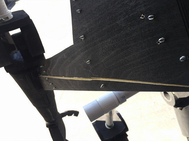

So while taking a test walk the left puppet paddle snapped. The twisting force I put on it was too much for the popler wood.
Cracked down the grain line. But didn't damage the hardware at all.
A quick trip to Home Depot and I had a reenforcing bracket. Yes I took my arm to HD to make sure the bracket fit what I needed.
Screwed down the bracket over the crack.
Added one to both sides for strength.

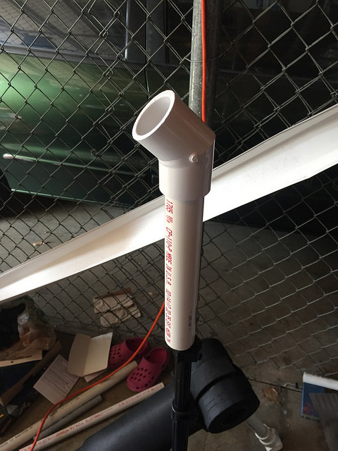

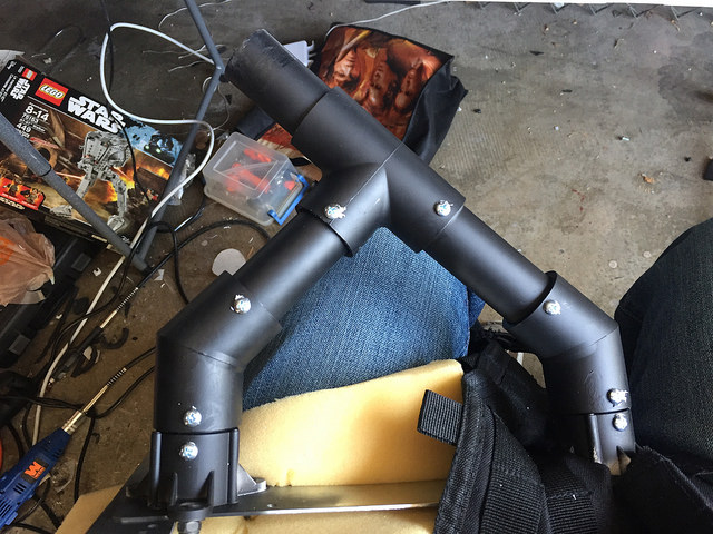

I also shortened one of the connecting pipes on the top half of the harness. This changes the angle to help keep K2 vertical.
I also put screws in at all of the junctions as the weight of K2 was pulling the pipe apart.
I swapped out the coupler spider joint for a permanent 45* angle piece. The weight was just too much on the adjustable joint and it was getting close to failing.
I also added a 45 degree to the setup stand.

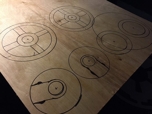

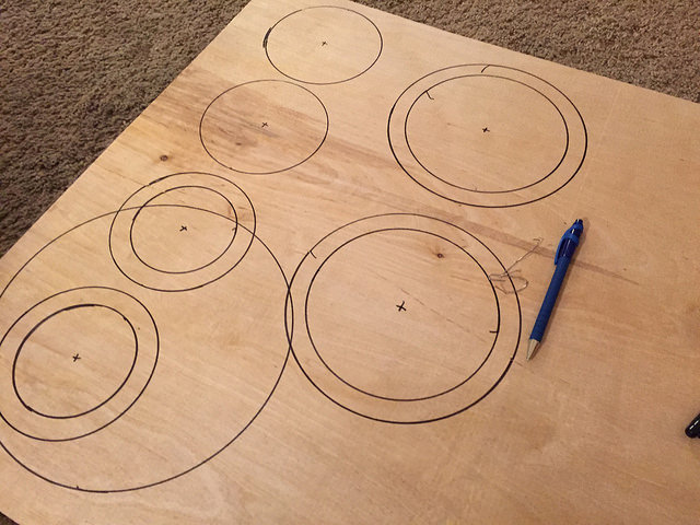

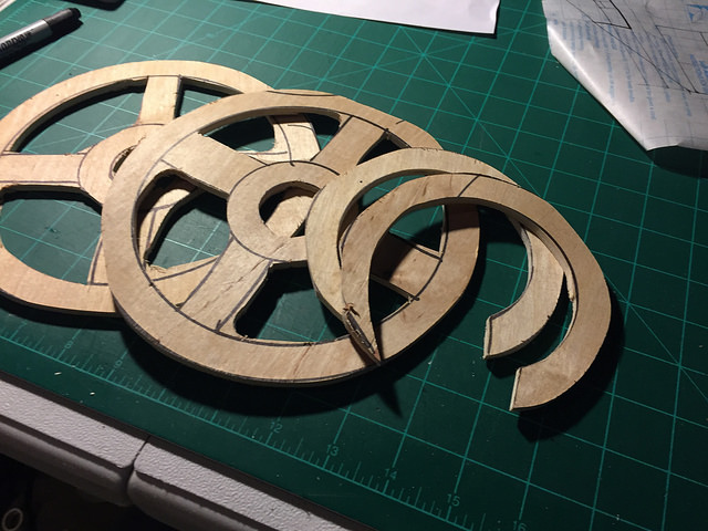

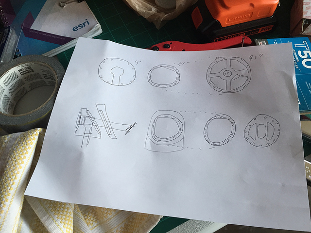

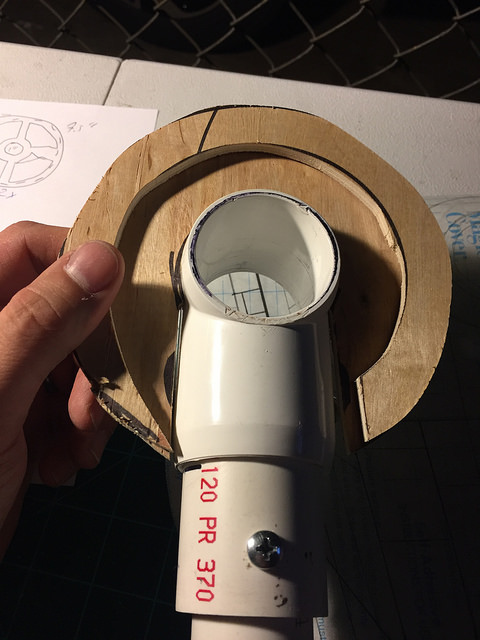

Today was fabricating the elbow skirt sleeve rings.

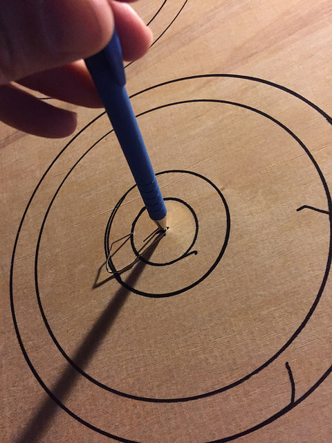

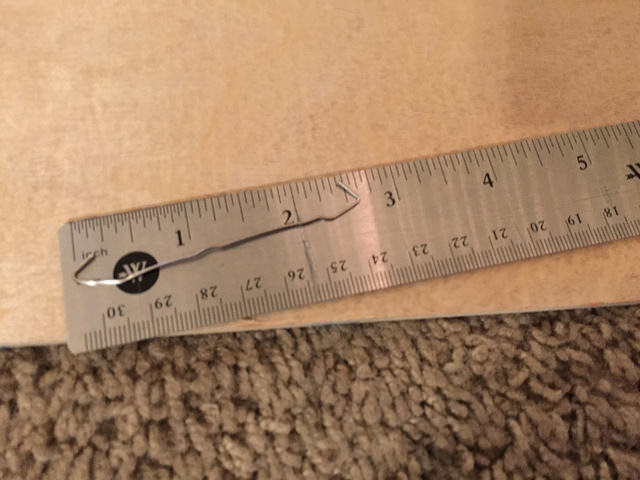

I used my paperclip compass trick to draw 5" and 7.5" circles.
Ready to be cut out.
The compass trick in action. Just anchor it with a pen on one end and bend the paperclip to the desired lenght.
The large ring will slip onto the shoulder 1" pvc pipe. The small ring with a notch will be attached to the arm slip-ring and have magnets around its perimeter. The single ring will have magnets and be stapled to one end of the shoulder skirt.
Cutting out some of the wood to save weight.

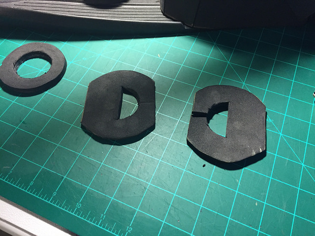

The shoulder plate which will have magnets.
The ring will have magnets that line up with the shoulder plate. Allowing the skirt sleeve to be connected and hide the shoulder pvc.
All cut out.

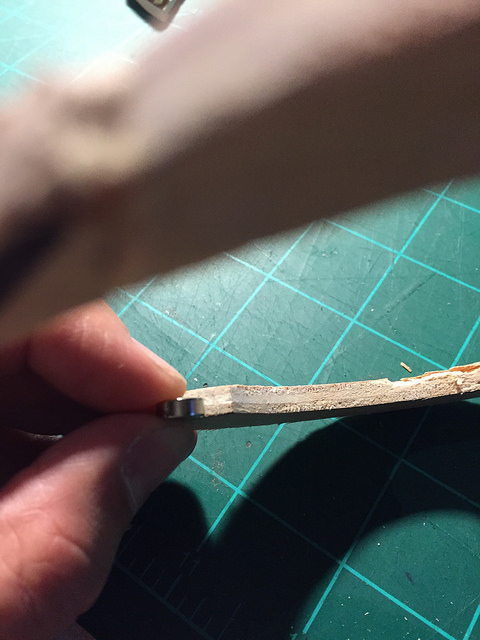

Trying some magnet placements. I have enough to add 5 per sleeve ring.
The magnets are about 2/3rds the thickness of the board. I'll counter sink the magnets into the board.

Drill bit wasn't large enough for the magnets to had to make the holes bigger. Used a countersink bit.

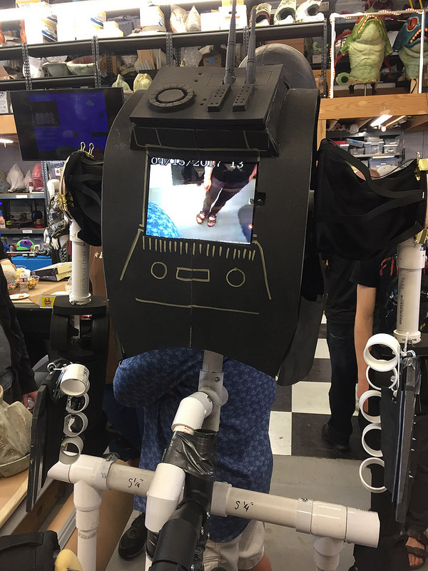

TORSO TIME! The RPF meetup is tomorrow and I can't let K2 go without something on his middle. I did the first steps on the torso between 9p and 3a. First I trimmed a mini torso to see how the foam would react trimming and bending it.
Made a 6" ring for the neck hole for tracing.

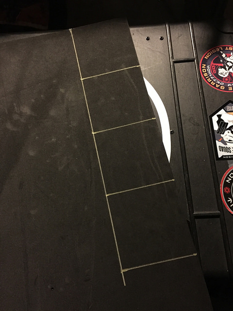

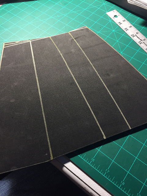

Started with the front panel.
Scored and heat traced the lines.
Time for the real thing. This step has scared me the most. So many curves and eyeballing it.

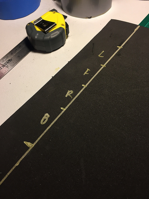

I start by marking the center point on a whole roll of foam. 2' x 5'.
Situate the front panel but not too low.
Trim out the neck hole in a circle, then move half the circle at an angle to make it a circle after the wedge cut in the back is made. Wedge cut the front panel.
Test fit over body.
Back seam isn't cut yet, just holding it all in place.
Trimmed back seam and taped it temp in place.
Trimmed one arm hole then used the foam cutout to mirror on other side.
Prepping the cog and bars panel support.
Fitting the frame for the cog and bars.
Made up some filler shapes for mounting the torso onto.
Attached and braced. This will need a lot more bracing but will work temporarily.
Made a pocket for the ipad.
Extended the side parts that go under the arms. Clamped them in place as I adjusted the two sides to match. Then cut the back flush and taped. Will glue once doing final assembly.
He looks good with a torso.
Prep for glueing the ipad mini pocket.
Access panel behind the cog and bars panel.
I'd like it to sit inside the panel but on top will do.
Ready for tomorrow at the RPF meeup.

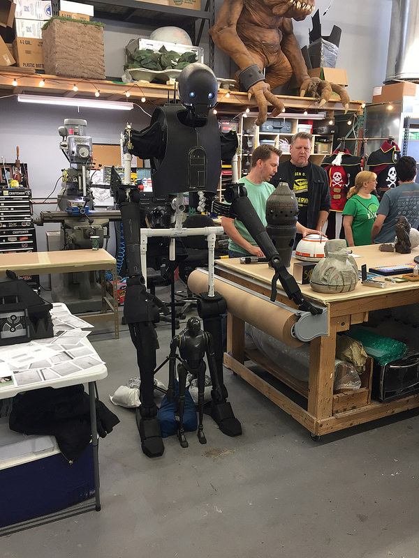

It's here! The RPF SoCal meetup!

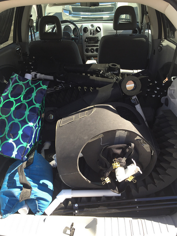

Gingerly packed K-2SO into my car. Lots of sound triangle foam.
Brought my work table and got a great setup spot in the middle of the room.

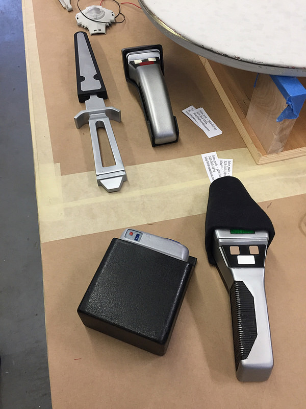

There were so many amazing creations. Here's the pod from one of my favorite films growing up "Explorers"

K2 greeting everyone.

Installed and used the ipad mini with the head camera for the first time. It worked great.

Star Trek props

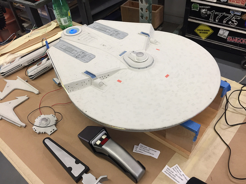

3d printed pieces everywhere.

More 3d printed pieces.

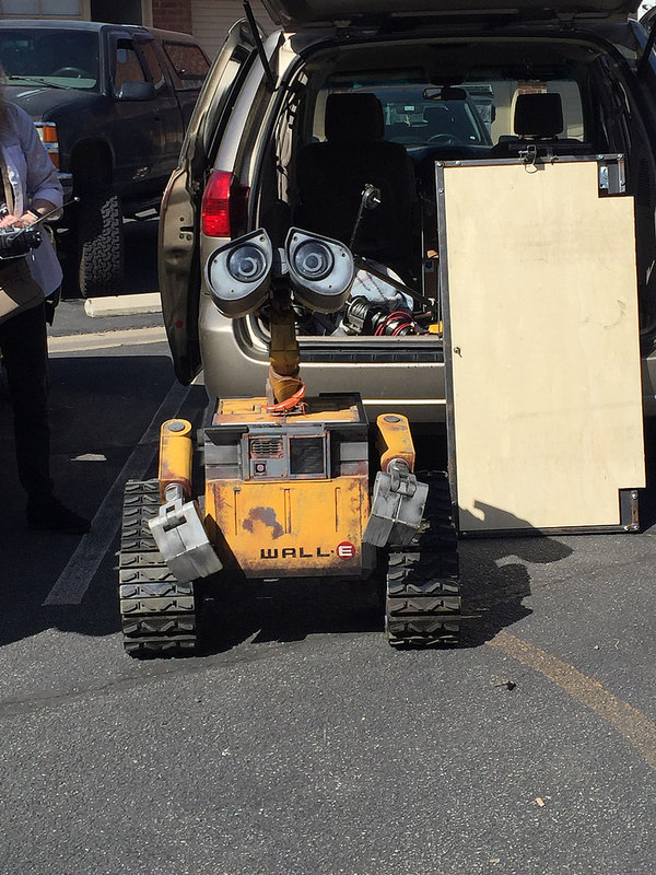

My little table with EP-1C the mouse droid.
K2 Selfie.
I won an Epsilon Pro kit from smooth-on in the raffle, Will go towards sealing all of K2's foam.

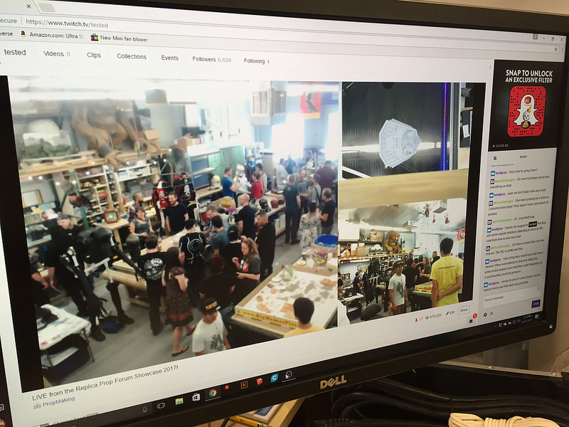

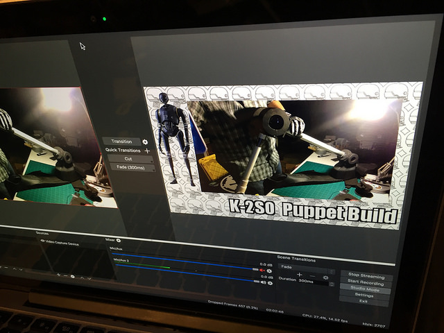

Event was live streamed on twitch. You can see K2 in the lower left corner.

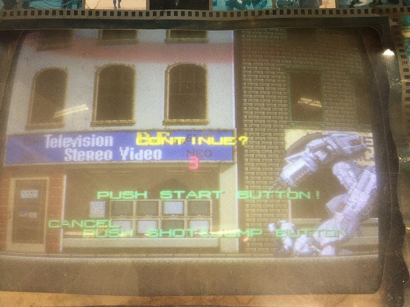

There was a Robocop arcade so of course I had to play it. ED-209 beat me though. Robocop was one of the first costumes I ever made.
At the end of the event Wall-E showed up.
My mouse droid got to come out and play with the robots.

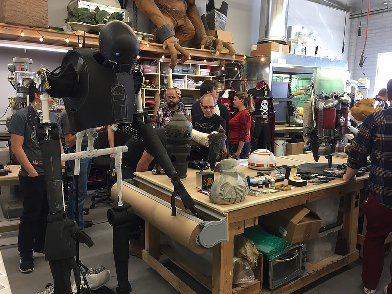

I took K-2SO for his second walking test around the shop. As you can see from the look on everyone's faces it went great! His knee lost a stop screw so it doubled back a little but I can fix that. He held up very well and puppeted around the room.
