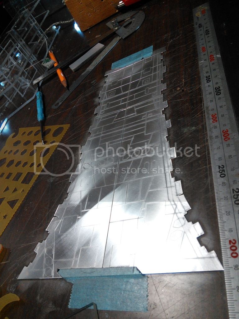

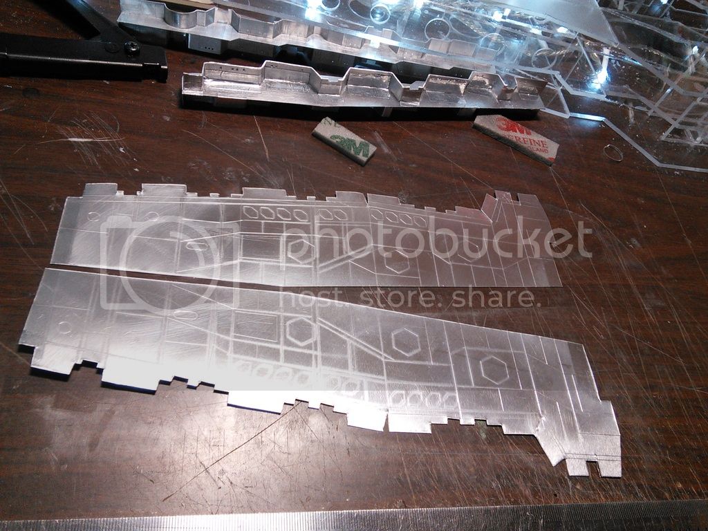

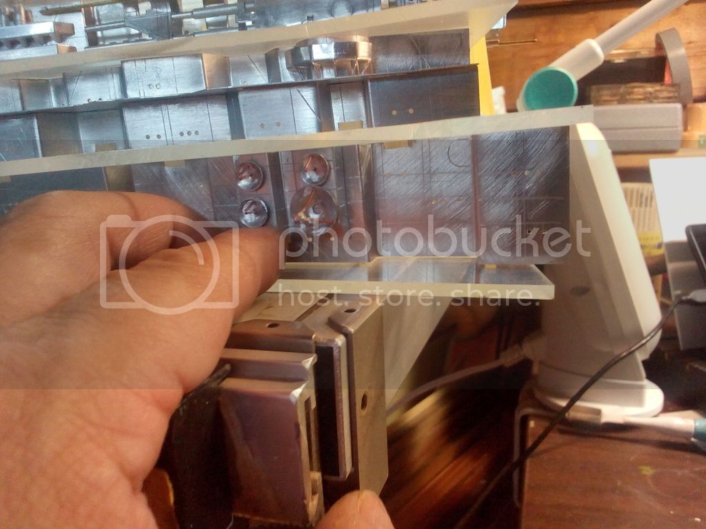

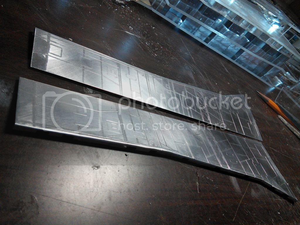

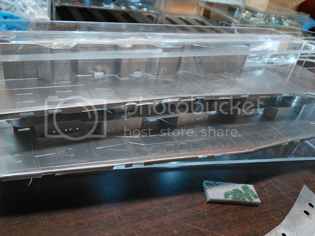

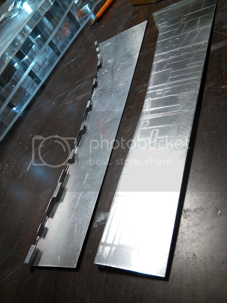

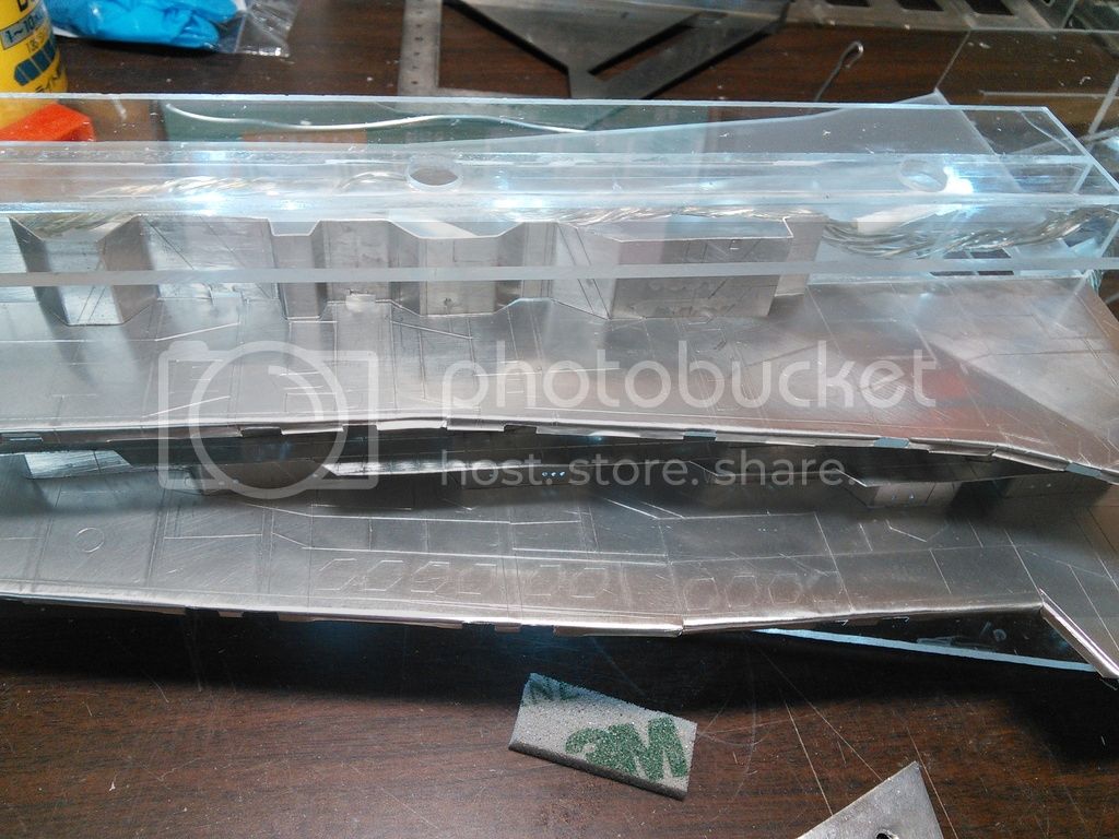

    The busiest month has been over and I was back to build in a couple of days ago.
    Here are some progress.
    I've started to built the hull shell with 0.5 mm aluminum.
    Hammering the sheet aluminum on a small anvil to get the shape.
    One of the good things about using the aluminum sheet is you can scribe the panel line on a flat surface at the first place.
    And then bend it or shape it.
    And fitted on the structure.
    [/URL]
    For the second and the third deck.
    I've just used some tiny rivet to hold the shell for now.
    When every parts are fitted and trimmed. I put them out again and paint it.
    Still long way to go but thanks for your support.
    Katsu

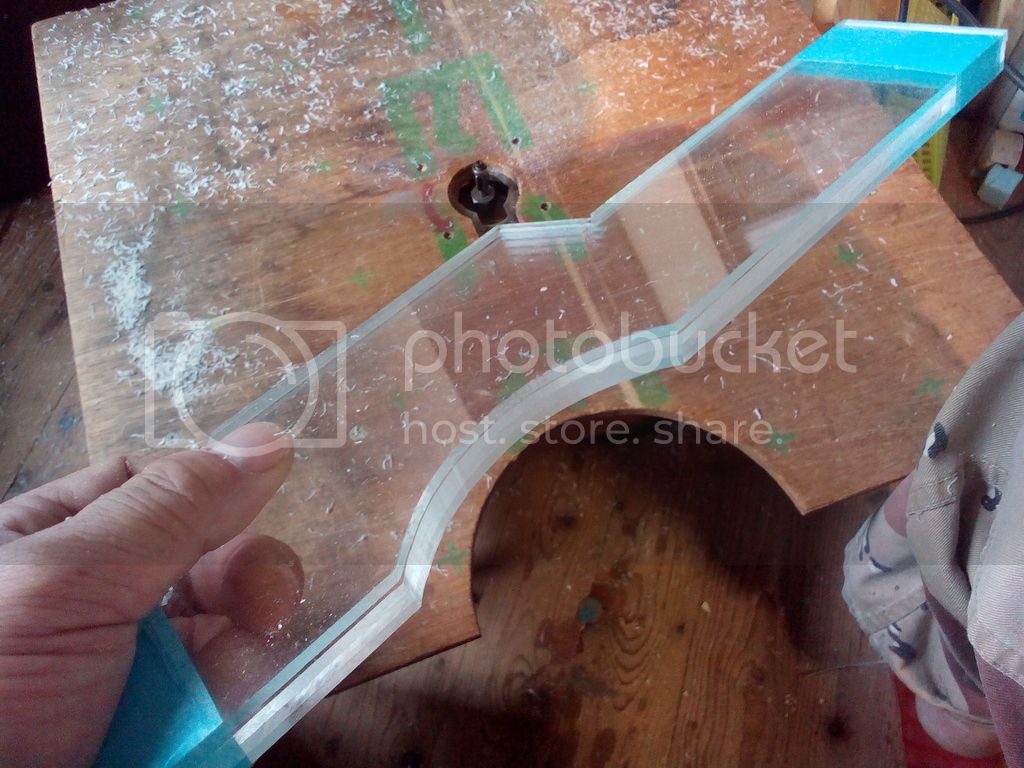

    crackerjazz said: View Post

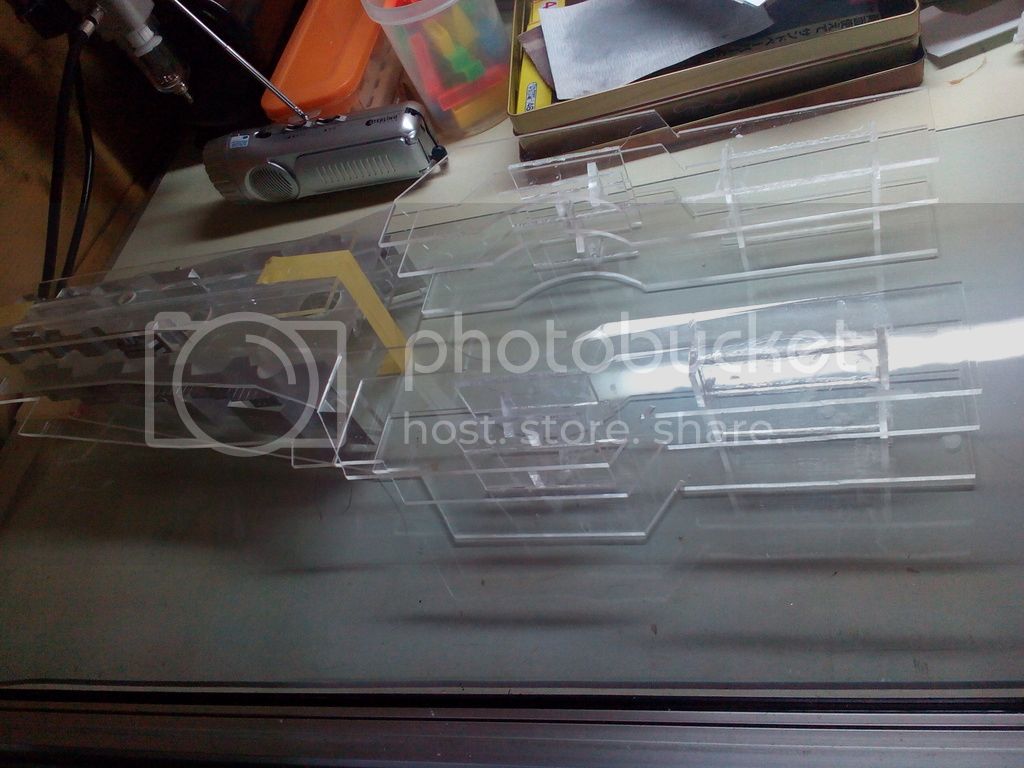

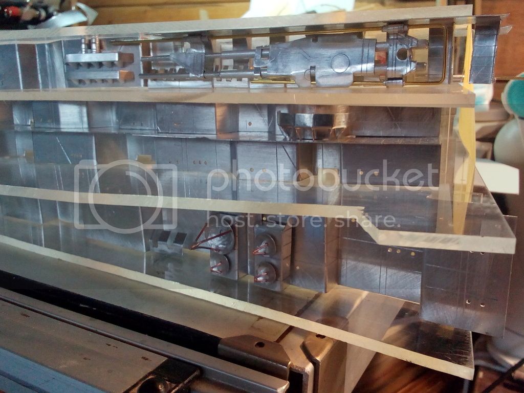

    Katsu-san, you surprise us with your skills! A couple questions -- how do you get all the parts to fit together so nicely? Do you work from completed blueprints with all the parts dimensioned? Everything looks incredible -- from the internal structure, parts and those beautiful aluminum panels.
    Hi! crackerjazz san, Thanks for asking.
    As usual, I haven't drew any blueprints. Just some rough sketches only.

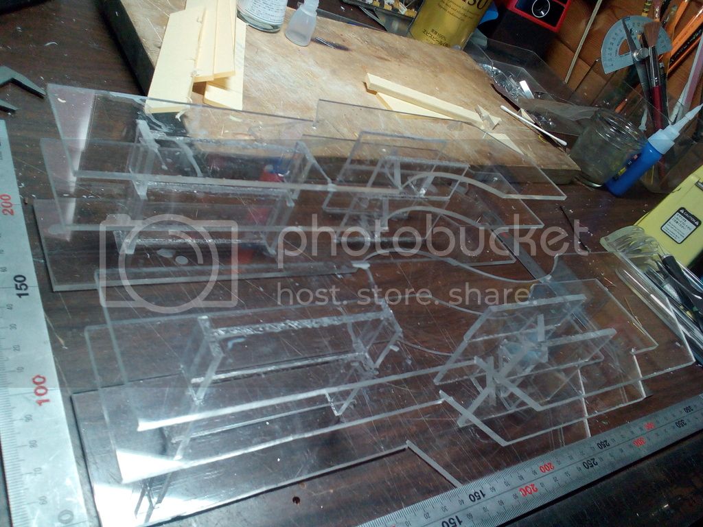

    For the structure, I used 3mm to 4mm thick acrylic plates for the good strength.
    I've just cut it to the appropliate shape with a circle saw with reffering to my sketches and mock up..
    In fact, it's just simple. I used some thin 0.5 mm cardboards to make a pattern before I cut the actual aluminum plates. I fit the rough cut of those cardboard to the structure and trimmed it with a scissors until it fit there perfectly. Then I put the cardboard paper patterns on a aluminum sheet, trace it and cut it precisely with a scissors or an knife. No room for error in a good way. Just like a making a tailored suits.
    Aluminum is very flexible material. You can heat up the aluminum plates and cool it down slowly to let it have more flexibility. You can make a complicated curve by a simple hammering.
    katsu
