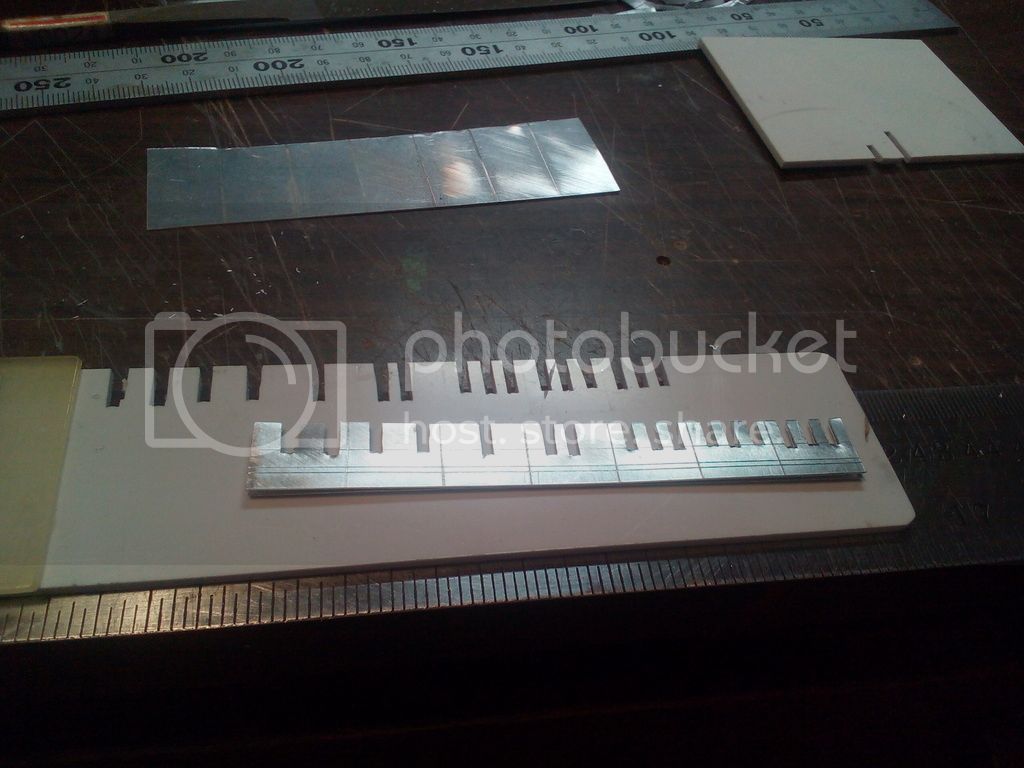

    Thank you Jim-san,
    So far, Im using Locktight super glue and aluminum adhesive tape.
    SmilingOtter said: View Post
    I LOVE the way you cut the notches out of the strip to make the curved platform, then used the same cuts to act as bracing for the platform. That is a beautifully elegant design.
    Thank you, Tom-san.
    When you scratch a line with any knife or something with a sharp edge on a sheet plastic and bend it, it will be cut out soon. But the aluminum sheet won't be cut so soon. Instead, it's bent with a sharp angle along the line.That's the good point of aluminum. And you don't even have to scratch if you want to have it a mild edge. Just put it on a ruler or blunt edge and bend it.
    It's very controllable. Also, also! If you carve a shallow circle hole on a wooden plate and place the aluminum sheet on it and press with wooden stick with a blunt end, You can make a parabolic dome without using a heat.

    What is the thickness of your aluminum sheets?
    --Alex
  6. yuumi2891103's Avatar
    Member Since
    Jan 2010
    From
    Small local town near Narita airport
    Messages
    1,960
    Jul 13, 2016, 1:12 AM - Re: Battle starship #56
    Albertese said: View Post
    --Alex
    I'm using 300mm x 20mm 0.3mm thick sheet aluminum so far.
    0.3mm is the ideal thickness for the model building like this. ( Beer can is 0.15 - 0.2mm)
    You don't need particular tool for cut and shape.
    Also, I've ordered 0.5mm sheet for the outer skin.
    Those custom bikers seem to use more thicker sheet for those original fuel tanks.
    http://www.cycleworld.com/how-to-han...hniques#page-3
    katsu

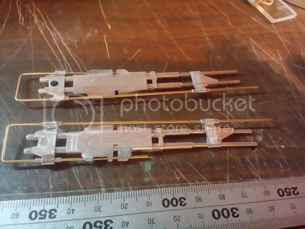

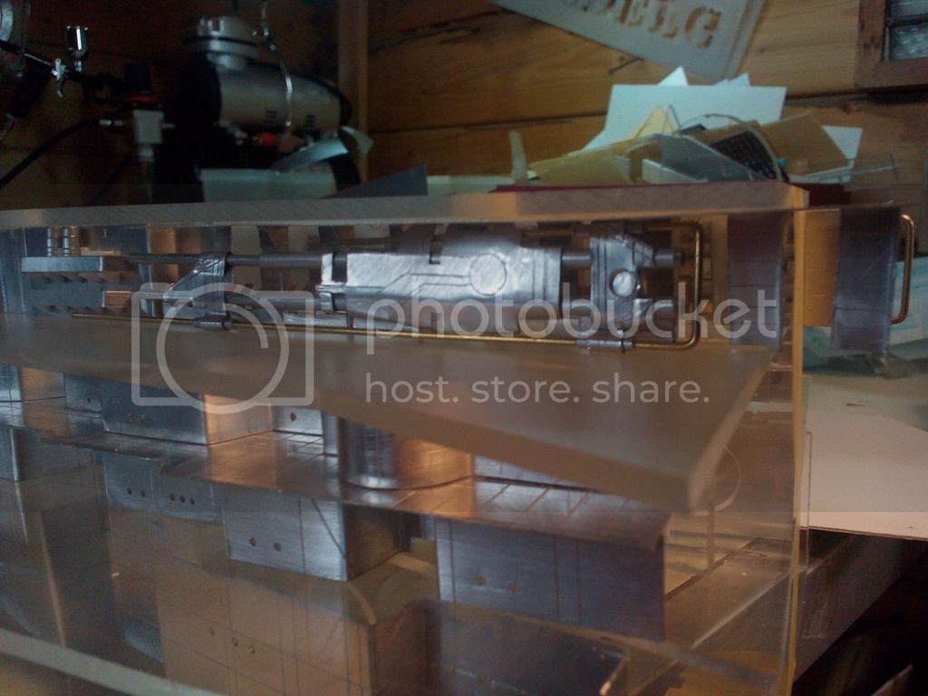

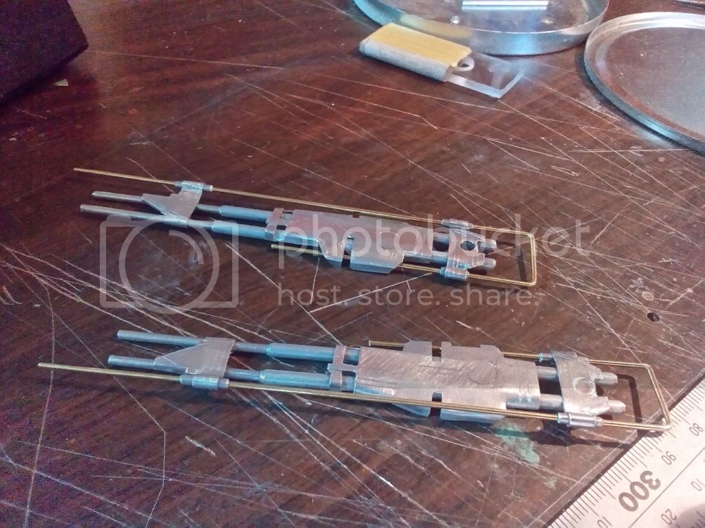

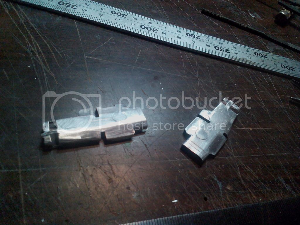

    Here is todays updates.
    I made some other detailing parts.
    Thanks for looking.
    Katsu

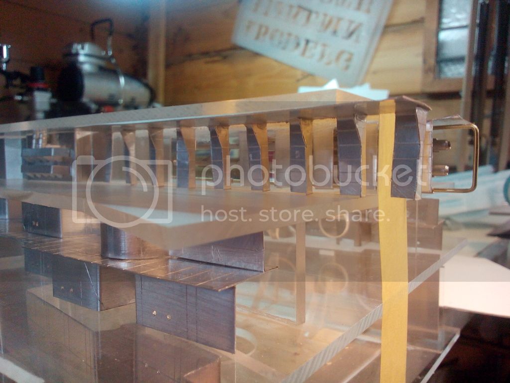

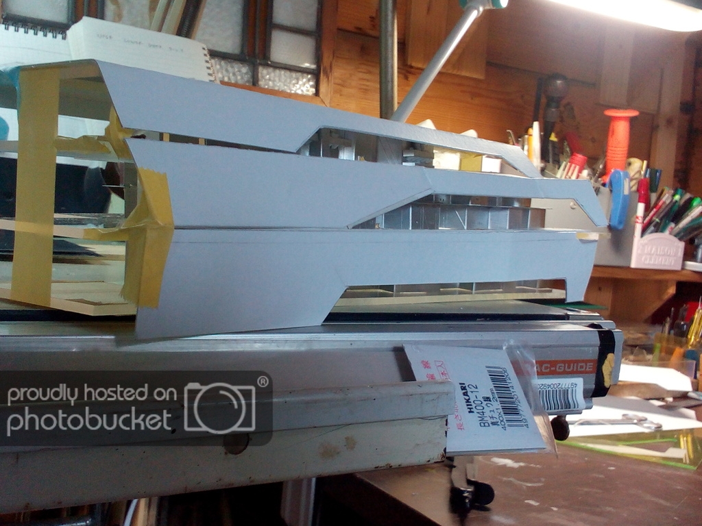

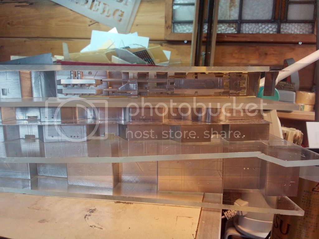

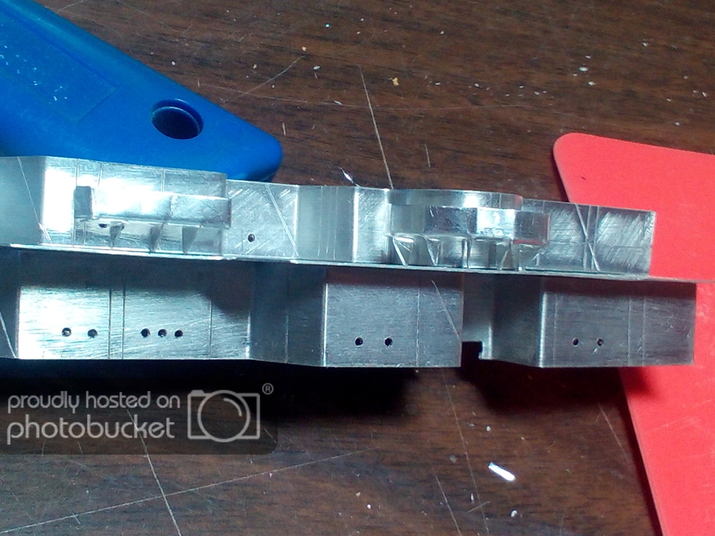

    Aug 6, 2016, 11:23 PM - Re: Battle starship #72

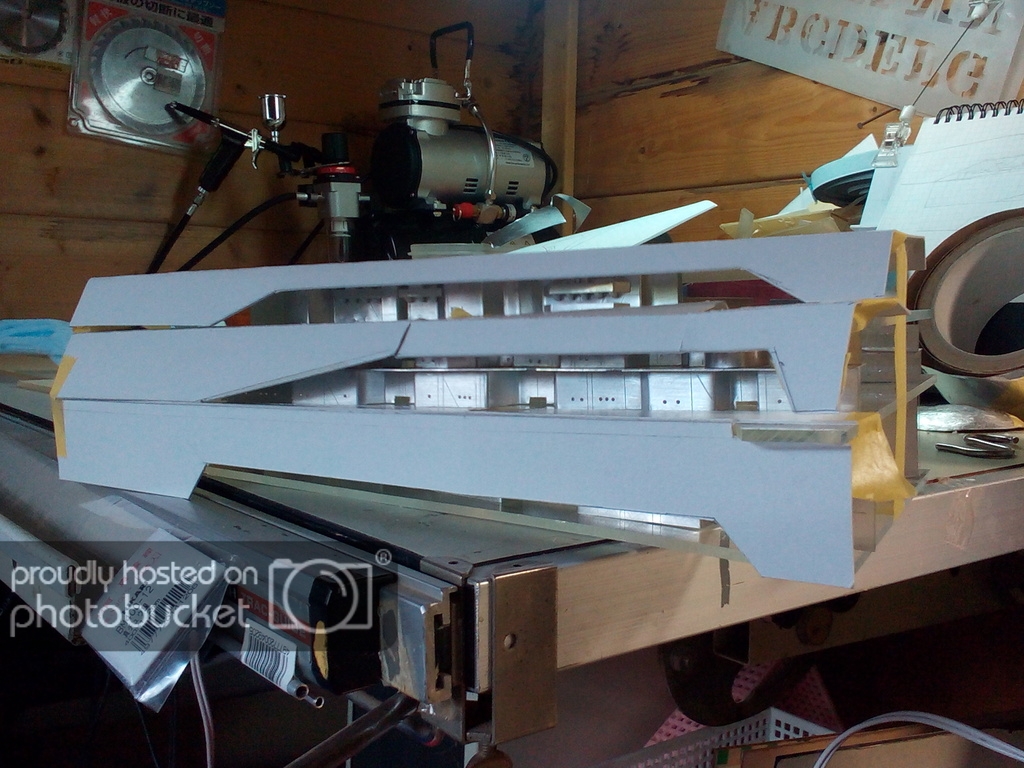

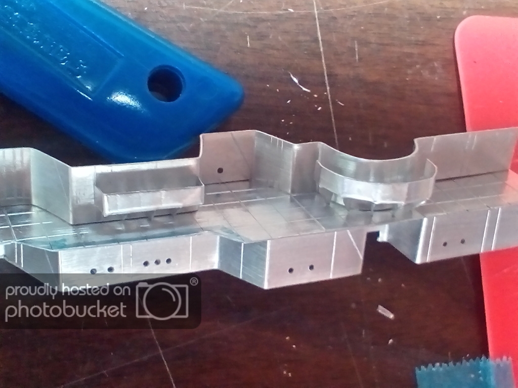

    Some progress
    Finished the mid section structure and I'm working on decks and ceilings.
    The circular open space in the middle of the mid section will be for the CCIC (Core of Combat Information Center). I'm thinking that will be looks like a small NCC1701 contained in this section.
    The aft section structure will be added to this mid structure later which contains a hanger/dock. Hanger deck will not have hard deck floor. The docking ship will be hanging in the space literally.
    All these parts are not glued at this moment. Just test fitting.
    To be adjusted, filled the gaps, glued and painted and be placed a little later.
    Thanks for looking.
    katsu

    Beautiful work! What are you using to scribe your panel lines in the aluminum?
    --Alex
  24. yuumi2891103's Avatar
    Member Since
    Jan 2010
    From
    Messages
    1,960
    Aug 7, 2016, 2:41 AM - Re: Battle starship #74
    Hi, my friend.
    Nothing special. Just a backside of a Exacto knife or something you use for plastic.
    And with a ruler and some templates of circles and squares.
    Katsu
