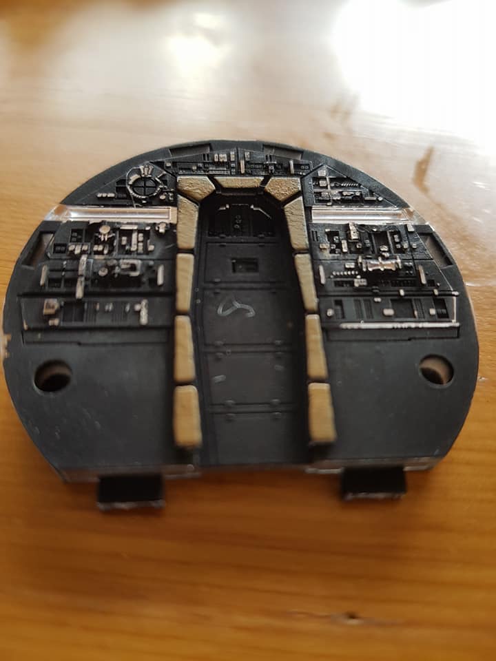

I just stripped and trashed all the cockpit decals. No amount of softener was ever going to make that work. I'm kind of at an impasse on the kit. I don't want to go any further until someone comes up with a good solution for lighting the cockpit. The built in clear back wall system is disappointing. Otherwise it's the perfect model.
Just paint the back wall, and scrape the paint from the areas that should light up.

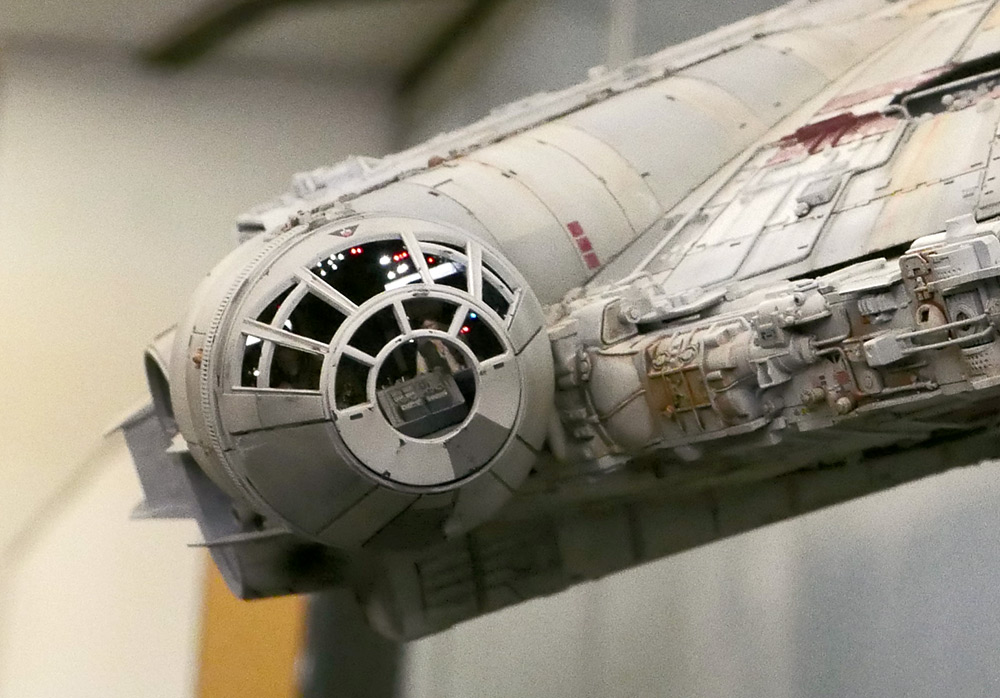

How about using fiber?
These are of the model that I have posted before, displayed at an exhibition of a group of modelling enthusiasts.
https://www.therpf.com/showthread.php?t=262348&page=62&p=4329074&highlight=exhibition#post4329074
I asked the guy who made it, and he said he just used the included cockpit LEDs, and rerouted some of its light with fibers, which were just drilled into the kit parts. The back wall as well as the side walls.
I don't think any afterparts, photoetched or otherwise, will be able to match this classic and uncostly solution, especially if one were to light the side walls.
That being said, and although the effect looks great in photos, I personally felt that those micro lights distracted the sense of scale when actually seeing the model in front of me. That is why I opted to just illuminating the light bars.
As with the cockpit decals, I have posted on this before, but you need to file the panels flat (or near flat) before applying them.
Or else, paint the panels with dark grey, and brush with a lighter color to make most of the engravings.
https://www.therpf.com/showthread.php?t=262348&page=68&p=4343512&viewfull=1#post4343512
