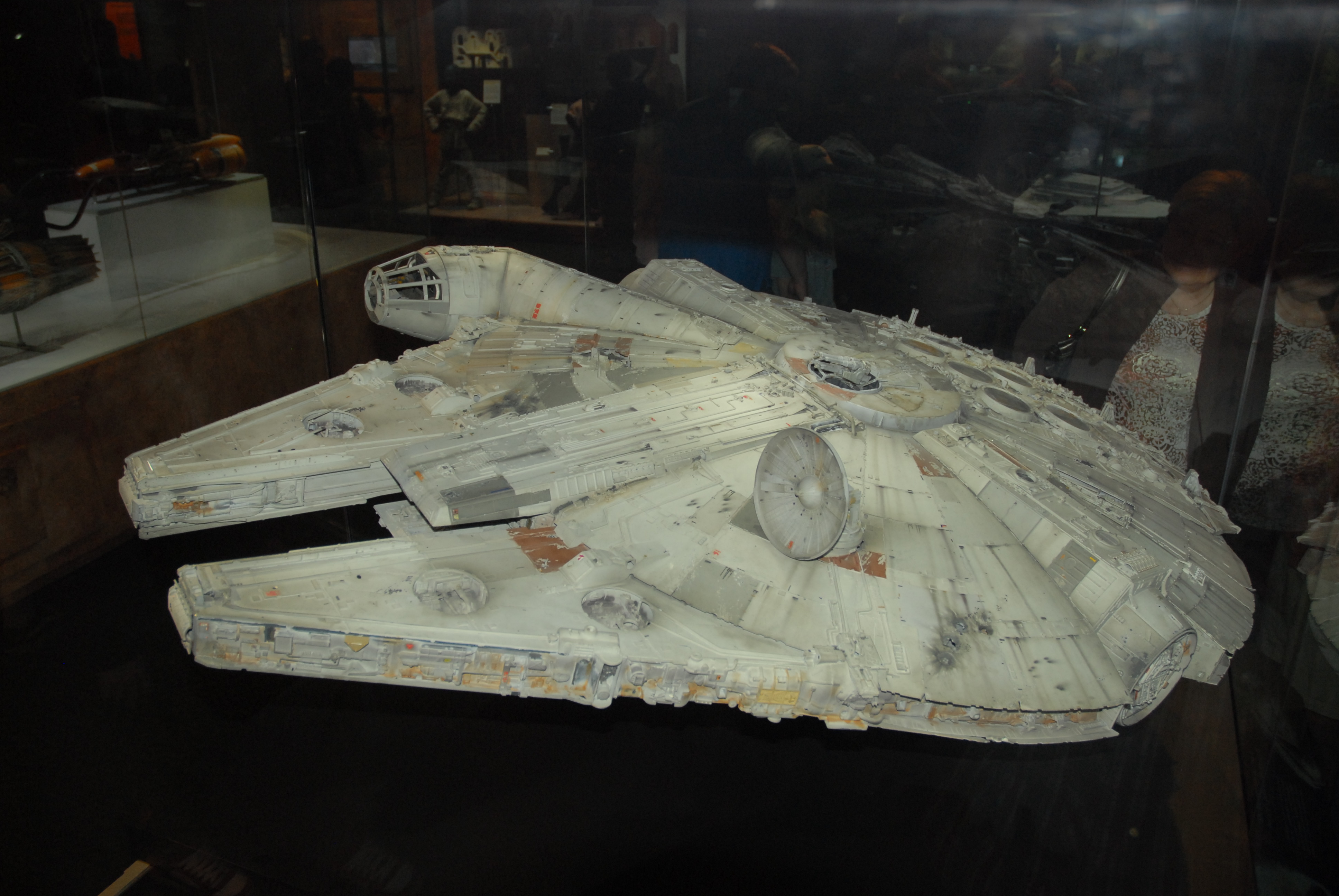

It's been said before, but the vagaries of cameras, sensors, monitors, lighting, white balance etc make accurate colour assessment from online photos impossible. With physical photos the printers, inks and paper stock also have their effect. Frequently studio models were (are) painted to look as intended under filming conditions, rather than as exhibits. Sometimes multiple models of different sizes are painted (slightly) different colours due to the "scale effect".
If you painted your model exactly matching paint chips from the original model, the shades will have faded/aged over the decades. . .
Of course, what you saw on the biggish screen in 1977 or your HDR TV last night, will be different again.
You can choose your references and do your best to match them, but for most people the elusive "it looks right to me" approach will do.
The more info and references the better, but don't lose the enjoyment factor, remember that Charlie Chaplin came third in a Charlie Chaplin look-a-like competition! (Maybe his gait lacked the "toe in").
Re: Bandai 1/72 Millennium Falcon
Here is a shot I took of the 5ft Falcon when it was in LA a few years ago and in my opinion is as close to accurate as you are going to get as far as color reference. The flash was daylight balanced, so the color temperature is correct and is not blown out by the flash either. The flash overpowers their display lights, but the camera exposure is set for the flash. You can see a little of the display lights yellowish hue on top of the cockpit tunnel where it makes it turn. Of course how your eye sees this also depends on your monitor when you view it also.

I saw the 32in Falcon in 1986 in an exhibit of Hollywood artifacts at the Smithsonian Museum of American History. It looked very much like the grime color that has been described, close to the beige color of the MPC kit. Funny though that the pics I took all look white/gray.
I also saw the 5ft at the Air and Space Museum in the first Star Wars exhibit in the mid 90s. It was in a spot that got a lot of sunlight from the skylights, and it looked very white/gray, much like the pics in the Archives book you mentioned. There were panels that were painted in tan and creamy beige colors, but the overall color was white/gray.
