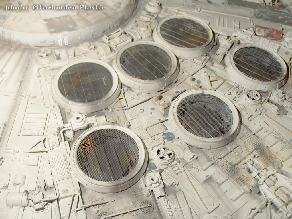

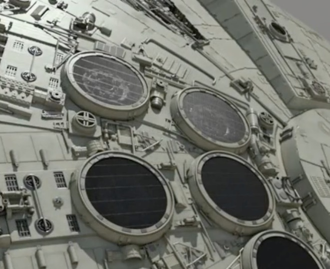

The five foot Falcon used to film ANH in 1976/77 had nine-bladed fans with circular central discs. The digital model used for TFA had octagonal central discs, but again with 9 blades.
Re: Bandai 1/72 Millennium Falcon

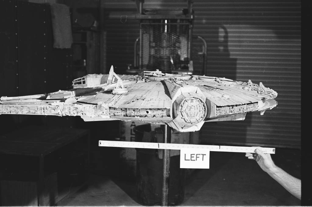

This is a photo of the five foot model taken by a fan. Fans shot by a fan.

This is a screen shot from a "making of" promo documentary on TFA. It shows the digital hard surface model during the Jakku escape sequence, without the paint layer applied.

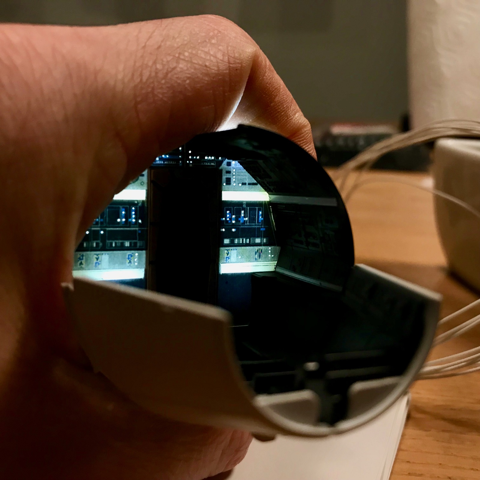

StevetheSwede is doing an amazing job on my Falcon build. We've experimented with lots of different options for the rear wall and have ended up with this. ANH style decal, sculpted details removed from the rear wall kit part so the decal can be attached flat. Light bars cut out of the decal and tiny individual lights drilled to make them appear brighter than the rest of the rear wall decal. Light box enclosure facing the rear wall was cut out to allow light to illuminate the whole back wall. Two additional LED's incorporated to light up the lower light bars. Really happy with how this looks. Thanks Steve!

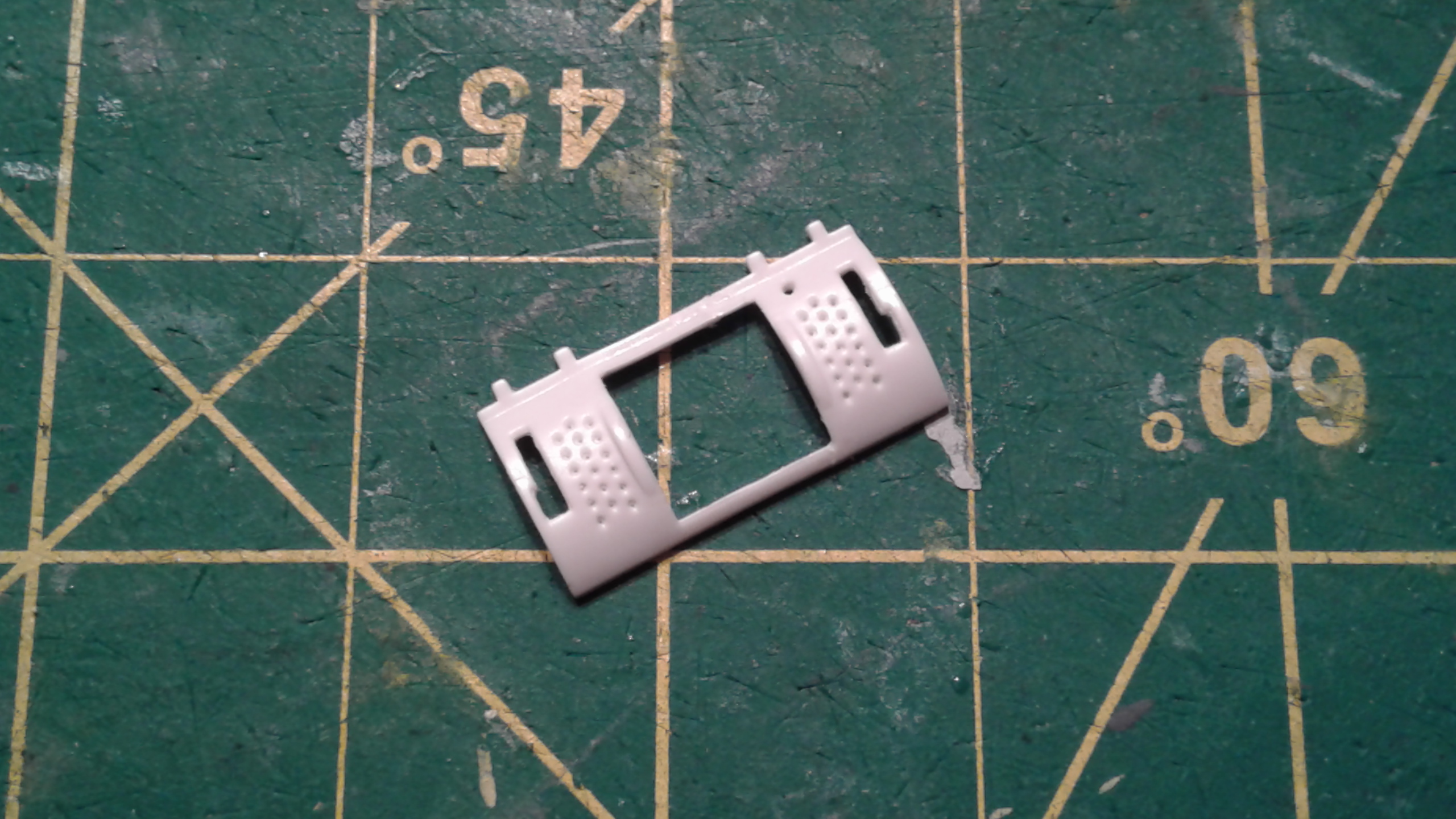

Fixed up this part a little. I don't have any tiny drill bits, so I'm just going to leave those little holes how they are. I did however poke them with a needle just so they are a little deeper and less one dimensional.

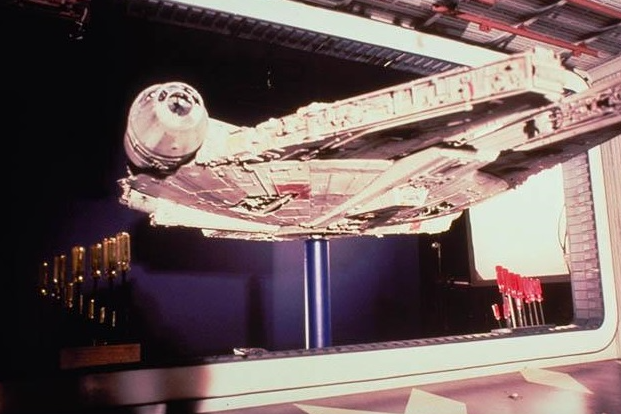

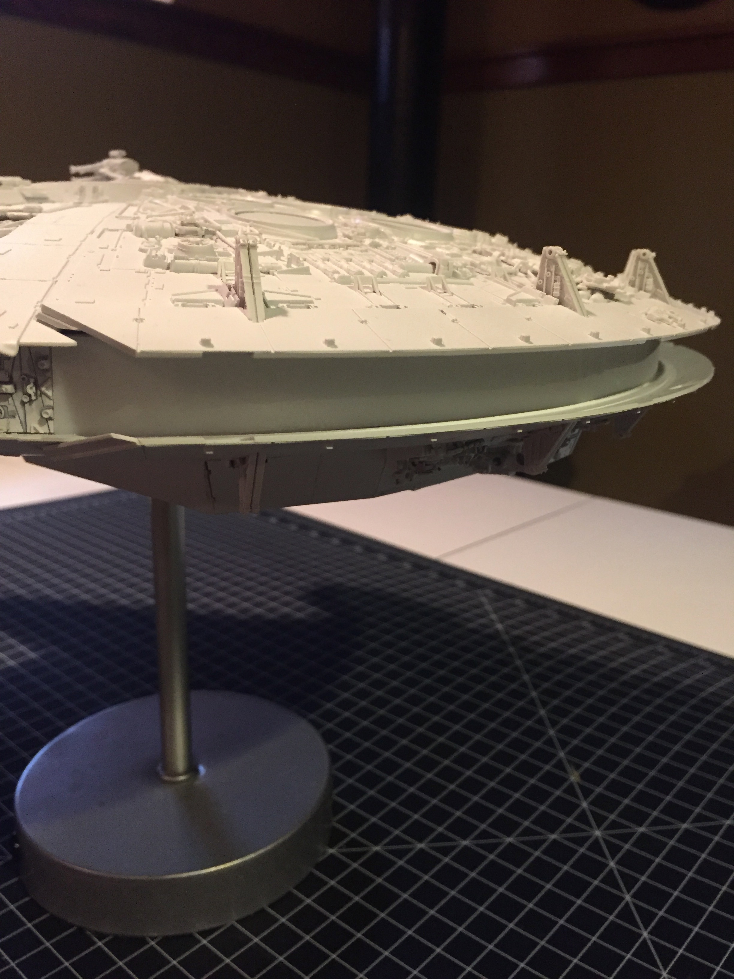

Happy New Year, Falconers! Got some of my bigger items sorted over the holidays. As you may recall, I'm modifying my PG Falcon to represent the ILM 5-footer during the specific shot where the Falcon is backing out of the Death Star hangar bay.
star-wars4-movie-screencaps.com-10929 copy.jpgBlue pole copy.pngc2e77b7cb7d06265270a8532b3836fc0 copy.jpg
The 5-footer was mounted through the lower gunport for this shot, which required modifying the lower gunport assembly and window area. This is the ILM original...

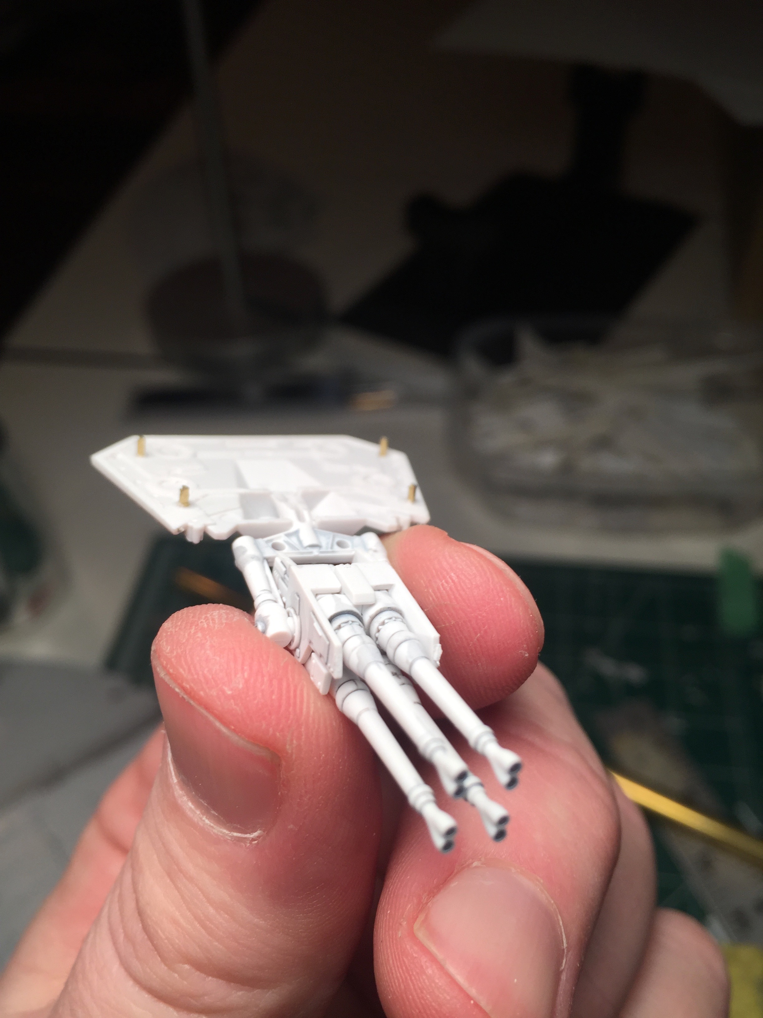

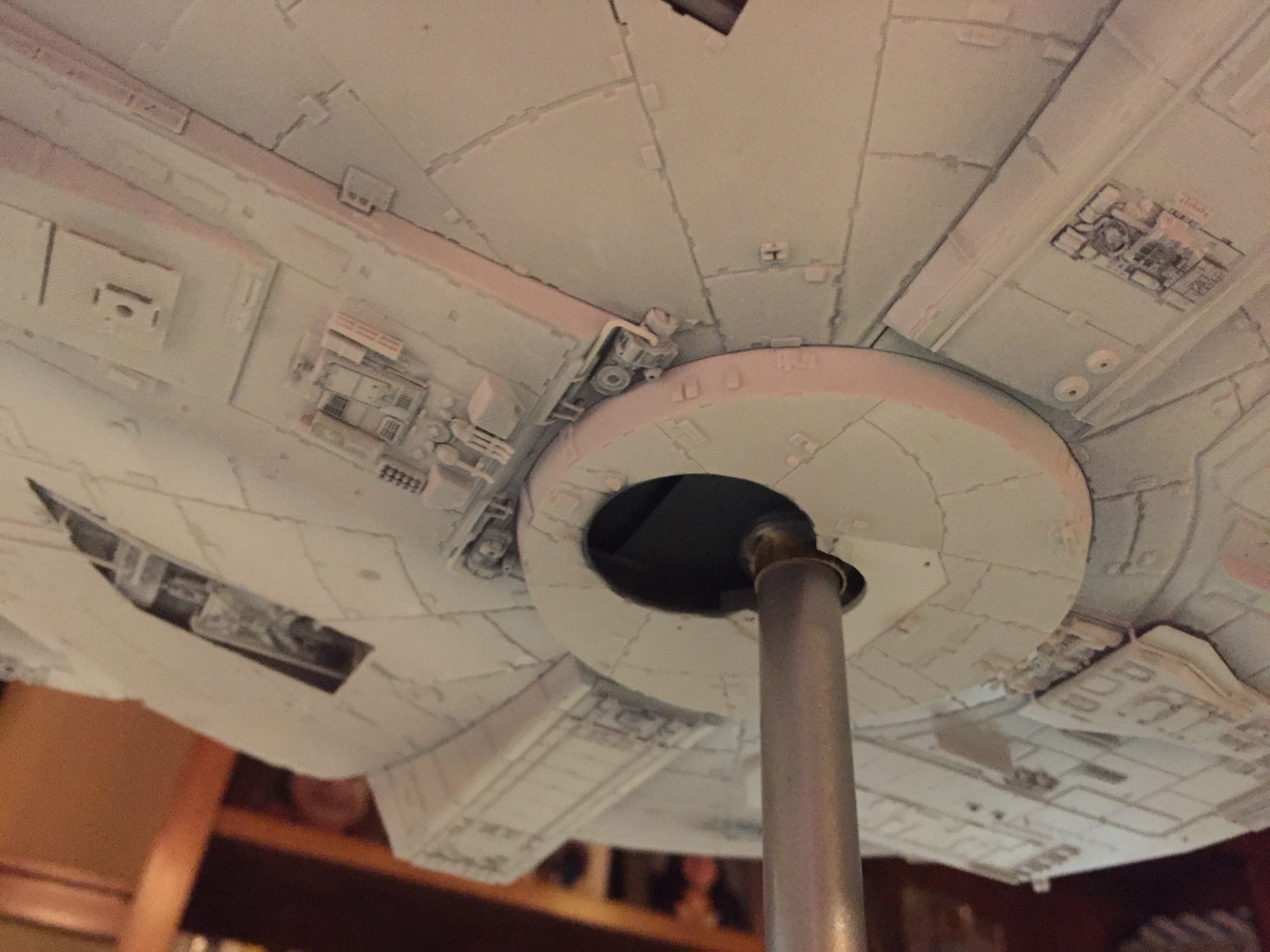

And here's my modification...

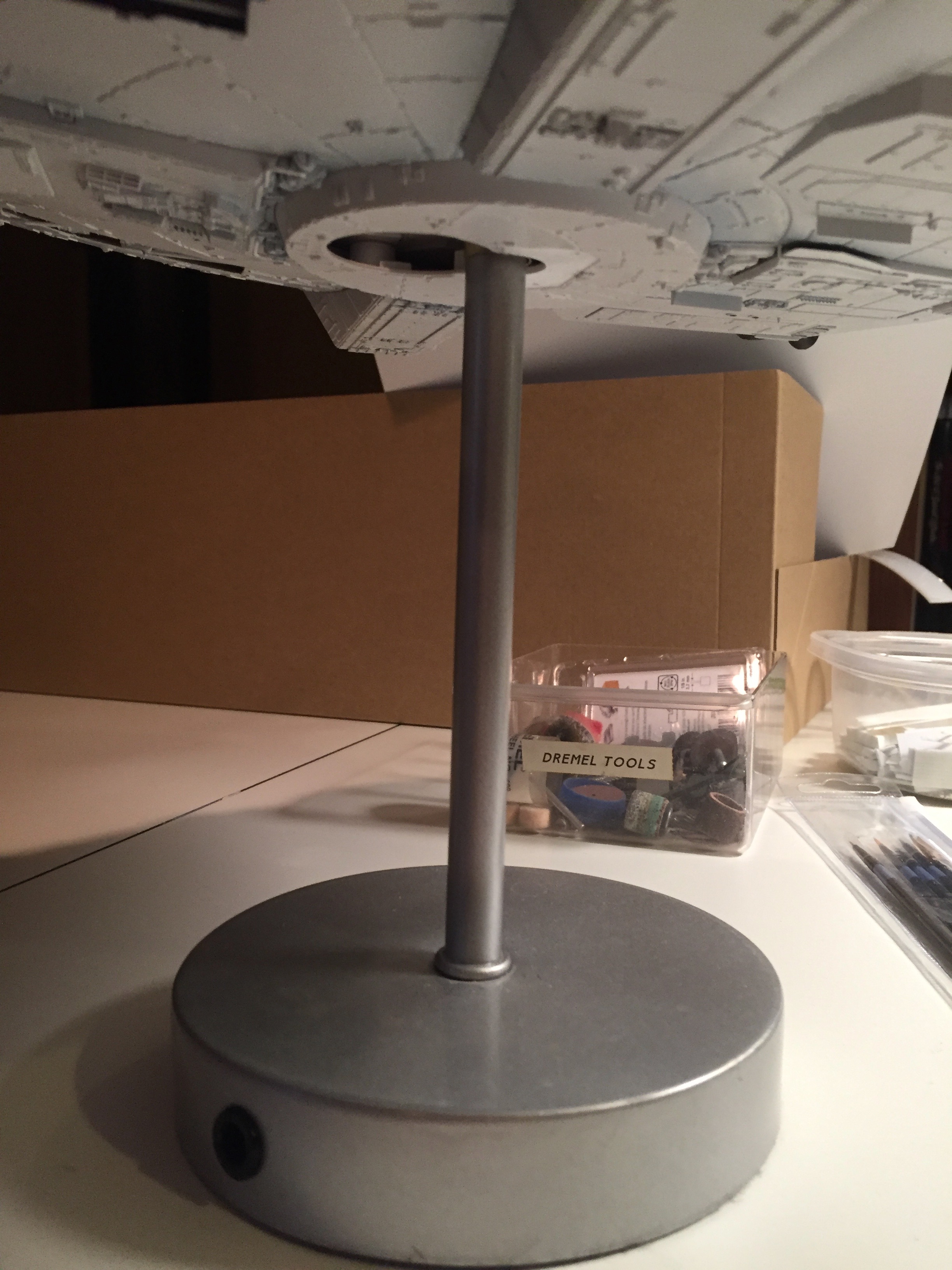

I created a mount using a brass tube that fits over the converted lamp base I'm using to replicate ILM's filming mount.
HOJ base mount 1.jpgHOJ base mount 2.jpgHOJ base mount 3.jpgHOJ base mount 4.jpg
Eventually, I'll paint the support rod a bluescreen blue color. I know some of you likely think I'm crazy for modifying the gunport to remove the Bandai gunport, but I will be able to display the model with the lower gun in place. Like on the 5-footer, I added brass pegs to the gun mount that correspond to the holes in the lower hull. The lower gun now snaps into position nicely.

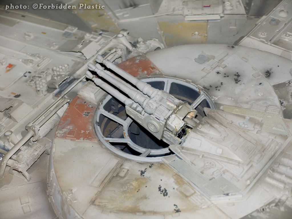

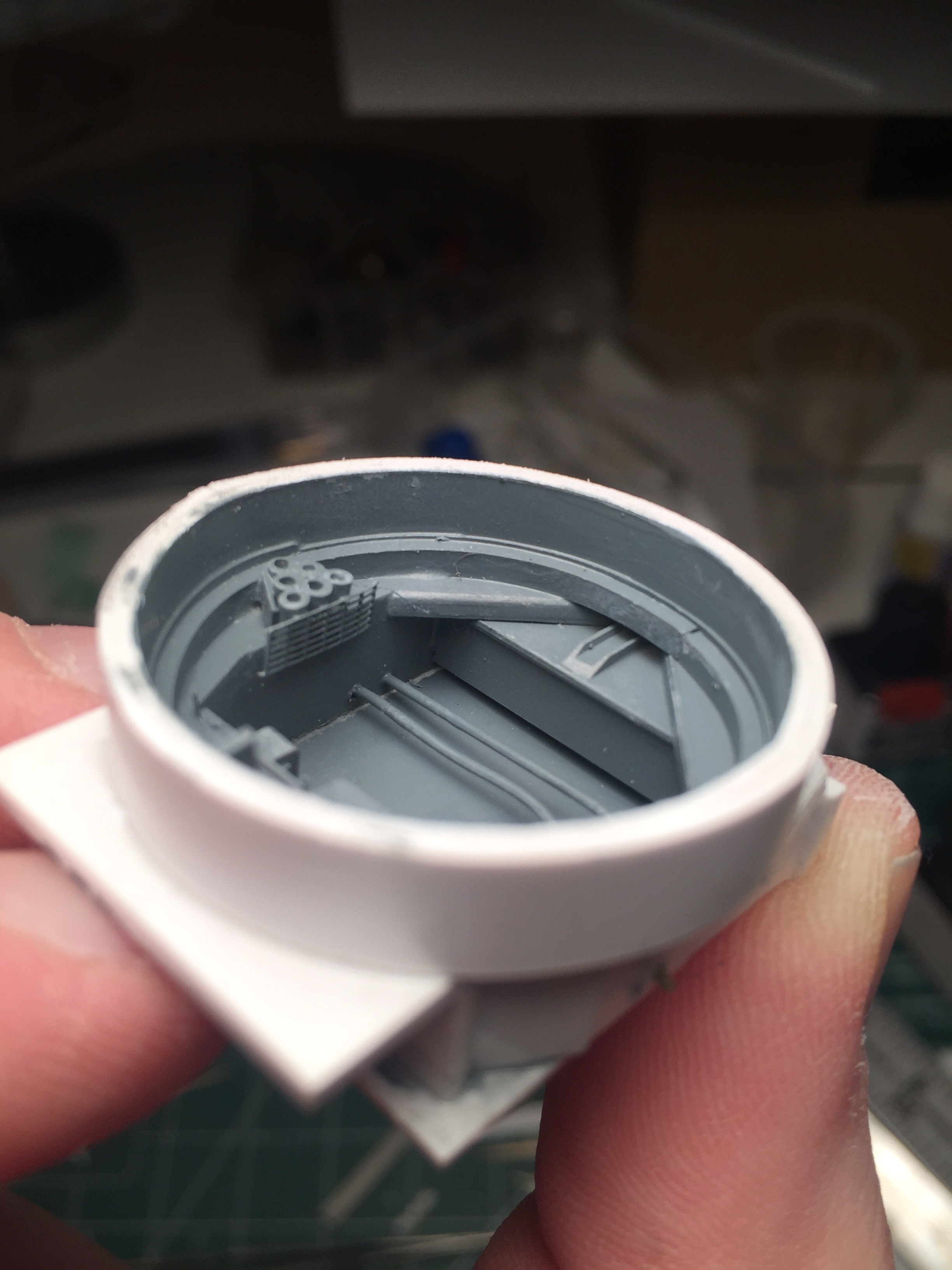

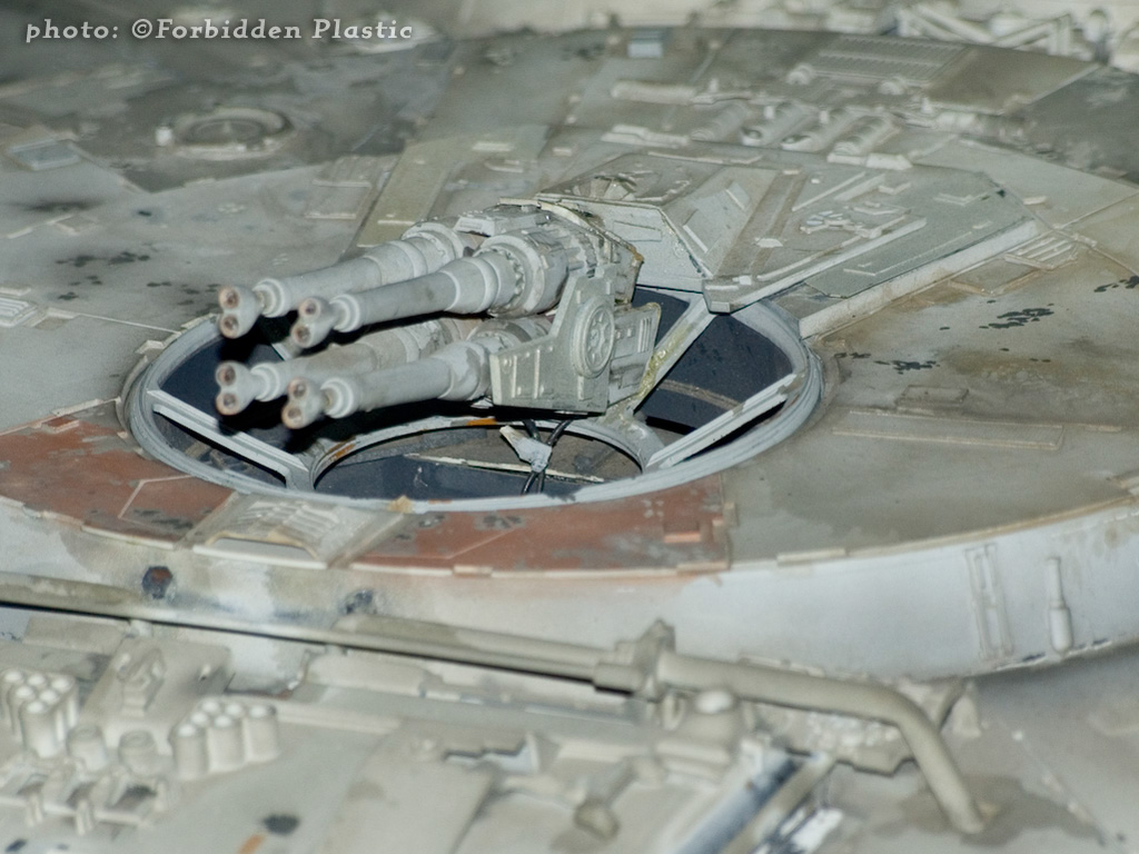

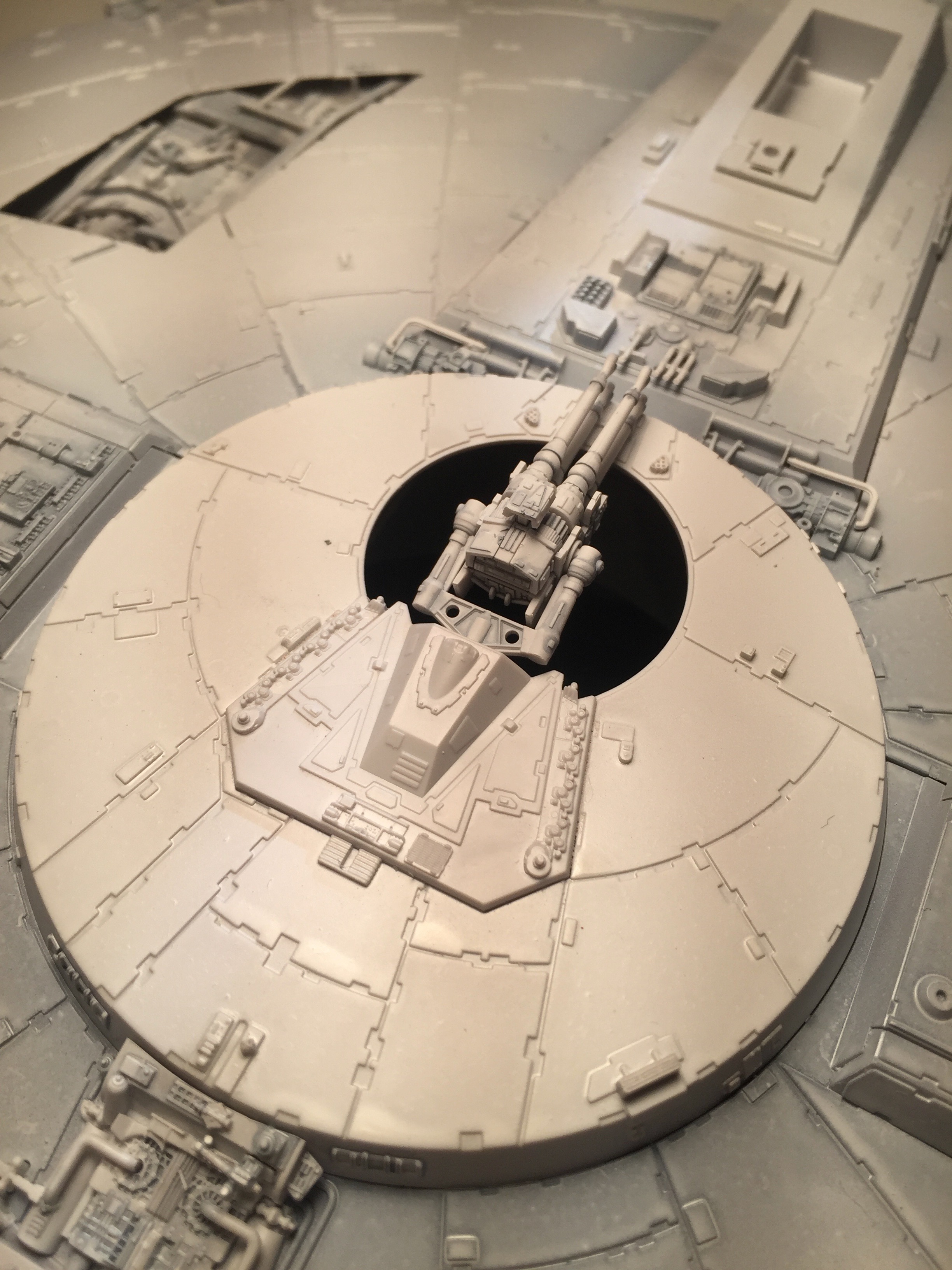

Next, I scratch built the "random" detail inside the upper gunport to match the 5-footer in these reference photos...
6d7cfd40908583.57918119df38a-1 copy.jpg8daebb40908583.57918119dd27f copy.jpge5fb207deae6f09736e12e39b4587ef4--millennium-falcon-millenium copy.jpg
And came up with this...
HOJ Upper gunport 1.jpgHOJ Upper gunport 2.jpgHOJ gunport 3.jpgHOJ Upper gunport 4.jpg

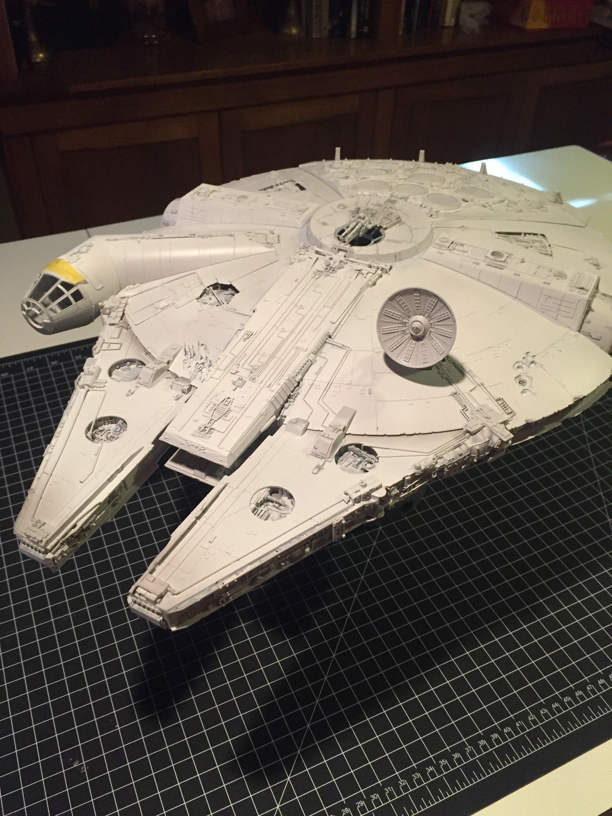

I now have the top hull attached and most of the final detail pieces in place. I gave the entire thing a coat of Reefer White, but still need to go back for a few touch-ups before I start the detail painting.

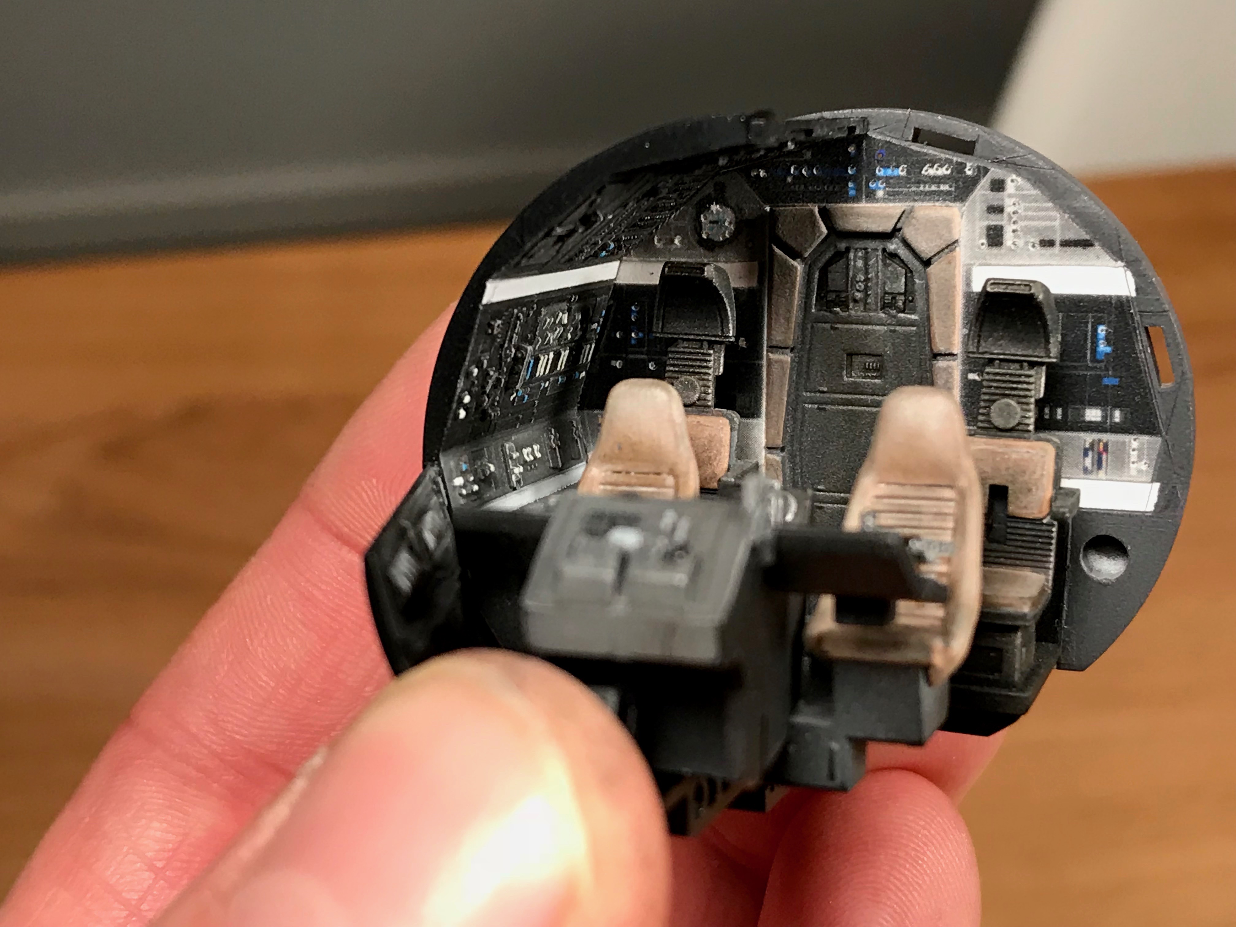

Today I'm ordering JoeCS's original cockpit off Shapeways. Thanks for looking!
