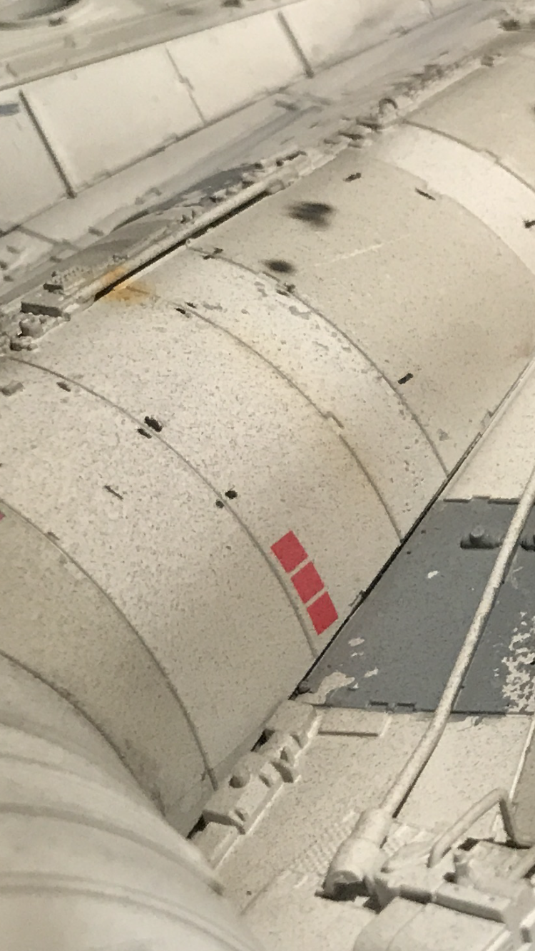

How are you guys going about recreating these blast marks? My initial thought was taking a pastel or grafite and smearing it. Thoughts?

About showing the damage on the edges of the hull - I used a pair of smooth needle nose pliers held against my soldering iron for a few second and then just bent and distorted in the places shown in research photos of the real 5'er. If you don't get the pliers too hot it works a treat.
One thing I did notice is that the research photos are almost all close-ups, so the tendency is to make details on the Bandai Falcon larger than the scale will allow. So, less is more on the damage to the hull edges and the blast points.
I used the rectangle and square notches on the hull plating edges as a reference against the photos of the real 5 footer, making sure bandai sized and located them in the right place, which they appear to have done.

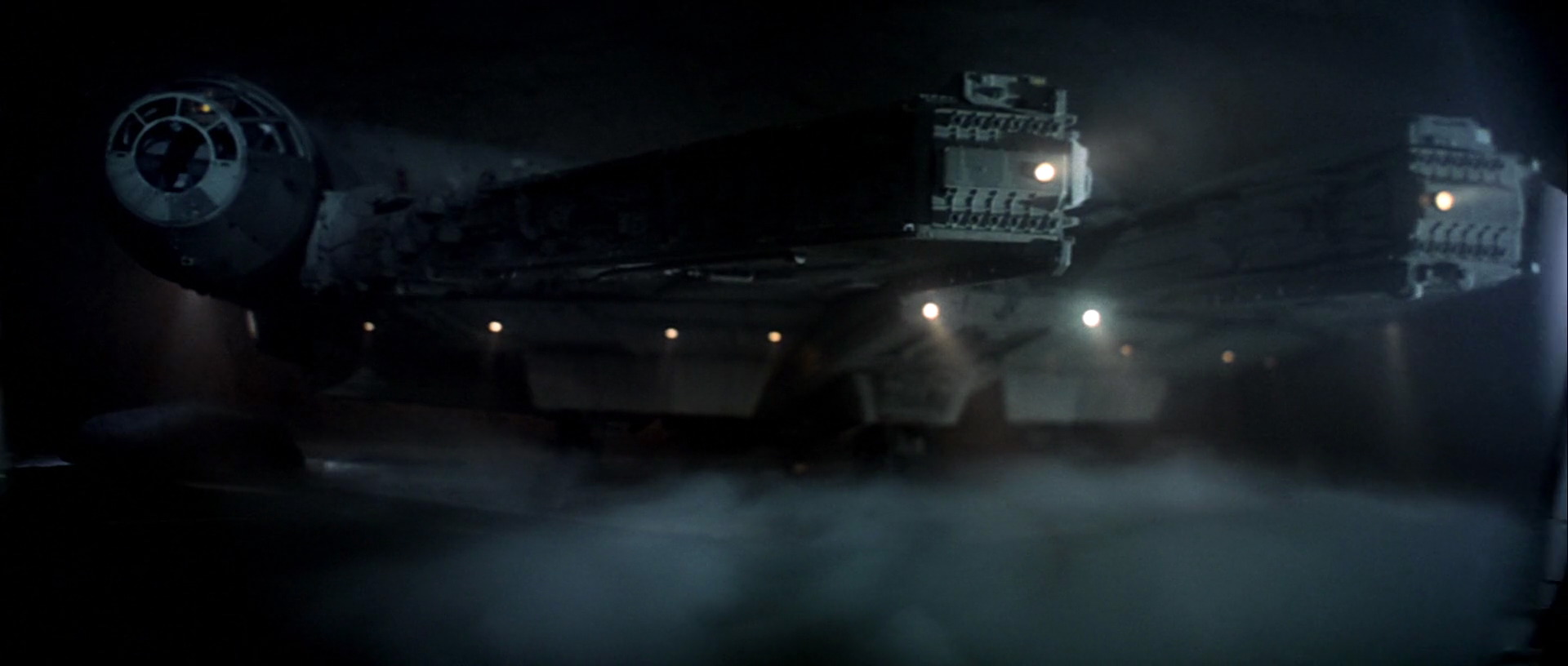

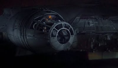

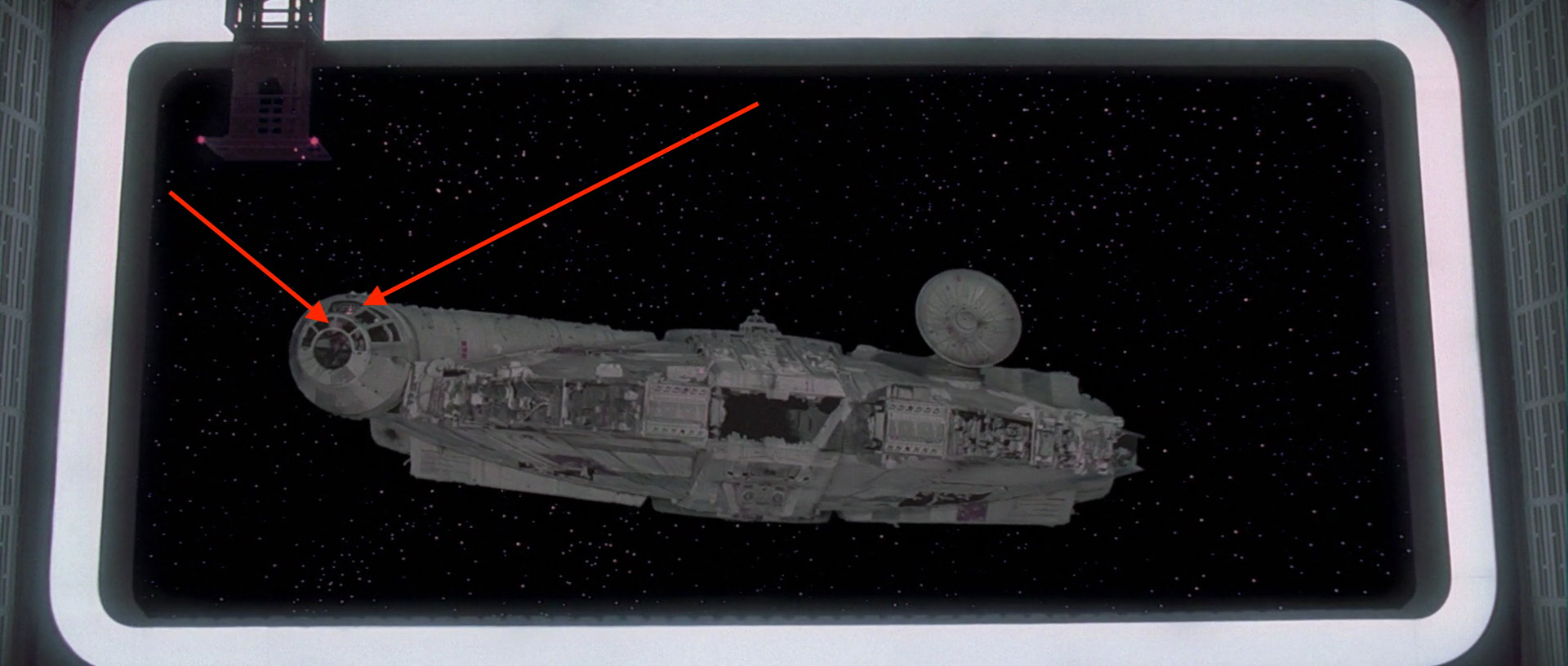

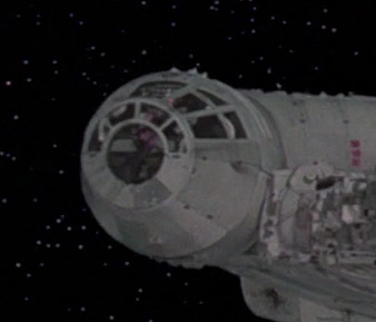

I was scanning through the ANH blu-ray last night and noticed that there seems to be some visible lights in the studio model cockpit during the backing out of the hangar shot. We know there were LEDs in the two lighter grey dashboard console boxes, but there seems to be an amber light visible on the board of gauges on the top of the cockpit back wall. I also suspect they may have added a couple figures into the Morgan seats because there are some shapes visible that don't correspond to the known details in the cockpit. I wasn't planning to light JoeCS's studio cockpit insert, but it looks like I'll have to do it after all.
Were those lights and figures there before the special edition ?

How are you guys going about recreating these blast marks? My initial thought was taking a pastel or grafite and smearing it. Thoughts?https://uploads.tapatalk-cdn.com/20171204/e59e76b3c5980c6f83a9af9f67eda6d8.jpg
Sent from my SM-G955U using Tapatalk
For those I angled my airbrush and shot it at low pressure similar to how the original was done. I appreciate that is hard to do though at this scale so I cheated on some areas, a dot from a sharpie then quickly smudged in the required direction with a cotton bud can work....
When I tried that with my airbrush I couldn't get them small enough. Were you able to o achieve the right size for this scale?
yeah it is very tricky to do, those marks where made with the airbrush:587939A1-F0AC-430E-AC14-780301539138.png

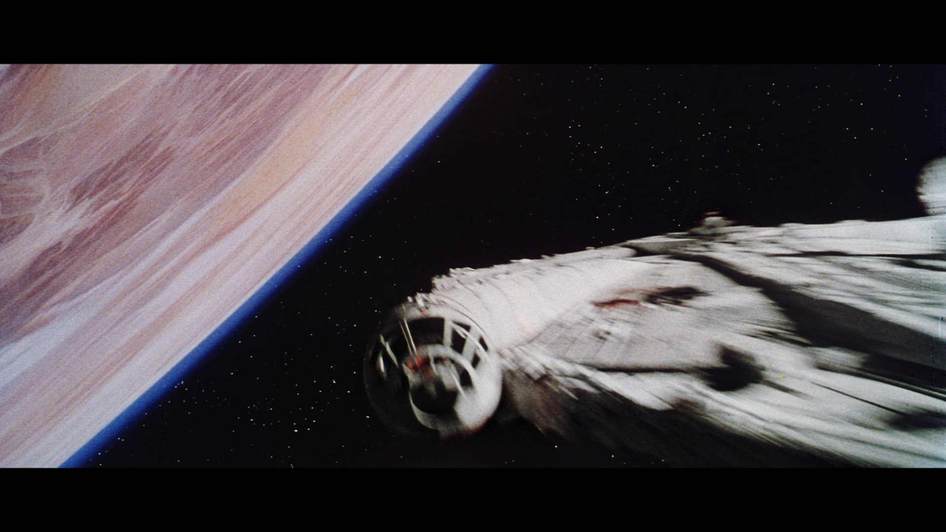

Well, to add to the conversation here is a photo from the new chronicles book with the same reddish color in the cockpit. It doesn't quite look like an illumination to me, but I can't tell for sure.

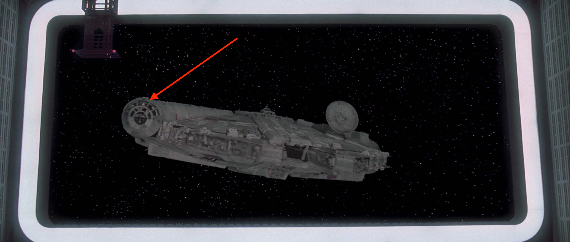

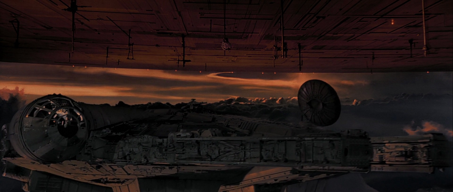

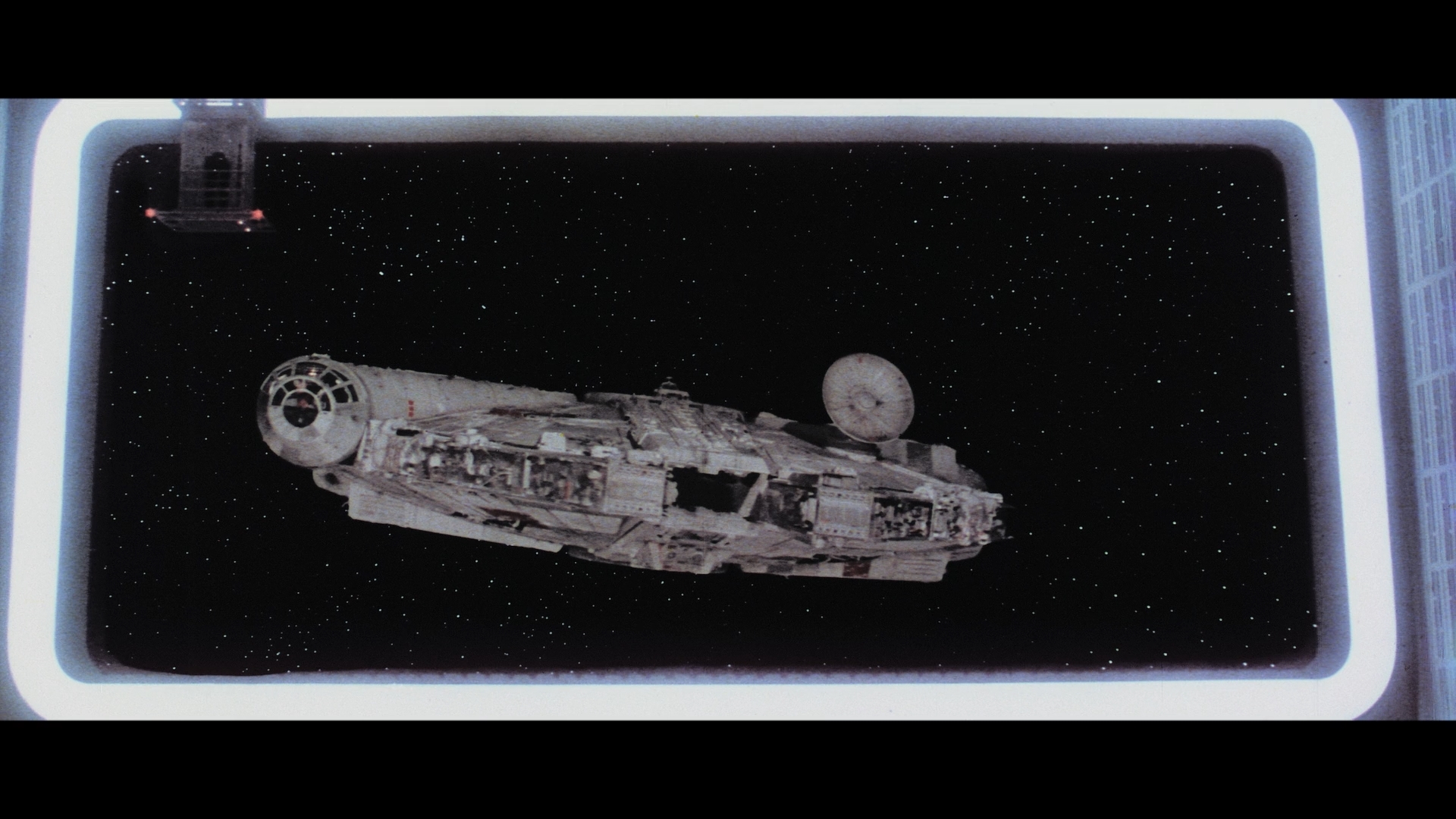

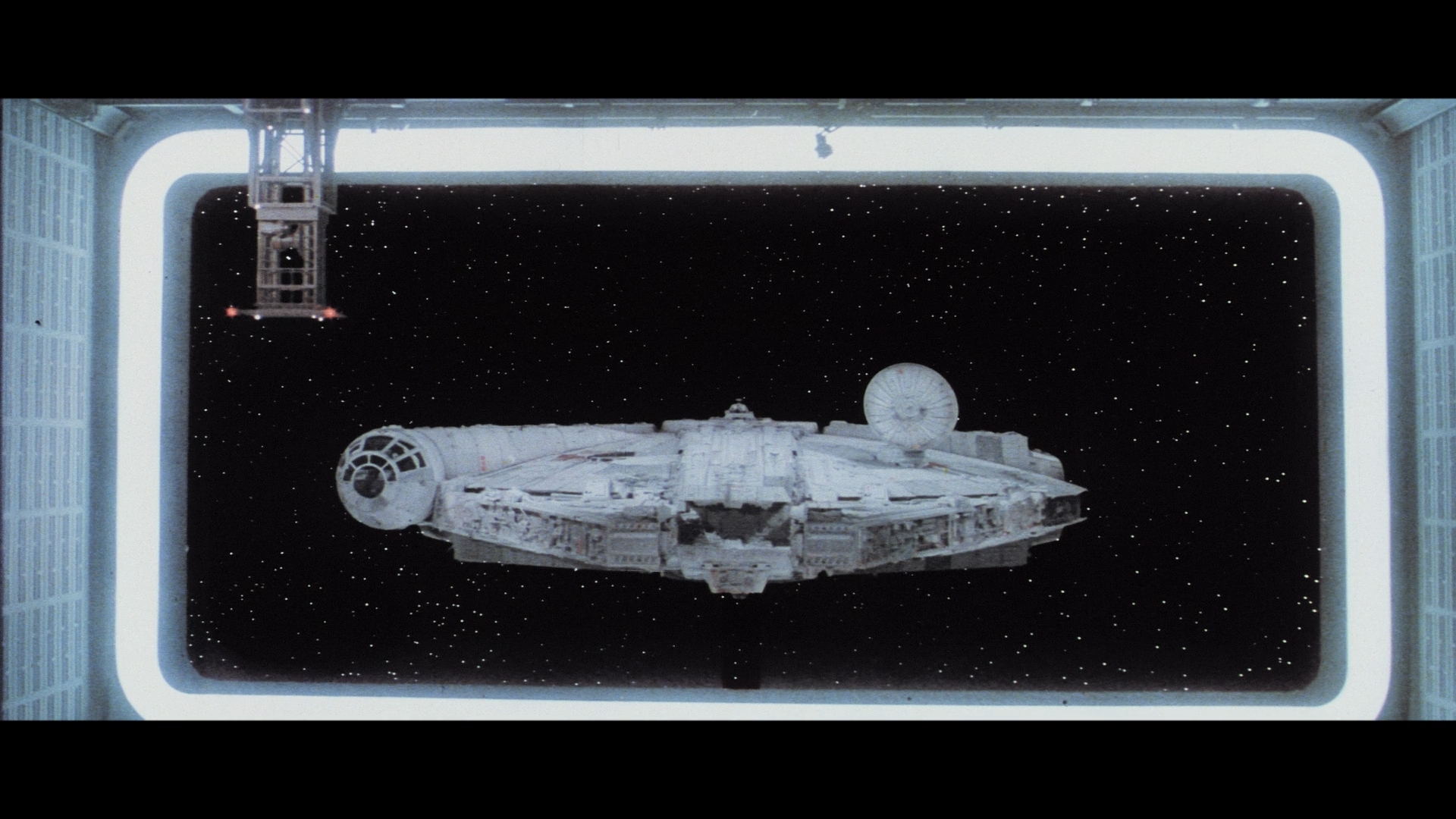

That brownish shape can be seen in nearly every shot in ANH. I've assumed it was meant to be Chewie in the co-pilot seat, notice that it is not there when the Falcon comes aboard the Deathstar as everyone was in the hidden hold by that time. The light is also present, in ANH and ESB non-SE.
Star Wars Episode IV - A New Hope 35mm (1977).mkv_snapshot_00.54.01_[2017.12.04_12.45.32].jpgStar Wars Episode IV - A New Hope 35mm (1977).mkv_snapshot_01.03.58_[2017.12.04_12.48.11].jpgStar Wars Episode IV - A New Hope 35mm (1977).mkv_snapshot_01.31.17_[2017.12.04_12.49.25].jpgStar Wars Episode IV - A New Hope 35mm (1977).mkv_snapshot_01.36.34_[2017.12.04_12.54.50].jpgesb.jpg

That ESB cave shot is pretty conclusive evidence that there is some sort of amber/red light in the overheard gauge panel. The light seems pretty concentrated -- it doesn't backlight the entire panel. So is that a fiber optic poking through or is it a light behind the panel illustration that is just too close and giving off a really strong hotspot?
As for "Chewie", there's also definitely something there that isn't in the regular cockpit images. In the ESB cave shot, did they stick a tiny Leia doll in there? She's roughly in the same position she is in the live action shot.

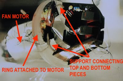

Whoa, Joe! That cockpit photo is amazing! It looks like they built the cone sections of the cockpit and attached them directly to a ring (white) connected to a fan motor (also white), which would explain why they made those funky white roll bars on either side -- to connect the top and bottom pieces or (I'd bet) to conceal the wires for the lights. It also definitely looks like the upper gauge panel was intended to be backlit, making that amber light a hot spot.
