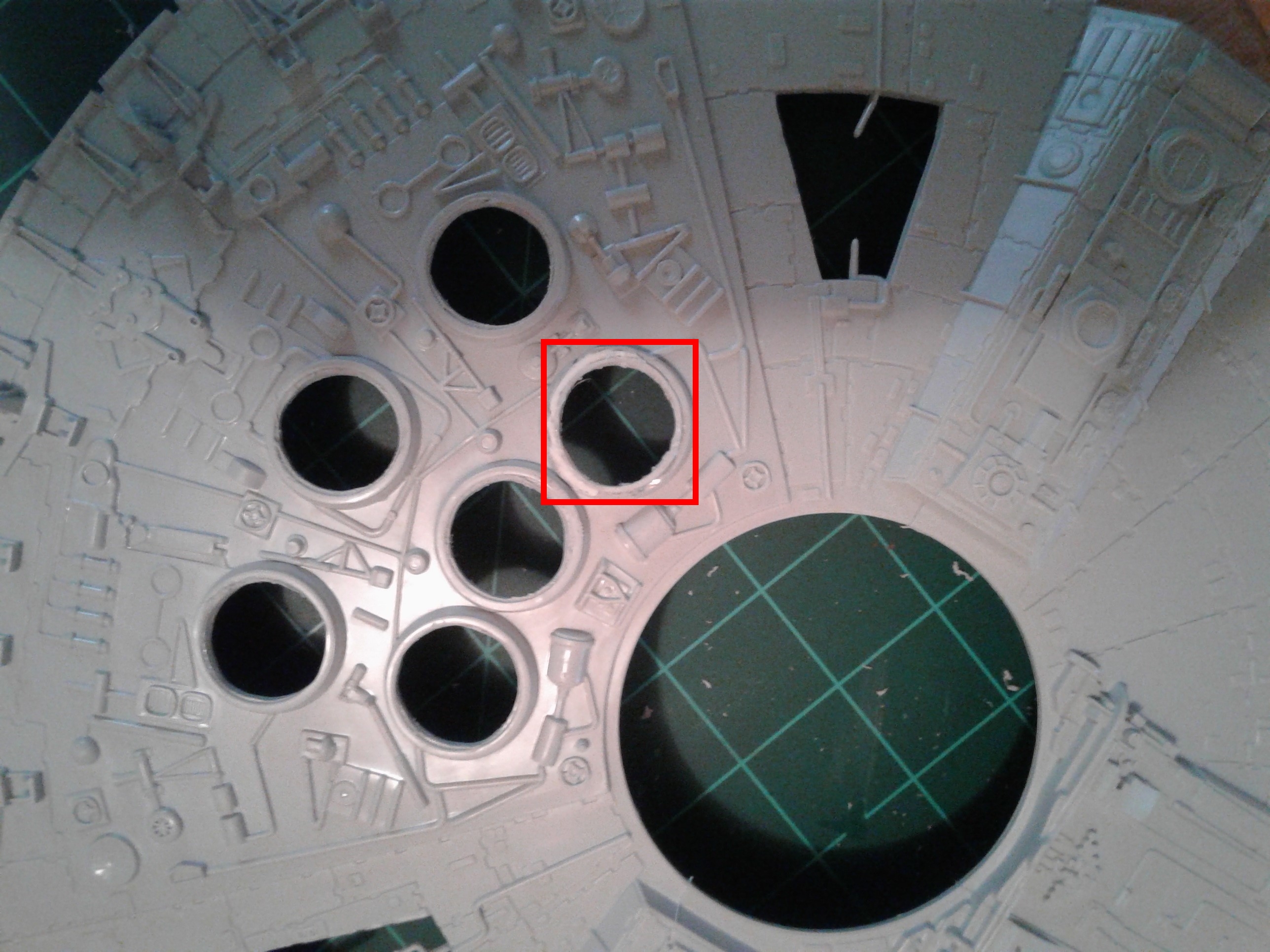

OK, so I've finished top and bottom hull prep - Had an engine intake ring mishap with the dremel. I was carefully tapping away and in my Zin-mode, then the dogs burst out with a fit of barking at someone walking down the street and, well I slipped. I had to do some major surgery with a spare piece of curved styrene and contour putty. I think things will look ok after some black primer and a base coat.

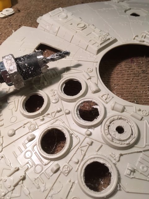

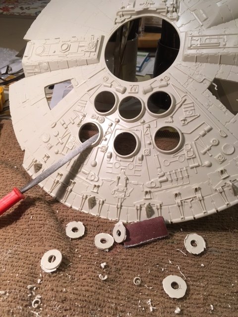

looks like we're at roughly the same stage of our builds. I got the walls up and landing gear hsng 4 and 5 on. going to drill my engine fan holes today, this will be the first time on that procedure. I'vefalcon 5 build pic7.JPGfalcon 5 build pic6.JPGfalcon 5 build pic4.JPG got a nice hole drill set but the bit set screw walked so off to the hardware store. also will be drilling out the landing light holes in the lower hull and attaching the light cans. I chop up a bic click ink pen tube, work great. also pic is the nearly finished landing ramp hull couplers. I really like this modification.

falcon fan holes 1.JPGthis what I used, progressively larger holes drilled from center that I located with a pair of digital calipers. then trim with xacto, then tiny semi round file, then sandpaper. I also did something else new on this one...filed out the tiny notches on the edge of the hull. looks good but my laptop lost the pic. ahh, found them. I've also taken to trimming down those rails on the top front of the hullfalcon fan holes 2.JPGfalcon top hull mod front.JPGfalcon hull edges.JPG
