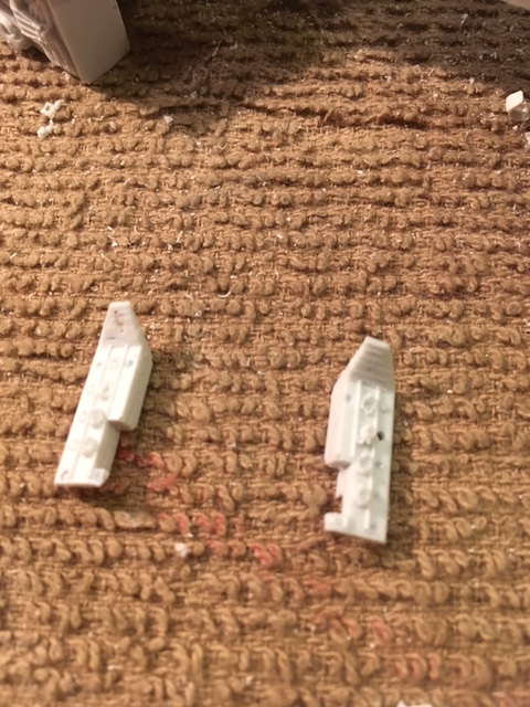

Ah! True, the mandibles do need be trimmed but as far as I can remember from the box art build it doesn't actually matter too much, the only place on the upper hull that the locator pins really do need to be removed is in the engine area
Assuming that the Aft/Back engine deck area will be lowered as well, will the hollow connection pin on the bottom hull need to be trimmed and sanded? The digital instructions (as well as jpeg) only hint at trimming the ones closest to the front mandible area. Hey, really looking forward to this build! Thanks HH miniatures!
Must've been an oversight on my part.....all the pegs need removing and cleaning up. I'll update the instruction files ASAP!

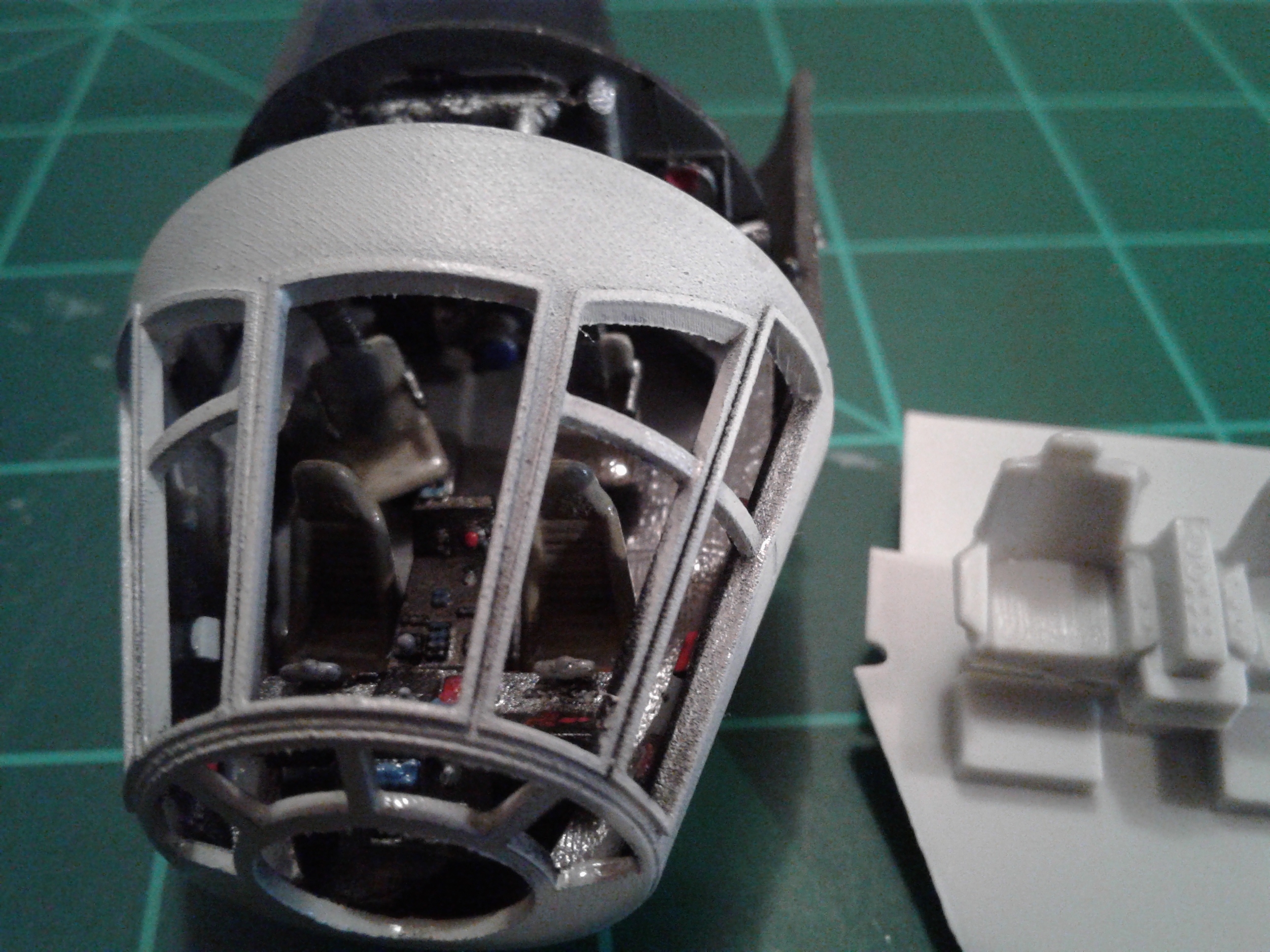

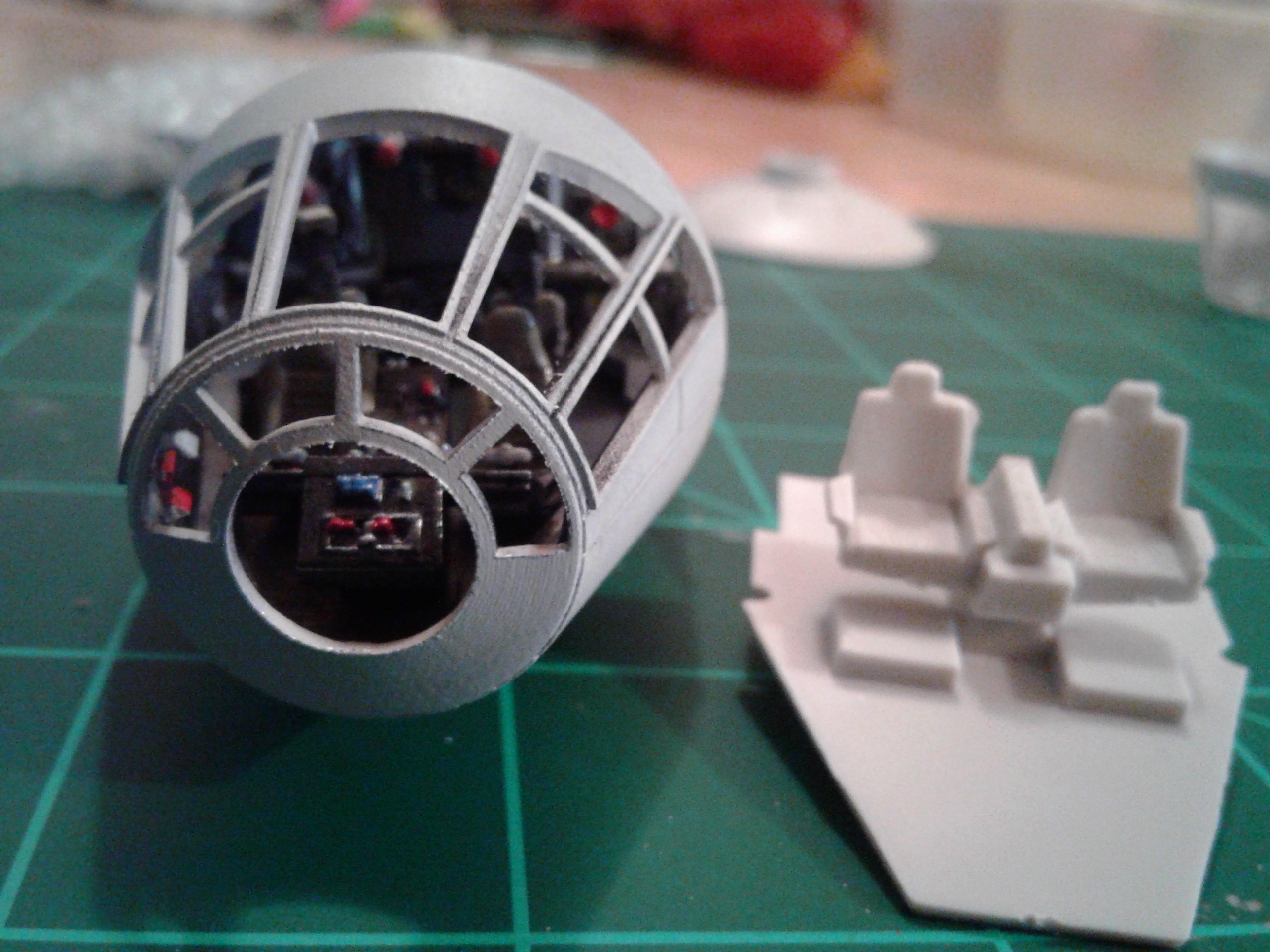

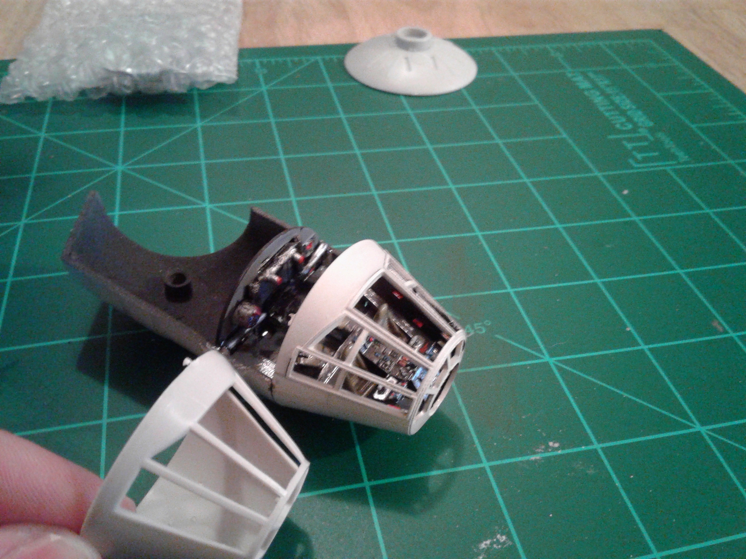

Thought I would get a head start on some of the simpler stuff in this build while waiting for the HH Min. kit to arrive (Shipped today, Yeah!). I have bought some Shapeways Parts as well and boy, am I glad I did. The difference is astounding. I have some side-byes to compare.
for sure, great looking cockpit! I think the cockpit cone is the only thing I haven't used but I've used the cockpit interior on 3 builds. Tough fit when you light the ceiling piece, have to drop it slightly which screws up the wall lighting alignment. Say, if you're doing a landed ramp down, I highly recommend the Shapways landing ramp, it's far and away better than the stock MPC parts. I think Tony is also working up a ceiling for the landing ramp corridor. Other Shapways pieces for "landed" ships I really like is the ESB additional front landing gear and housings. Some of that stuff can be a bit spendy, but it sure makes a huge difference.

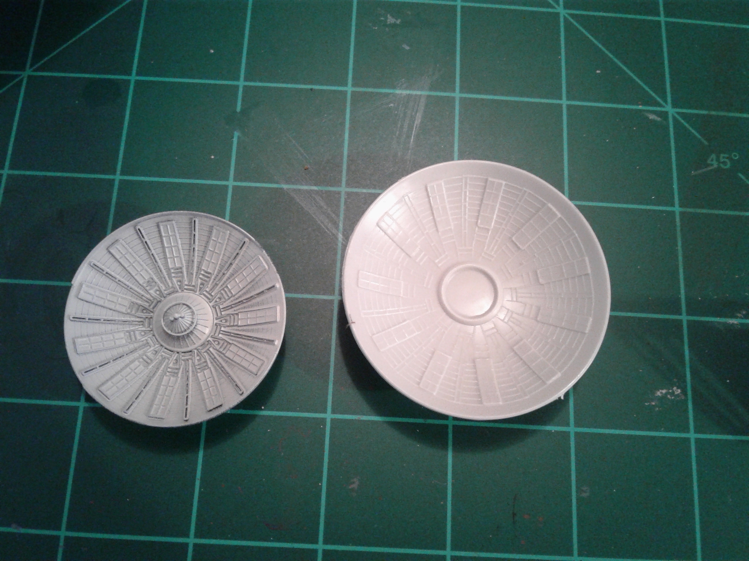

Hi Haystack, Here you go - https://www.shapeways.com/product/Y...pc-combo-cabin-cone-cockpit?optionId=56434201
https://www.shapeways.com/product/E...-radar-5-footer-44-mm-w-mount?optionId=621703

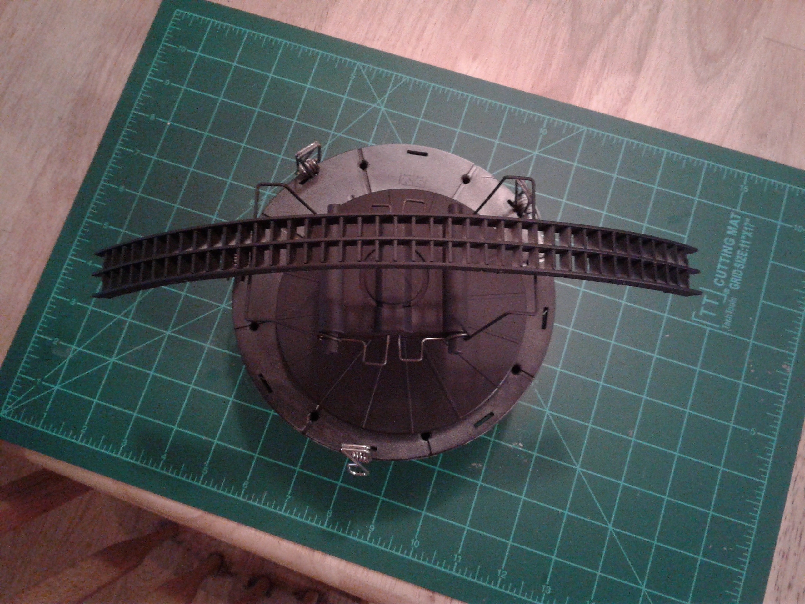

Also, I'm gonna attempt to use this for the Aft/Back engine exhaust grill, it's the reduced height egg crate kit from Star ship modeler. Can't remember the exact dimensions. Do you happen to know anything about their parts in relation to the HH miniature parts?

As far as I know the SSM 'egg-crate' engine pieces should fit perfectly !
