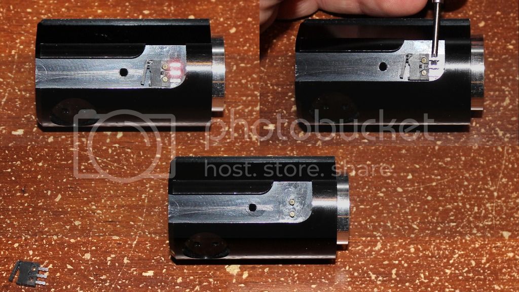

As for the slide switch, it is either a rivet holding it all together or if it's like my older Parks v1 replica, is a square piece with a rod shaped protrusion on two opposite sides that are then peened over on each end to form a lip to hold it all together. Either way, you will most likely ruin it if you try to remove it and will have to custom fabricate the hidden part to rebuild it. If you're very careful, using a rotary tool you can shorten the tab on the inside so that it works with a snap action switch. Here's what snap action switch looks like when installed on a TGS blade holder...
I used 1.5mm dia. brass rod that I then glued into the two small holes already present on the TGS blade holder, using 2 part metal epoxy. After cleaning up excess epoxy with a toothpick and tissue paper, I set a snap action switch over the rods while the epoxy was curing so that the rods would be perfectly aligned once the epoxy was set.
That's great many thanks.
