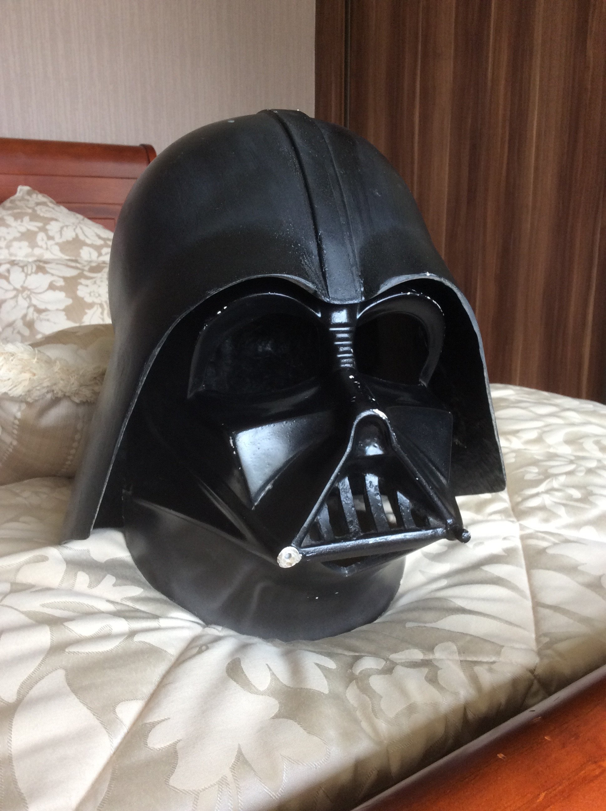

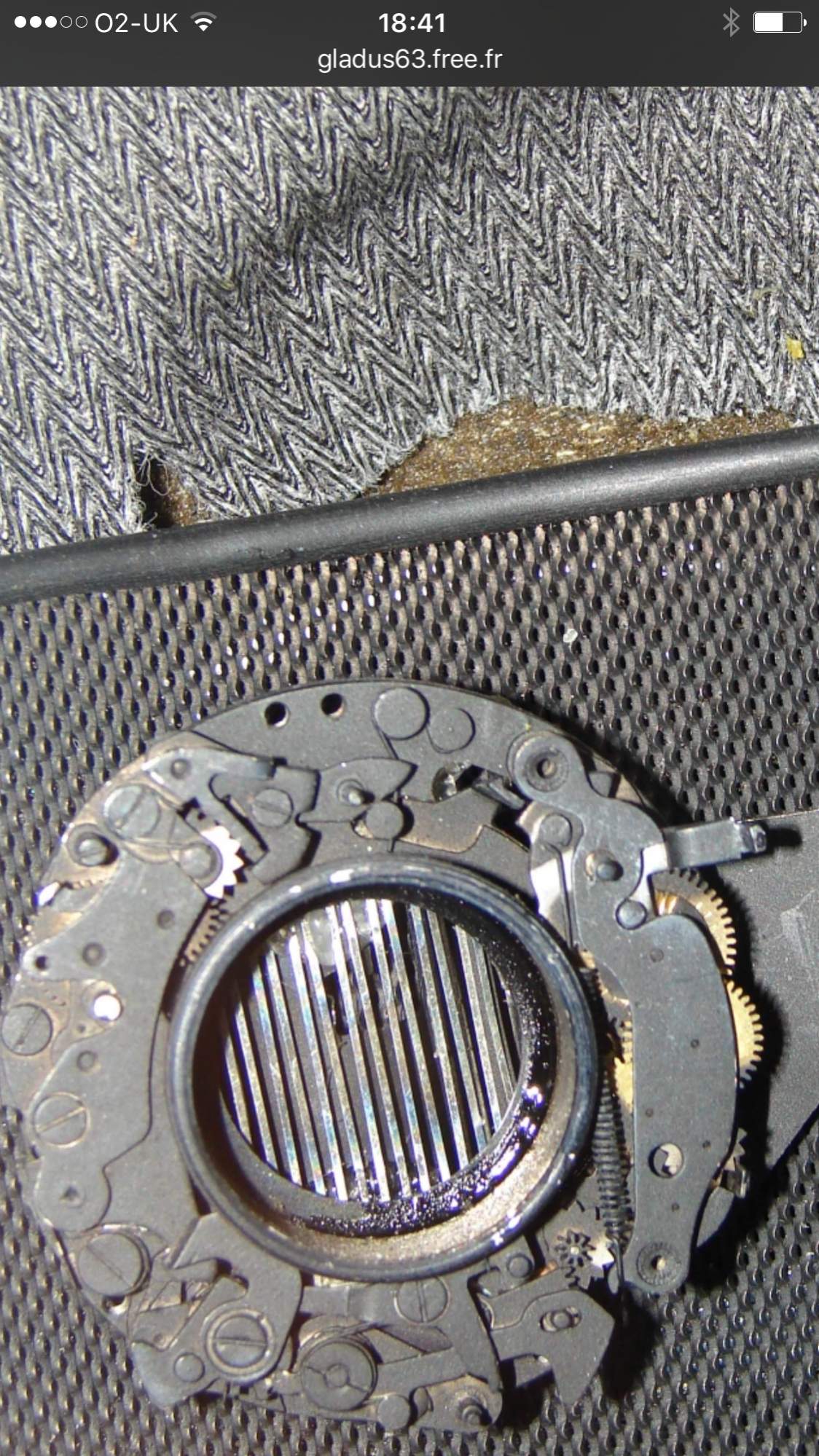

    Jul 9, 2016, 12:24 PM - Re: Bengrim's Darth Vader reveal project #76
    Bengrim09 said: View Post
    The original
    Attachment 640013
    QUESTION what sits inside the lense ?
    That's what I'd love to know as well ... anyone know what it is?

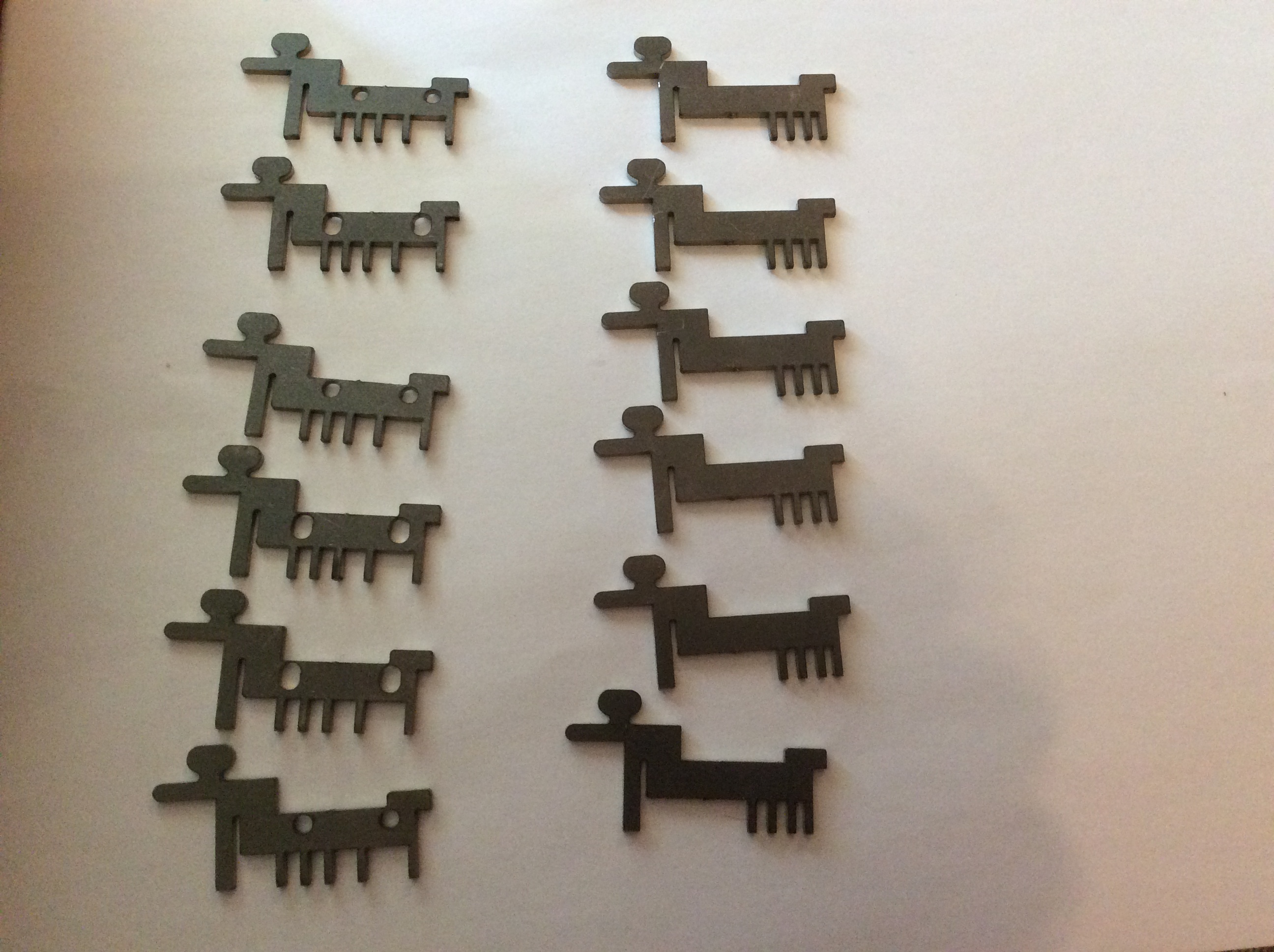

    Jul 9, 2016, 5:41 PM - Re: Bengrim's Darth Vader reveal project #77

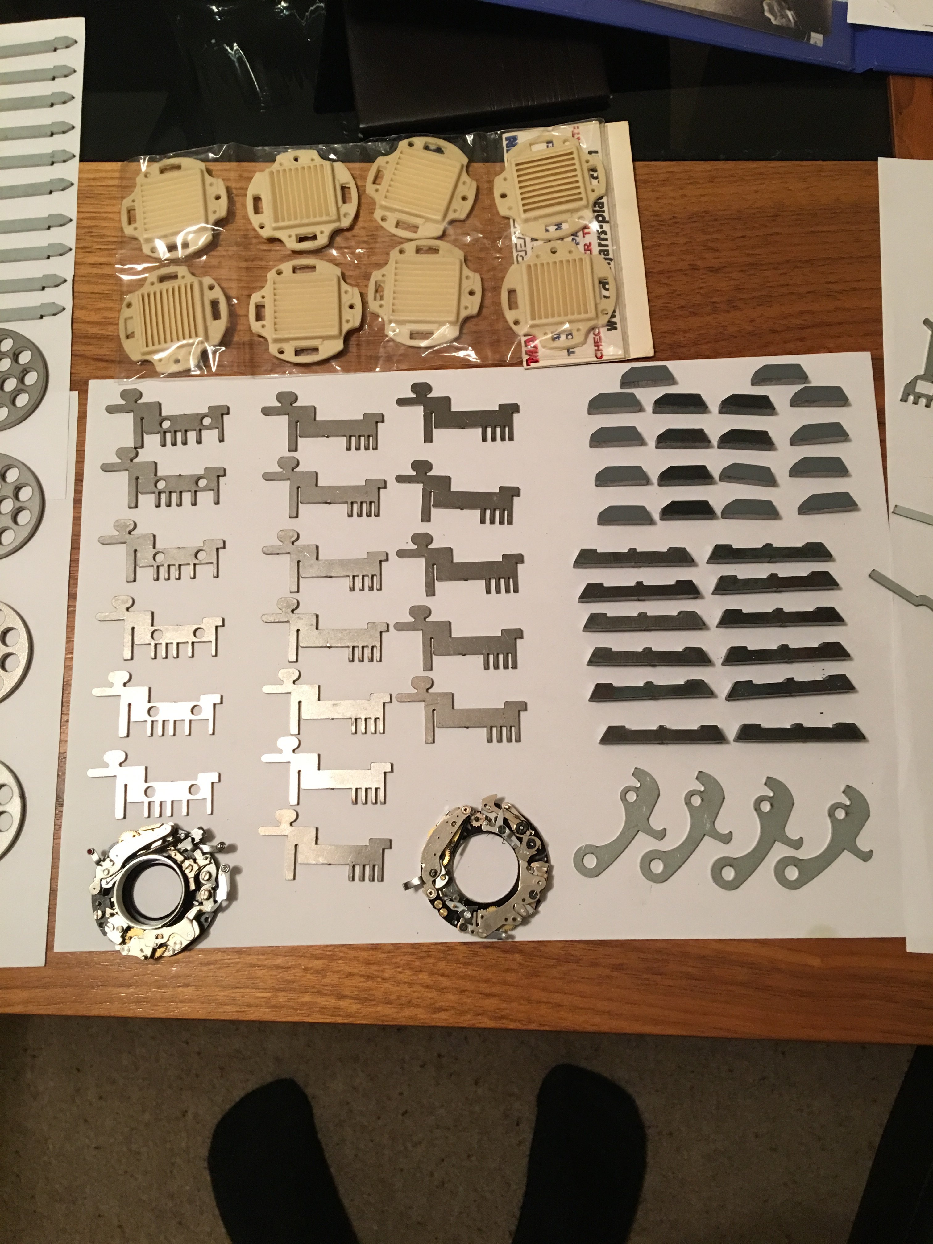

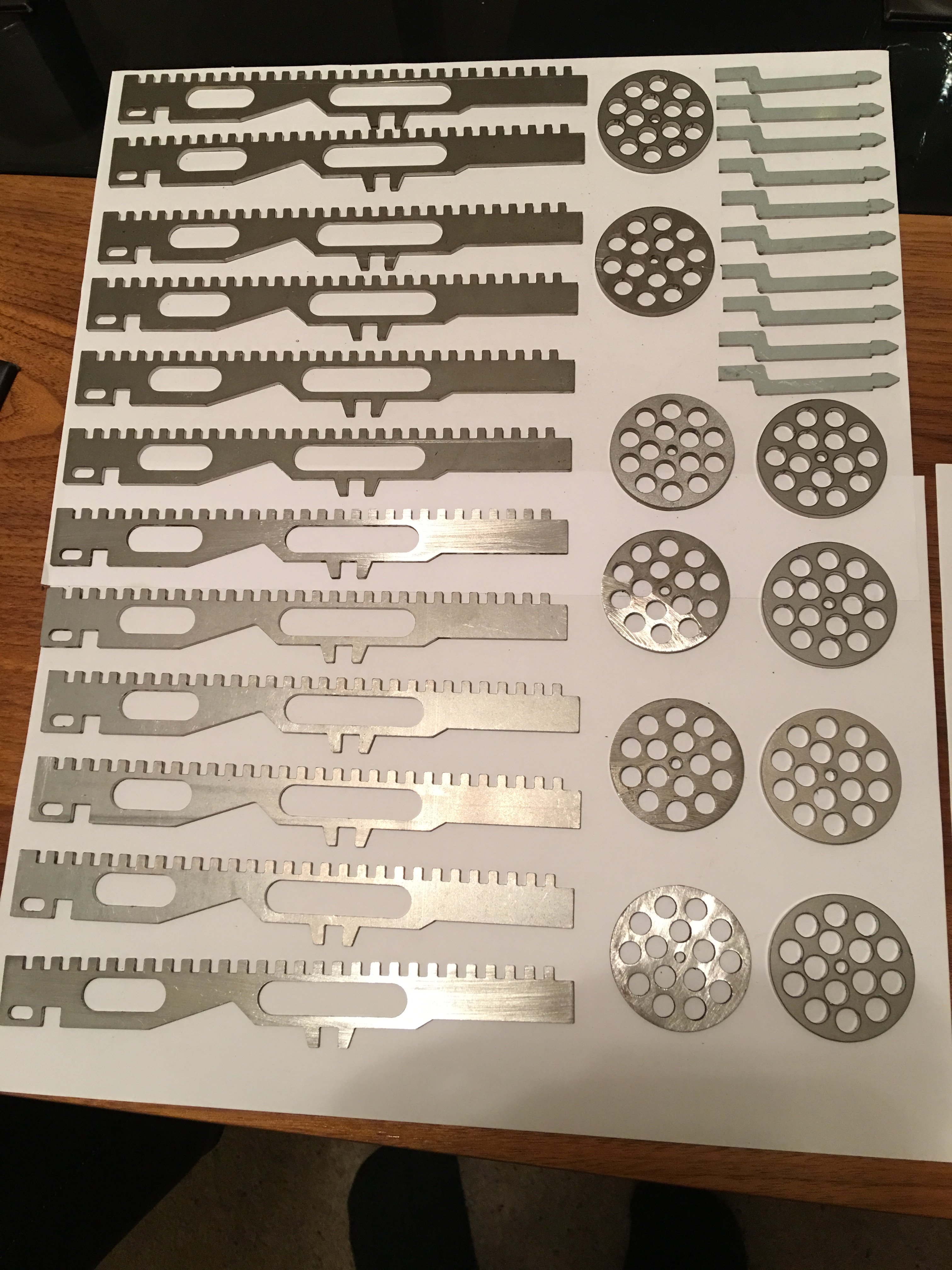

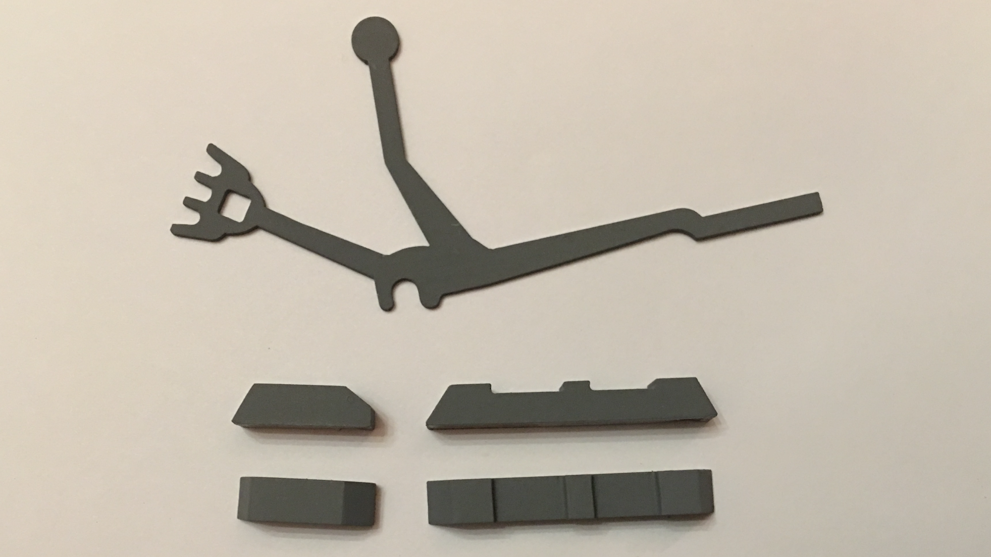

    Had a bunch of stuff delivered from my " laser cousin " this evening, didn't realise that 3 months work drawing re-drawing and drawing would look this good
    Click image for larger version.
ID:	642560Click image for larger version.
ID:	642561Click image for larger version.
    Apart from the last pic of the fork linkages waiting for the re-cuts to come back
    got my other camera today for the left hand lense will pull that little puppy apart Sunday evening ( not the puppy !!! The CAMERA)!

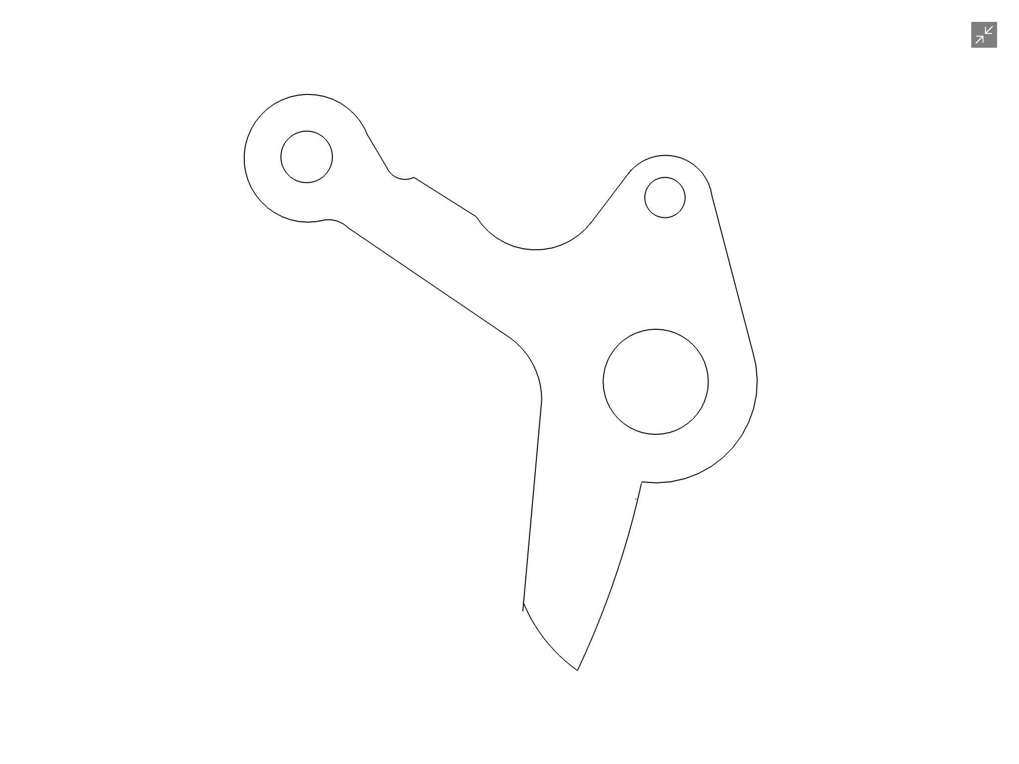

    Jul 11, 2016, 4:41 PM - Re: Bengrim's Darth Vader reveal project #82

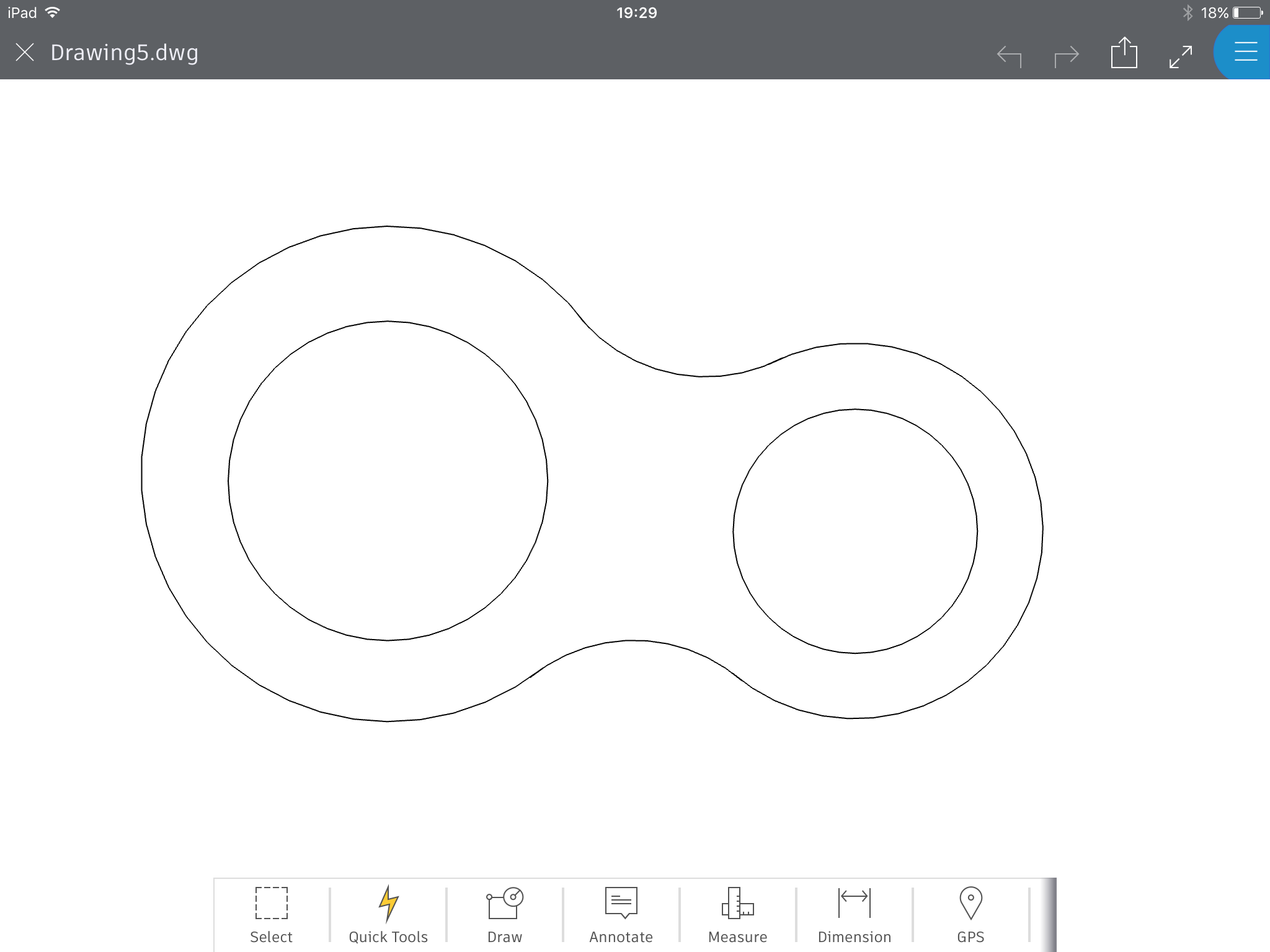

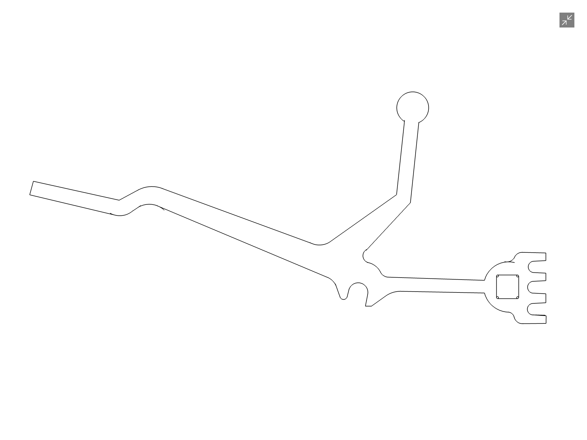

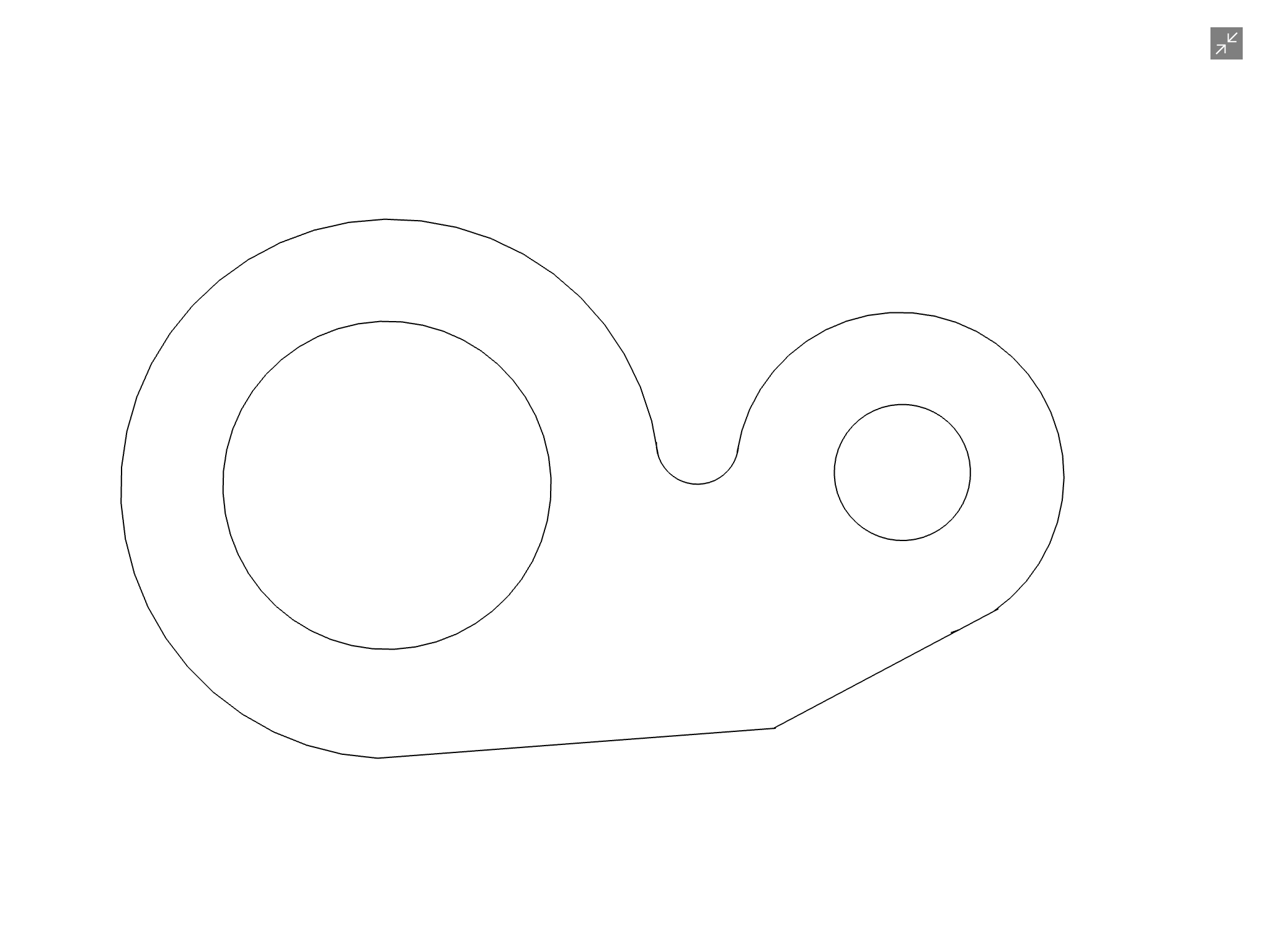

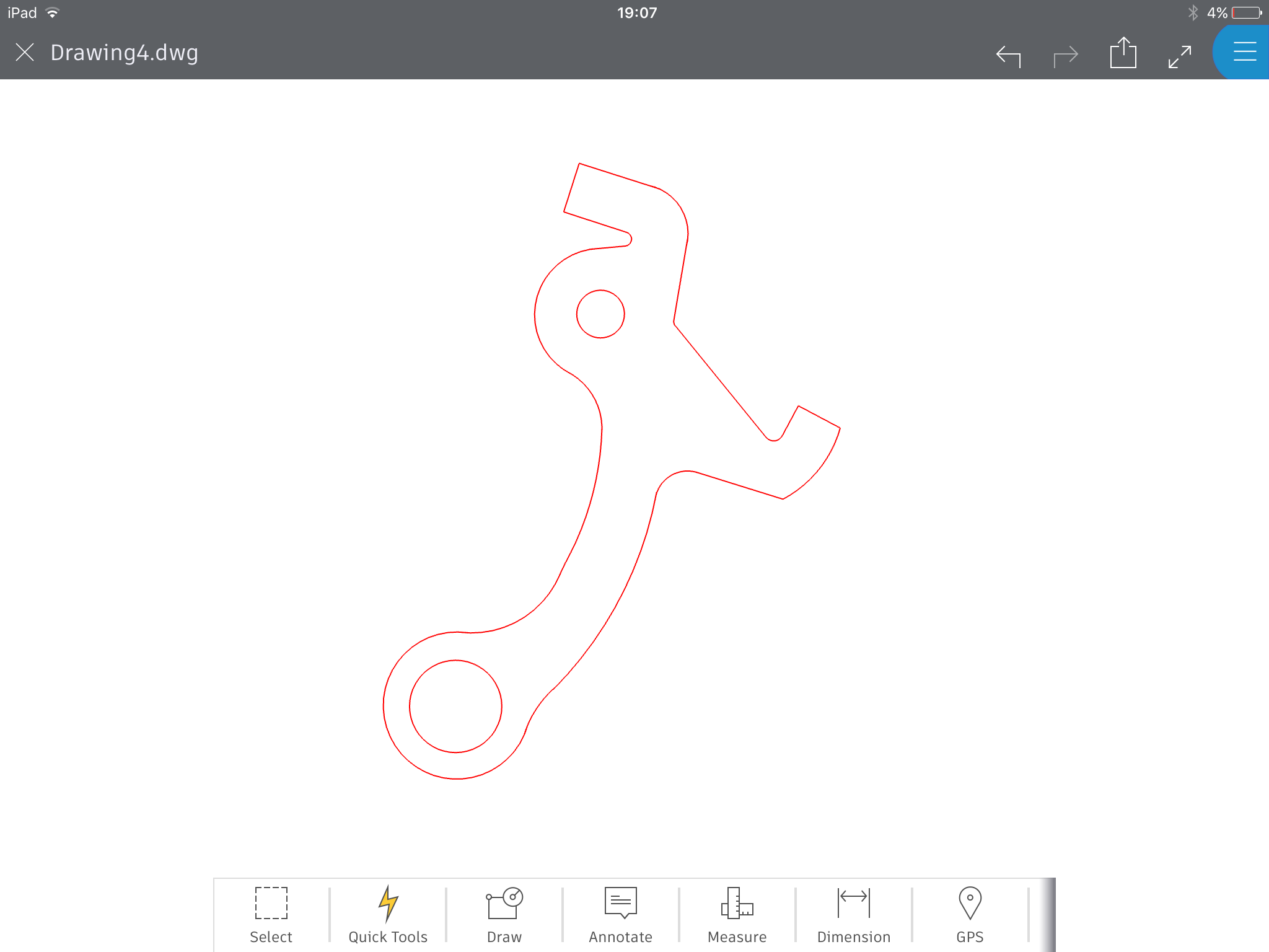

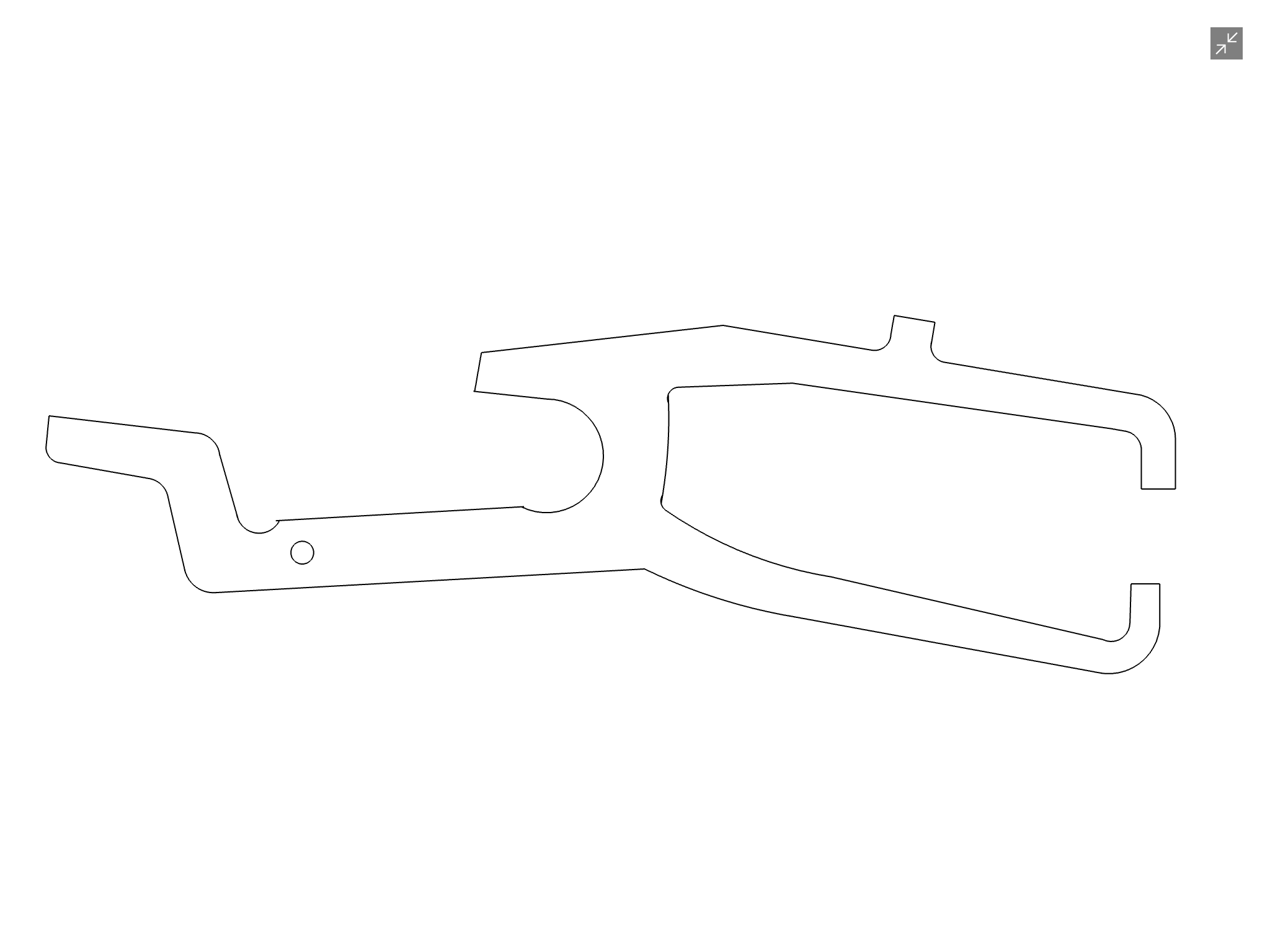

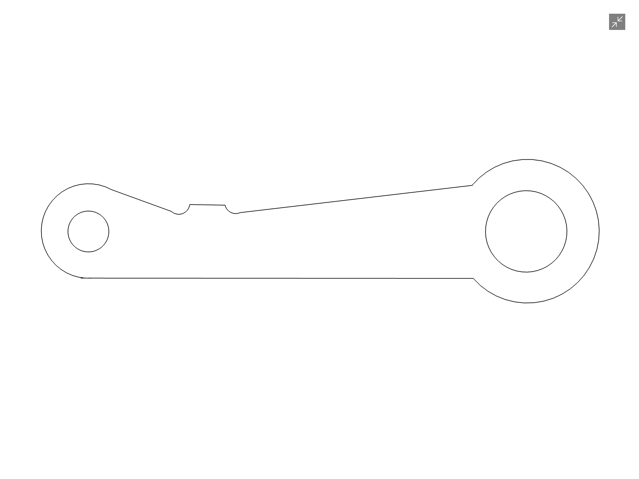

    Done a bit of refining to the front linkage
    from this
    To this
    For this

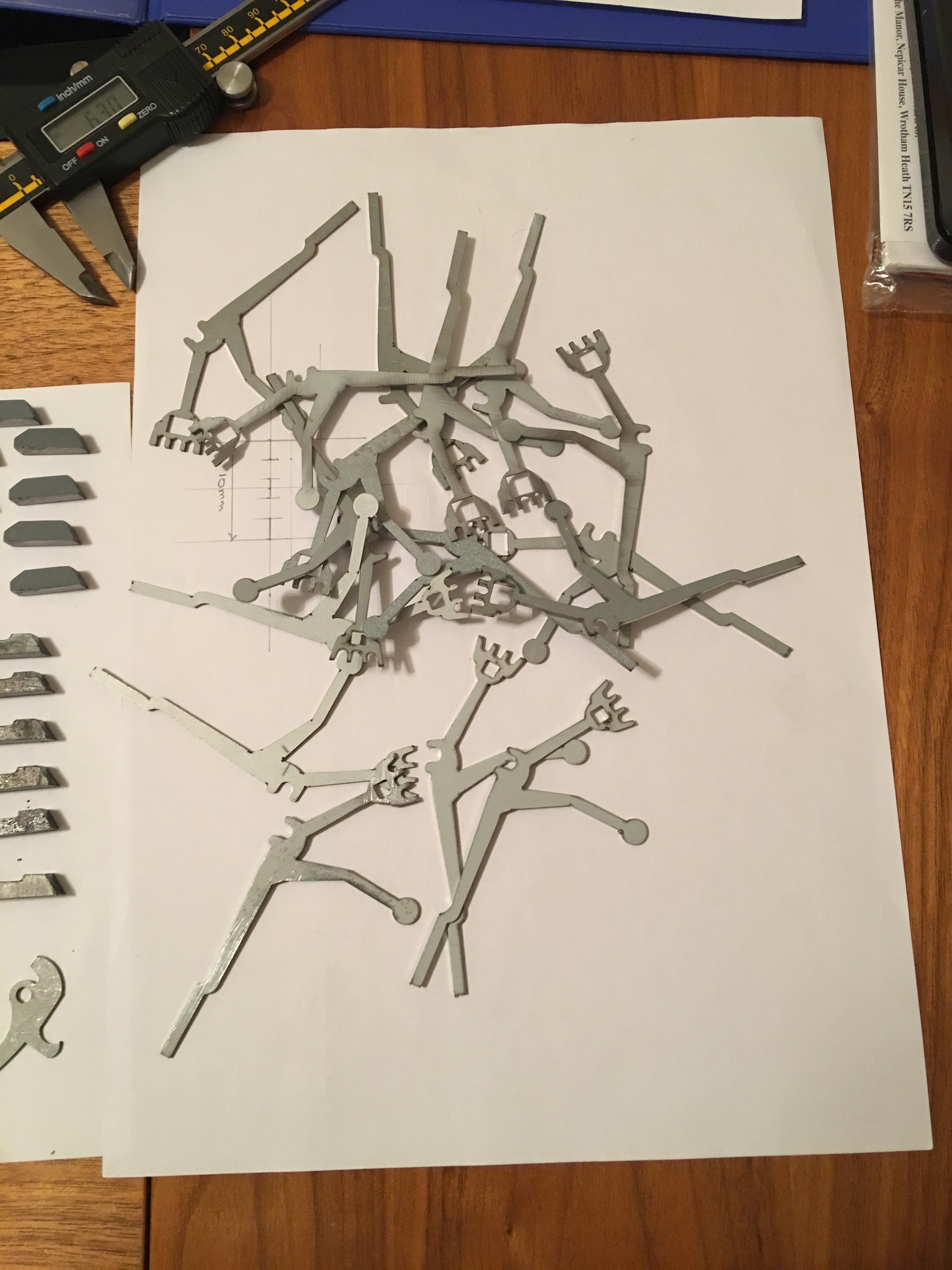

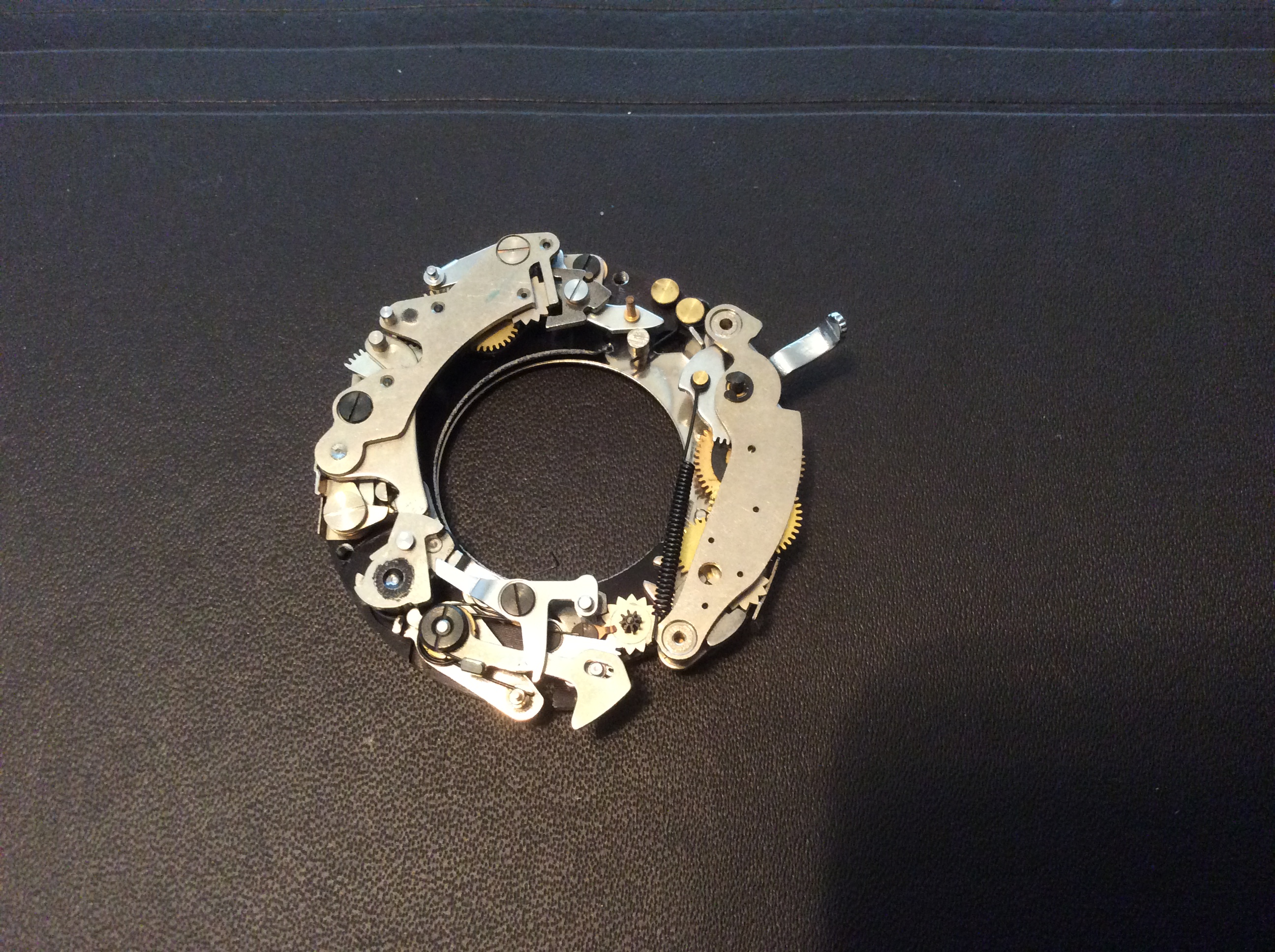

    Aug 1, 2016, 3:34 PM - Re: Bengrim's Darth Vader reveal project #94

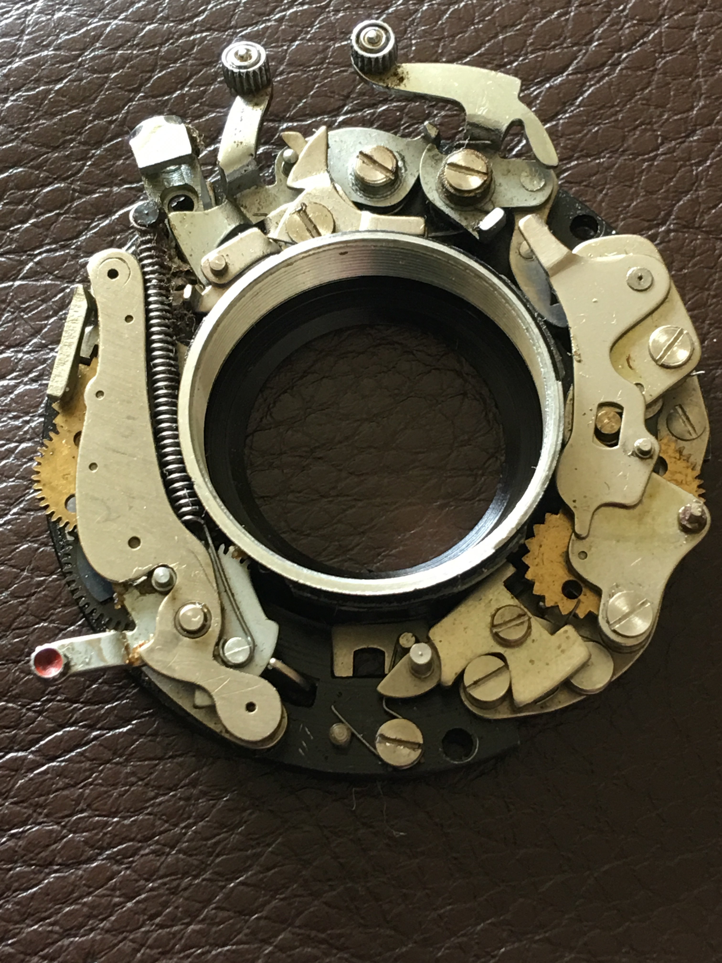

    My seagull camera arrived on Saturday for one of my correct shutters and I promptly removed it
    Then I got 0.5mm staples and flattened them out and separated them individually
ID:	650200Click image for larger version.
    Then I placed them on some sticky tape at the correct distance apart so all are visible through the centre of the shutter

    Aug 2, 2016, 4:16 PM - Re: Bengrim's Darth Vader reveal project #95
    Sym-Cha said: View Post
    Chaim
    how does this look Sym-Cha
  21. Sym-Cha's Avatar
    Member Since
    Jun 2008
    From
    Groningen, Netherlands
    Messages
    5,850
    Aug 2, 2016, 5:51 PM - Re: Bengrim's Darth Vader reveal project #96
    It looks quite acceptable and a genius solution using large staples to recreate those metal strips ... in true propmakers fashion
    Chaim

    Aug 8, 2016, 5:28 PM - Re: Bengrim's Darth Vader reveal project #100
    Had the second brow piece back today just need to refine and clean it up also looking at getting come small stamps for the lettering LTRS
    Piece no1 was not as I wanted it to come out the teeth spacing was wrong so I re-measured and had it re-cut piece no 2 is now ok clean up and refine the edges will see this little puppy done
    The lettering is looking about 2mm
    Either going to stamp them or wait and see what the laser print looks like when it comes back
