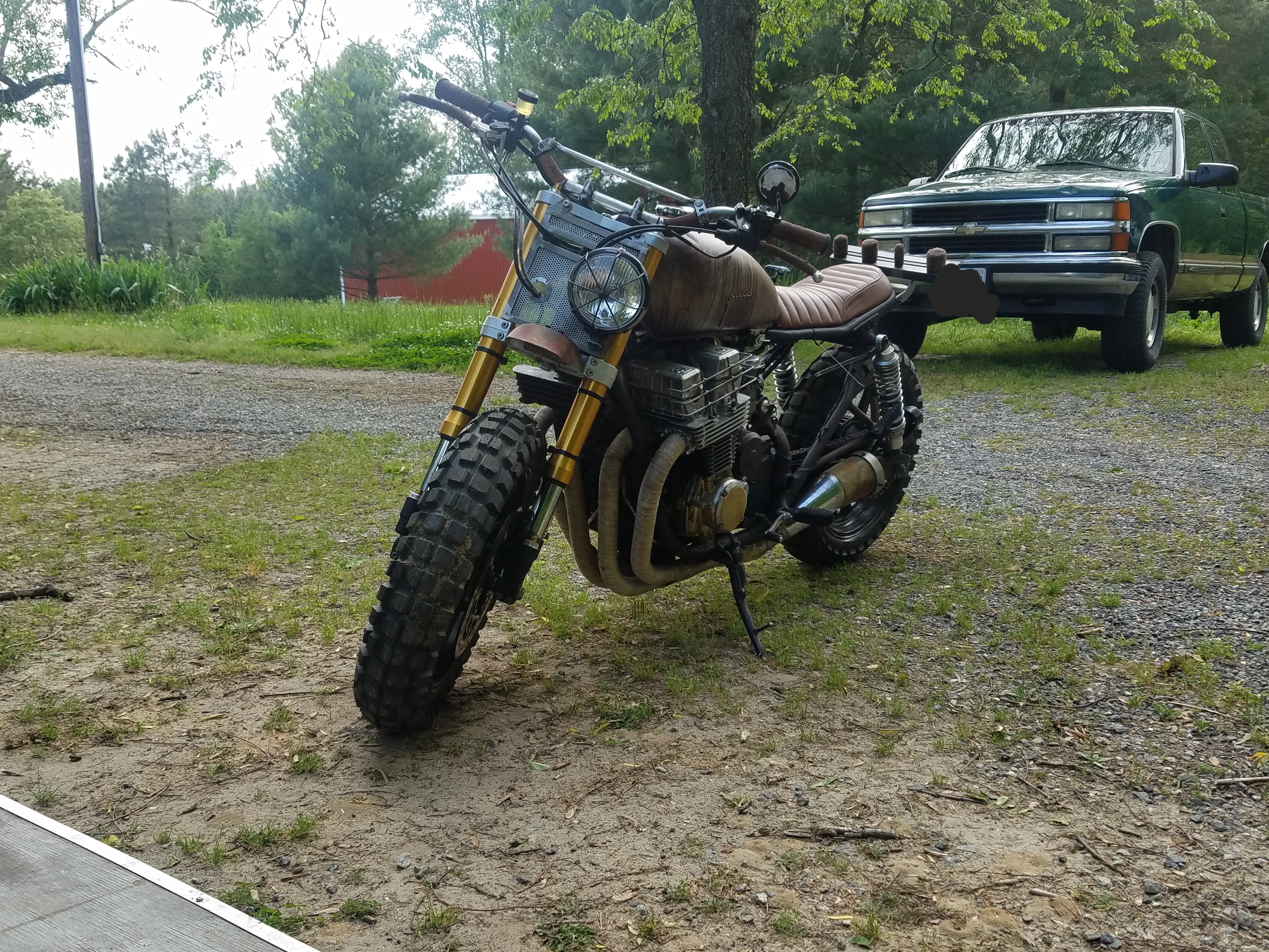

I just finished my version of the bike, thank you for all the tips nstevic01!

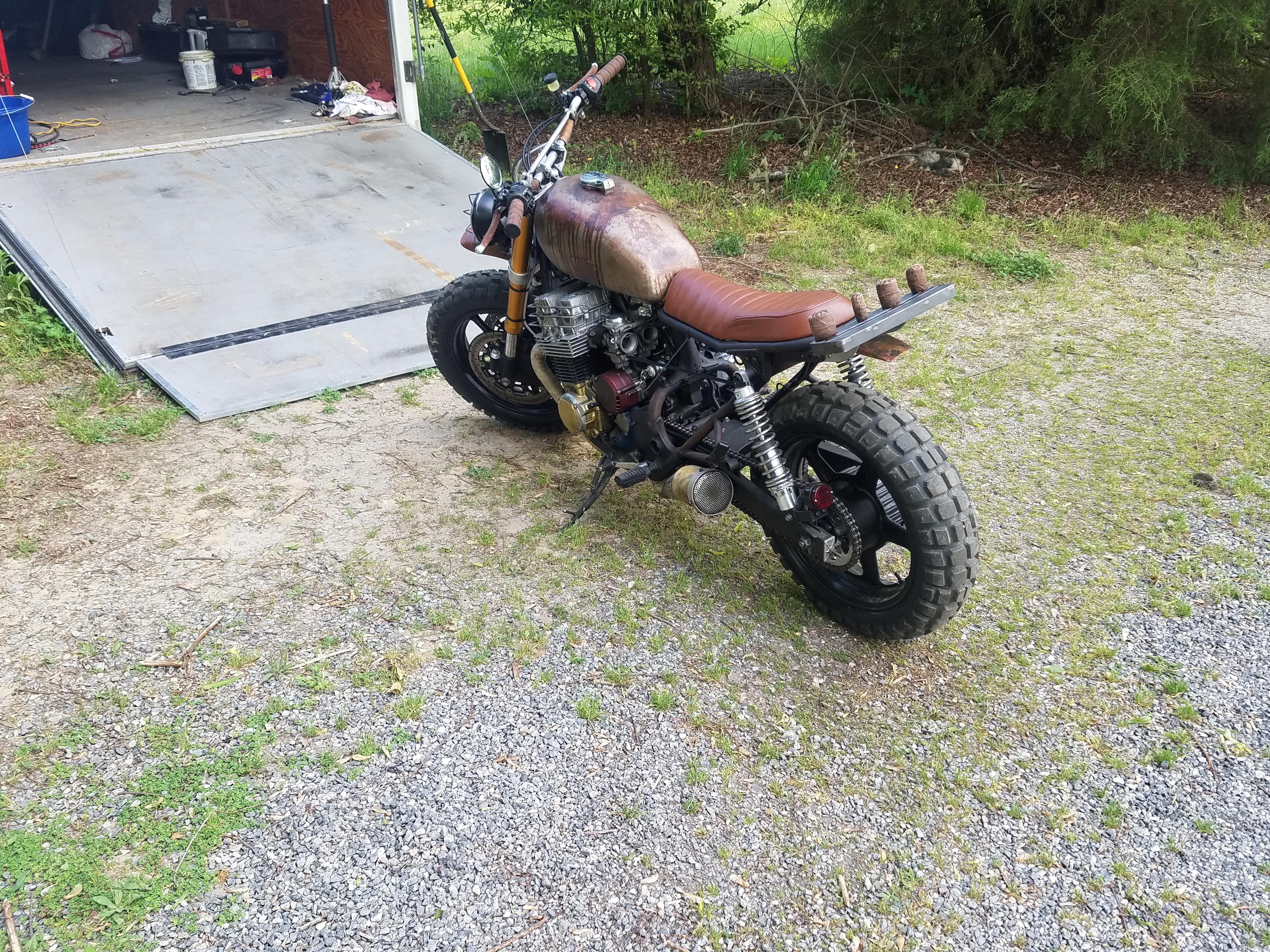

Got my seat back today. Looks pretty good do the most part. Only mistake was the guy didn't put in the stitching for the rear on the right side, so I guess I'll tackle that on my own.
