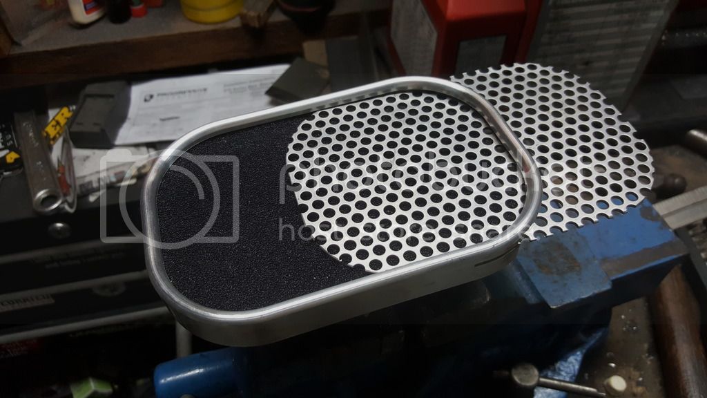

And can you open the box for replace airfilter of is it whitout filter. I see there was open air intakes whitout filter for motorcycle but i want one with a filter
Indeed it can.

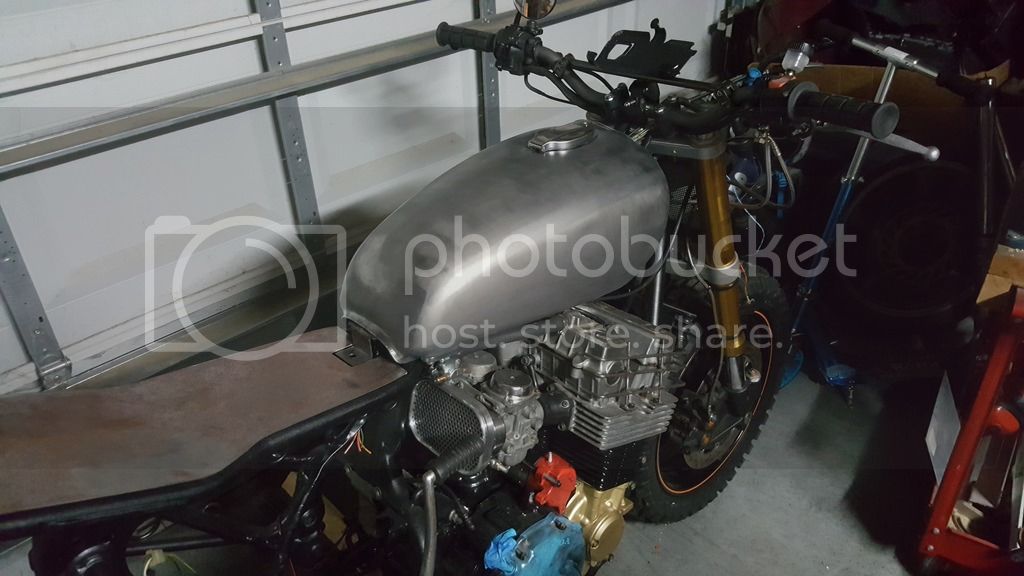

I am very, very close to getting it ready for the first start. Just need to torque down the engine covers, change the oil, and mount the tank. Cut, wrap and out the exhaust. Then I can turn the key.

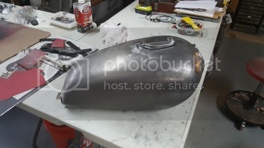

Not just yet. Next up will be balancing the wheels and mounting them with the swing arm, chain, and rear brakes. Still have to bleed the front brakes, do an oil change, finish the tank, seat and crossbow rack. Just aren't enough hours in the day between work and family. I'm hoping to have it completely ready for show by the fall. Ideally when a con rolls around that has Norman attending.
