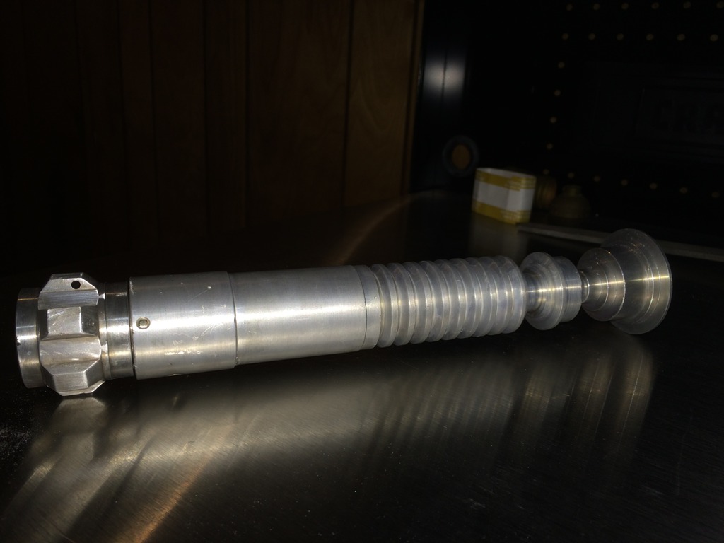

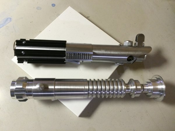

heres a few pictures of how the saber came to me, perfect

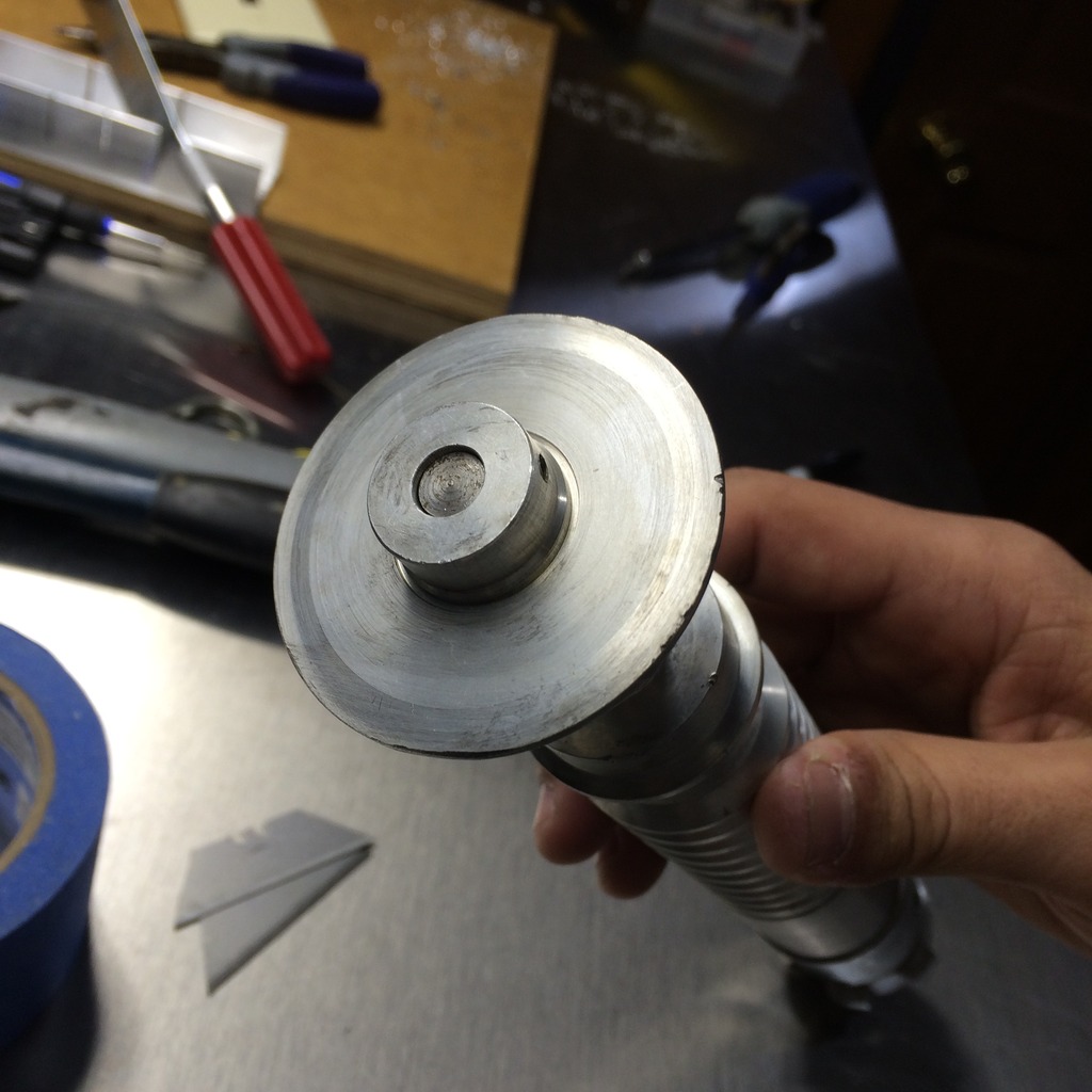

now was onto my first layer of weathering. i figured dent and ding the aluminum so that it helps the weathering stand out. Trooper_trent did a amazing job proving this works with his tutorial he made on painting. i tried my hardest to copy what he did.
I took a carpenters hammer and used the claw side to lightly dent some surfaces, i also used a ballpien hammer and used the round side of the hammer to dent the booster area. i also softly dropped the hilt (assembled) down my stone drive way to help simulate random nothingness. i use my driveway allot for weathering. especially cloths, my neighbors must think I'm nuts when they see me rolling down the driveway in different cloths trying to weather it up lol..
above you can see the damage taking place. the photo above also shows i started filing 1 side of the emitter, in the Celebration 7 photos it looks like it was dropped pretty hard and 1 side of the emitter is really flat. i didnt want to do this fully, but filing 1 side so it wasn't completely symmetrical was my goal.

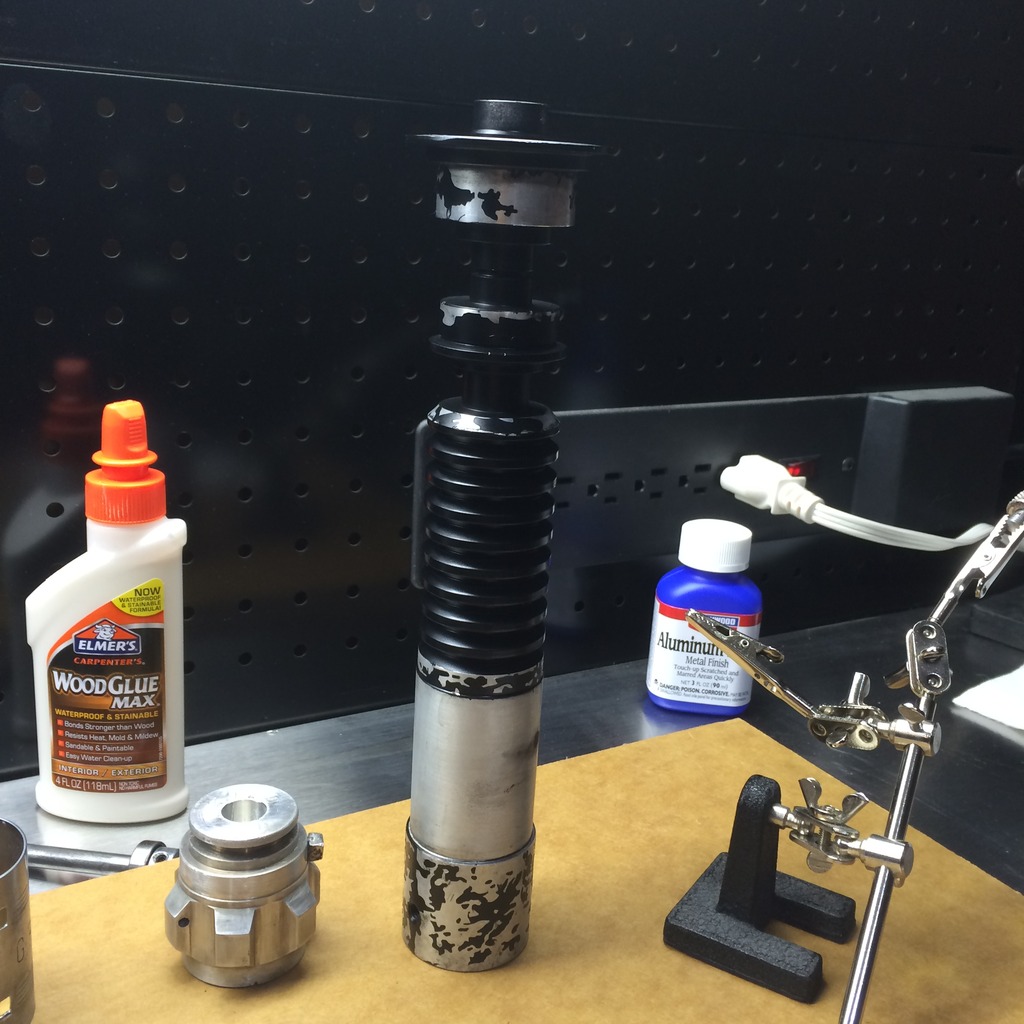

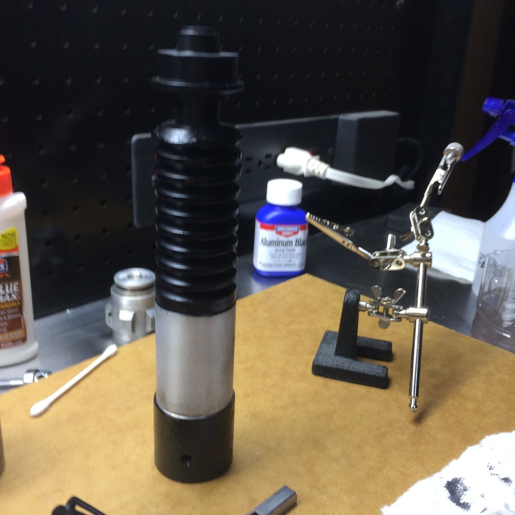

now onto the oven clean. I saw D48thRonin used oven clean to dull the aluminum. this was a genius idea, my only concerned was i remember being a kid and my friends used oven clean on their aluminum rims to remove the brake dust. they left it on too long and it burned the aluminum, leaving it a orange color...
i figured i would soak the parts for 5 minute rounds. between rounds i had a bucket of warm soapy water to rinse them, i changed the water each round as well. i hung the center section upside down and taped off the booster. the center section (all the rings) i didnt want too dull, the pictures to me look like the rings are much shiner then the rest of the saber. so i only coated the center section once. with the booster taped, and the saber upside down, i didnt have to worry about damaging the booster section.
heres the pommel, and emitter after 3 rounds at 5 minutes each
above you can see i filed much more out of that side of the emitter
here you can see the difference in soak time, again pommel and emitter 3 soaks, at 5 minutes. center section 1 soak at 5 minutes

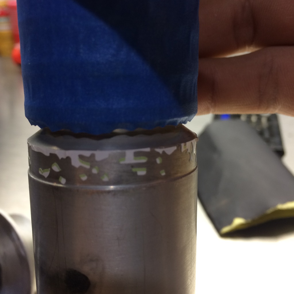

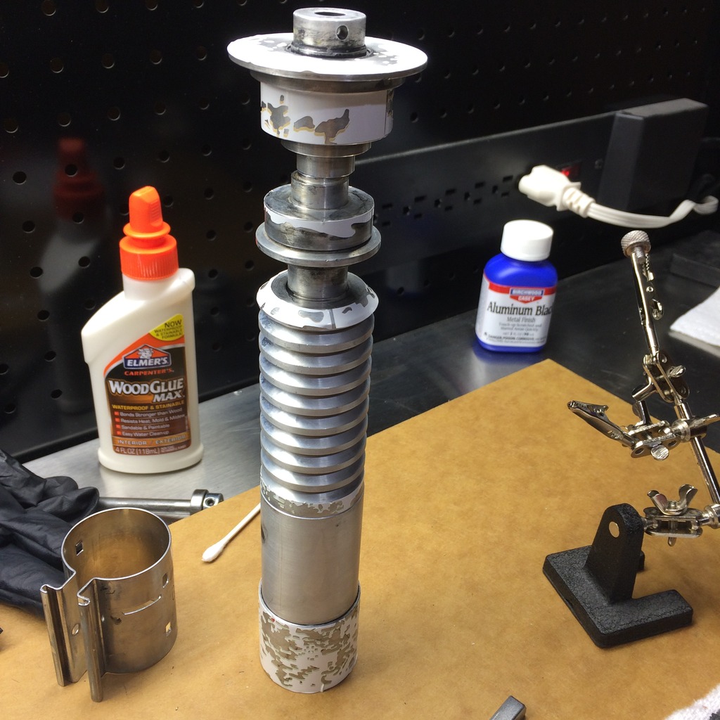

next came the most intimidating part for me. i was so afraid of this next step. i had to have watched Trooper_trents videos 15 times! along with reading his instructables over and over. i just took my time and paid close attention to all the details being sure to put the stickers in the right locations
one thing that really helped me was i marked where the upside down T is suppose to line up with the booster. i marked it with a red sharpie to stand out more
i waited a long time to get this far, cracking at it 5-10minutes a night. glad to have gotten this far. i knew i now had to step it up because i didnt want the stickers to cure and give me a hard time in the removal process and destroying the paint job

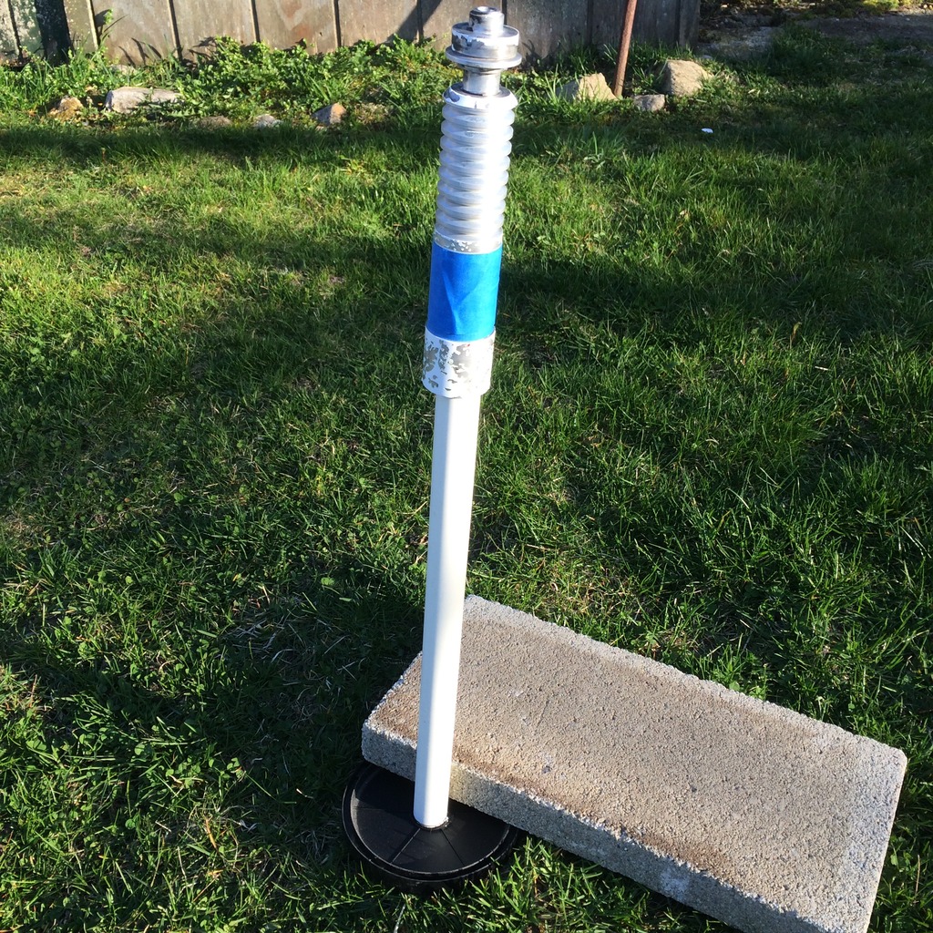

back to the yard.. time to spray. this is my makeshift spray tower. a CD case as a base and a PVC pipe lol.
this is where this 2 in one paint comes in handy. with a sunny day it drys fast, 1 light coat, and the second coat i would only do say 1 side of the booster. let it dry, then i would do another side, i would make it all un even. these way the paint has a someway wavy feel to it. i dont know if this is the right way to go about it, it just makes it look and feel old to me

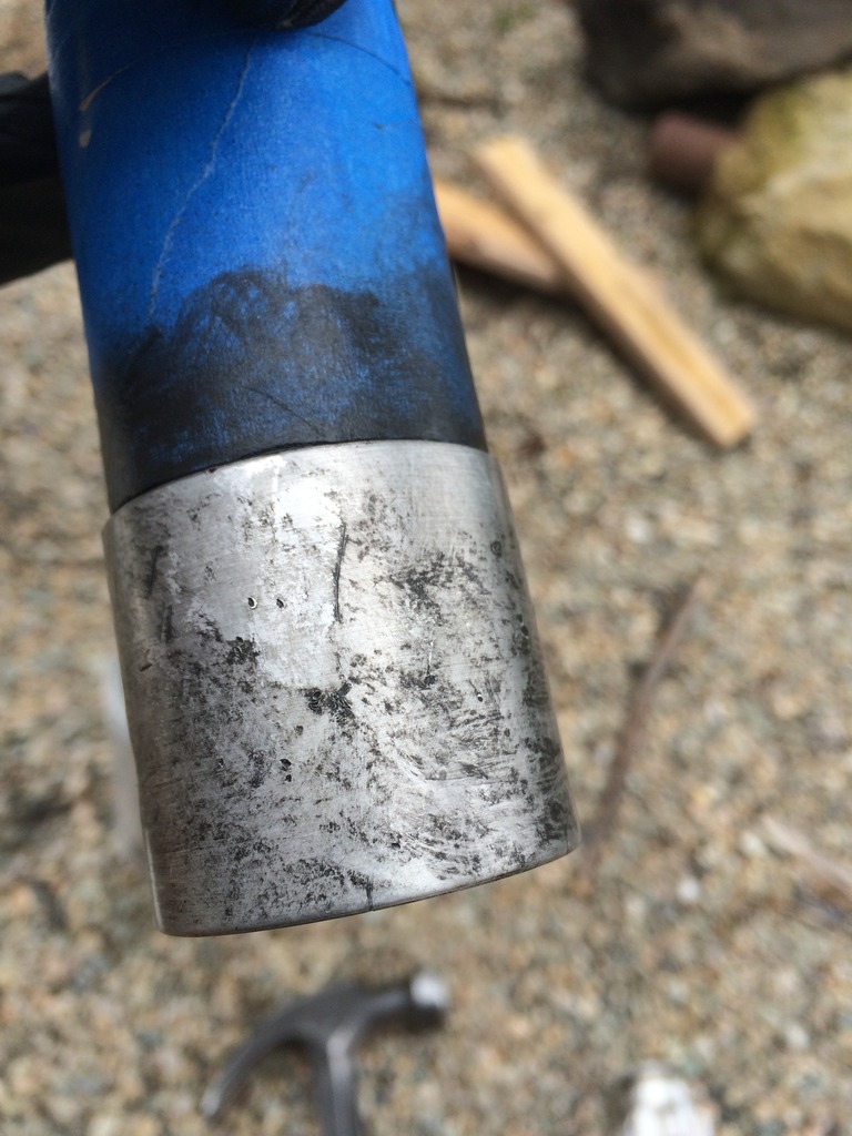

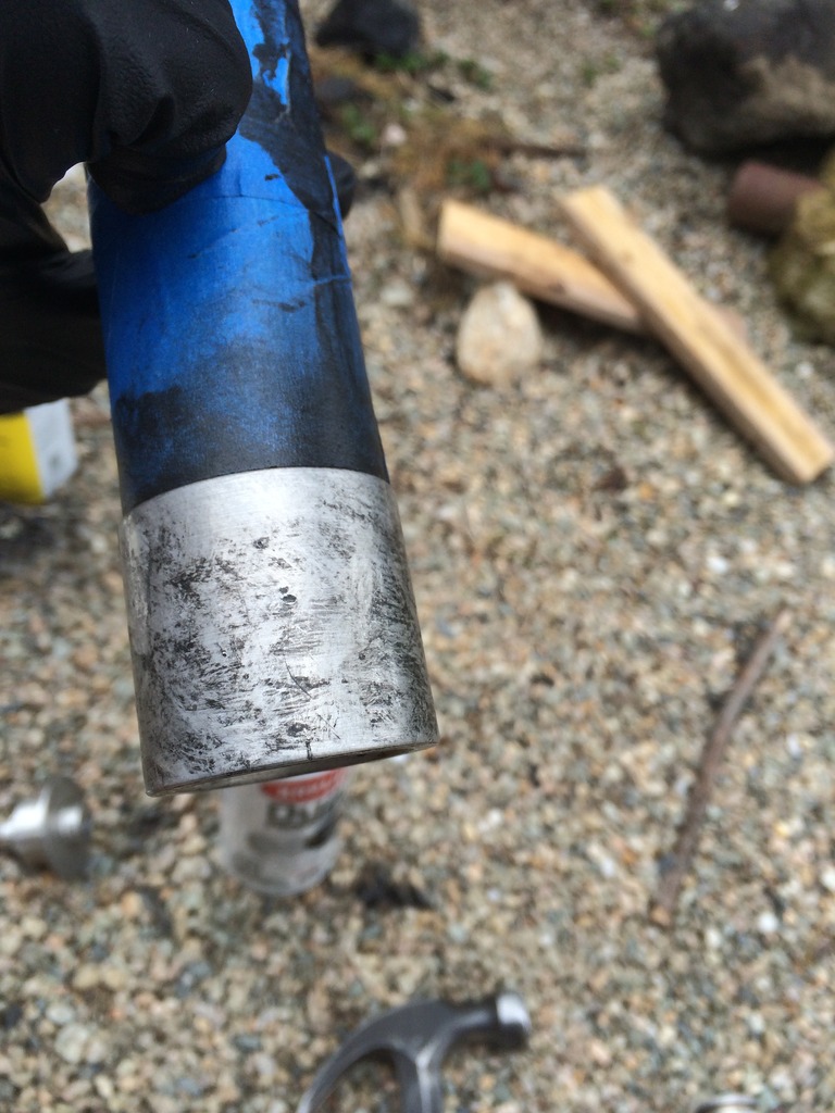

sticker pulling was more time consuming then i thought. i had couple hours this night pulling stickers because i still wanted the paint somewhat soft. for the up coming step
i want the paint soft because i wanted to give the stencils a rougher edge. when doing this i used plastic spoons and wooden popsicle sticks. this way it wouldn't scratch the aluminum, and would still be able to remove the paint, and rough up the edges.
just softly rub the edgers, you dont really have to go hard, you can just see the edge slightly change color, this is exactly what i was looking for. i then used 3 spoons on the grenade rings... time was against me and the harder the paint got, the harder it was to remove...
here i ended up wearing out the spoon, so i used the other end of the spoon, i hit it on the belt sander and then went to town on the rings

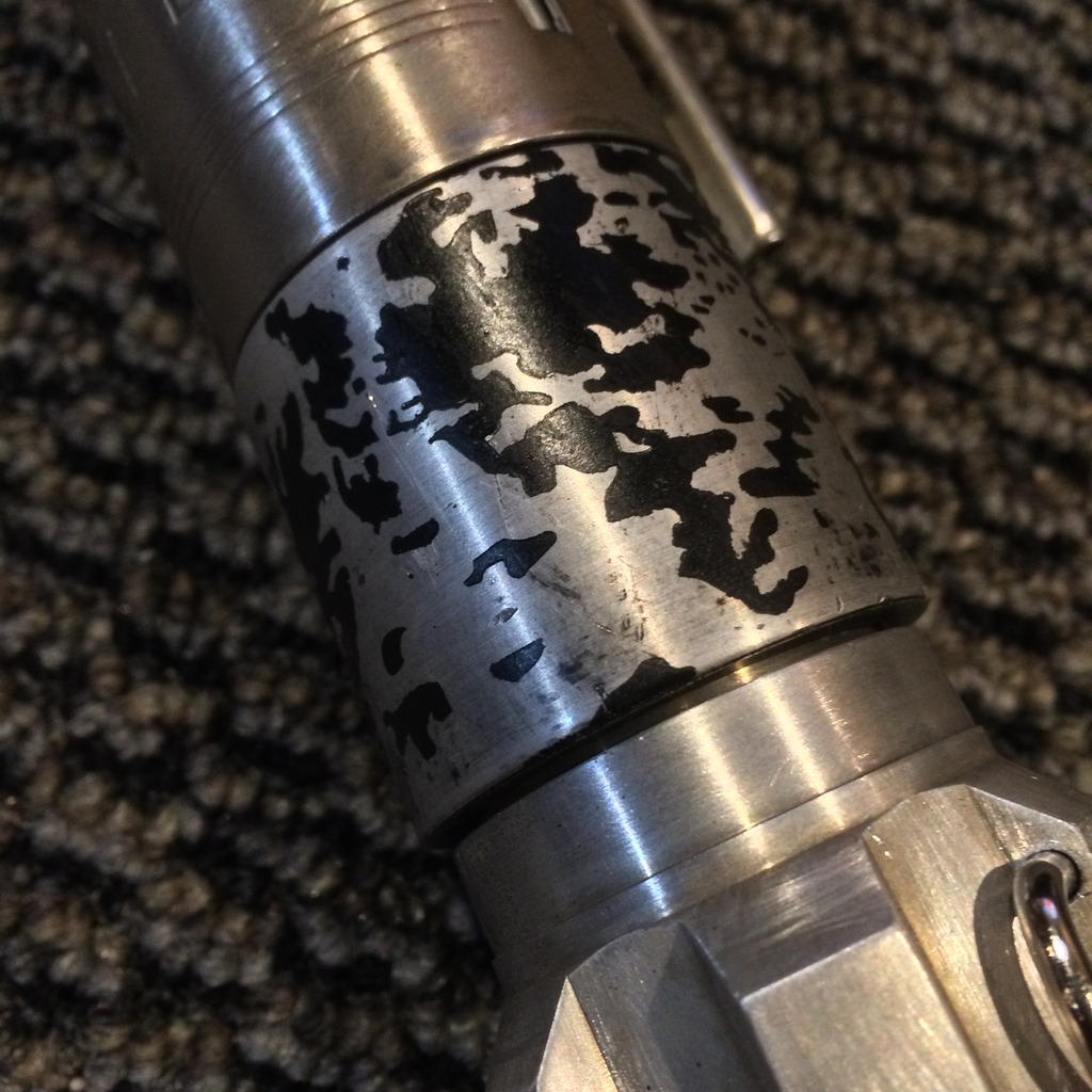

there is some great reference pictures on this site, thank you Chaim for the photos, these really helped me determine which ring gets what scratch
heres another shot of the roughed up edges

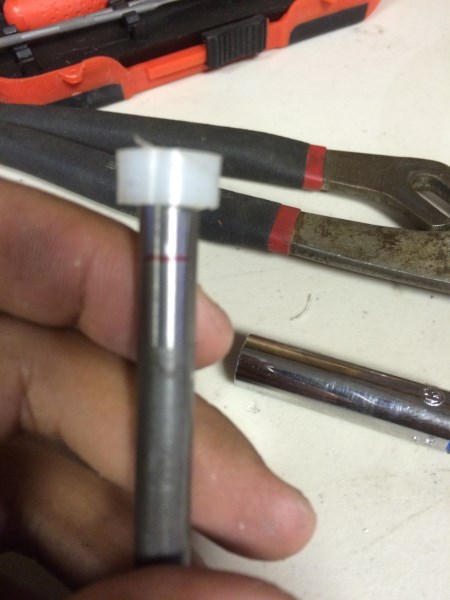

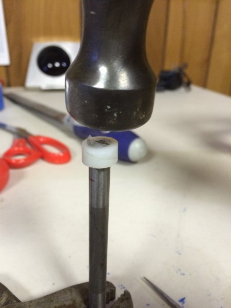

this is something i did from day one. i was so tired of going back and forth on trying to get the alignment just right every time i took the saber apart.. i used a chisel and stamped a alignment line. this way it is hidden in the weathering and i can quickly lock her in the right orientation. i did the same thing for the clamp, i could fit a small chisel in-between the actual clamp (under the circuit board) and hit it with a tap of the hammer making a mark on the inside for throne room orientation.
the photo above also shows the sanding i did to the mysterchunk. this photo the chunk is 2 turns less then it should be. when tightened all the way it sits flat. the reference photos i swear i see angled sides to it. so i sanded the sides down, like a pyramid shape... if that makes any sense lol

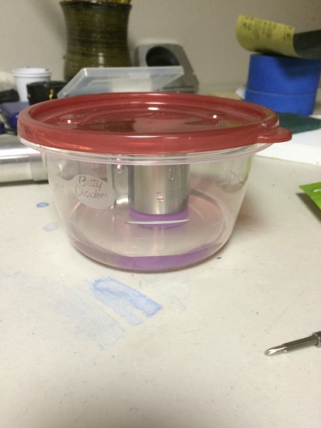

After all the wet sanding i needed to dull it, i poured some vinegar from my moms kitchen into a rubbermaid container and used a old allergies medication bottle to clamp to. to keep the clamp out of the vinegar so that only the fumes will touch it
I let the clamp stay inside the container for 40 minutes
the end result i was very happy with! beware of the fumes it will take your breath away lol

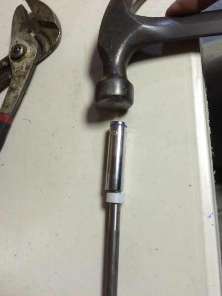

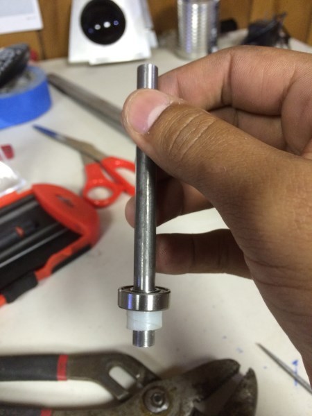

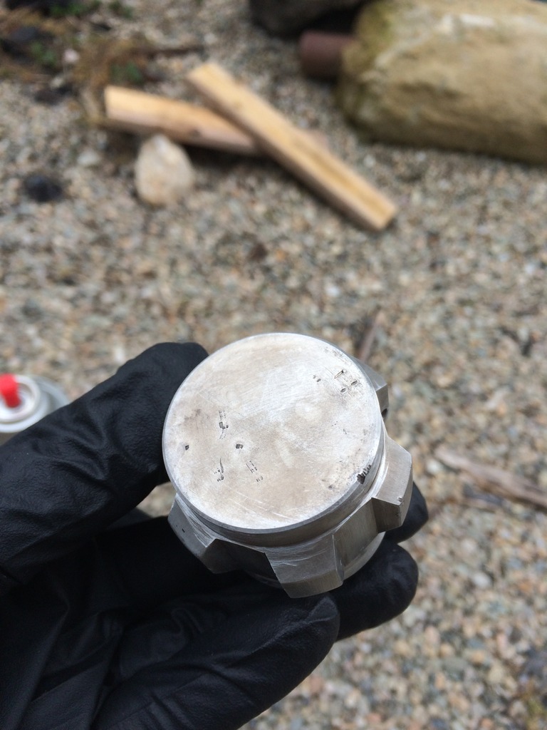

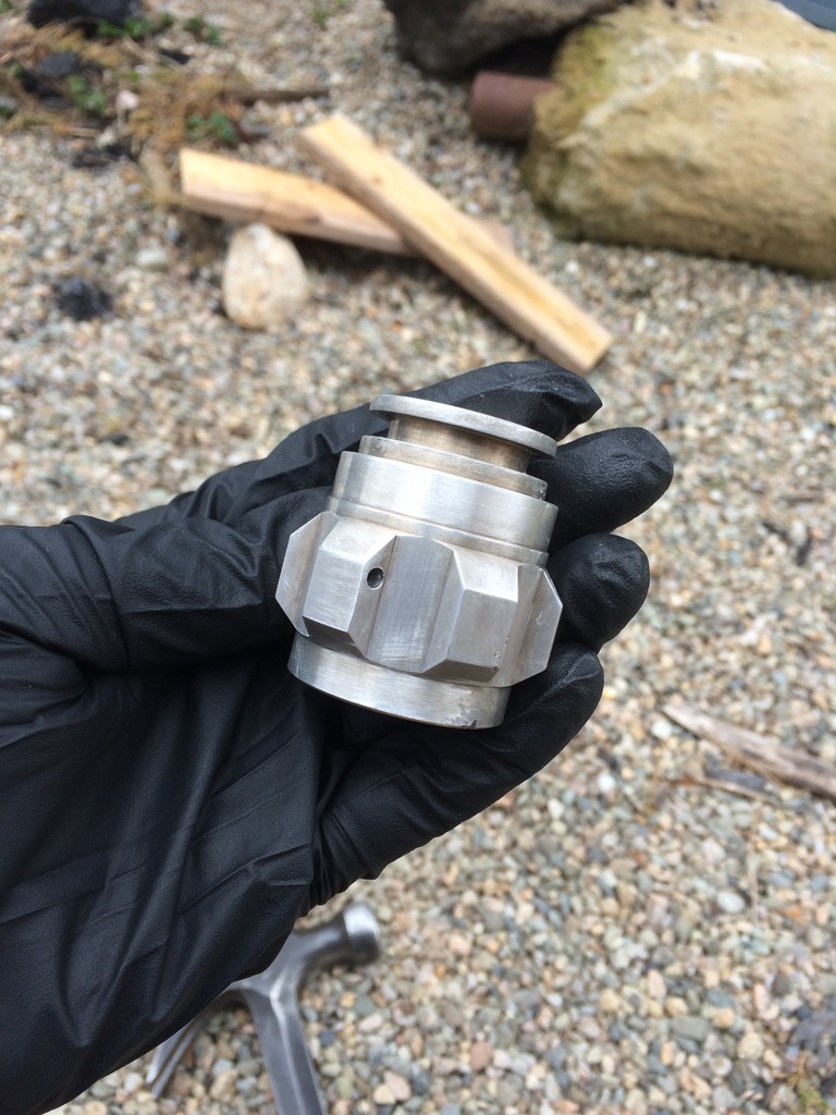

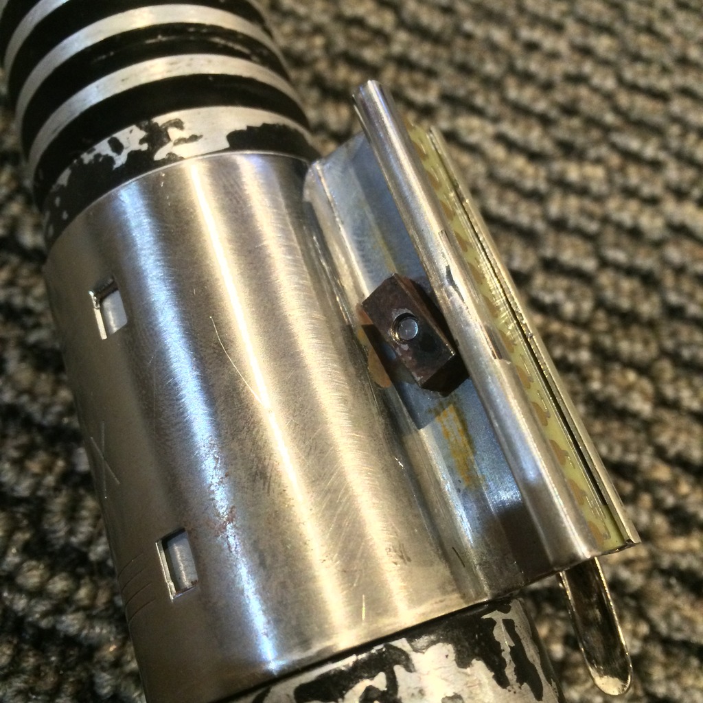

some watered down acrylics on the cone knob, inside the clamp lever gives it a dirty feel. i also had to rust the metal block that Roy supplies with his lever. i think its stainless, i soaked that thing in everything i could think of to make it rust and that baby stayed like new. i had to result to many layers of acrylics
roys ANH D-ring installed!!
there we go, all finished!
