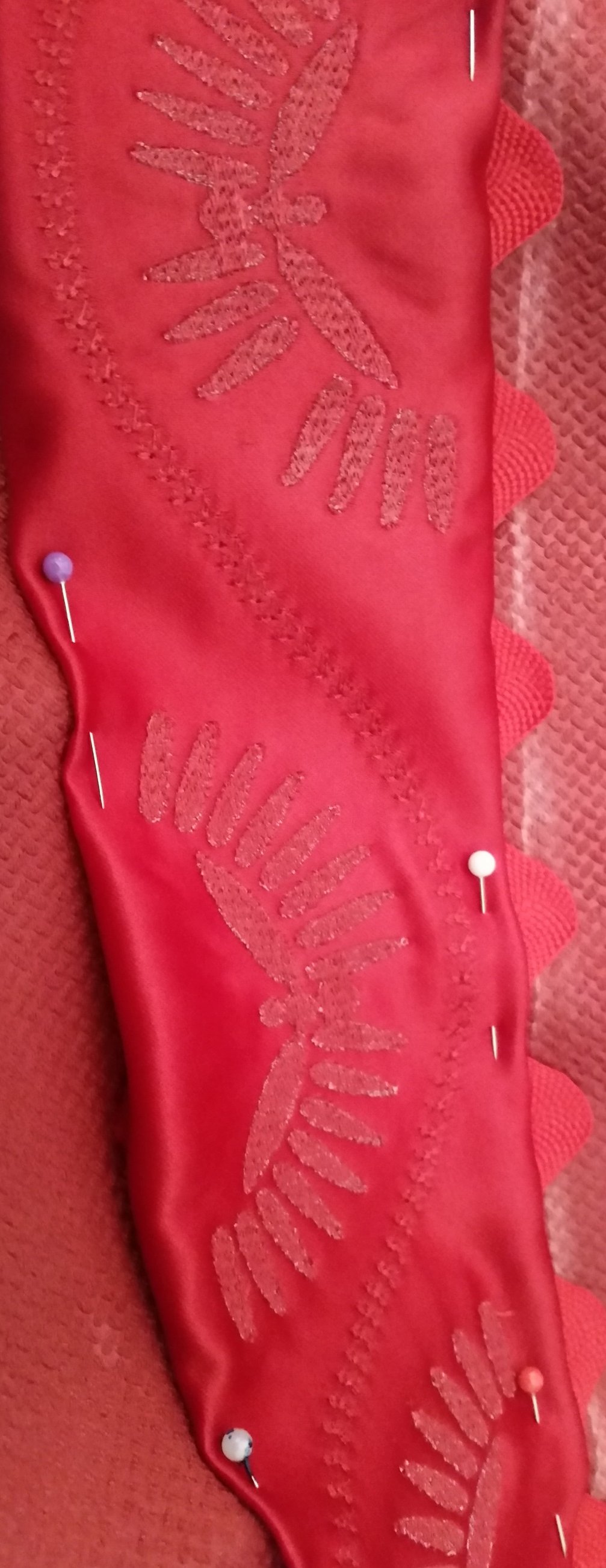

Here's the trim pattern done via the embroidery function of m'darlings new fancy sewing machine. If anyone would like the patterns, happy to share and/or convert to whatever manufacturer you require - this one's a Brother but the software lets me convert as required. We made one pattern for the arc, a reversed one to allow alternation and did the long flowing seam in between using a decorative hemming heirloom stitch (Brother stitch # 40).

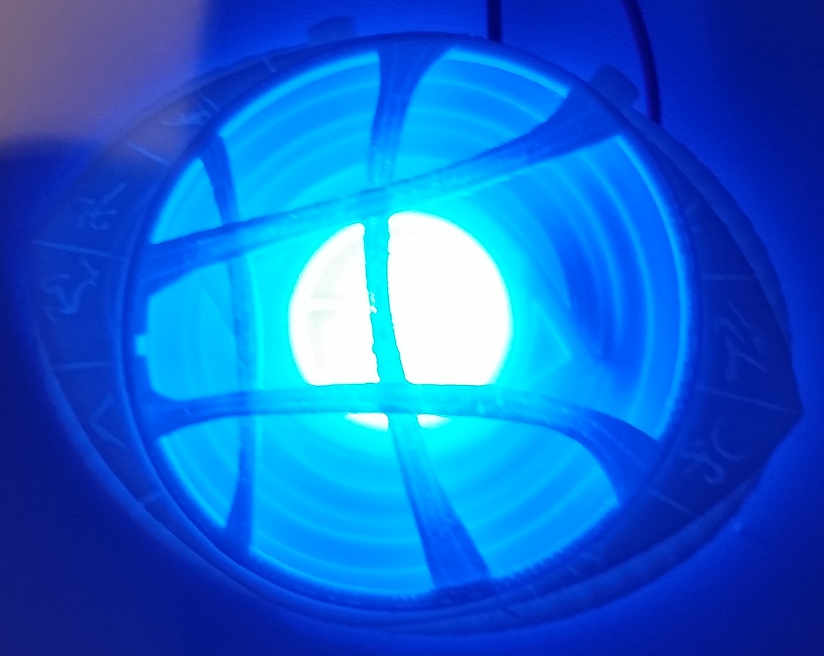

And here it is with the LED. Please note that I'll be using a green LED of the same wattage, I just had the blue already hooked up to the driver & battery pack so it was convenient. It'll be a bit different when painted but I'll also be printing the eyeball part in translucent PLA to allow more light through.
Note that both these photos were taking in the same place under the same lighting - the camera just had to darken the whole photo in the LED shot to compensate for the brightness. This will be easily visible outdoors in the sun! :)

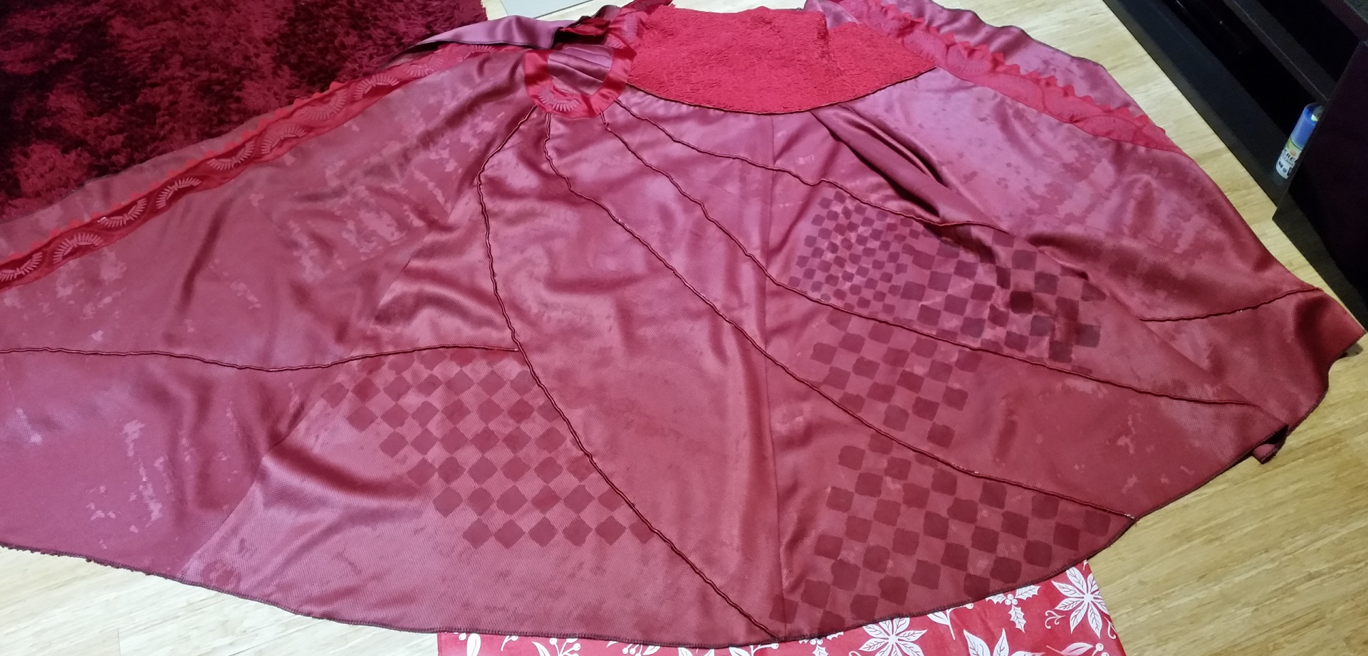

Well, the cloak is starting to look like a real cloak! It's the most assymetrical thing we've ever worked on.... Note: What appear to be marks on the fabric are just the way it looks in the light - it changes all the time depending on the angle of the light. :)

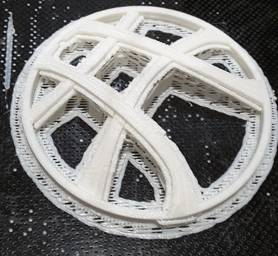

Here's the full-sized, printed at slow speed Eye.
First pic is the dreaded "X" with the supports as generated by my UP printer. I found it interesting how it made a kind of channel holding up each arm of the X - that popped away fairly easily:.

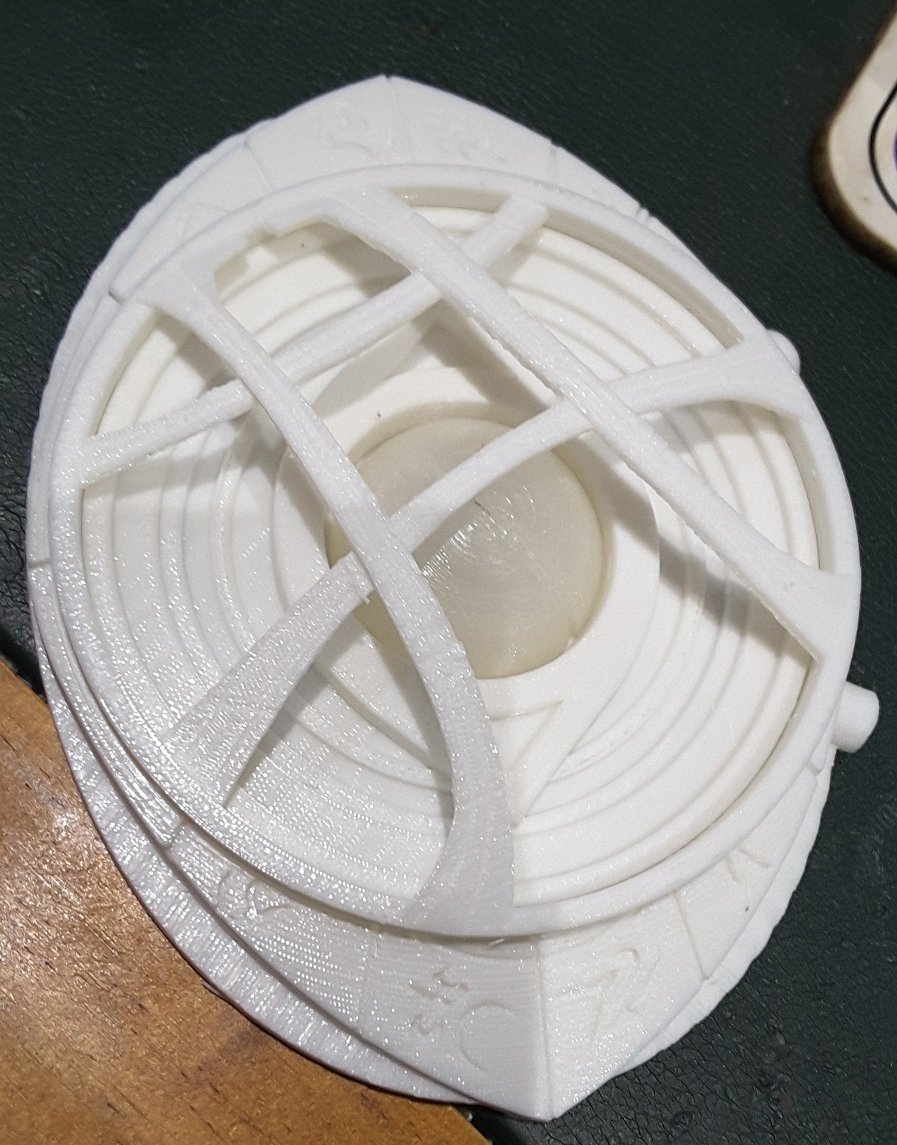

Second, the assembled (yet to be painted) Eye. I printed the eyeball itself in translucent PLA to allow more light to pass through.
As an aside - do you have an STL for a back for the Eye or is it intended to remain open-backed? Just wondering as I think I'd prefer to close it up, if only to prevent light leakage from the LED as it's pretty powerful.
