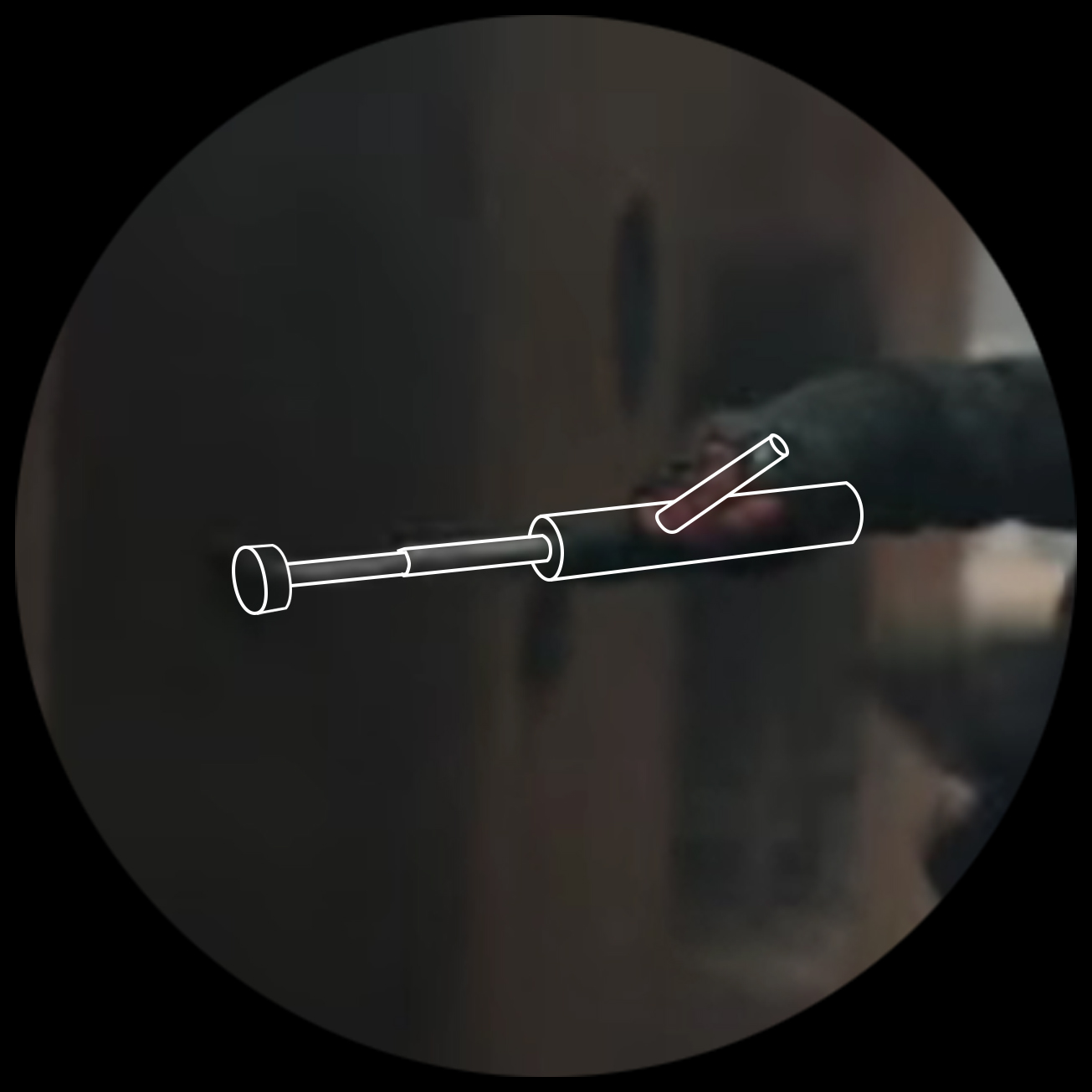

And here's a basic diagram of how the parts work together:

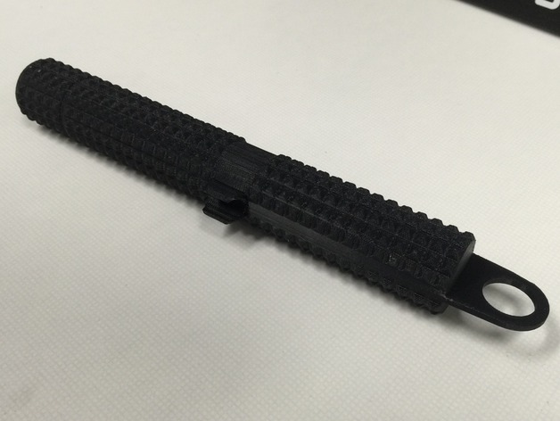

First prototype of the baton/tonfa. There's a long way to go with this, I need to work out how to model and assemble the spring loaded extension, and how to use the side handle as a trigger to deploy it. I'm thinking you'd just push it back after use, which means the side handle would swing back into parallel with the baton when you push the top back down. I just want it to be a really beautiful thing to use.

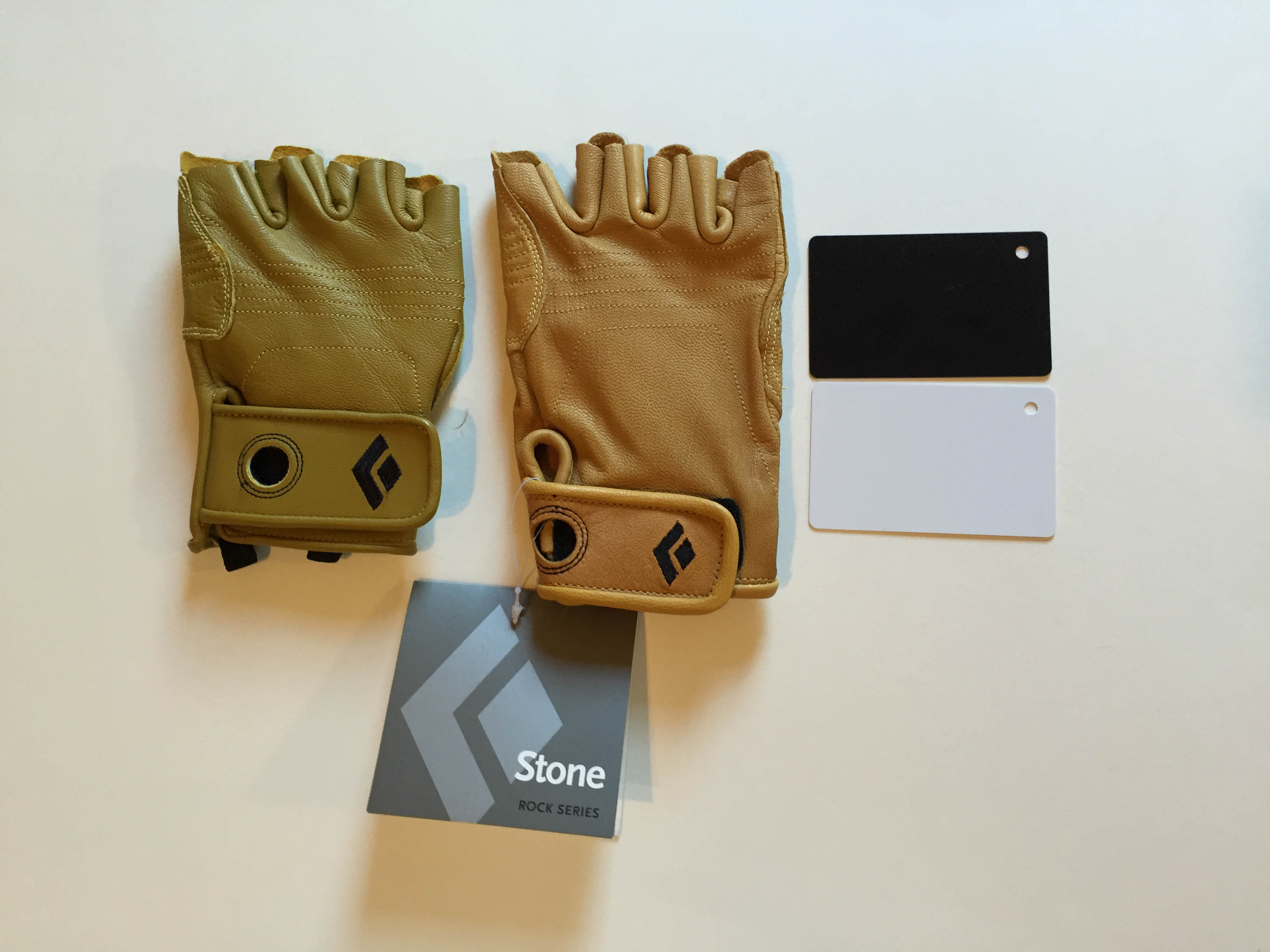

I got two pairs of the Black Diamond Stone gloves. One (XS) was produced in Pakistan, and the other (S) was made in China. They both were treated with a "natural" yellow dye that bled off when rubbed with a damp cloth, but the XS version is much thicker with a darker/greenish cast. The S version's leather is more porous and slightly softer as well.

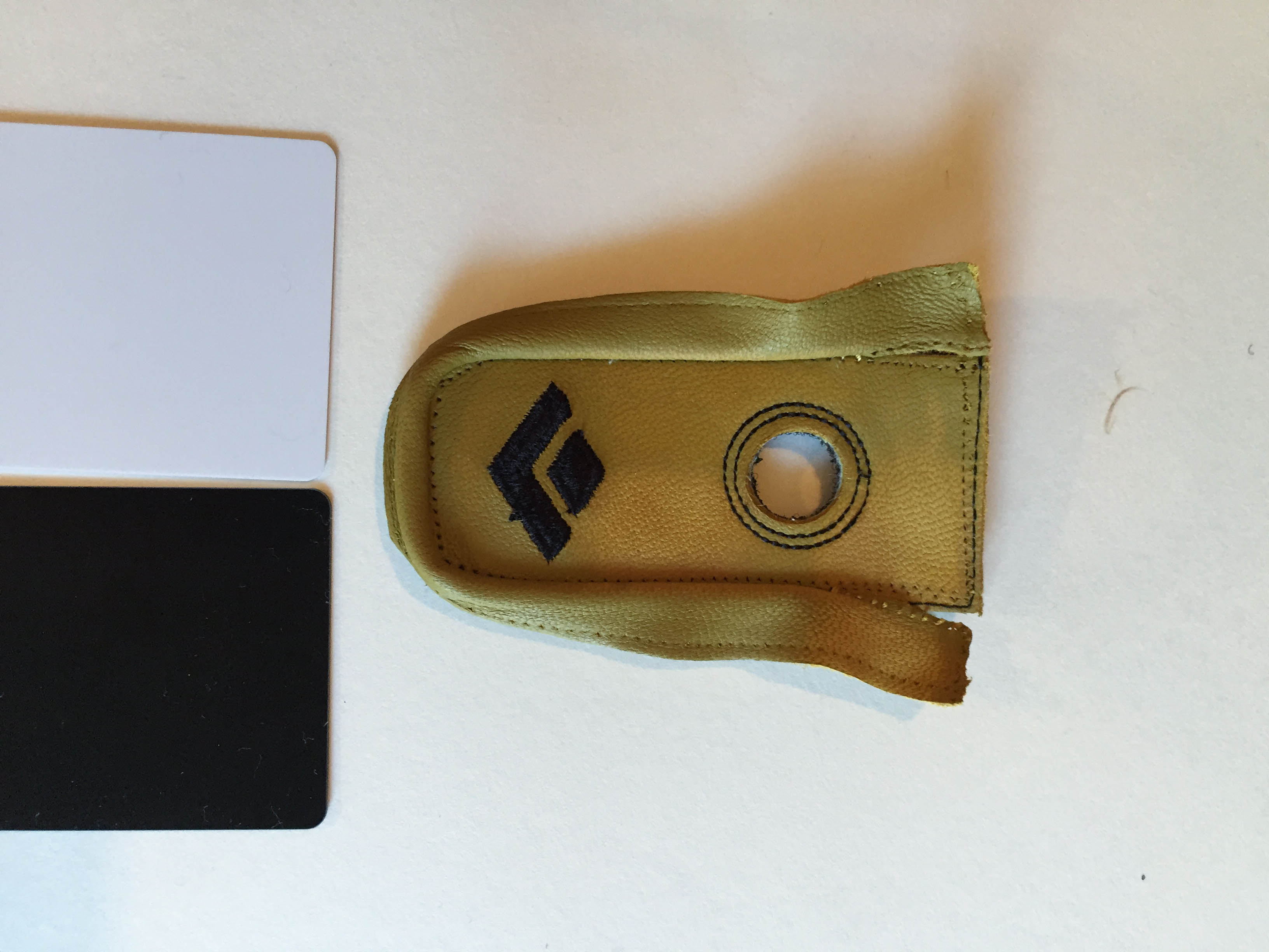

I removed the wrist strap to do some test with the neatsfoot oil, which didn't perceptibly change the color of the leather. Also tried gently removing some of the yellow overdye with several q-tips and acetone. A whole lot of dye came off, but not enough for the neatsfoot oil to change the color. Next step is going to be prep the leather with Angelus Leather Preparer & Deglazer and then darken it with a transparent dye.
Jyn’s close combat weapon seems to be a combination of a tonfa (with a hinged handle) and an expandable tactical baton. The telescoping sections of a baton of this type are not spring loaded. When the baton is flipped outward, the inertia and weight of the head allows the shaft to extend and lock into place. The sections often lock together when spring loaded ball bearings or rounded-end pins pop out slightly into retaining holes. The sections collapse when a little inward pressure is placed on the end. The pressure acts to compress the springs and allow the sections to telescope back together. In the collapsed state the same ball bearings or pins pop out into another set of holes to hold the baton closed. As such, this is a clubbing weapon, not a stabbing weapon, as a stabbing motion will only serve to close the baton.
Update: After drying a bit longer, and two or three more applications of the oil the sections where I removed the finish started darkening up. So something to break down the factory finish and several layers of oil may just do the job of darkening everything up. (And it looks like I flipped the strap around since the last photo.)
