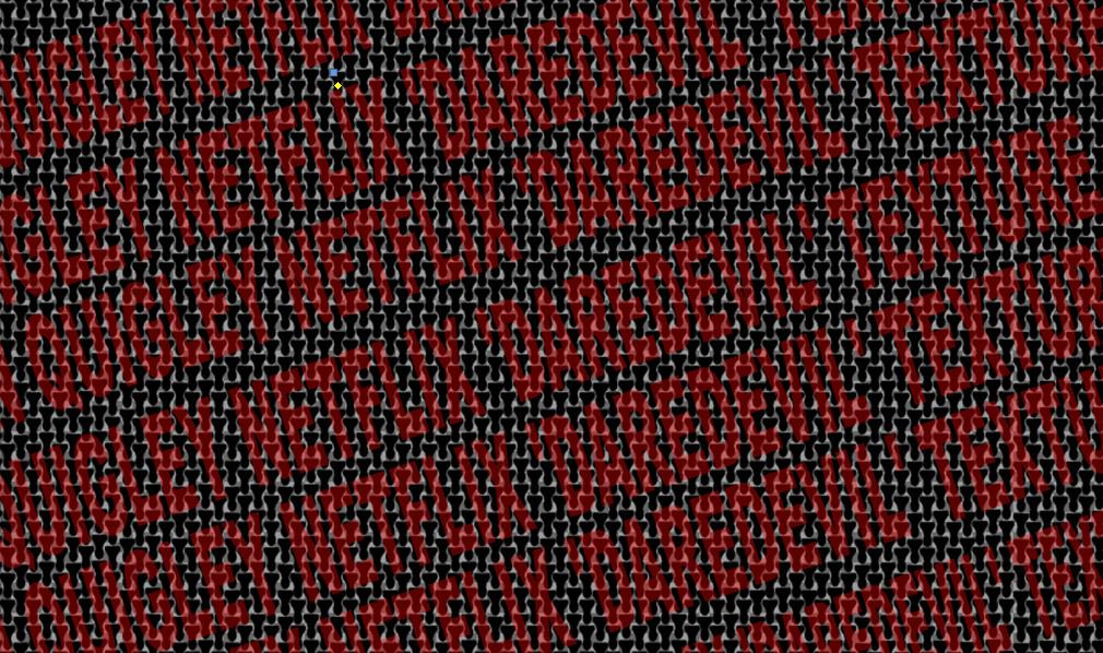

I'm actually working with a company who made the fabric in CA FA to replicate the new daredevil fabric and this thread is very useful. The DD pattern appears to be very different to the one used on other marvel suits would you all agree or is there a higher res shots that show it to be a similar replica of a weave?
I've looked at a lot analyzing the pattern
It's hard to explain, and I deleted the high res pics I had
It's similar to the Captain America (avengers) suit with the T pattern, but the T is bracketed
Like this

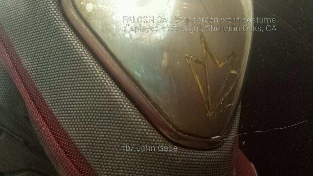

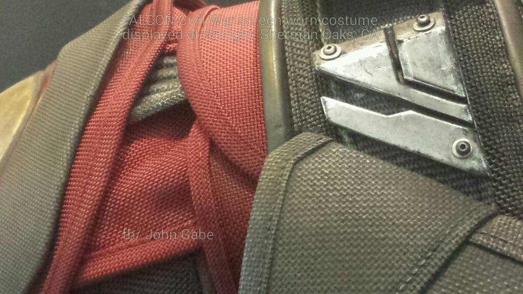

Kiyo, I am absolutely AWFUL at deciphering what the base patterns on some of these suits are. I don't know how you have such an eye for it? Could I pay you to extrapolate what the pattern for something like the fabrics shown here would be?
12973272_10154031124113605_8099129029265169927_o.jpg12998225_10154031123338605_5172789597913699364_o.jpg12973229_10154031120338605_7161426045708696122_o.jpg
To my eye, JJ, those all appear to be actual textured fabrics, rather than printed fabrics. Look at how the sheen changes as the fabric rolls.

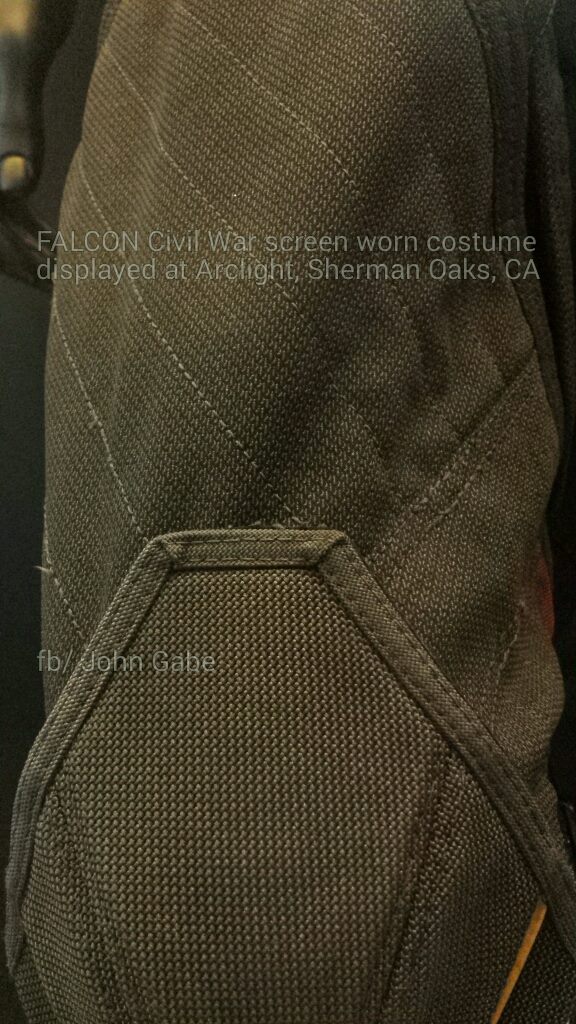

View attachment 616388View attachment 616390View attachment 616391
-Nick
some parts of his fabric are printed, others are already textured when bought as theNickFox was saying.

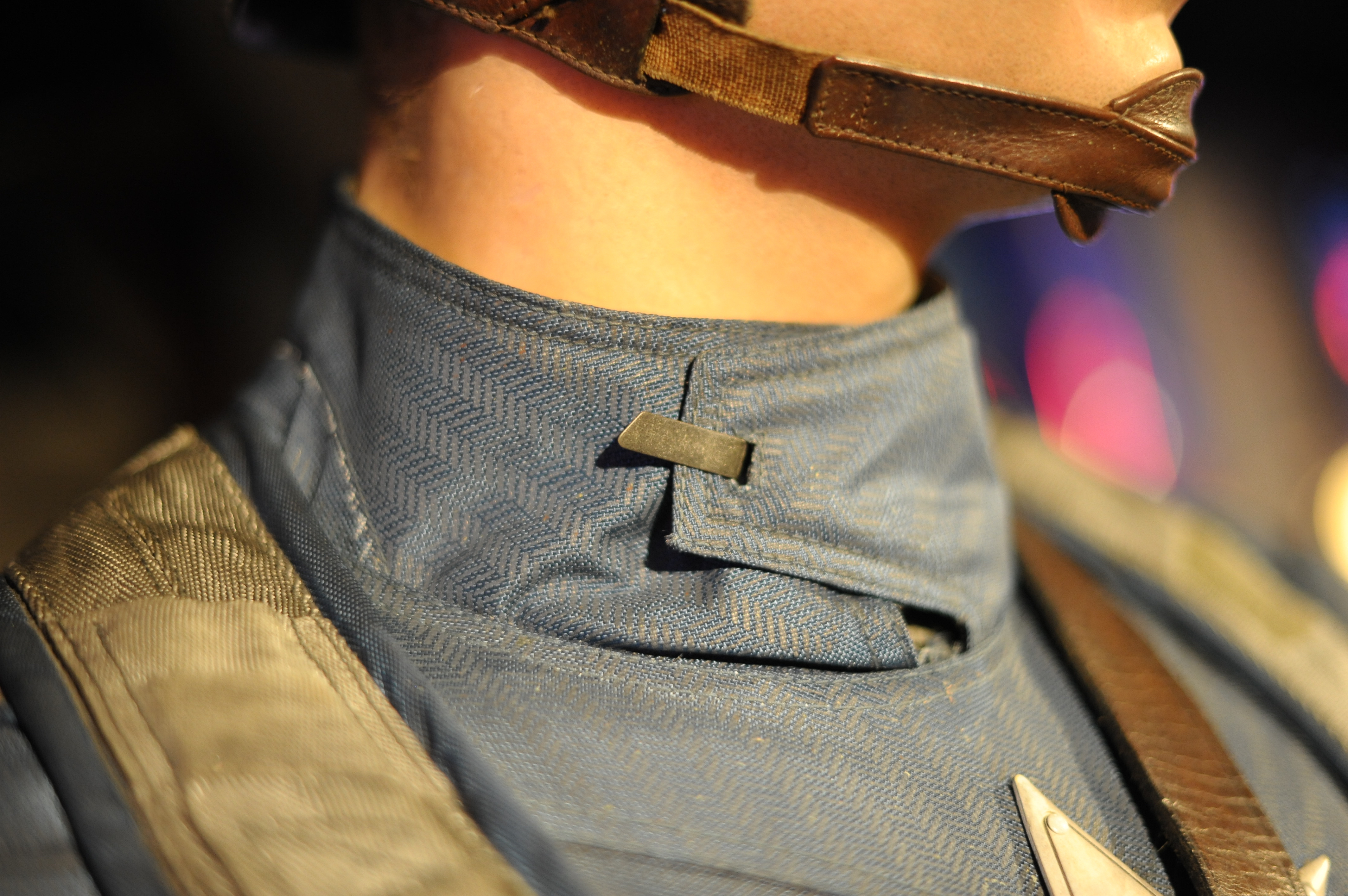

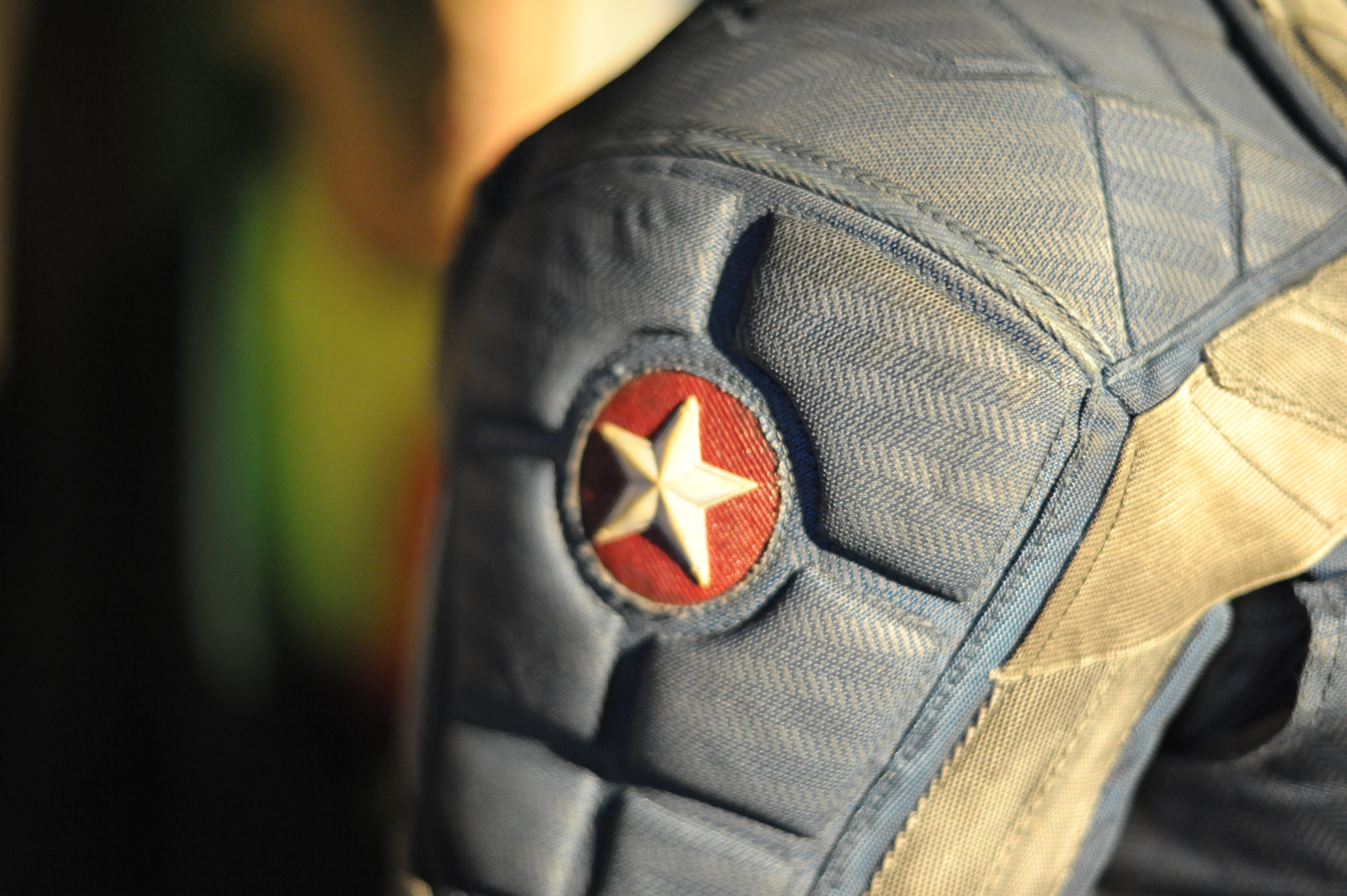

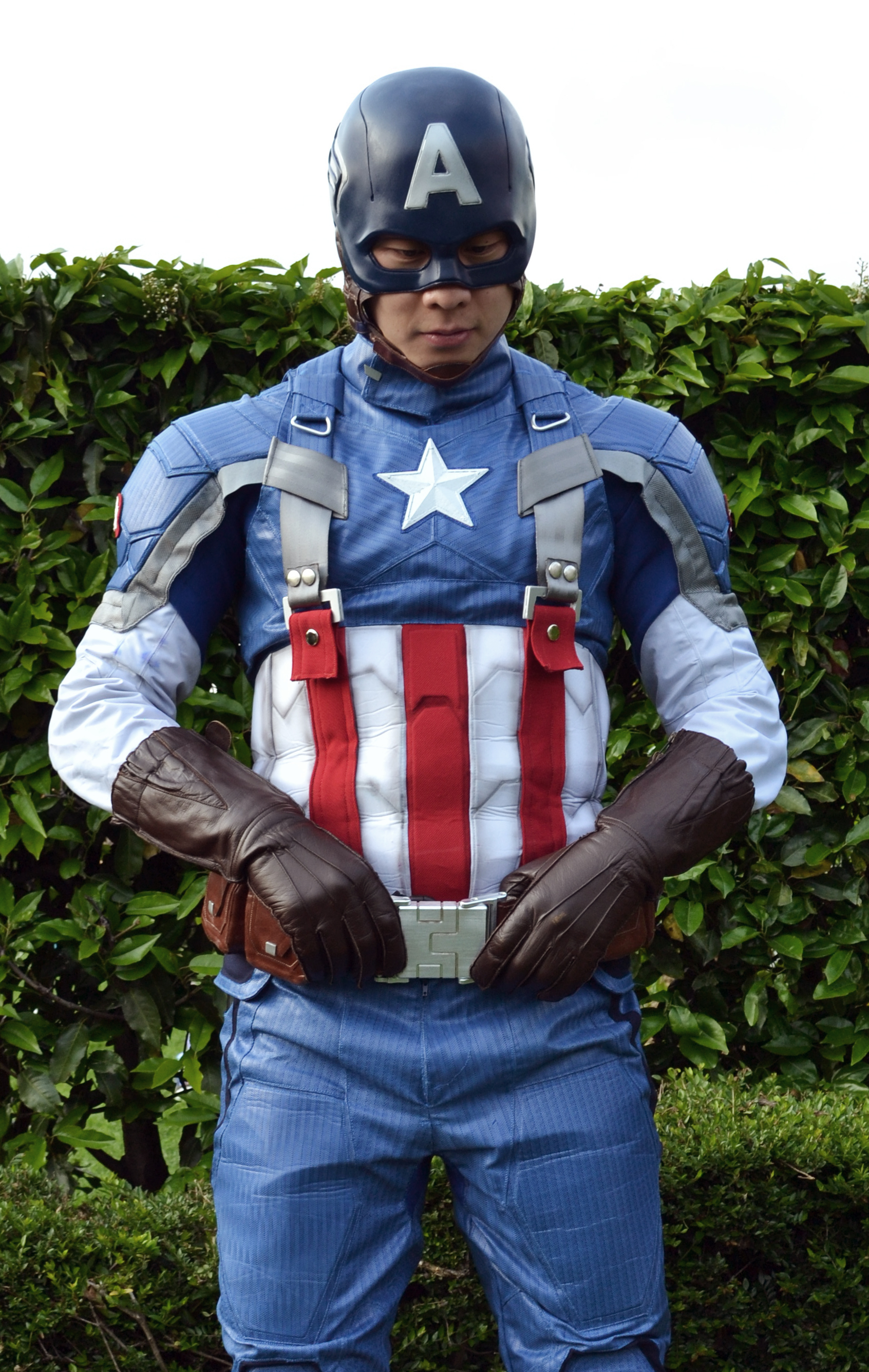

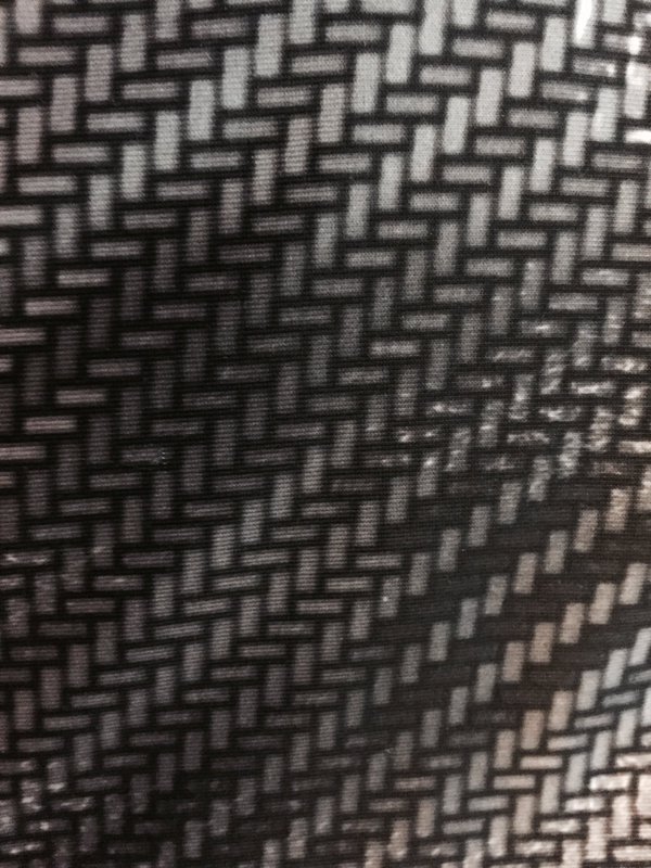

Thank you for sharing some info on the screen-printed stretch fabrics! For Captain America (The First Avenger), I am pretty sure they actually used normal ballistic Nylon, with screen-printed "fish bone" pattern on top. I got to look at the fabric up close, touch and feel the suit they have at Madame Tussaud's in London, and it is definitely not stretch fabric. See picture below:

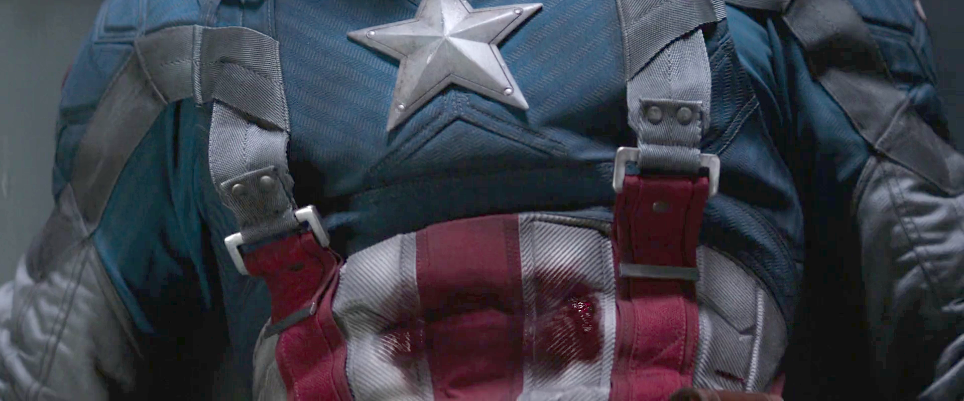

For the Cap suit in the "Winter Soldier", the Smithsonian Suit (Golden Age) suit, the fabric however, seem to be stretch fabric with full screen printed textures. See screen cap below.

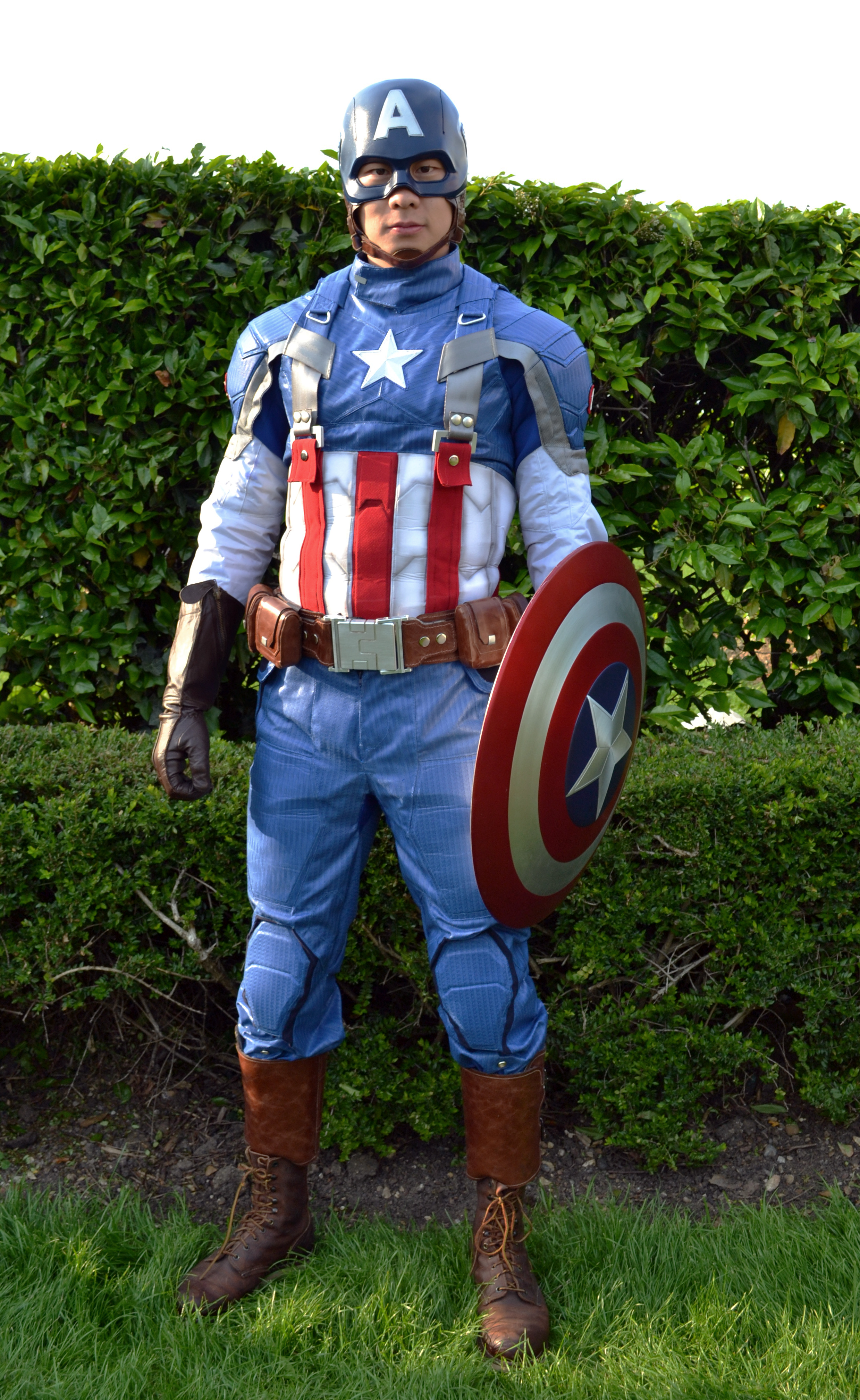

I've made a costume replica of the Smithsonian suit. However, since I was not aware of the conventional printed screen fabric method, I used heat transfer screen printing on top of ballistic nylon instead. The pattern works superb, however, there is a shine on top of the print that I am not a particular big fan of. I am able to sand it down to a more dull appearance, so it's not too bad.

Oh definitely, the TFA suit is indeed a Ballistic Nylon. But the suits that came after that (Avengers 1 to date) used a stretch fabric approach. I apologize to anyone if I have misinformed them somehow.
My friend who works in the UK got to screen print that texture on the suit; he just happened to work on the Harry Potter movies as well.
The Smithsonian suit was printed by my company, but not me directly, as I was interning at that time.
Heat transfer is still a great way to get texture onto fabrics. I really like your suit.

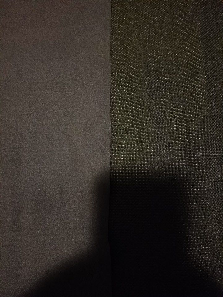

I've always wanted to do this type of post, unfortunately I only have a tablet camera available.
The left side is regular non-printed spandex - The right side is screen printed fabric.
It makes so much of a difference in texture.
