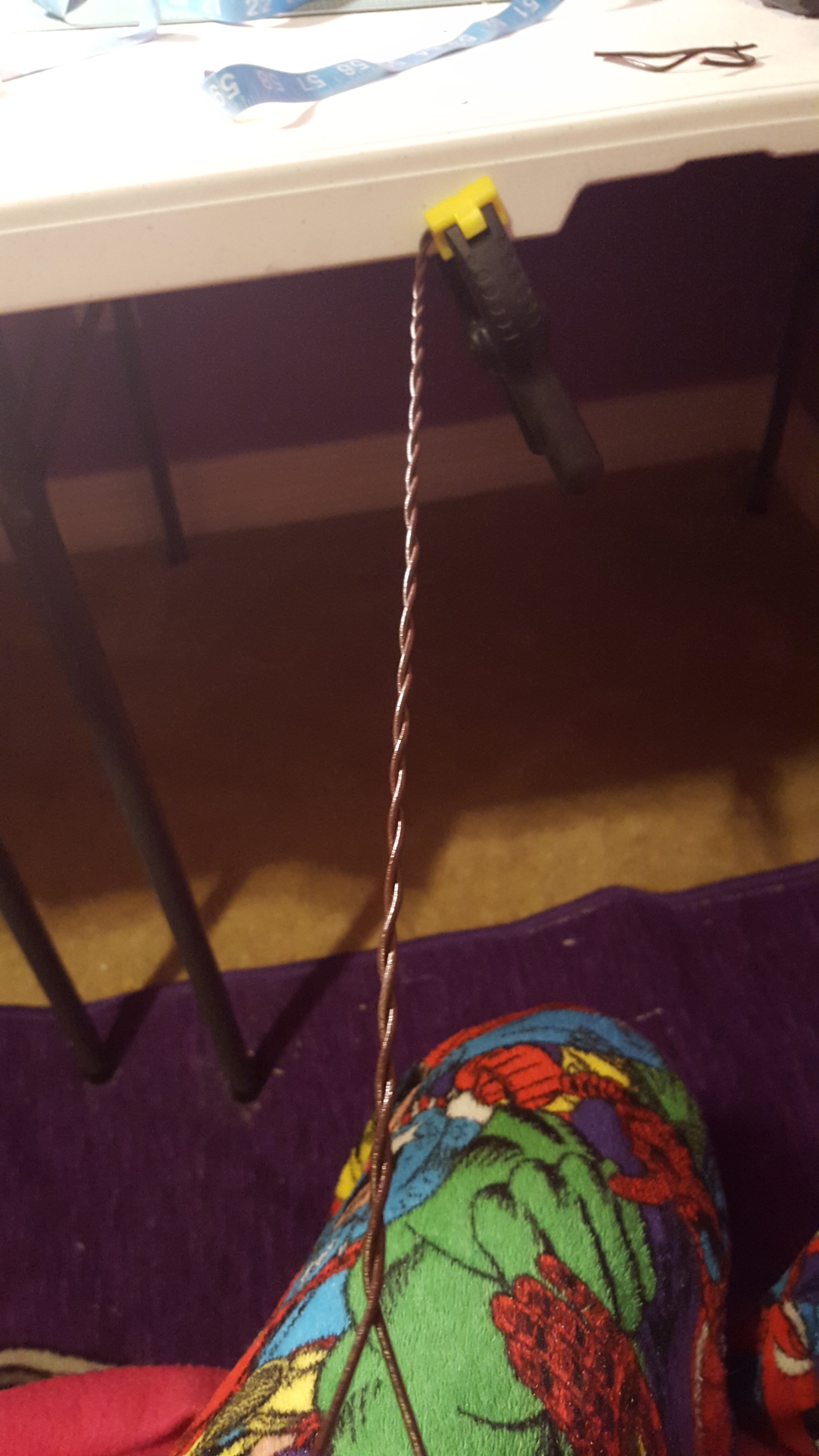

    Now go back to the remaining amount of cording. Super glue the ends together and then clamp the end to a desk.
    Click image for larger version.
    Start twisting the cords together by moving them around each other - try not to roll the cording. You want to be able to let it go and it doesn't uncurl.
ID:	604783Click image for larger version.
    Once it's all twisted, attach the other end to a solid object like another desk with another clamp to keep it taught.
