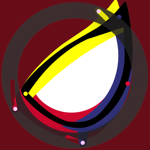

Cool! But how are you going to work with the parts going through rotation points?
figuring all that out now... I just want to get the look right before I start with that. Don't wanna get everything moving just to find out it's not right.

Any ideas on how to mechanize the eyes?

Could you please make the multi-layered mechanism too? Or send the file for that so I can figure it out myself if you're just going to work on the single-layered ones?

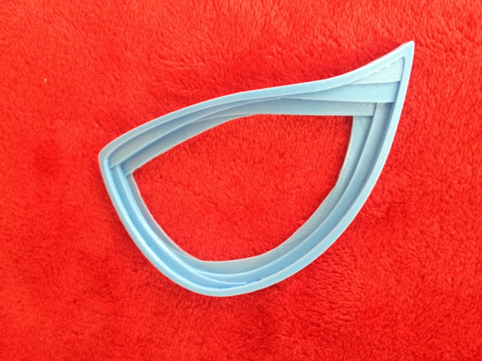

Yes, there will be a lens frame that will have 3 shutters that open and close surrounded by a thinner static frame. I am working out all of the details so I can start test printing. The tricky part is not so much making a mechanical shutter but making a curved or convex mechanical shutter.
Stay tuned.
Stay tuned.
What if instead of 3D printing, a design is made to be 2D lasercut onto a flexible sheet like a thin PVC (the kind used as file covers maybe) so in the movement it will bend by itself whenever it needs to? Just the outermost frame and the 'spokes' can be 3D printed to be firm. Wouldn't that be thinner too? And I meant, like, a total of 9 shutters but in 3 layers. 3 shutters within 3 shutters within 3 shutters.
I downloaded the static lens but Blender was unable to separate the parts as the vertices are still connected in places with each other so I was unable to play around with it.
