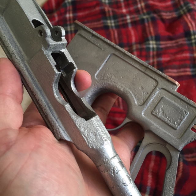

Whatever you do, don't use a caustic bath to strip it... Like one plate house just did to mine against my wishes...
Ouch.. I hope you were well-compensated for that goof. I suppose that you could fill it with epoxy putty or similar.
I once left a Denix's bolt stop in a jar of vinegar to strip the bluing, which within minutes dissolved it down to a black, fuzzy, pea-sized pebble. I had to scratch-build a new one.

Yeah, after a very long and heated conversation, we worked it out. I'm now in the acceptance stage of grief... I'm going to try some filler and paint to see what can be salvaged. When they called me they described the condition as "some pitting" lol. Completely ridiculous.

I would try epoxy putty with some pigment kneaded in. I have previously filled Denix with metal shavings but how much that takes bluing varies a great deal.

I have it on good authority from a deactivated gun specialist here in the UK, who sees these regularly, that the gold finish will come off easily with a bit of Brasso and some elbow grease. He thinks the plated finish underneath will then take bluing quite well, after being 'keyed' gently.
Re: Which Denix?
On his thread; Thread: DL-44 Greedo Killer - start to finish (almost)
member; spoudastis suggests a commercial Zinc spray from a rattlecan, the kind you get in hardware stores to repair galvanised metalwork, will blue.
He does say that it goes on quite thick and textured and requires a bit of time to smooth and finish before bluing but the zinc content polishes and darkens.
This may be a finish to consider on pitted parts where the zinc spray will fill voids.
