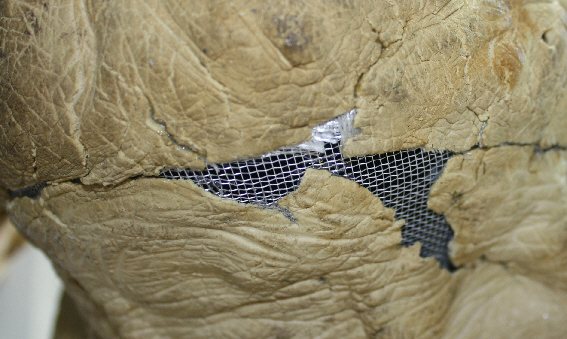

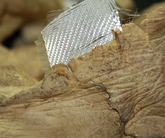

I was asked how to close gaps and rips.......?
For me i found the solution in using fibre cloth for areas which should stay moveable
and wire mesh for areas which needs to build up a stable structure.
And of course its important to use the right "glue".
I used RTV-1 silicone rubber bonding glue and its ultra sticky......
You have to hold it in position for 10 minutes but then
you have a super connection and its flexible too...:)

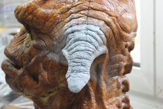

The next step is to apply primer.
A light grey color is best for seeing all details and it's a good base for
all materials i need to fill gaps and rips.
I reached the main goal which is preserve the condition.
Of course now it isn't a mask you can wear anymore.
But after complete restoration i can mold it....:D what would not possible if it would be still old brittle foam latex.
Closing and filling all gaps and rips will take several weeks. I let you know then about the progress.......:cheers

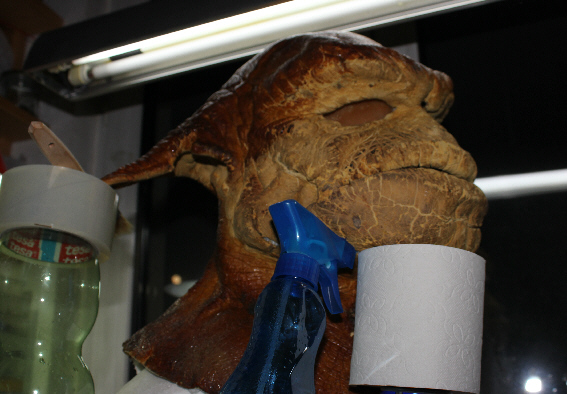

No, there is no progress with this mask. But it is stable now.
I will restore another head soon as this head has the same issues with the crumbling foam latex.

This will be a total challenge to get it restored ................:confused
