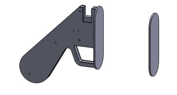

Here is my early progress on the model: (All of the CNC machining which will come later, will come from this model.)
As you can see, I've got the shape of the grip/trigger area done and have added the end plates for the charging chamber and some of the screw holes. I've decided on M3 and M4 size screws, the two tiny screws above the trigger pivot are M2.5 I think that's what I chose! (more about screws in a later post) There are 3 grip plates, on thicker center plate and two side plates, which you can see in the trigger guard.

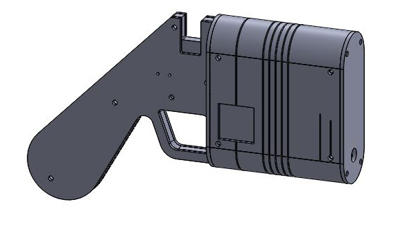

More progress on Rey's Blaster.
At this point, I'm almost done the power core (middle section) you can see I've connected the two end plates with upper and lower cylinders, added side panels, the window and panel behind, vertical details, Apparently this was taken before I transferred the front details around the bottom and added the top front cut.
I chose M3 size screws for the side panels and to secure the front and back panels. The hole in the front panel is in place for the lower front bobbin detail.

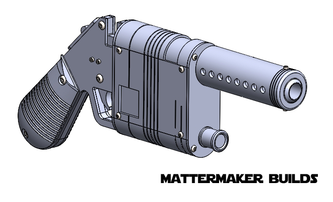

Update three of a multi-coolness thread of blaster awesomeness.
Here's a new update on the modelling...
Front barrel, vent holes, barrel neck (somewhat hidden in that view), barrel cap, and the front bobbin is in place. Coming along nicely.
I had to spend quite a long time estimating dimensions, I used a side view of one of the reference shots found online to trace out the general proportions of things. I also deviated a bit in places after measuring different parts in detail on different views. Trying to accurately measure dimensions on a plane photographed at an angle, with inherent perspective is an art in compromise. Ultimately though everything needs to be properly proportioned. I believe I chose 33mm for the barrel diameter, the top and bottom cylinders of the power core I set at 35mm, slightly larger than the barrel. As all the photos revealed the barrel as being slightly smaller than the power core.
One thing I discovered while modelling is that this blaster is smaller than it looks. When Han hands (hehe, Han hands) it over to Rey, you will notice that it's pretty darn small in his hands. Rey has smaller hands, so it fits her perfectly.

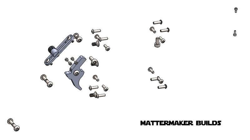

Safety lever, Trigger and trigger "chamber"
As discussed in another thread (here), we've surmised that the fire position for the safety lever is down/back and the safe position is up/forward. Safety is done. Not exactly sure how I will manage the knurling on the end of the post, it's pretty tiny, I guess It'll be sorted out when it comes to building...
If anyone has any thoughts on how to handle the knurling, please comment! I am wondering of the knurled knob part is an existing piece of hardware and not made custom for the prop?
Below you can see the safety plate, post, and trigger along with the space for micro switches. There's just enough room in there for 2 micro switches. One for the trigger and a second which will align with the screw holding the safety post in place when it slides down into fire position. I may have to figure out a method of holding the safety in the up position as well. Might see if I can use a second micro switch, or better yet, a small detent that the pan head screw can contact with. You can also see the slot towards the right mid level, this is the wiring path for the switches which will go to the middle chamber that will hold the sound and lighting pc boards.
The curved area in front of the trigger is for a spring. I think it'll work having a spring put into that spot under some compression without any other method to hold it in place. It should stay put. If I had to I could put a tiny cap head screw on the end of the trigger lever which would hold a spring, but I really don't think I'll need to.

Screws screws and more screws.
Holy, this thing has a lot of screws! I will be buying Torx anti-tamper screws as used on the real thing. Bit of a pain having to hunt them down, but screen accurate is screen accurate... I decided I would use metric screws, as they're readily available and personally easier for my metric brain to understand when figuring out all the hole, drill sizes and taps.

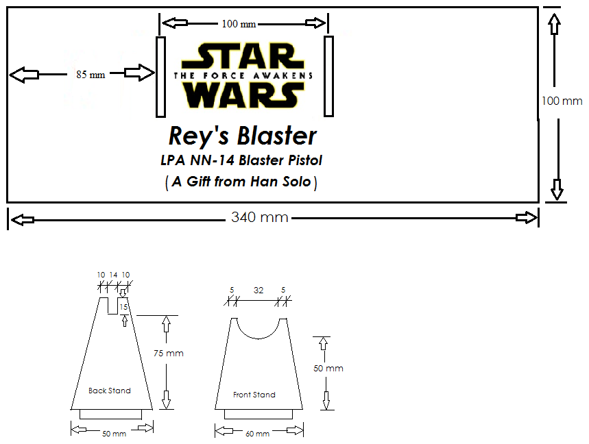

Does anyone have an opinion on building a stand for this blaster? I've been toying with the idea but not sure yet. As my plan is to make it as realistic as I can, I think it would deserve a matching stand.

I was going to do a stand as below
Thanks JDiamond! What were you thinking of making your stand from? Is it acrylic? What about the text? I'm tossing around some ideas for a stand, but nothing to show yet. I think I'll go with a combination of aluminum and clear acrylic (or something similar to acrylic), with the text machined into the acrylic.

I mocked up a stand using a DL-44 acrylic base with two thinner posts but I like the tapered posts in your sketch better. Honestly, I think something like this blaster would look awesome with an aluminum base with acrylic posts. The lettering wuld be engraved/ machined into the base then filled with black paint.
Finally, i'm working on a wall mount (or stand up with Adafruit lights inside a wooden base) for a DL-44 which Im thinking of trying out on the NN-14

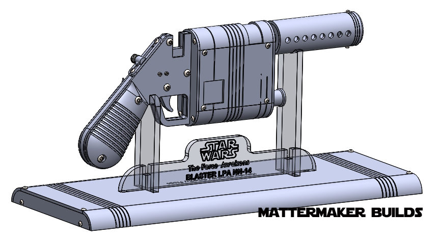

LPA NN-14 Stand model.
I mentioned that I was working on a stand for the blaster as well...
Here is the blaster with stand. I wanted to design the stand to match the blaster. The base will be aluminum, the clear parts, plexi. with the text CNC'd into the face of the plexi. Not sure if the stand will make it to the finished piece. It all depends on the manufacturing cost. We will see!

Nice work MatterMaker. I like what you have done with continuing the design of the blaster into the stand.
Mine all have to be acrylic so that the light in the display will reach the bottom shelf.
When I was looking at your stand I thought, as you have height in the base, why not try
and illuminate the stand. If you cut out the small square as on the blaster at each end of the stand and use
acrylic instead of painting them black and put in some LED lighting??? Just a thought :confused
