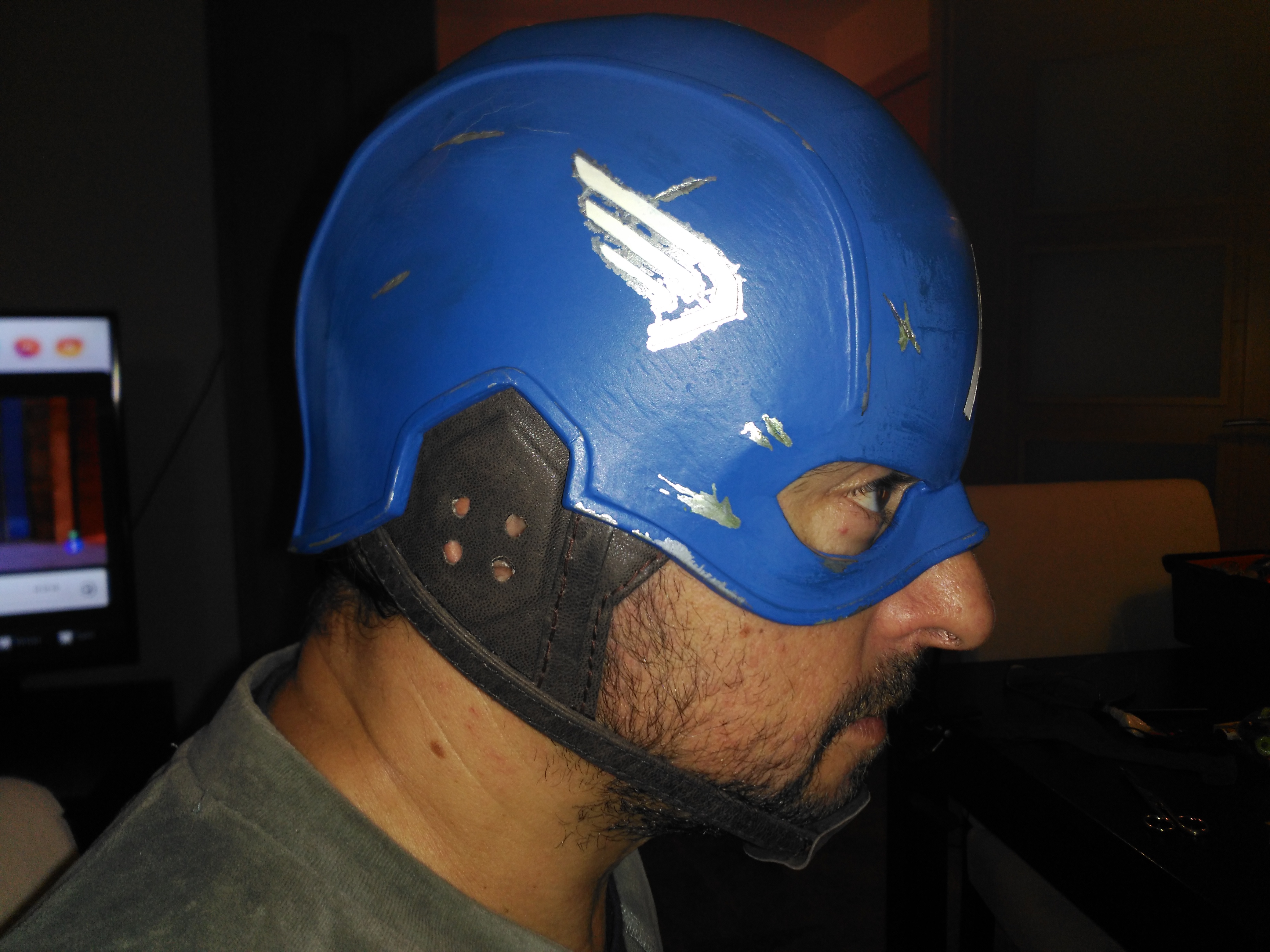

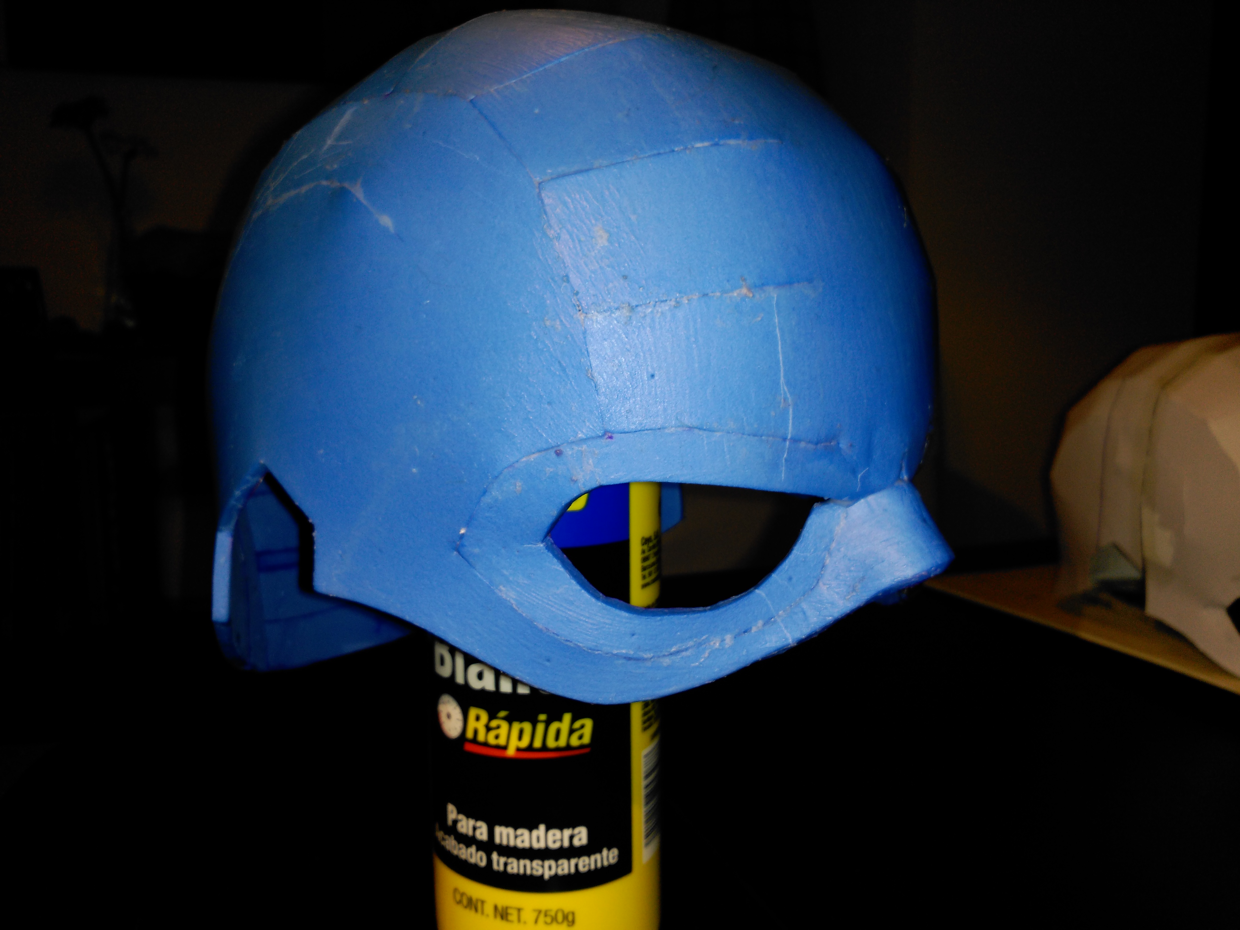

    So, first the helmet. I used eva foam, 5 mm. Then 3 layers of white glue (PVA) and primer, 2 layers. Hereunder some pics of the process. First colour did not like it, so I decided to change it later to go better with the clothes color. Leather parts were made off parts from a leather jacket bought in a outlet shop, cost 10 €

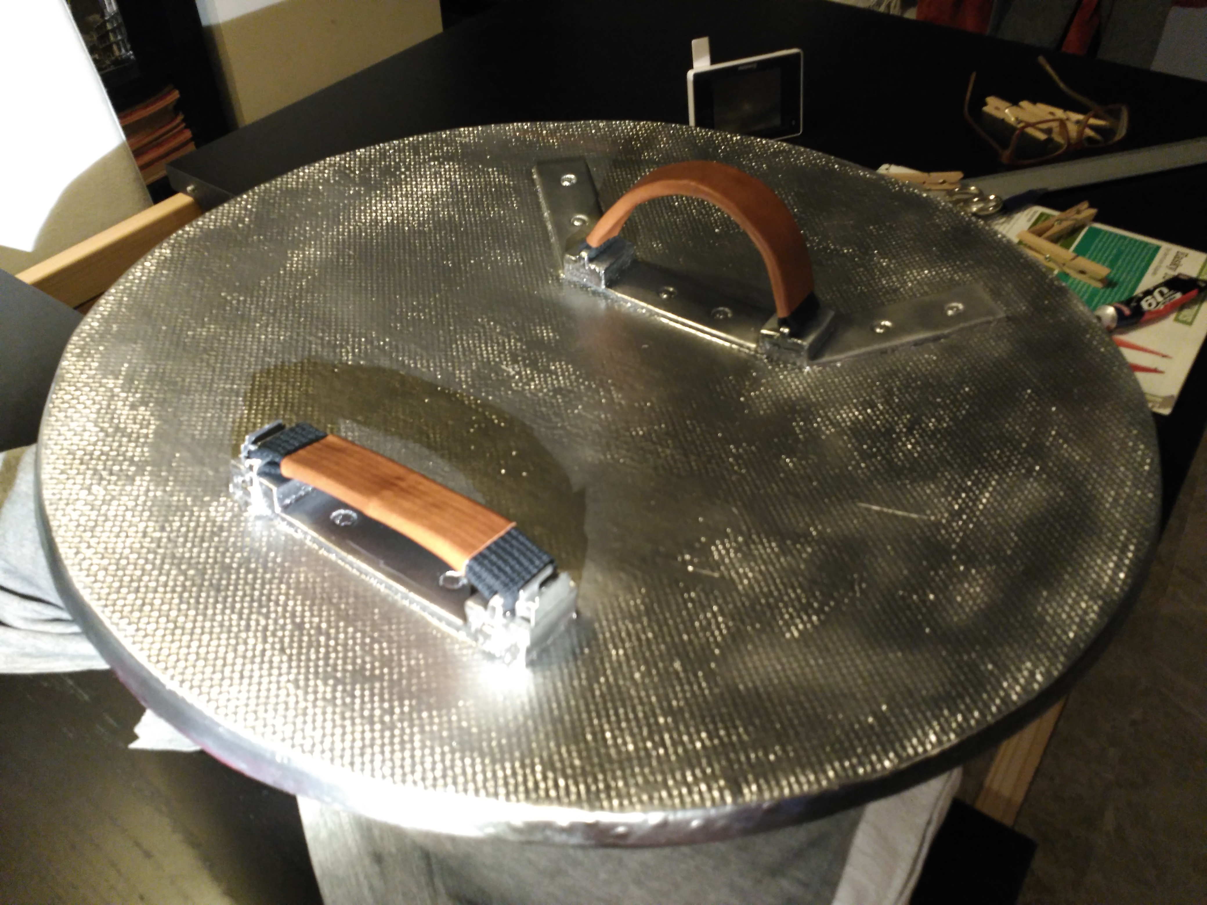

    As per the shield, I read and watch many tutorials, but I came up with an idea inspired by Bill Doranīs Foamsmith Complete Trilogy. To make boobs armor, he uses a good trick, heating up a eva foam circle, little big bigger than a bowl of cereals, and then put the circle coverting the bowl and pressed it down to the bottom and keep the pressure for a little while. That changes the shape from circle to half-sphere.
    Ok, so I thought what if you use a 55 cm diameter circle of eva foam (biggest pieces I have) 1,5 cm thickness, heat it up and put it on a parabolic dish with some weight on it? Well, I was right, I got the desired shield curve, very nicely.
    Of course, the shield did not maintain its shape because it was a big piece of eva foam and needed some hardener. I tried with some layers of white glue (PVA) but that was not enough. After watching a Youtube video from James Brutonīs Xrobots, I decided to try with polyuretane resin on top of the PVA. After a few layers and lots of sanding between them the shield was hard enough.
    When it was all nice and shiny, I carved by hand, using a broken screwdriver tip, all the circles and the star on the shield.

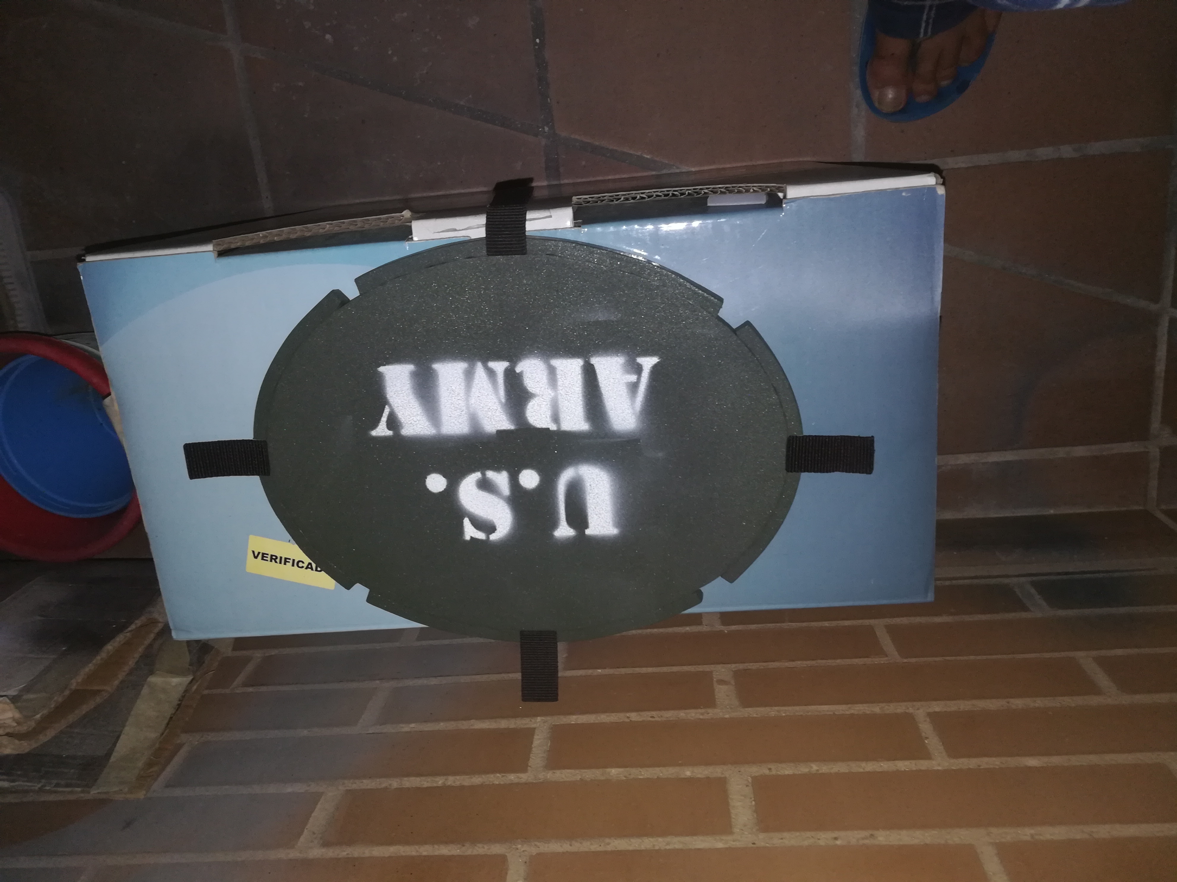

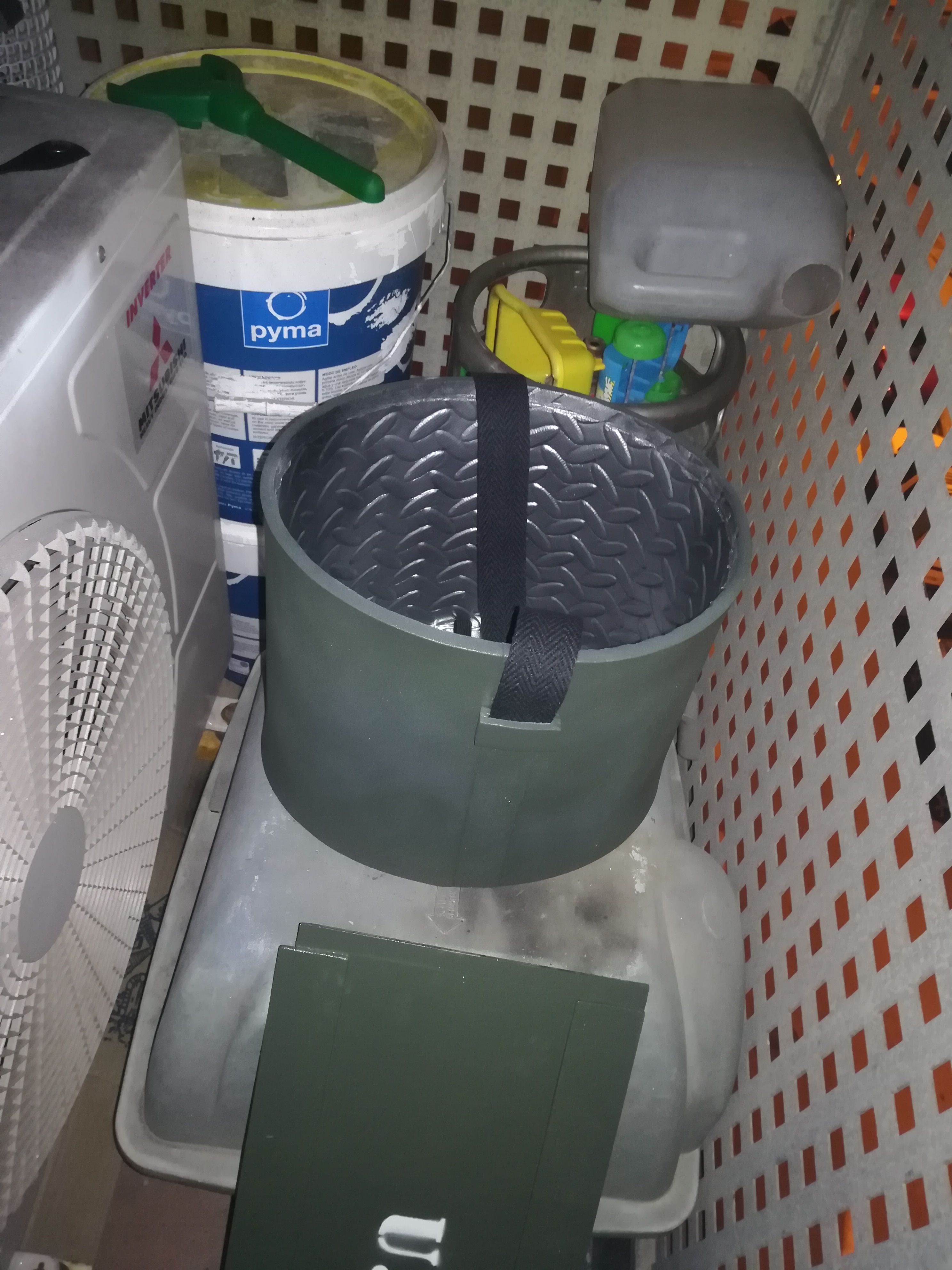

    So I was going to Heroes Comic Con at Madrid with my Captain America cosplay costume and I needed a nice/cool/safe way to transport my "work tools" on the train, so I created this
    Click image for larger version.
ID:	777594Click image for larger version.
ID:	777596Click image for larger version.
ID:	777595Click image for larger version.
ID:	777597Click image for larger version.
ID:	777598Click image for larger version.
    Awesome video here showing how these work:
    It was lots of fun to watch the faces of the security controls people during the trip indeed
