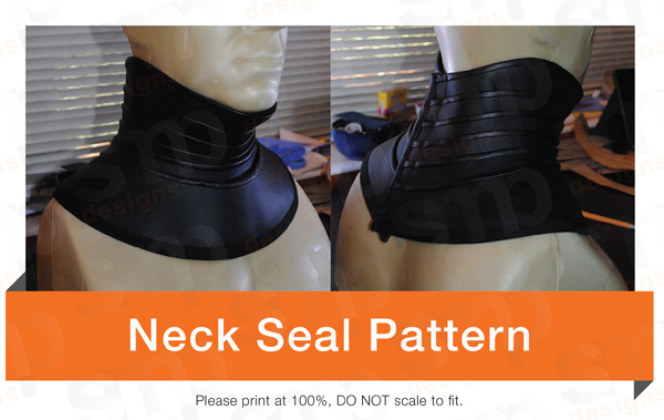

Hi guys - I wanted to let you know that I've just made the neck seal pattern available for download. Feel free to grab a copy here: http://smpdesigns.com/downloads/
Many thanks to Graphic Jordan for the awesome vector work!

SMP Designs I'm slightly confused on how the pattern goes together. I assume the piece labeled "top layer" is the layer closest to the chin? Then the pieces labeled "1, 2, 3, 4" go below it in order with 4 being attached to the bottom layer?
Re: Kylo Ren WIP (Pic Heavy)
Read through the first page posts, he step by steps the whole process.
Basically, you assemble the base, and the layers go top, 1, 2, 3, 4, on the base and the bottom layer forms the shoulder drape. On the bottom layer, the pattern pieces should be taped together at the join line - there is no seam there. The layers are cut on a fold at the center front line.

Thanks Graphic Jordan - also, be aware that the notches on the layers align to the side seams of the base and mark the bottom of the piece.

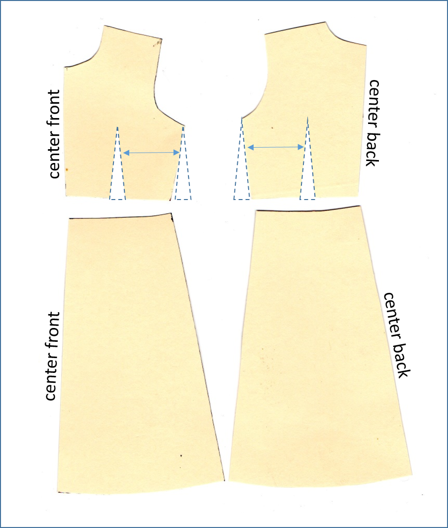

So, @Bogleo asked a really good question over on his thread that follows up the comment above. He asked about fitting with darts vs shaped seams and what I thought was the best way to get a fitted look and still maintain the fairly simple pattern. Below is what I posted there and I thought it might be good to include here as well as an FYI...
"I think you can do all the fitting you need with darting or moving darts to the sides. Also, you should probably have a seam at the waist to give you more flexibility in fit and shape.
Here's a really rough basic pattern template that I threw together to illustrate my point.
So, on the upper body sections, you have a choice - you can dart the front and back pieces as well as have tapered side seams or you can move all of the tapering to the sides (essentially, you just take the dart and cut that amount out of the side). This works if you're slim and don't have a huge drop from your chest to your waist. If you have a large chest and a small waist, I think that distributing the fit around the piece evenly (via darts) is best.
With the lower sections, cut these with a waist seam (will be covered by the belt anyway) and give them some flare to add fullness and drape to the finished piece. Here's a quick and dirty diagram for taking a rectangular piece and adding flare to increase fullness.
So, that was maybe a lot more than you wanted to know, but I hope it helps. :)

Hi
I printed out the neck seal, at 100% but it seems to short in length around the neck. Only 3/4 long enough.
A4 size for the print or A3 is the only thing obvious that i can think of to fix that.
Any ideas
