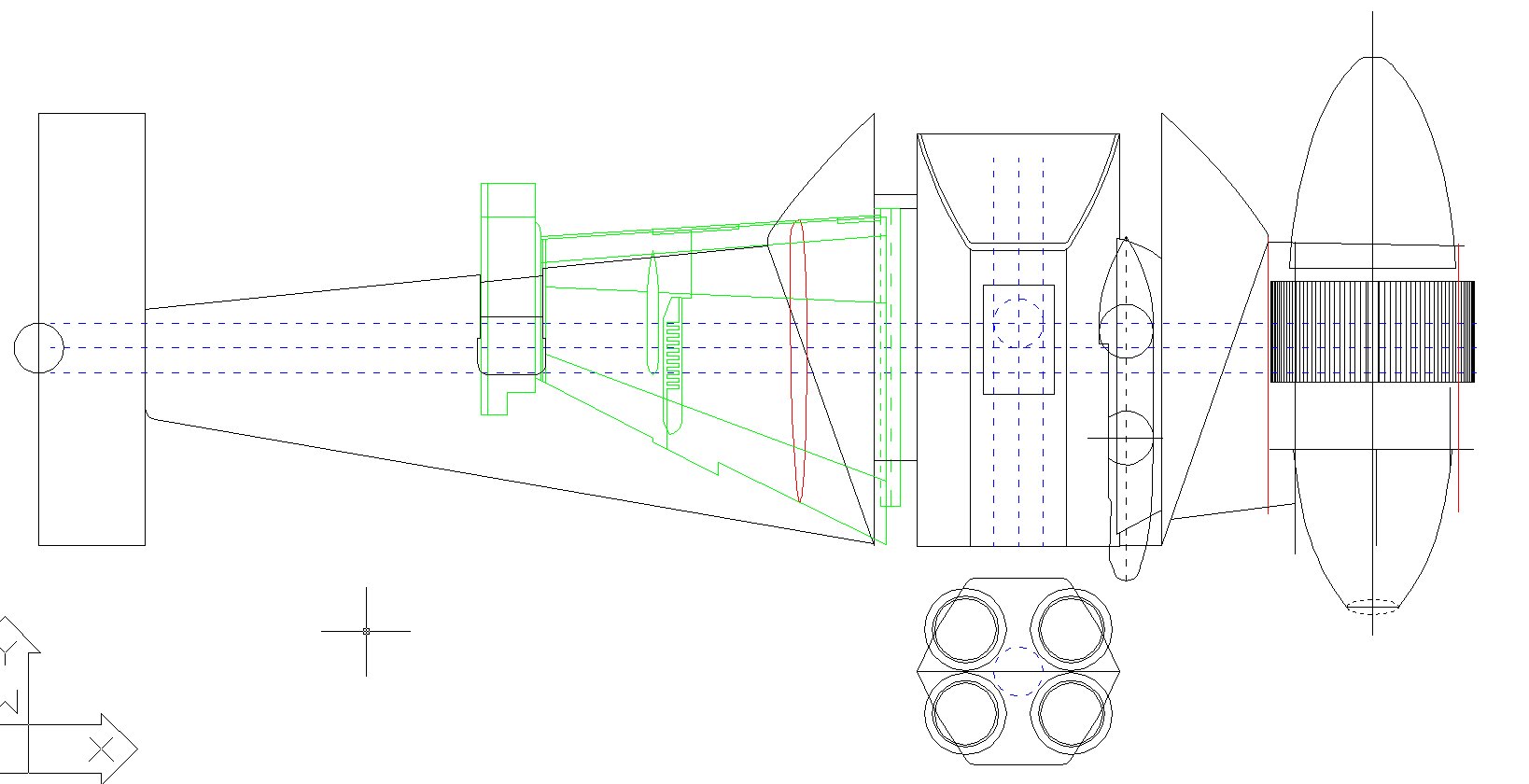

    Mar 14, 2016, 1:52 AM - Re: 1/48 B-Wing Scratch Build #76

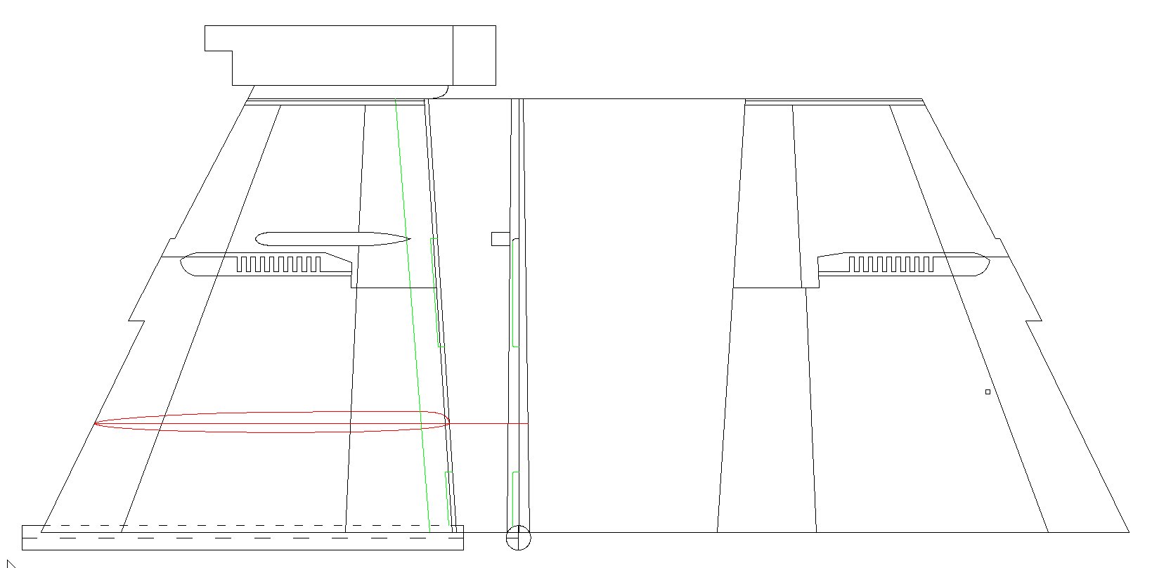

    So, here is today's progress; this is a 'screen print' so it most likely has a bit of distortion in the image. My plan is to finish up the drawings and then print and scan the result, then save as a PDF for ease of sharing. I am drawing to 1:1 scale so any dimensional data will show as full size.
    So, point is: this is more of a progress report than usable drawings. That said, if you see anything that looks 'off', please advise me so I can correct it.
    I do know the Saturn V section is oversized but that is because it requires trimming. I included it simply for reference.
    Click image for larger version.
    Also, if any one has any idea how a landing gear might operate on this thing, I'd appreciate your thoughts.
    Cheers!
    Robert

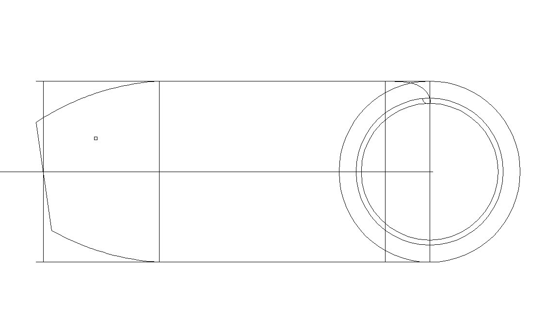

    Mar 17, 2016, 11:50 AM - Re: 1/48 B-Wing Scratch Build #77

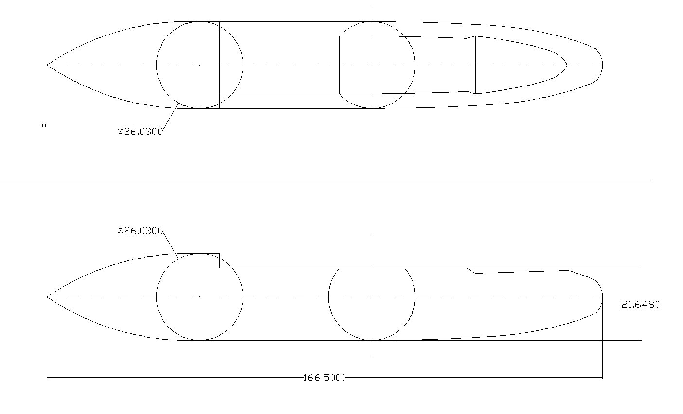

    Another update for the drawing: the 'engine box'.
Name:	engine pod box.jpg

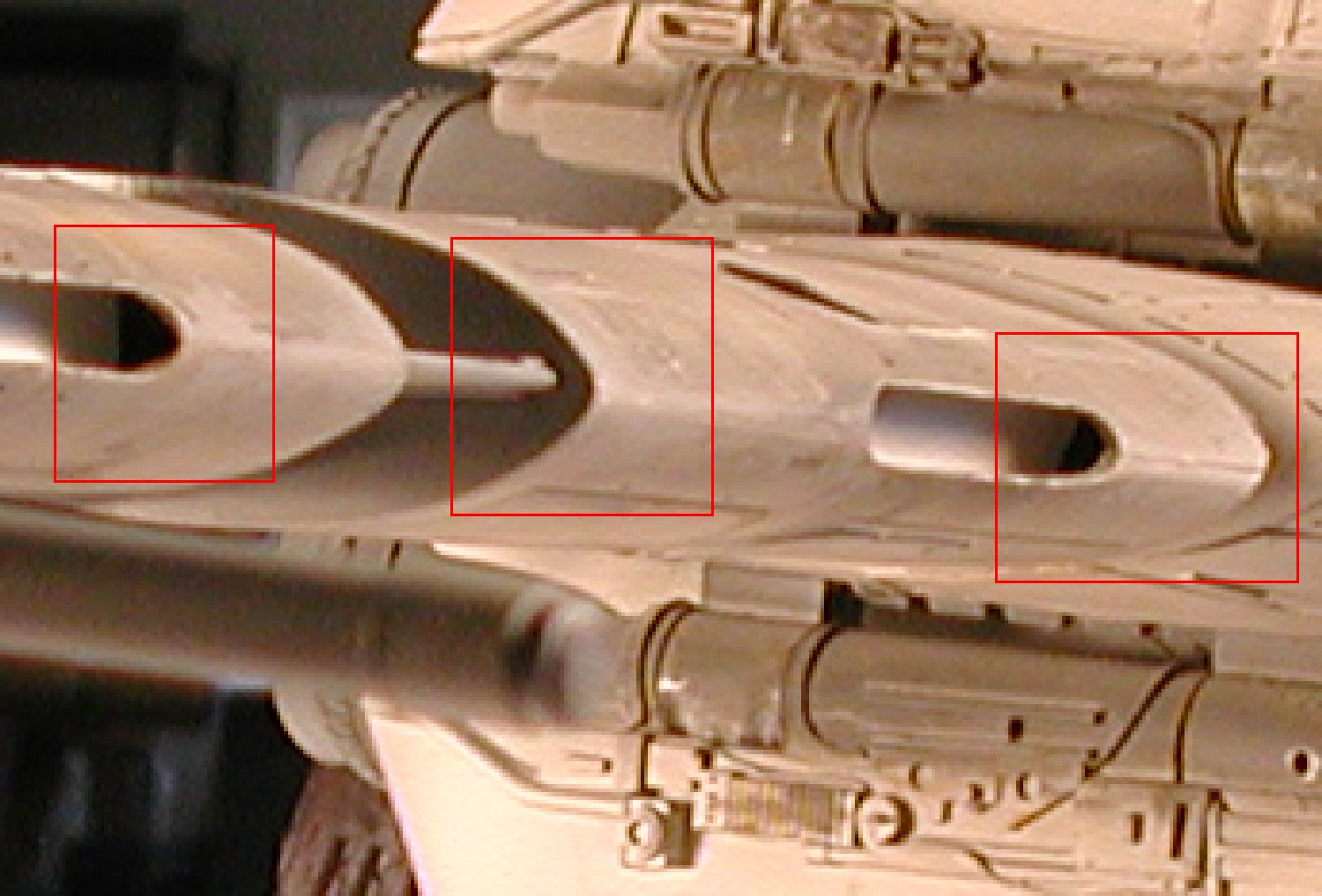

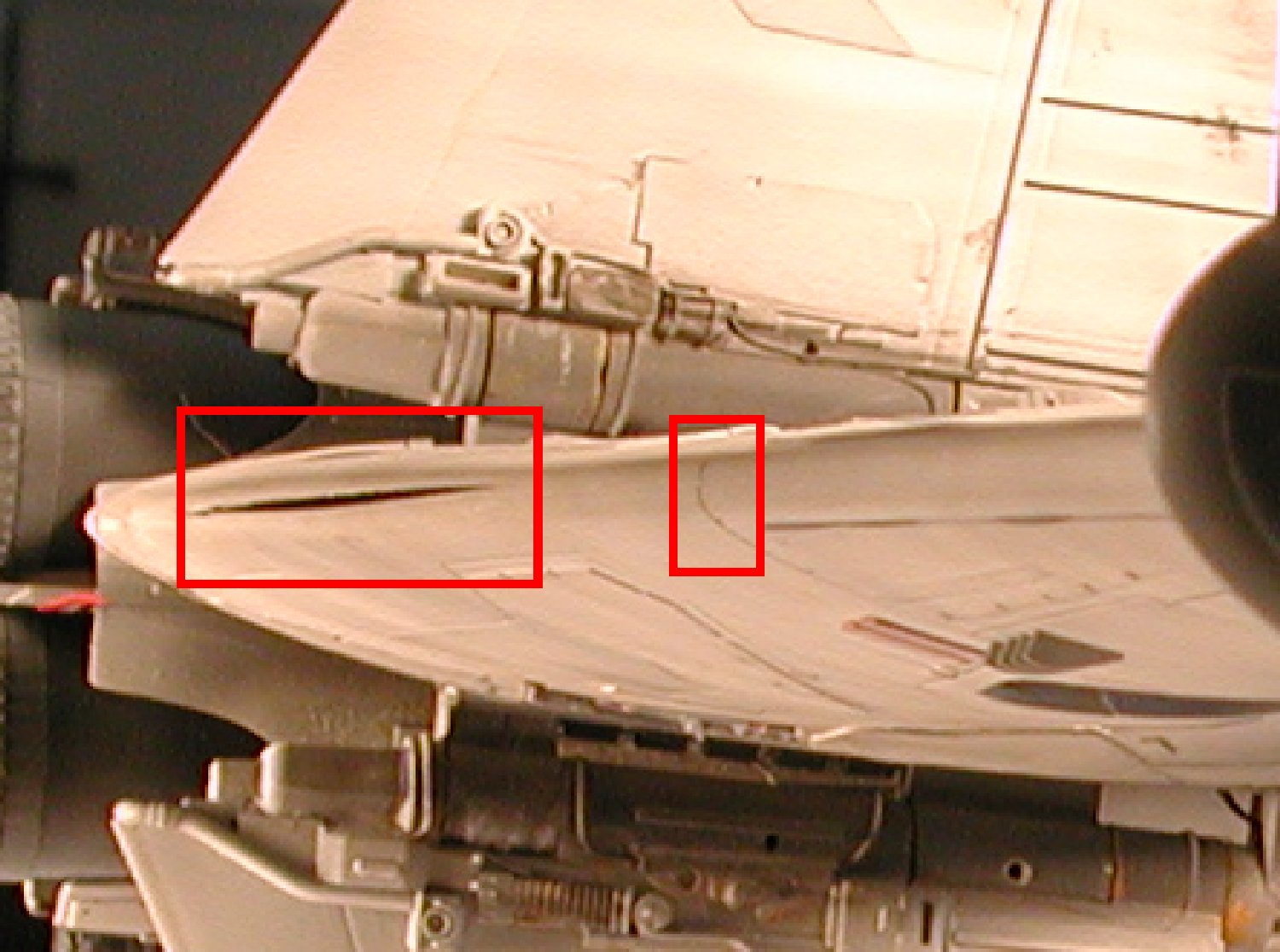

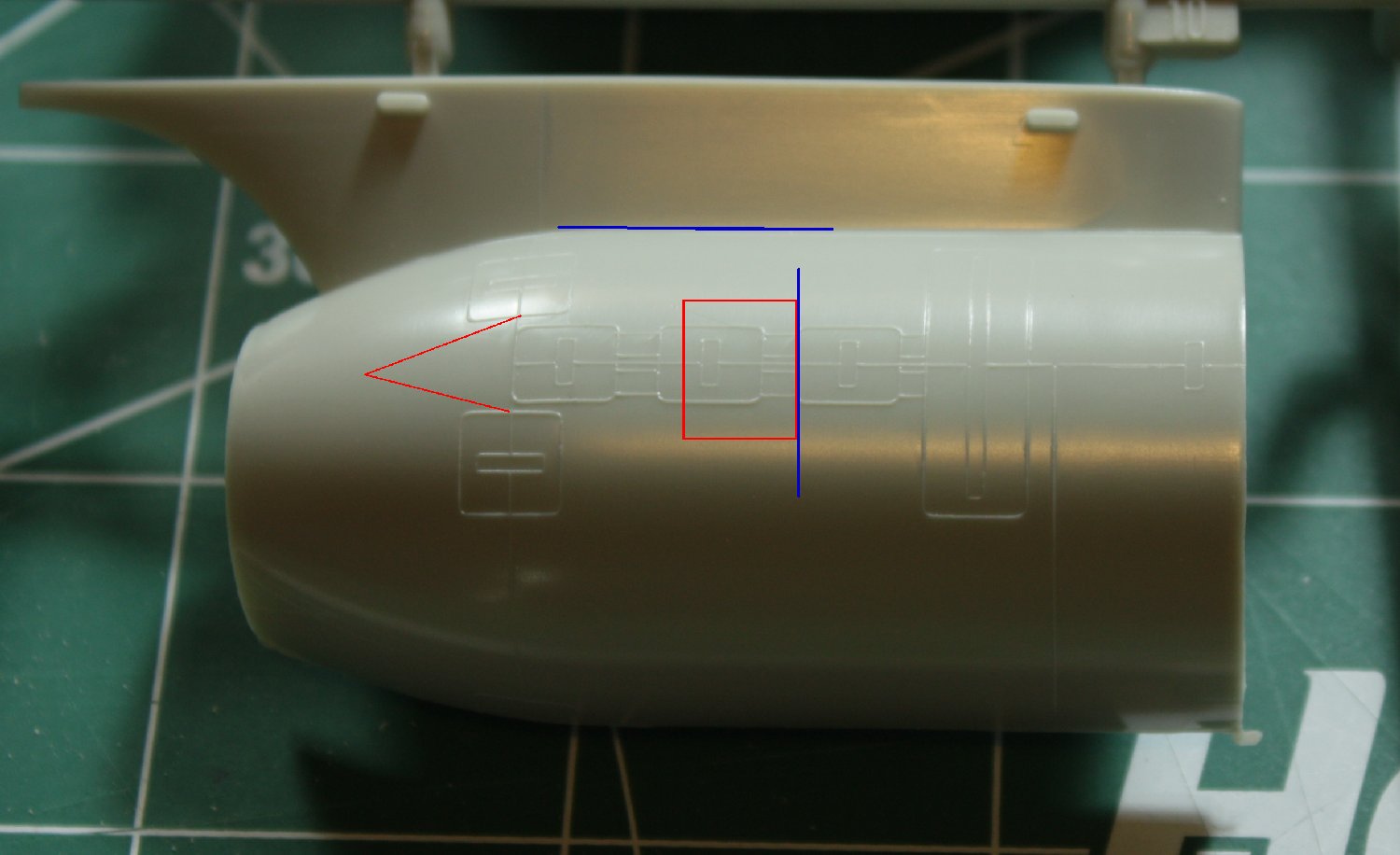

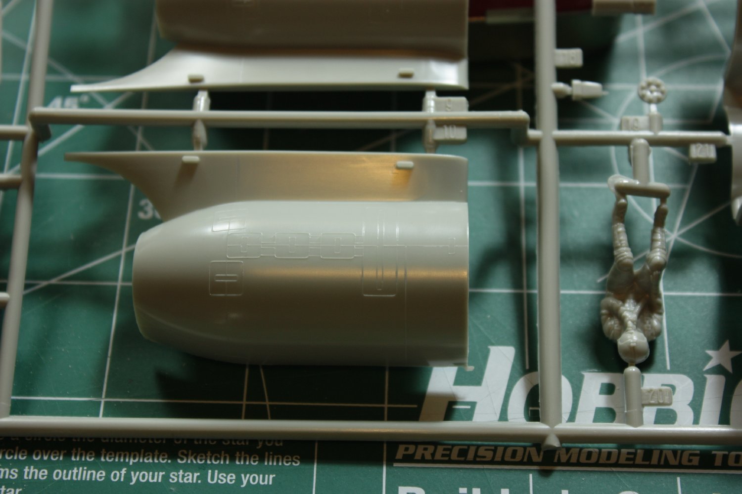

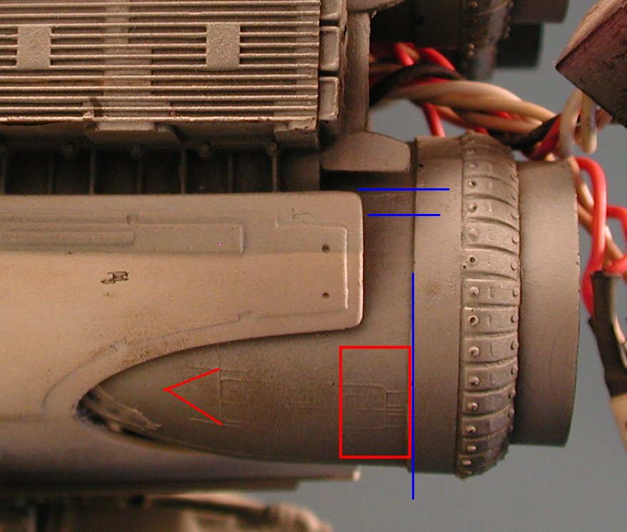

    Note that I have made a 'plan projection' of the box shell's cutout for the engine bells. This can be used as a pattern to accurately cut those relief cutouts. Also, there is a slight 'tilt' to the engine bells that I noticed when I tried to draw in the bells and found there wasn't enough clearance between the top & bottom rows. I didn't change the angled end of the engine bells to fit anything specific. I'd expect the ILM team had sanded off that angle so the bells could sit straight on the rear bulkhead or at least at the angle they needed for clearance. The depth the rear bulkhead is set back is unknown so I took a reasonable 'guess' based on the model pix.

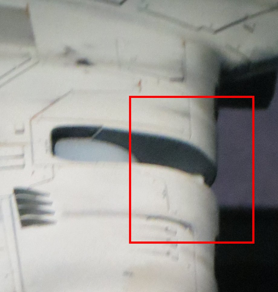

    I also noticed that the F-14 drop tanks were rotated such that the seam between the two tank halves is about 45 degrees from horizontal (or vertical for that matter...) This implies that the tank mounting is such that the 'cutout' is aligned with the surface of the engine box sides. Also, the spacing between the tanks precludes the armature pipe from passing between them, hence there shouldn't be a mounting point on the outside of the crew pod. Wait! I see a pipe opening in this picture. Perhaps the armature pipe was not a 3/4" (19mm) pipe after all... 5/8" perhaps? Or perhaps two different sizes?
    Looking closer, it appears there are cutouts in the tanks visible where the armature would need to pass... so they just cut the part to fit around the pipe. Interesting...
    I noticed a few things working on this. One, the 'orange' (O) & 'blue' (B) models differ on some intake details:
    1. The upper and lower 'bay' blanking plates on the O are vertical while on the B they are angled. I used the angled B version in my drawing simply because I like the look of it better.
    2. On the O intake, the upper and lower horizontal divider plates have a leading edge even with the outer shell edge (as on the drawing.) The B plates are set back slightly in the opening and with forward edges that appear to be slightly curved inward.
    Both versions share a feature: the center 'side' bays appear to be open at the back as I've not been able to discern any blanking plate to them, unlike all the the other "bays". It has already been shared that the four center 'openings' define a covering plug that allows access to the mounting point on the armature. Most of the pictures of the models show that plug dislodged a bit, protruding instead of being flush with the center divider.
    While working on the mounting for the auxiliary wings, I noticed that the whole 'wings' section, comprised of the main and auxiliary wings. was dislodged in the pix of the 'orange dot' model taken by Jason Eaton. It appears that the section had rotated slightly around the axis of the armature pipe running its length. Whether this is damage or just a loose assembly joint is unknown. It does make determining the placement of the aux wing's pivots problematic, however.
    Regards, Robert

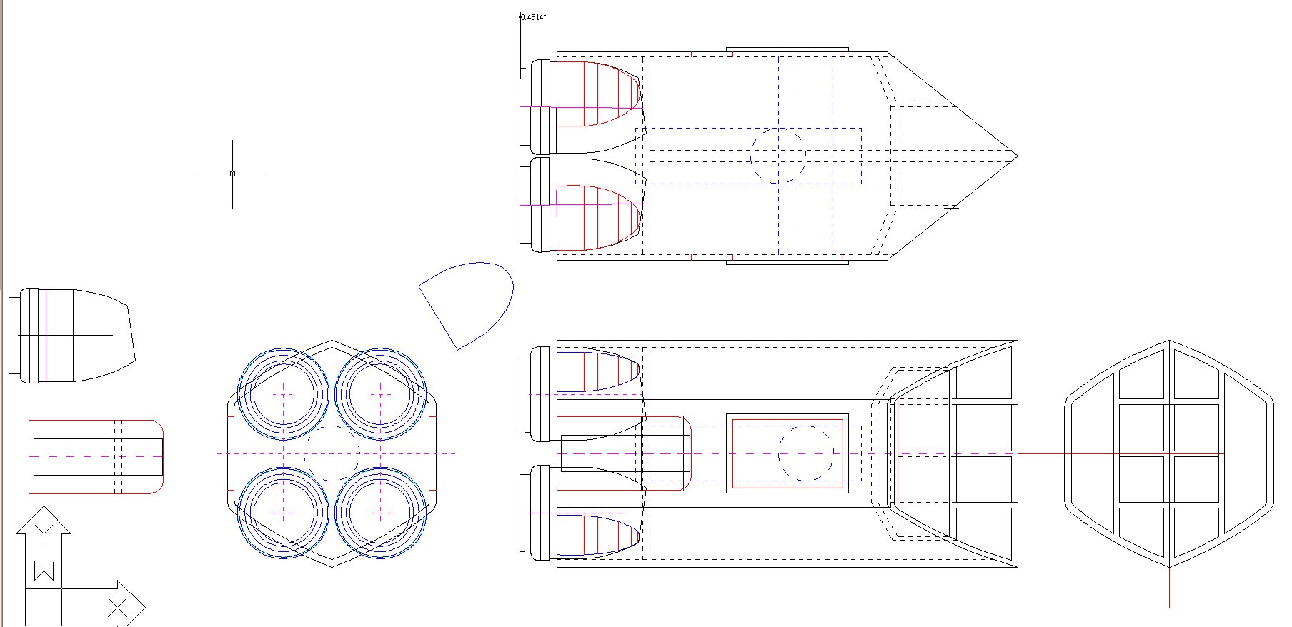

    Mar 20, 2016, 1:30 PM - Re: 1/48 B-Wing Scratch Build #84
    Saw an interesting post by MonsieurTox in Studio Scale Modeling via his AT-AT thread (click HERE) and this made me wonder, so this is for Julien:
    Greetings, Julien!
    My question relates to the position of the armature within the engine 'box'. Putting together my 2D drawings, I placed the mount access hatches on the top and bottom in what I believed to be the correct location, but then the result was the exposed vertical armature mount tube location was incorrect compared to pictures. However, when I moved it by a radius distance it fell to the correct location in the hatch opening. I've accepted that this assumption might be correct or incorrect as I've nothing to show what the 'naked' armature looks like but it still presents me a puzzle. My primary assumption was the long tube's location connecting the mount openings in the crew pod and the main wing 'weapons' pod was correct and hence everything else is based on that starting point.
    That said, short version is there perchance direct evidence of the configuration of the central 'star' in the engine box? I like your version better but it also means I've got some stuff to redo if confirmed...
    Thanks and Regards, Robert
    Update ------------------------------------------------------------
    Being aware of this possible discrepancy, I did a bit of manual 'photo-metric' analysis using an almost direct side-view of the 'Blue' B-Wing and found minor adjustment of the fore & aft position of the horizontal armature tube allowed things to line up much better, such that my plan now looks like this:

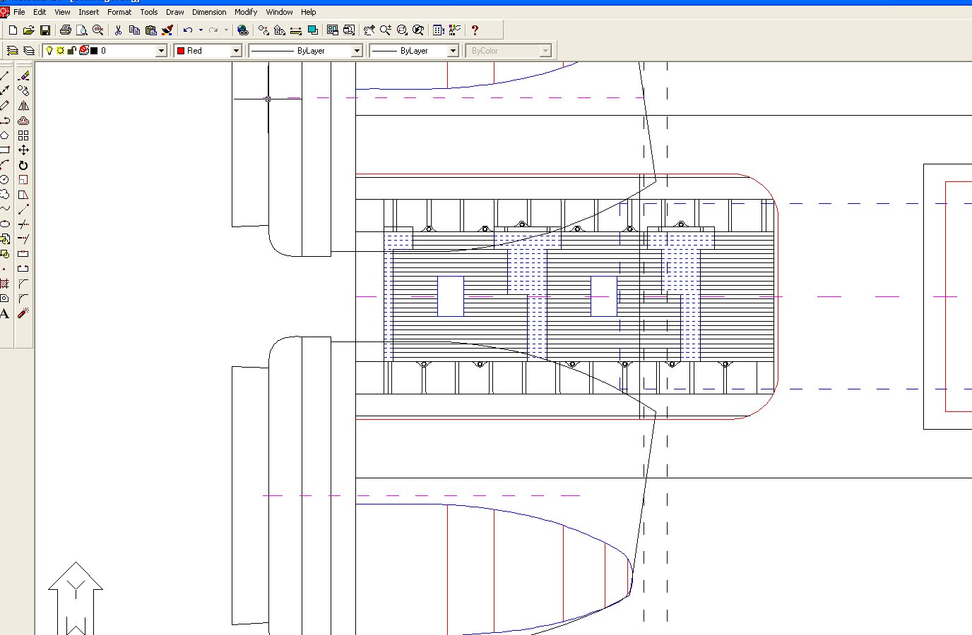

    Mar 21, 2016, 12:59 PM - Re: 1/48 B-Wing Scratch Build #85
    So, I've incorporated the tweaks that are indicated by the armature configuration highlighted by Julien, plus applied some details to the crew pod, as seen below:
    This was all done 'by Mk.I eyeball' and photo analysis, so hopefully it is reasonably correct to the studio models. I can say the Leopard track is accurately sized, so that portion at least is solid. The cut-outs in the cockpit shell were developed using cross-sections and angular displacements to determine the intersection points and should be pretty accurate. The biggest assumption relates to the profile of the shell itself, which was sketched over an image, but the image was a bit blurry yet used because it was the one with the least amount of distortion.
    I ended up reducing the size (ie, the diameter) of my AMT Saturn V segment by quite a bit to get this clean result. My drawing may be 'tighter' than the actual studio models, which seem to suffer from a certain amount of 'slop' between the Saturn part and the rotating crew nacelle. This most likely is due to how rotating joints were engineered which has suffered over time. I was wondering how they allowed for the armature tube running through the center. Obviously, the crew nacelle couldn't rotate if it had a solid connecting axle or tube running through the Saturn segment. Perhaps there were 'windows' cut into a connecting tube to allow access to the armature, as long as the pod was aligned properly. However, the image showing the open Saturn V 'hatch' doesn't show anything indicative of that, so apparently the fore and aft portions of the crew nacelle rotate independently (unless there were actual connecting, synchronizing shafts with gears so turning one half would also turn the other...hmm!)

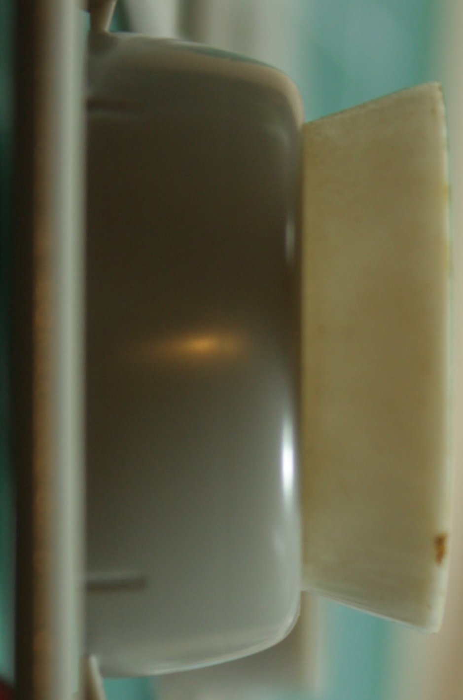

    Here is a bit more of my concept for the pri-wing's landing 'prop':
Name:	landing gear_priwing_cu.jpg
    Regards, Robert
