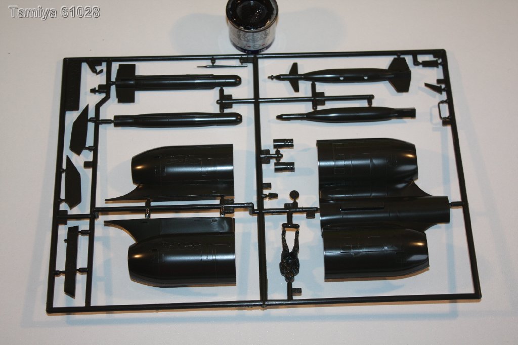

In the meanwhile, here is a teaser from parts images of the Tamiya kit from Flevo Aviation website [http://www.flevoaviationhobby.net/images/kitreviews/1-48/tam61028/tam61028.html]:

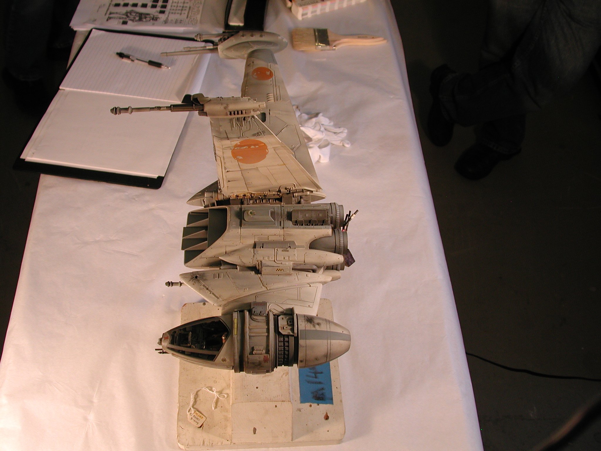

Here are shots I have , the B&W is obviously legitimate, image.jpegimage.jpegimage.jpegimage.jpegimage.jpeg The others were taken of the studio model by Steve and posted on modelormagic
it may help, maybe not but if you have contact with someone who has actually built the full studio scale as it's hard to see from the images but I thing they are proud of the main wing , maybe with some photogrammetry you could check it, maybe someone has a shot from a show ......ill keep digging
be careful as there is a lot of shots out there that look like the studio model but I can't confirm
Vac-Hero, very interesting WIP shot - I can make out another B-Wing in the background, laying just right of the air hose. Interesting that the armature passed through the crew nacelle 'clamp' area. This means, if the front and rear halves both rotated, then likely they were independent. Wait, I guess a relatively thin rod could connect the two, with still enough room for the wires to pass...
I also noticed what appears to be a rod or tube that is situated on upper primary wing's trailing edge. I wonder what is it's purpose?

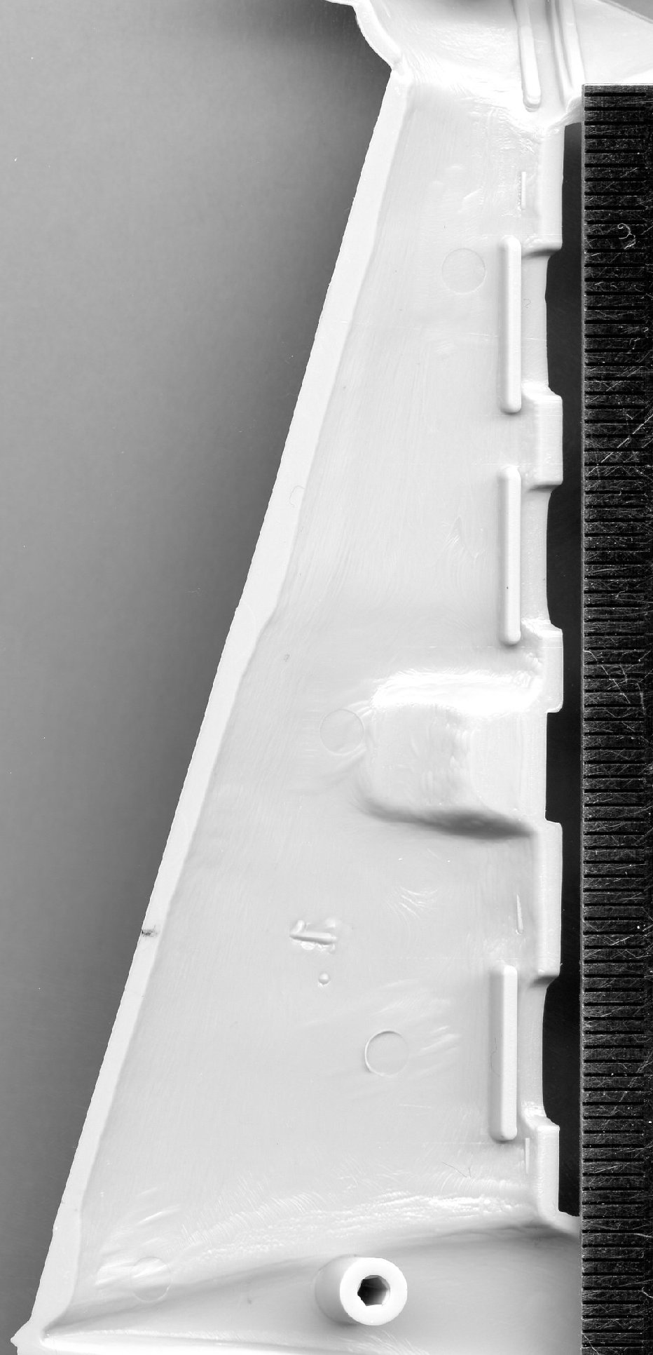

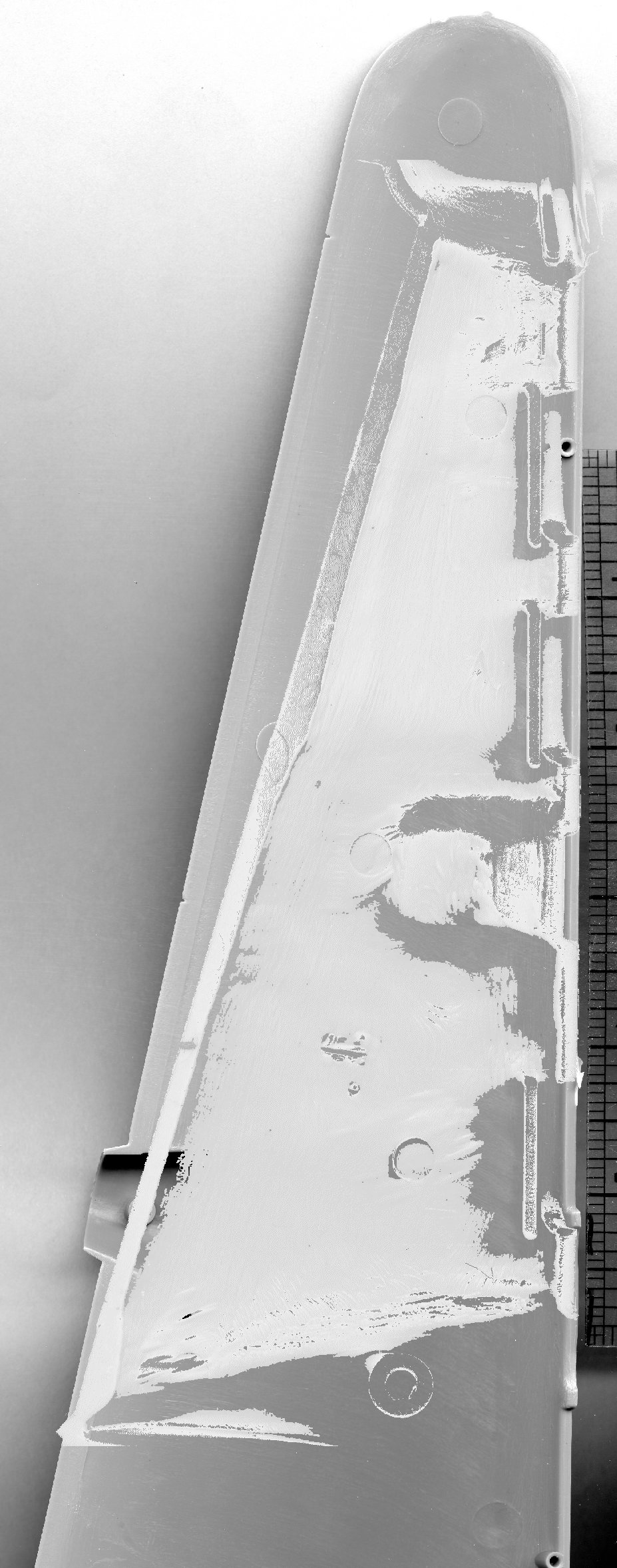

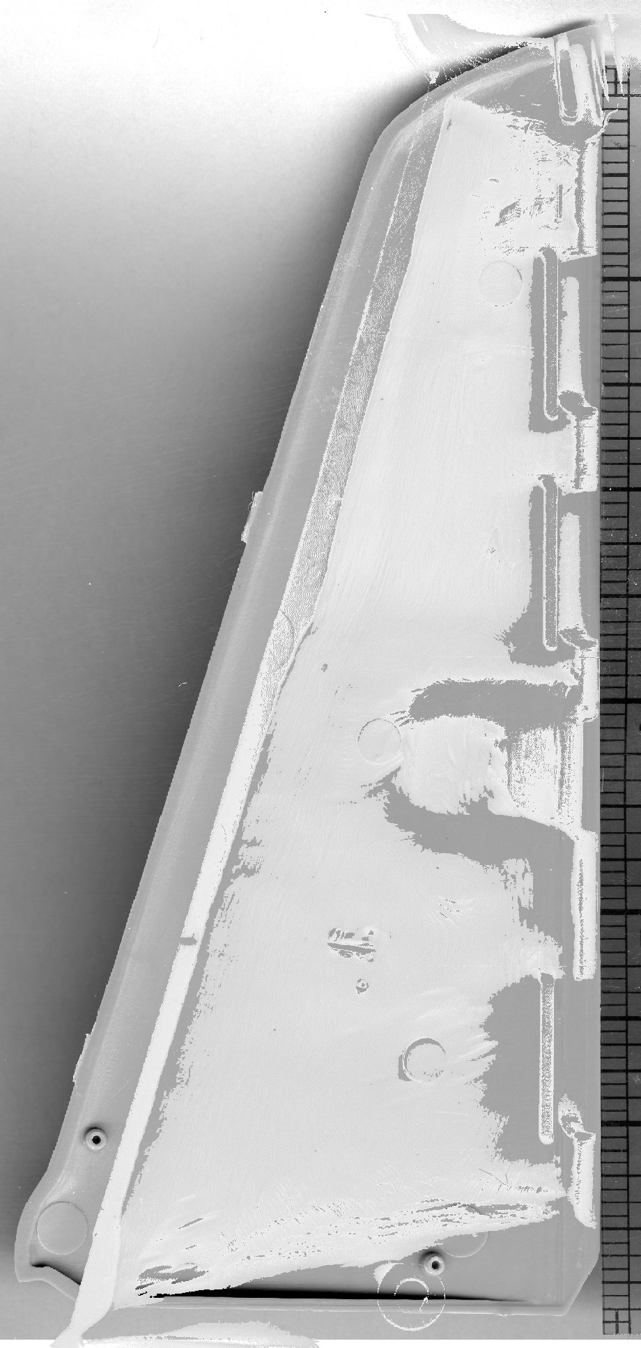

So, I pulled the 1/72 Monogram B-36 out of the stash and compared the top wing half to my only exemplar, the 1/100 MPC B-Wing kit. It wasn't a good match when I ghosted the AMT part (on right) onto the B-36 wing (note the angles and the location of the B-36's engine fairing):
The F-14 wing part matches the angles much better (note the wing is backwards with the trailing edge matched to the "leading edge" of the B-Wing):
The result is, if the B-36 wing were cut to the correct length for the studio model, it would be too narrow in chord. Granted, there is plenty of plastic in the part so it could be trimmed to the correct angles (the part is some 18" long and only 9.3" is needed...) In fact, it may have been exactly the case, that the leading edge was trimmed so to reduce the thickness of the assembly so it fit around the armature pipe better. However, for my purposes, it may be easier to achieve the desired result using the F-14 parts even though I'll need a splice job to get the needed length.
