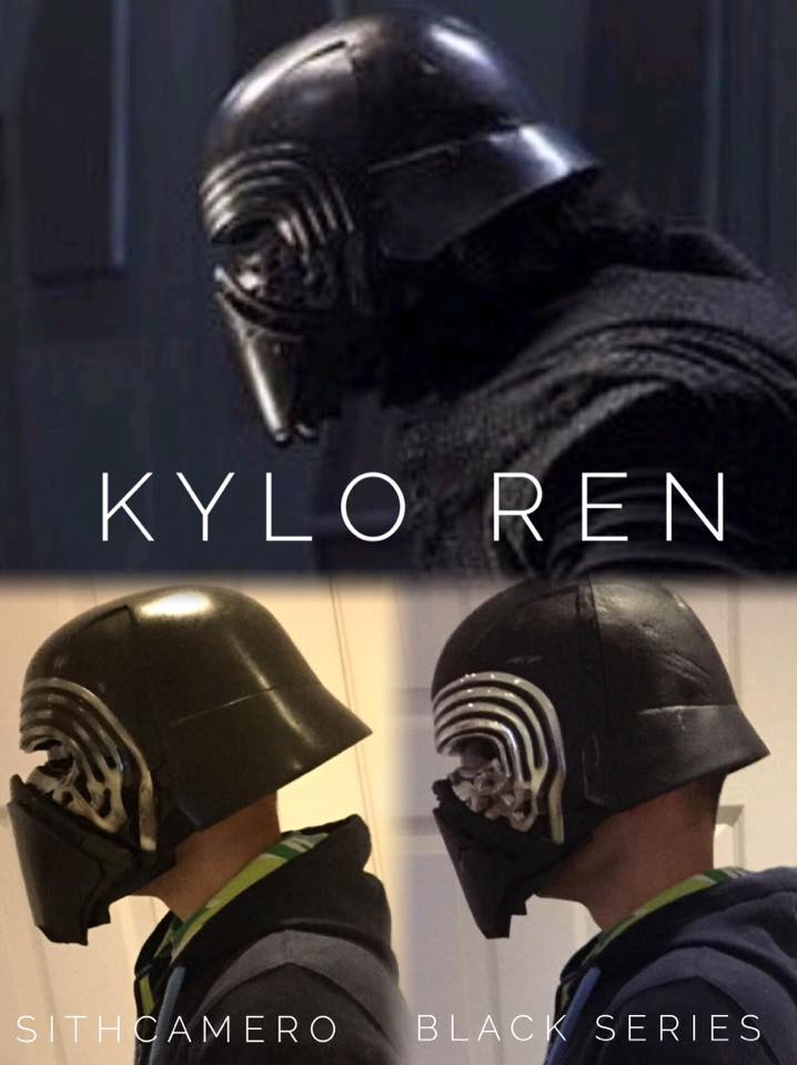

Does anyone know what the inaccuracies are on the Kylo Ren black series helmet (besides the obvious like battery compartment)? If so, can you give me some cross reference? I'm going to be making a cast from it, so I'd like to fix all the inaccuracies first.

- Visor needs to be replaced with a mesh.
- seams from 2 halves and battery compartement need to be filled
- Mouthpiece breathing holes need to be filled.
- Speaker holes on brim needs to be filled.
- chrome needs to be dirty
- spraypaint the black with a texturing paint
- side flaps need to be cut out and made wider.
And something jamestan has done is to cut and reposition the peice that sits between the chrome and the flap, with thee three ridges in it so it tucks behind the flap.
