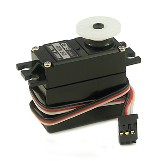

i think if i had to do it ...i'd use a little servo from rc air planes....you know like the kind they use in the wings.
then you'd have to hook it up to a micro controller of some kind and either a light sensor or movement sensor.

I mirrored the Arduino/servo approach as well..
would be very easy... let me know if you want any help.
the light activated 'roar' could possibly also trigger the movement up/down..etc..

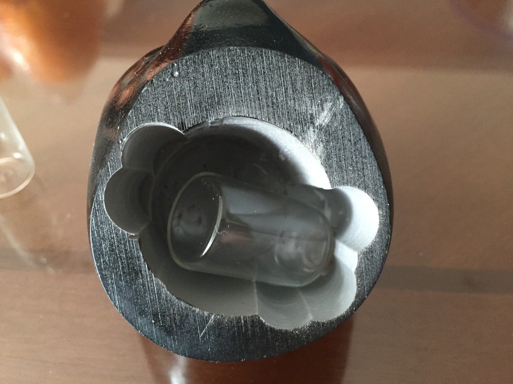

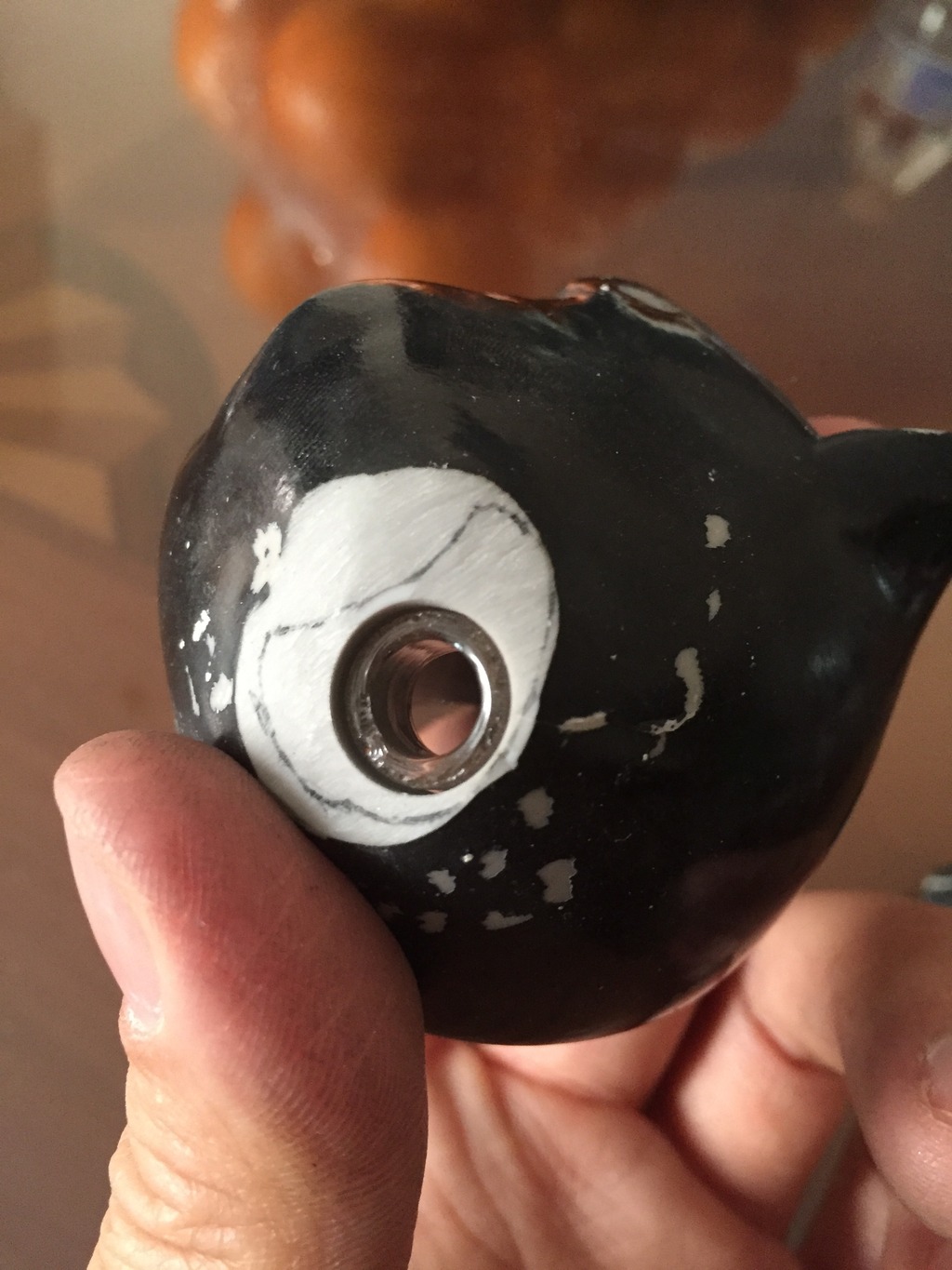

Little update on the head progress:
Bought a bunch of small glass vials (with cork stoppers). I managed to grind down the "lip" using a combination of my lathe and a dremel tool grinding wheel.
Next, I was able to use the band saw to get the pather's left ear off. Used the sanding wheel on the dremel to smooth out the cuts a little bit.
Then I traced out where the ear will go and drilled out a hole to fit the neck of the vial
Next, I had to widen out the bottom of the head cavity in order to adequately fit the vial.
And here's the result - you can see the glass vial in place, with and without the cork for test fitting.
4C64E5E8-A5C6-4537-B3E7-B2A698411624_zpshojxvdm1.jpgAB928477-824E-4EB4-9750-A15EB321E654_zpsizxadtrd.jpg
The vial neck is now being glued in place. Once that has set, I plan on filling the rest of the cavity with some of the expanding foam sealer that you can get at the hardware store. That should provide enough stabilization for the glass vial.
