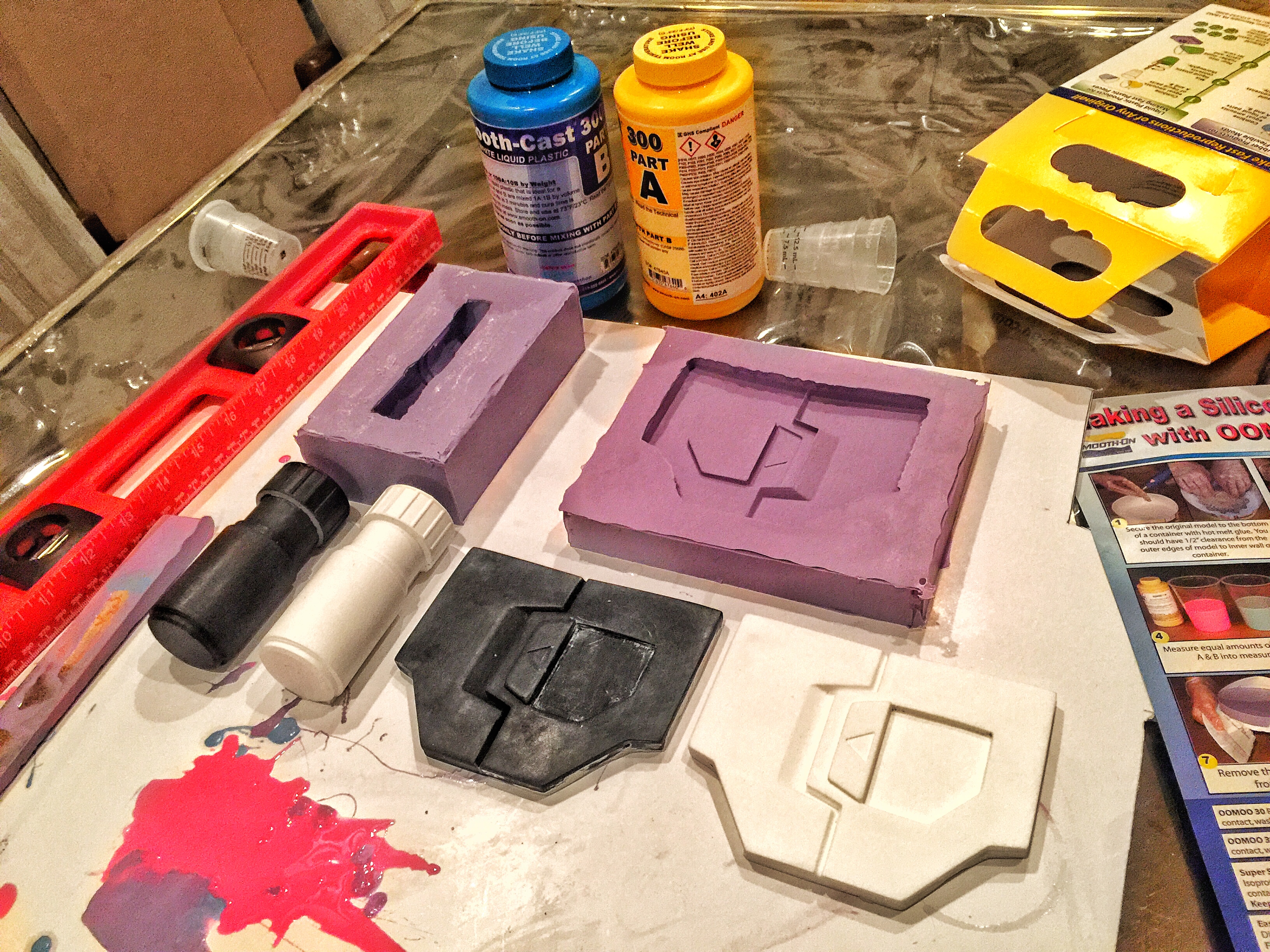

Moving along I then started on the belt buckle. I originally was just printing it for size and used a horrible resolution. I then went to sanding and ended up using it as my actual master piece. Had to made some changes to the underside of the buckle and fill in a lot of hollow portions as well as fix the effects of ABS warping. After I felt satisfied with the surface I started the mold. Same method as previous piece. Another successful pull. Next will be the pouches.

Just updating this. Haven't had much time to work on my prototype. Finally smoothed out the pouch and decided to mold it out with Mold Max 30. Made my first casting of the pouch again using Smooth Cast 300 and it came out pretty nice. Next thing I'm going to do is remold the buckle and thicken it by about half an inch.

Still haven't made the master pieces for the belt itself, but decided to mock up a beta build to test it for finish, weight and such. The belt itself is still made of foam but the pouches, capsule and buckle are all molded and cast in smooth cast 300. Belt feels heavy in hand but once you snap it on you don't notice the weight at all, truth be told it makes the thing feel more authentic being that batmans utility belt would probably have some weight to it. Anyhow I'm pretty happy with this test piece so far. Moving forward though I still have to finish my edits to the buckles master mold and im going to try and mold the belt in segments so that it has no foam components when I have the finished product.

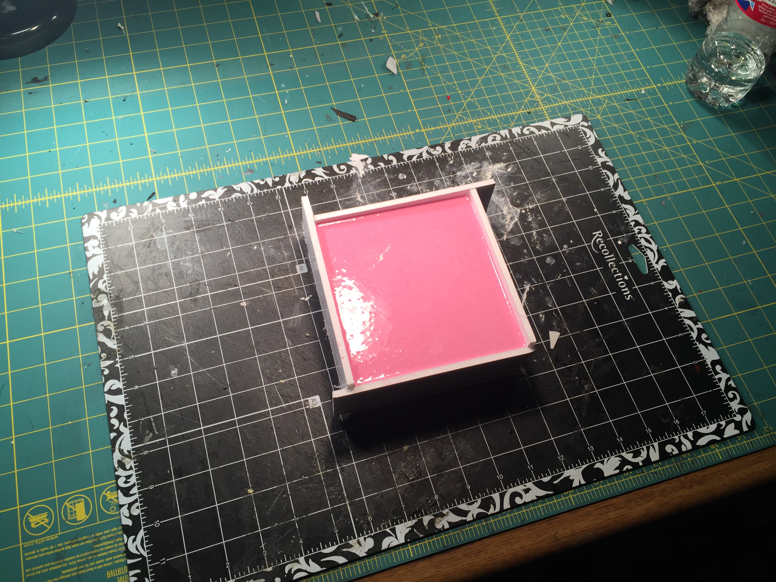

Mold boxes all setup. Now my least favorite part. Calculating how much A:B to mix to fill these molds...
Re: Batman Arkham Origins Utility Belt
Crossing my fingers on a proper mold. From what I felt was a through mix and uniform color consistently when pouring... I fear that the batch was bad or that pockets of unmixed product made their way in as now towards the end of the cure time I'm seeing small pools of lighter shaded silicon on the surface of the mold as if parts of the A:B mix might have separated during the 24 hr cure time. Upon suggestion of the folks at RAM I'm putting them under heat lamps for the duration of the cure. Not sure how that would help but I'll it if it keeps me from having to redo the whole process over again and wait another 24 hours. 2 more hours to go then I'll demold and see if the molds are intact and usable or just pink pieces of trash.
