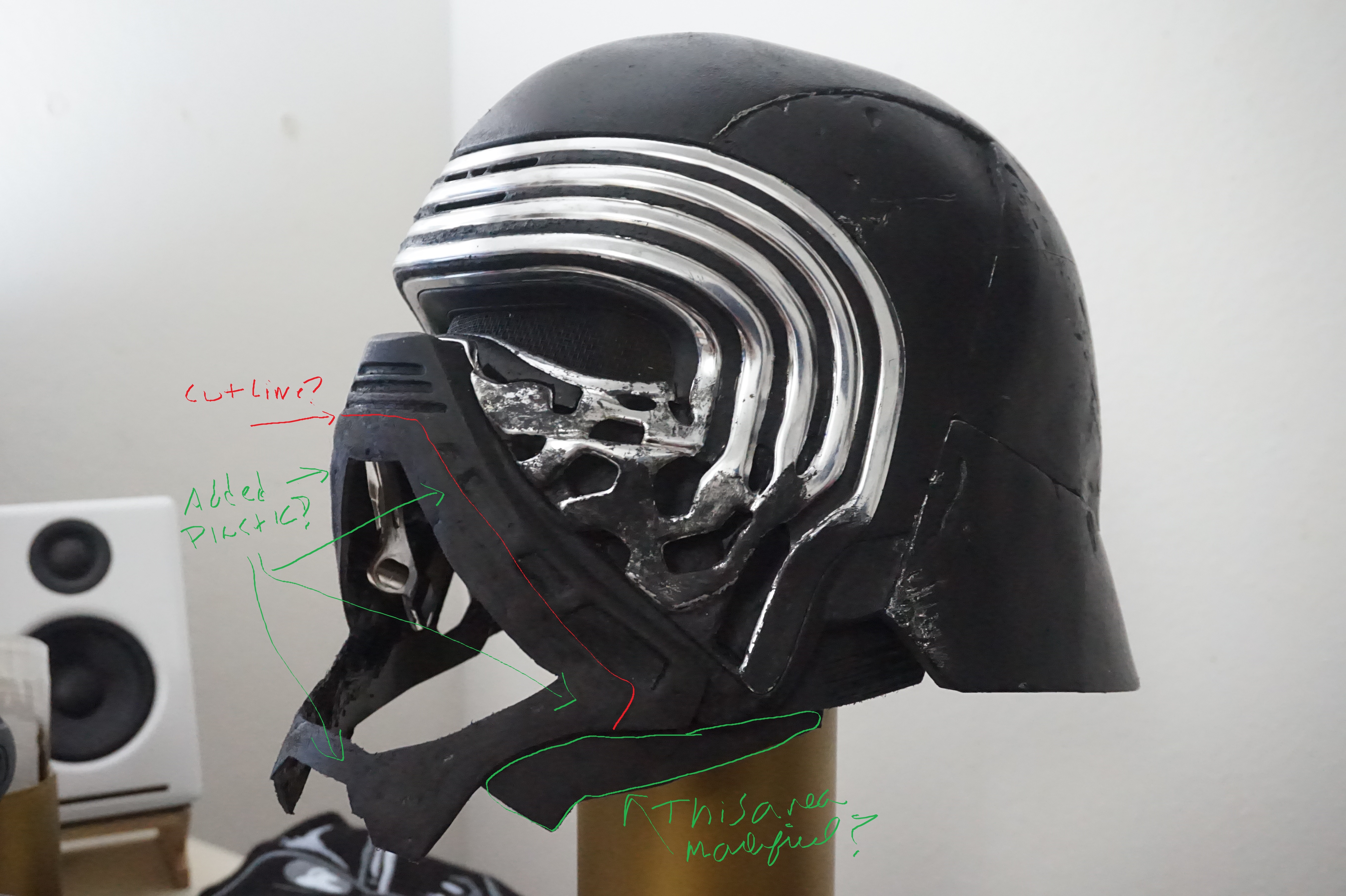

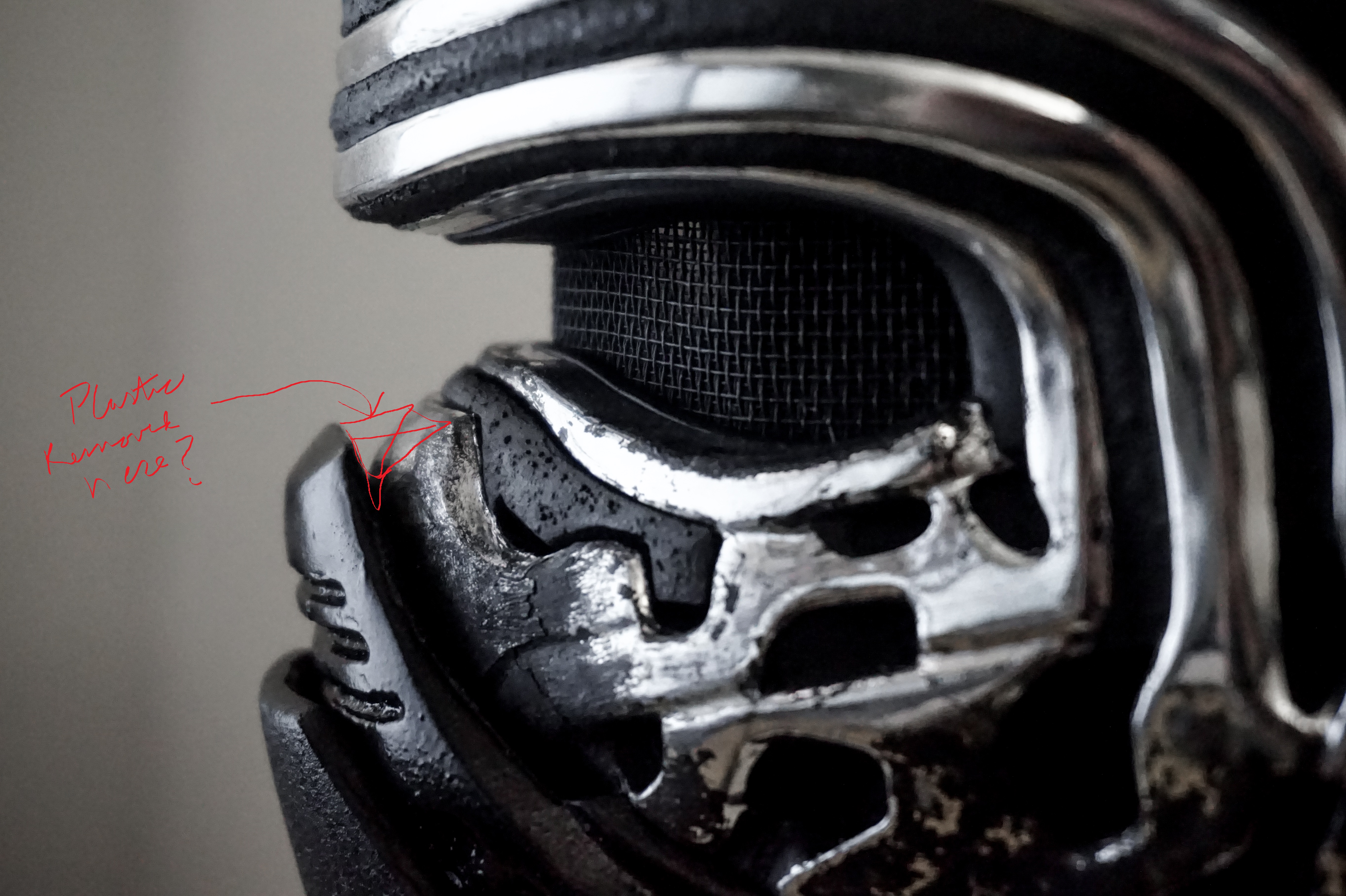

James, nice work here! I'm new to the forum and have a few questions for you after reading through your posts several times. I copied some of your pics and drew on them to help illustrate what I'm asking.
Did you remove some of the plastic in the area above?
Is the red line where you cut off the front piece? Are the areas pointed out in green all added plastic? And did you modify the lower jaw area outlined in green? It looks different from what I see on mine if I cut on the red line.
Last question, after seeing the movie are you planning any other modifications to make it more accurate, or do you feel this is pretty close? I've only seen it once so far but plann on seeing again this weekend.
Thanks!
Thanks man, I appreciate it. I think the whole welding the shells together and modding this helm is going around which is great, it's nice to know I've helped some people out as I'm usually the one scrolling through threads just soaking up information.
1. Yeah removed that part and rebuilt the chrome nose part. Also made the 2nd layer taller to match the anovos and some ref. pics from the movies.
2. Yes I cut on that red line and re built it and added plastic. The layering wouldn't work unless you do that.
3. It's close but could be done closer. I might cut off the front entirely and attach it to the chromed parts, but I would also cut off the back of the 2nd layer and reshape it to make even more accurate. So yes, there might be a Ver 3.0 to this. Maybe i'll get to it after I finish some of the commission work I have coming in for these helmets.
In the second pic I posted, did you modify the lower jaw area? It just looks different and I want to be sure what I'm doing before I start messing around, ya know?
