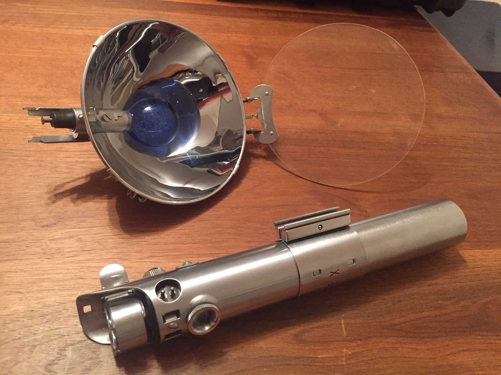

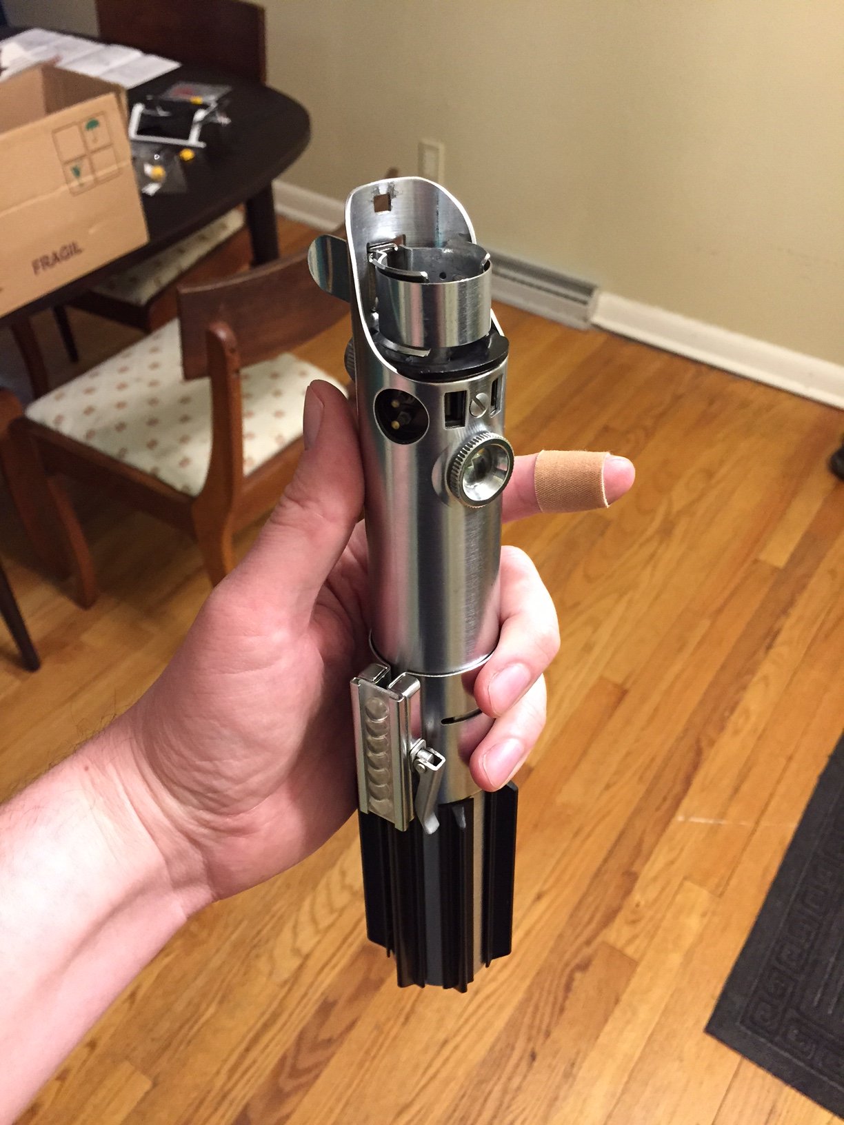

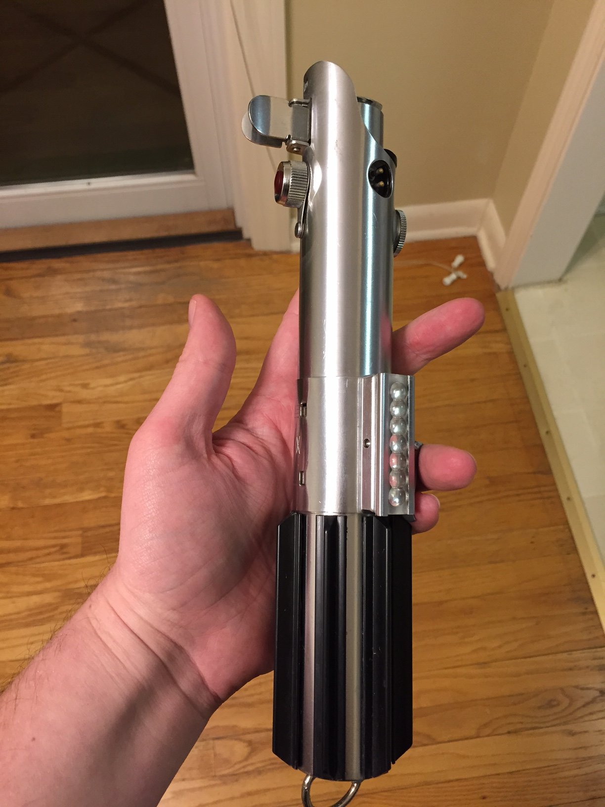

Here is my Luke ANH fresh out of the box, I instantly fell in love.

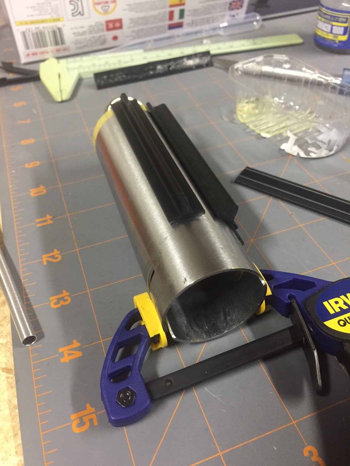

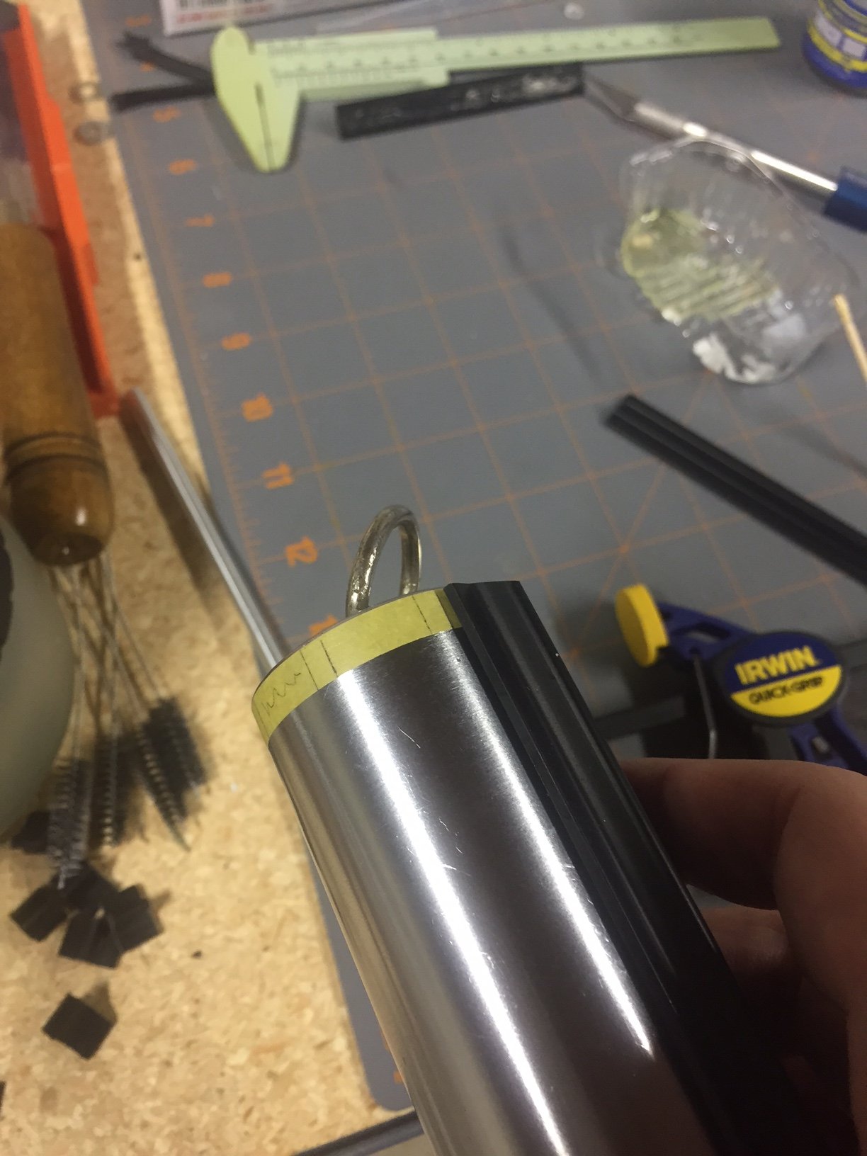

But after a while I realized that the grips were not accurate, and I had a want to replace the fake bubble strip with a real one. So I took the bottom off the saber and threw it in the freezer, metal shrinks at a different rate than the epoxy and plastic so most of the grips popped right off after a couple hours.
I cleaned off the remaining epoxy by carefully scraping with an Exacto blade, and I used very fine steel wool rubbing only in the direction of the brushed metal lightly. It cleaned up well.
I ordered new grips from Roy, cut them to length, cut the correct angles, sanded and polished them smooth, and finally epoxied them on. It seems like a subtle thing, but it really makes a difference, in the look and how it feels in hand. My old t-track was narrower at the base and taller, and the angles were not correct.
And here is the finished product. (I know it's hard to tell in these pics).

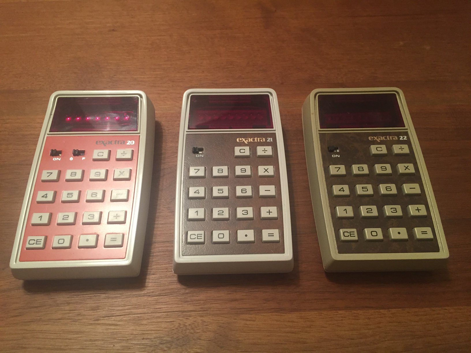

I'm still to chicken to cut up my Exactra 20 for the bubble strip, I'll do it some day.

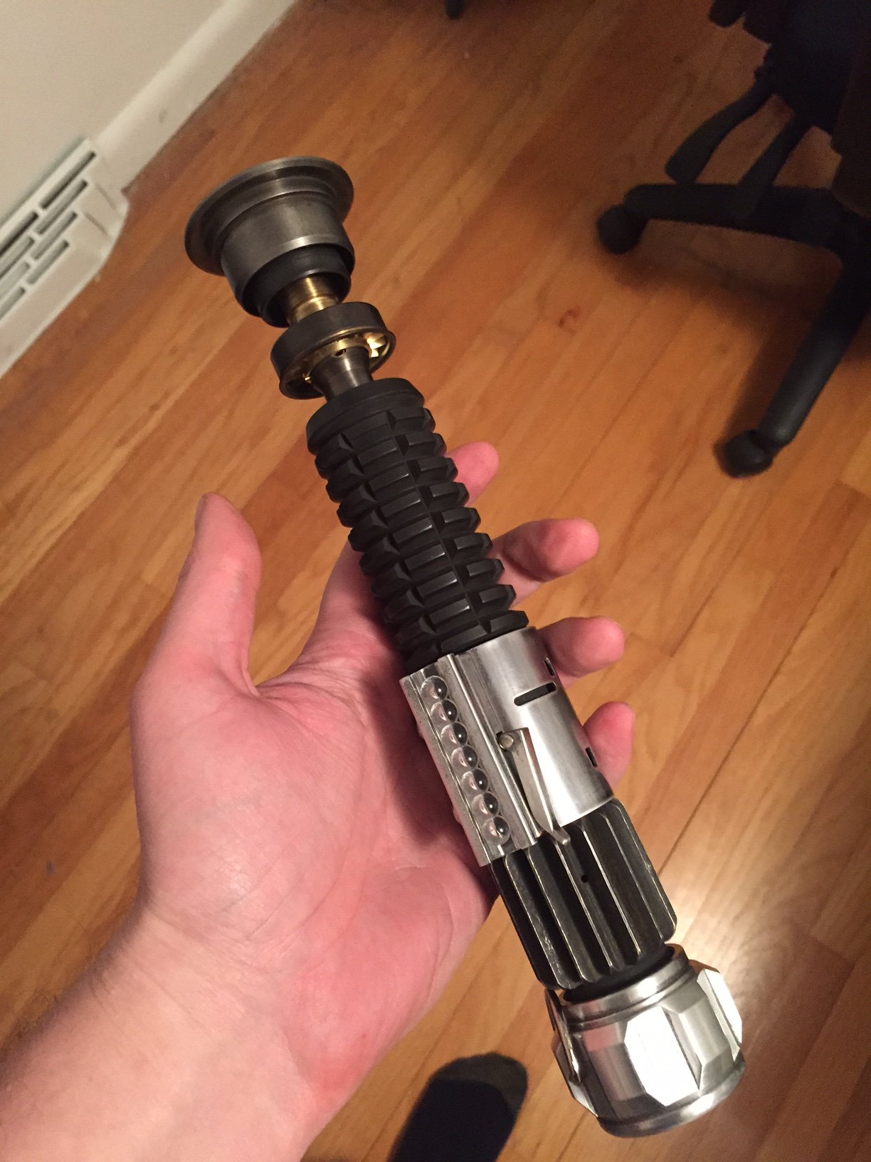

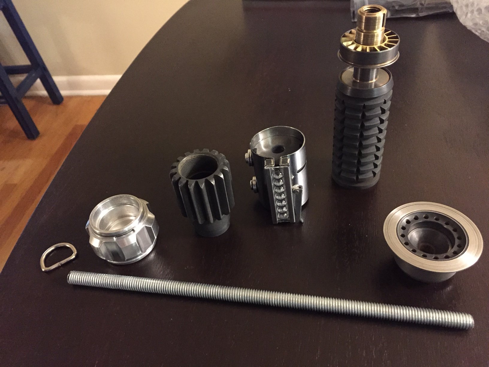

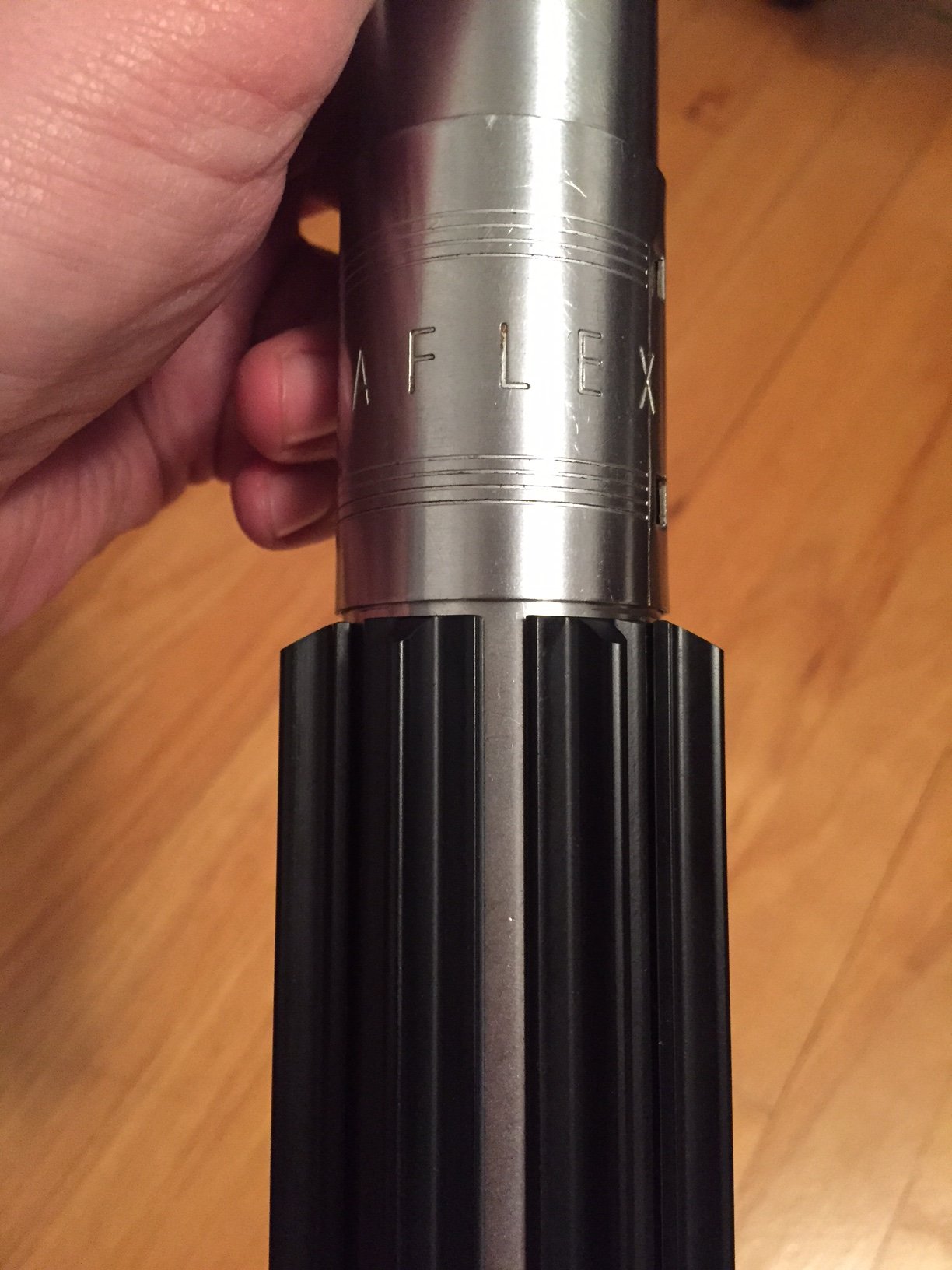

Next up is my Obi Wan saber. I ordered it from Roman to help along the Graflex replica project. I had to wait a while for the parts to come in but no biggie. I'd seen several people post theirs in various thread and I'd seen a couple real parts OB1 sabers that made me jealous. I really does seem like the most random collection of parts, what are the chances that someone would have all that on hand. I know that Roman was working hard to get these parts out to us as fast a possible because when the box came and I opened it, I could smell that he had been eating pizza while packing parts. Thanks for making me hungry Roman :lol.
I had my Vader shroud arrive the same day as my OB1 parts, you could say I was having a good day. It took less than a minute to put the OB1 saber together minus the D ring.

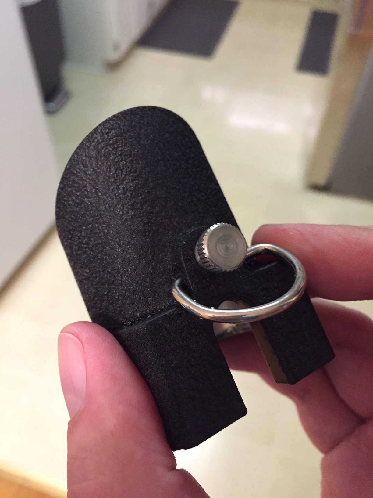

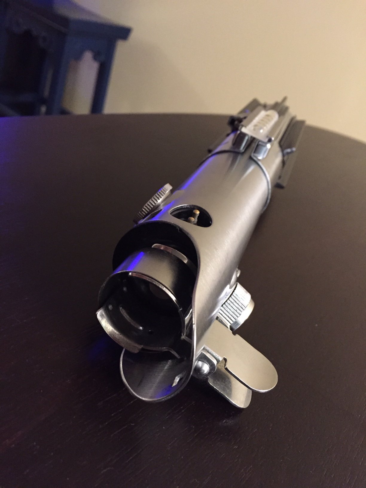

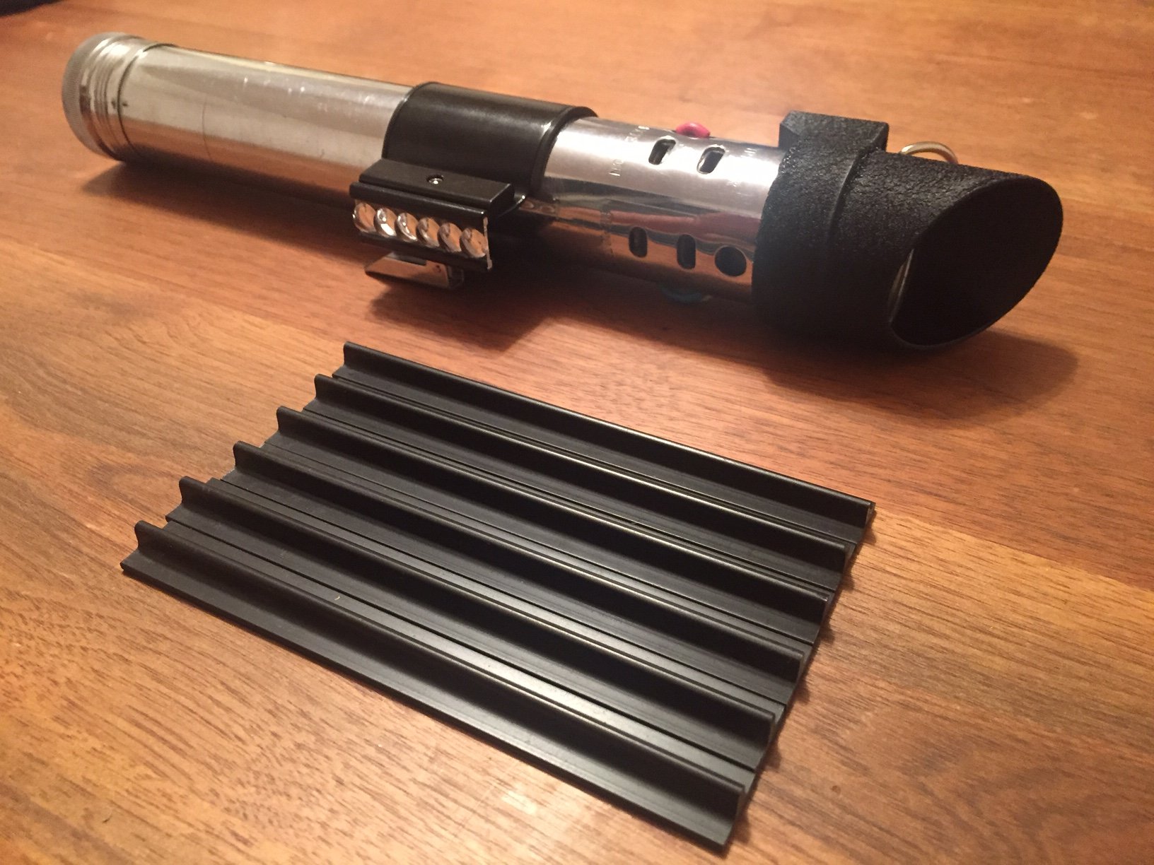

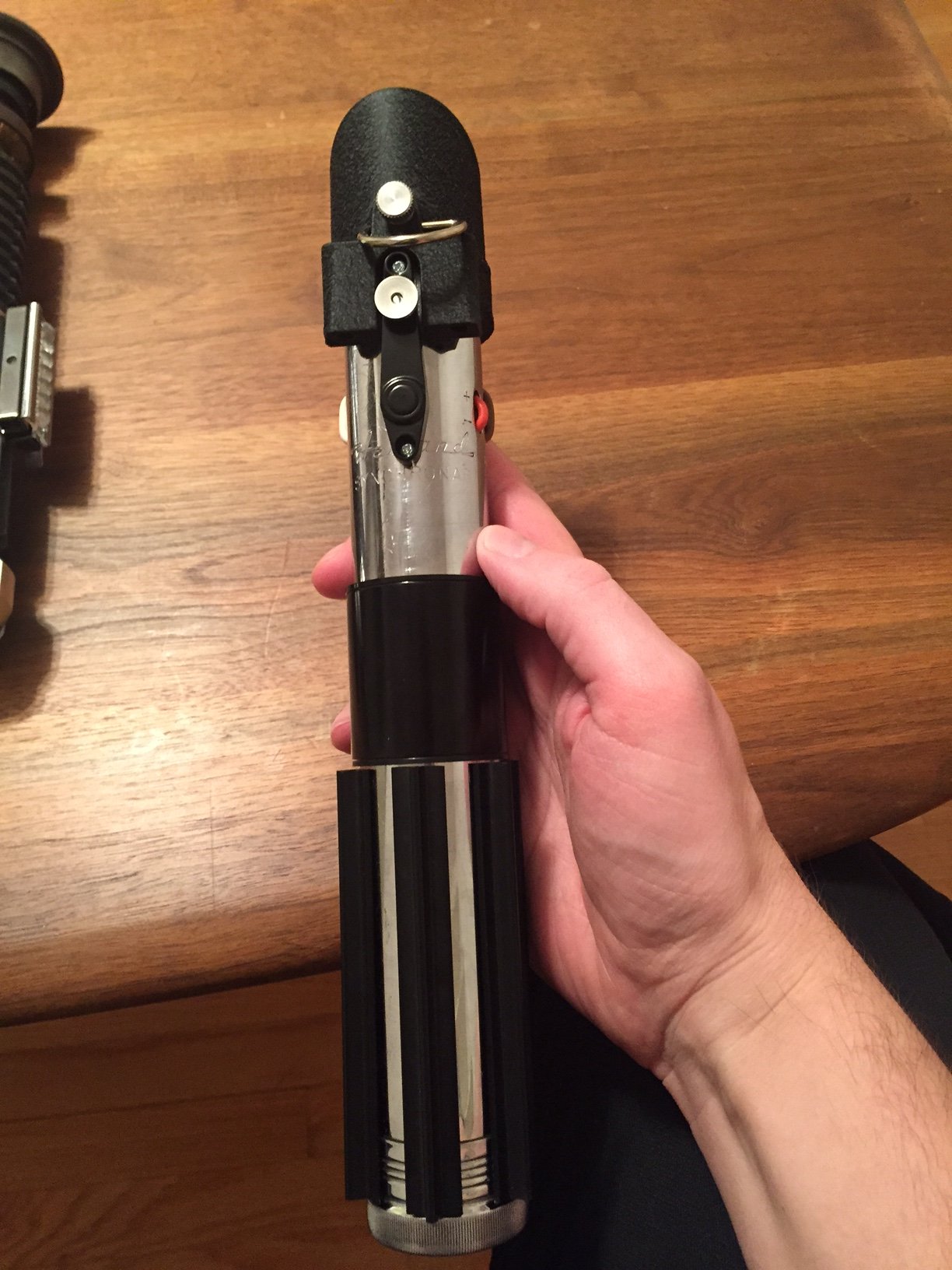

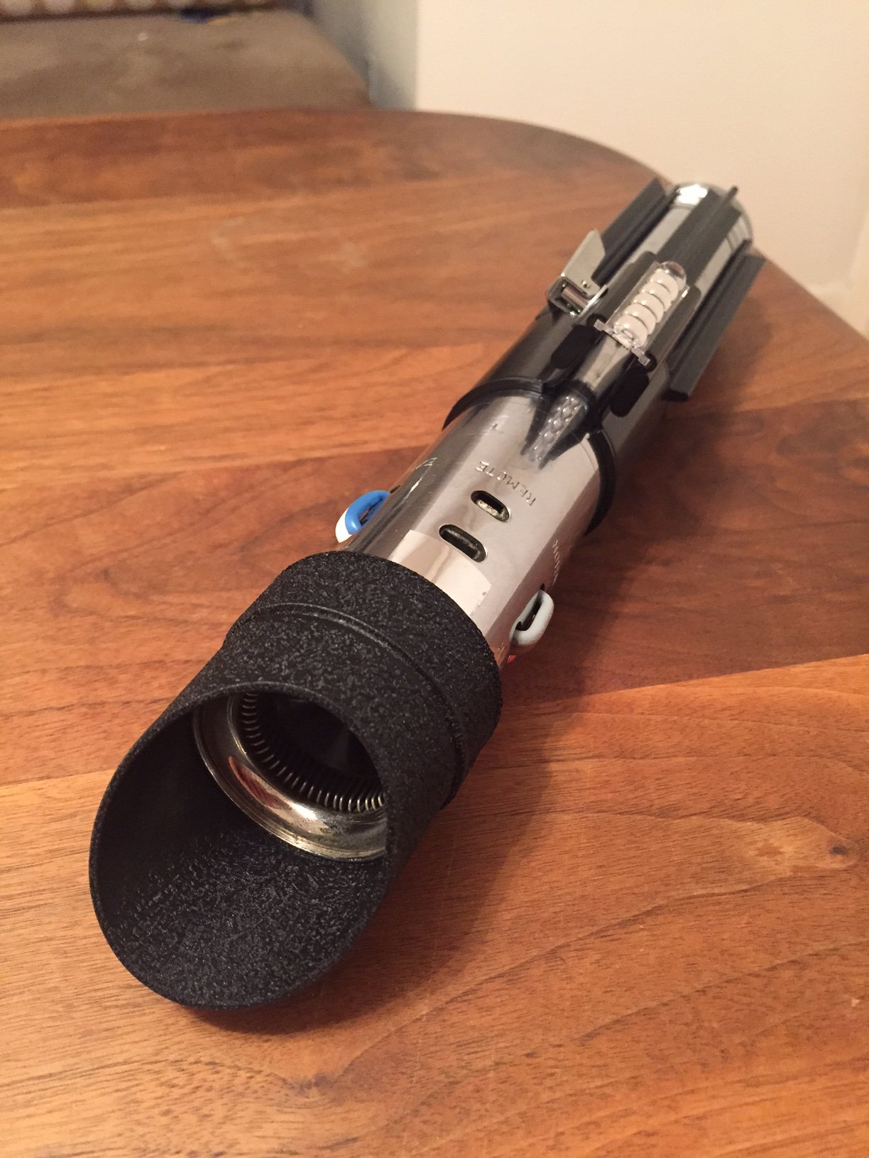

I really lucked out with the Vader saber. I caught wind of Roy taking measurements of a real MPP on a thread, so I started looking out for what to look for in a Heiland and what parts were already available. There are three areas on the Heiland that you need to pay attention to: the guts (bulb seat), the hole shapes (on the sides should be rounded), and the end cap (there are several different kinds). I managed to find a Heiland with the right guts, holes and the end cap that I preferred in an antique shop for $13 usd, pretty good if you ask me. It was less than a week later that Roy announced the shroud and bulb release would be available soon. I was actually pretty concerned with the condition of my Heiland because it was so scratched up, but it turns out that after you add the clamp and glue on the t-track, most of the metal is covered, so it became a non-issue. I ordered the shroud, bulb release, wire set from Roy, and ordered the clamp from TCSS.
EDIT: I forgot to mention that I over tightened the bottom screw for my bulb release and it cracked. You can make out the crack in the bottom just barely. I'm still kicking myself for that one.

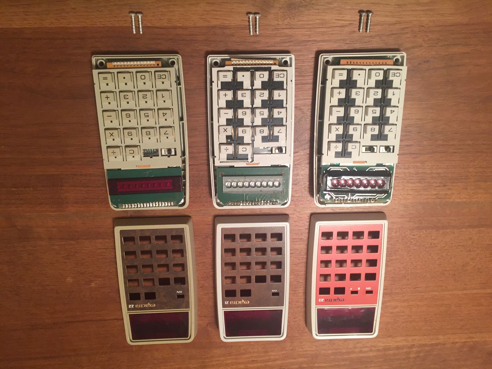

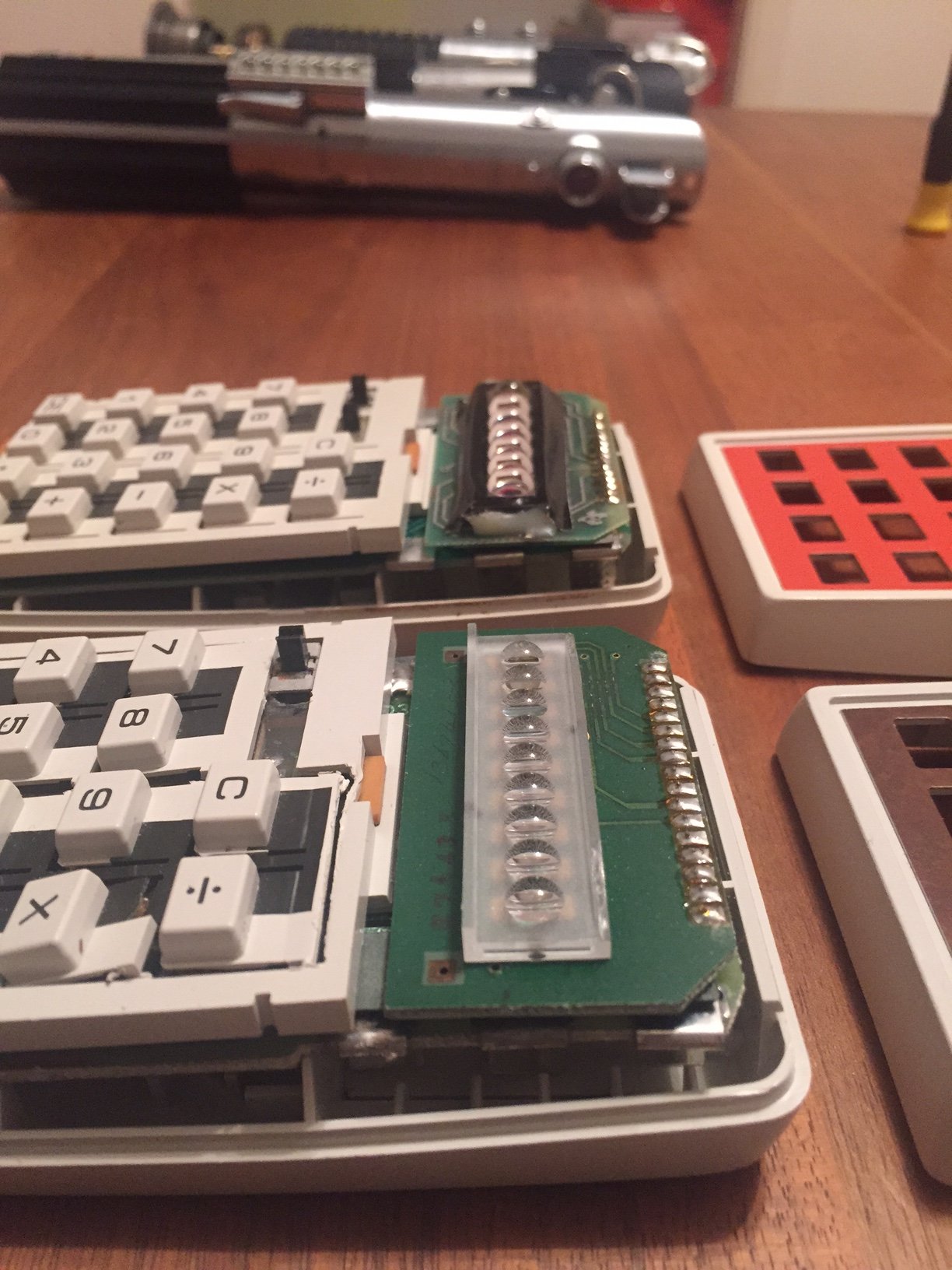

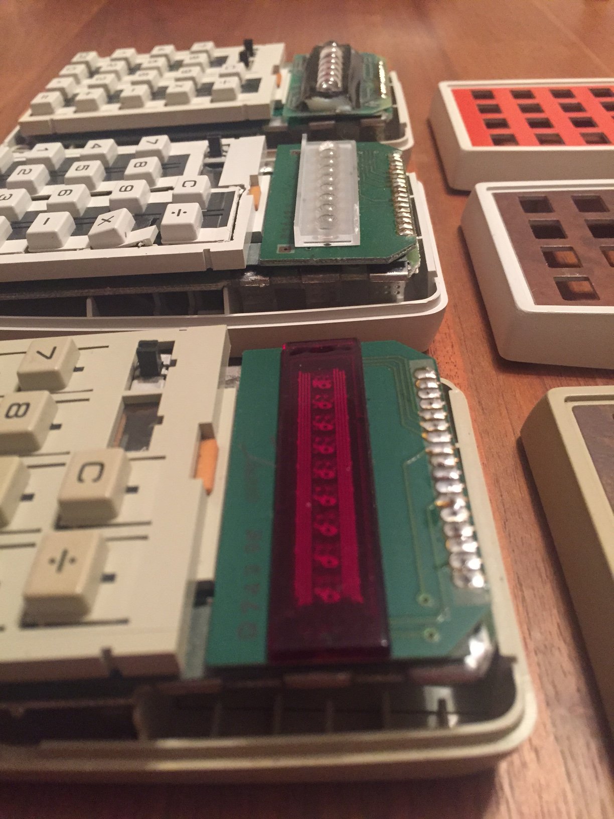

I thought I would be clever and order another exactra but, instead of getting the 19 or 20, I would get a 22 or 21. My logic was that I had heard that the number of characters was more on these calculators which is why they can't be used for Luke or OB1 lightsabers. But this was Vader's and the MPP clamp is shorter there for the bubble strip has to be cut down to six bubbles. Turns out that is a dumb idea. The exactra 22 doesn't have bubbles at all, and the exactra 21 has bubbles BUT they are smaller. So don't make the same mistake that I did.

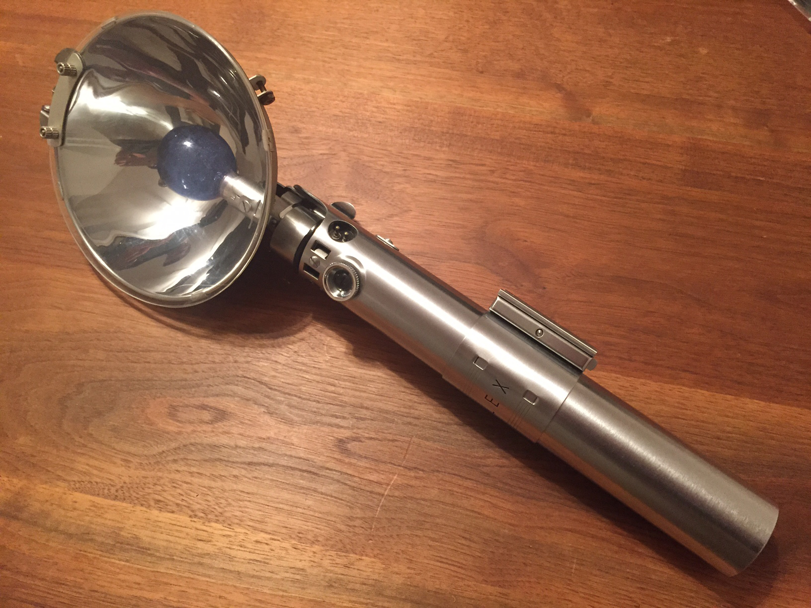

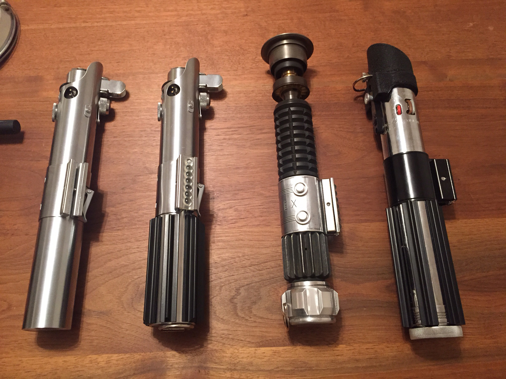

Here is my current lightsaber collection all together plus my unused Graflex. I'm still working out how I'm going to display them, that will be a fun project in itself.

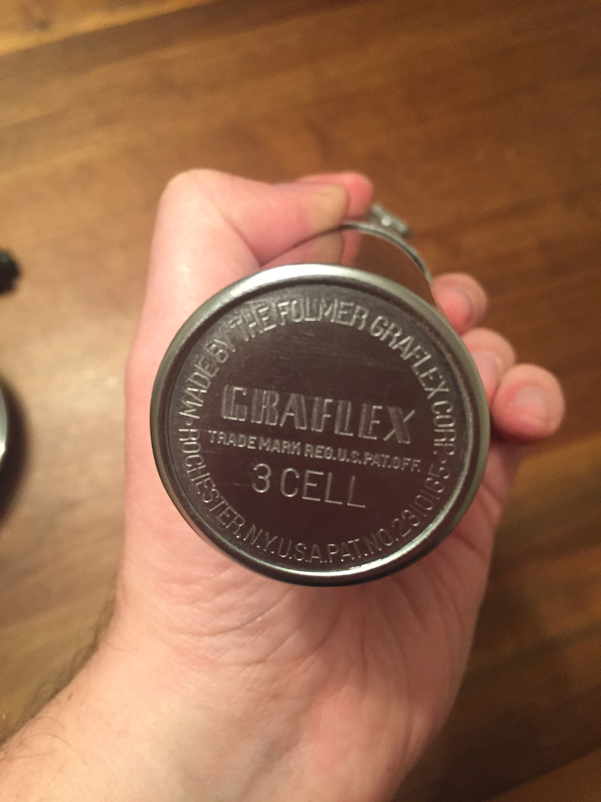

More glamour shots of my spare Graflex. I picked up this as a 2 cell in nearly mint condition and later bought the 3 cell bottom in pristine condition. I'm still going back and forth on what I'm going to do with it. I may use it for an ESB Luke saber even though the bottom is not the right stamp. But I am getting a replica Graflex from Roman sooo maybe not. Thought about using it for a TFA saber, but with everything that keeps turning up about the possible use of a veneer on the clamp and other small differences, I'm just going to wait and let it look pretty on my shelf for now.

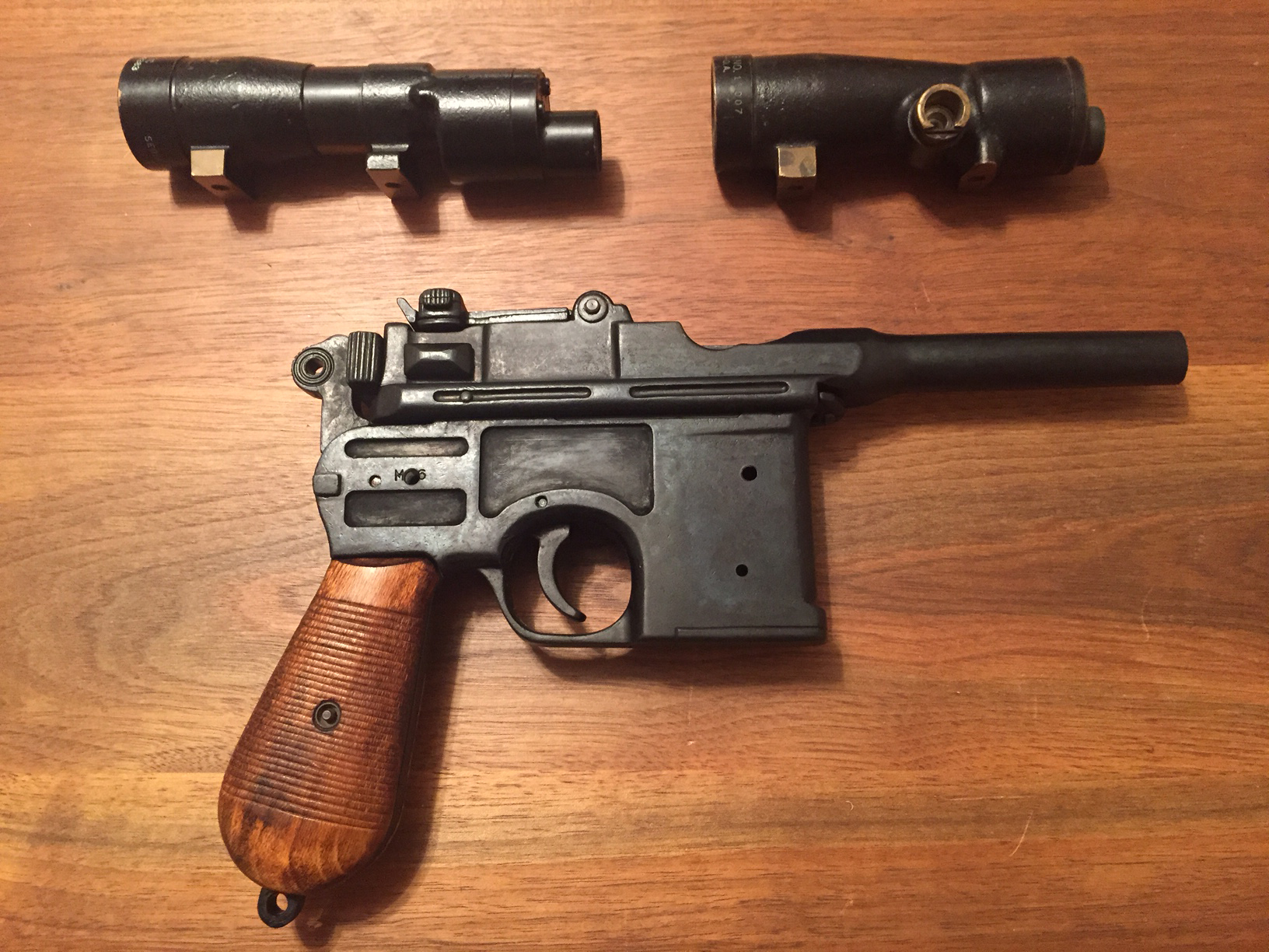

I have some parts for some blasters on hand, and a lot more that have been ordered and paid for on runs. I just missed out on Boba Debt's run of ROTJ DL-44s but I went a head and bought the machined Denix mauser drilled for the ROTJ parts thinking that I'll come across the parts eventually. The parts are surprisingly difficult to come by, but that's ok because I've had plenty of other stuff to spend money on. I've also picked up a M77c scope on the bay for cheeeep, while it's not used in the movies it looks like it could be and it looks great. It's identical to a M38a2, which isn't used either, but I figure it would be a good alternative if I get around to making an E-11, or my own custom blaster. One very late night on ebay I got a wild hair and bought myself a real M19 just cuz, but it's going on one of my ESB DL-44s (Luke or Han Hoth). There is something really special about real parts, they have a presence that most replicas don't.

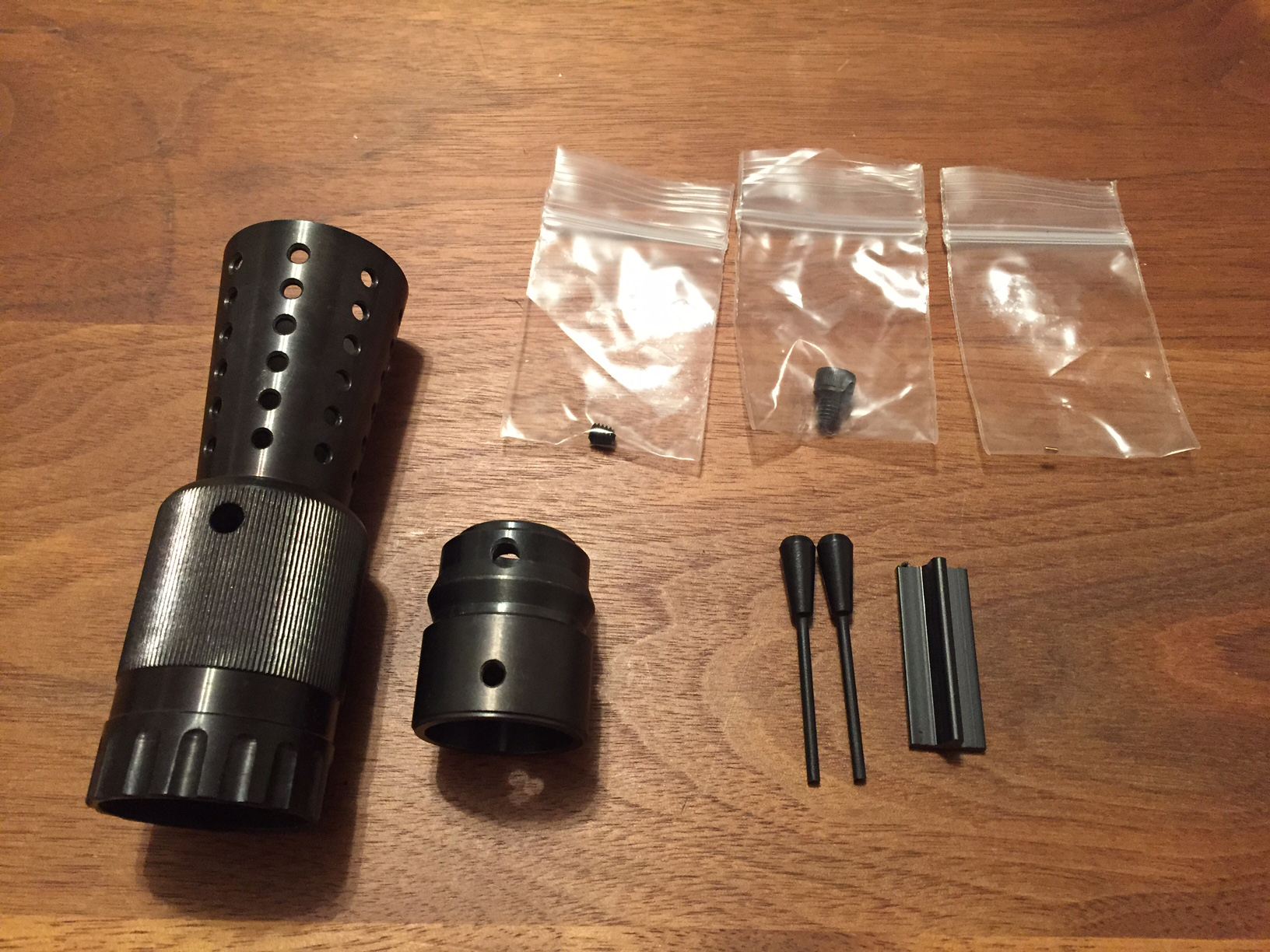

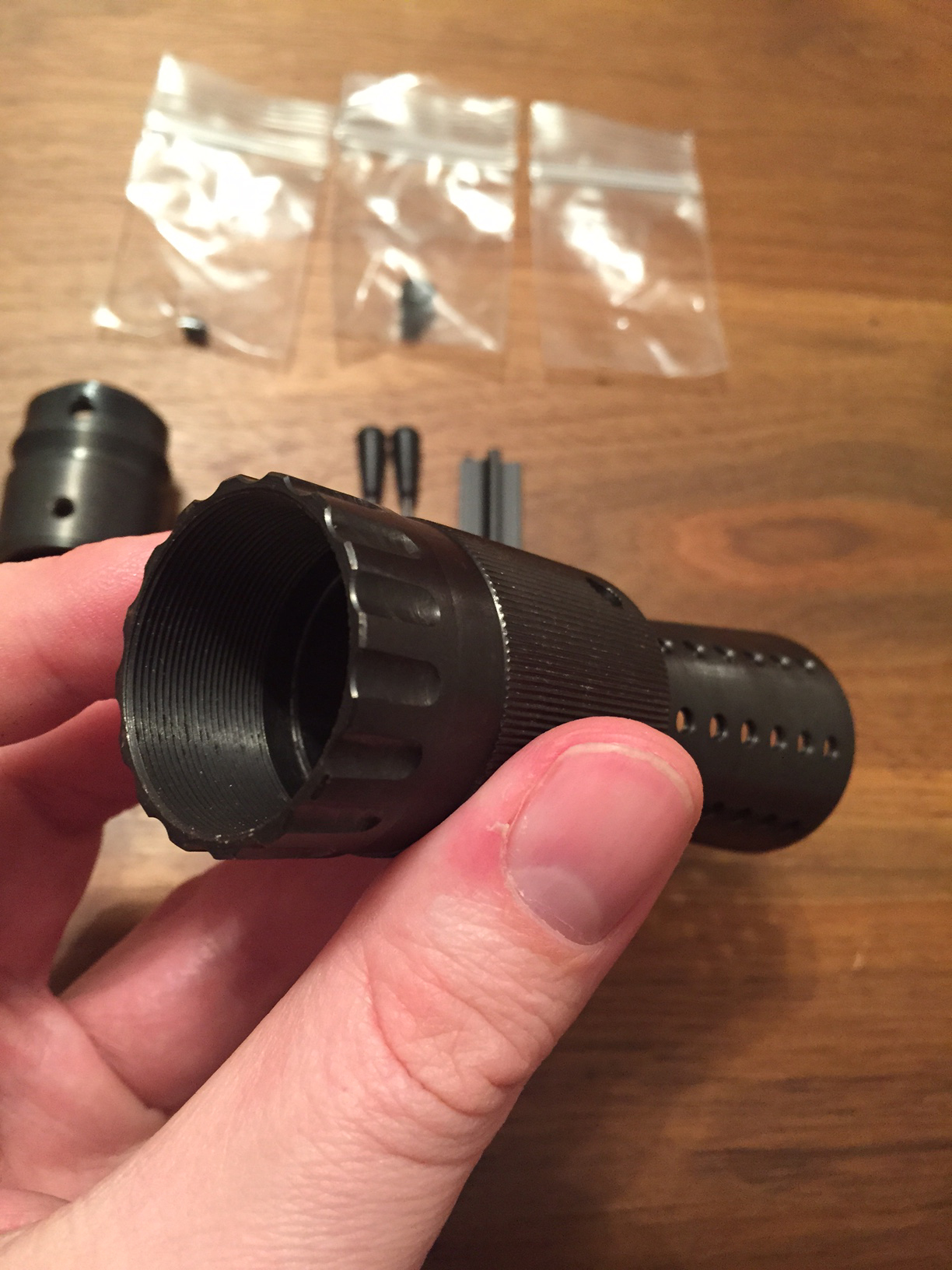

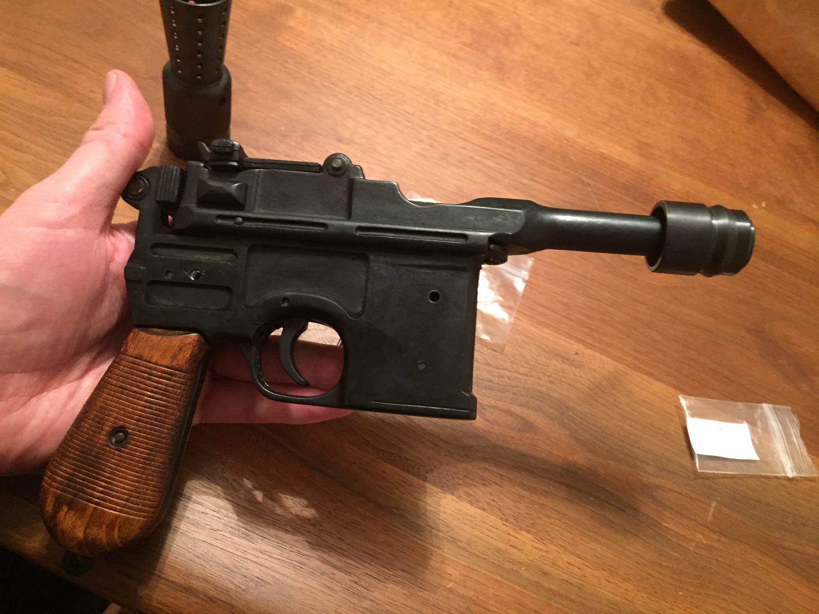

New parts came in today!!!!

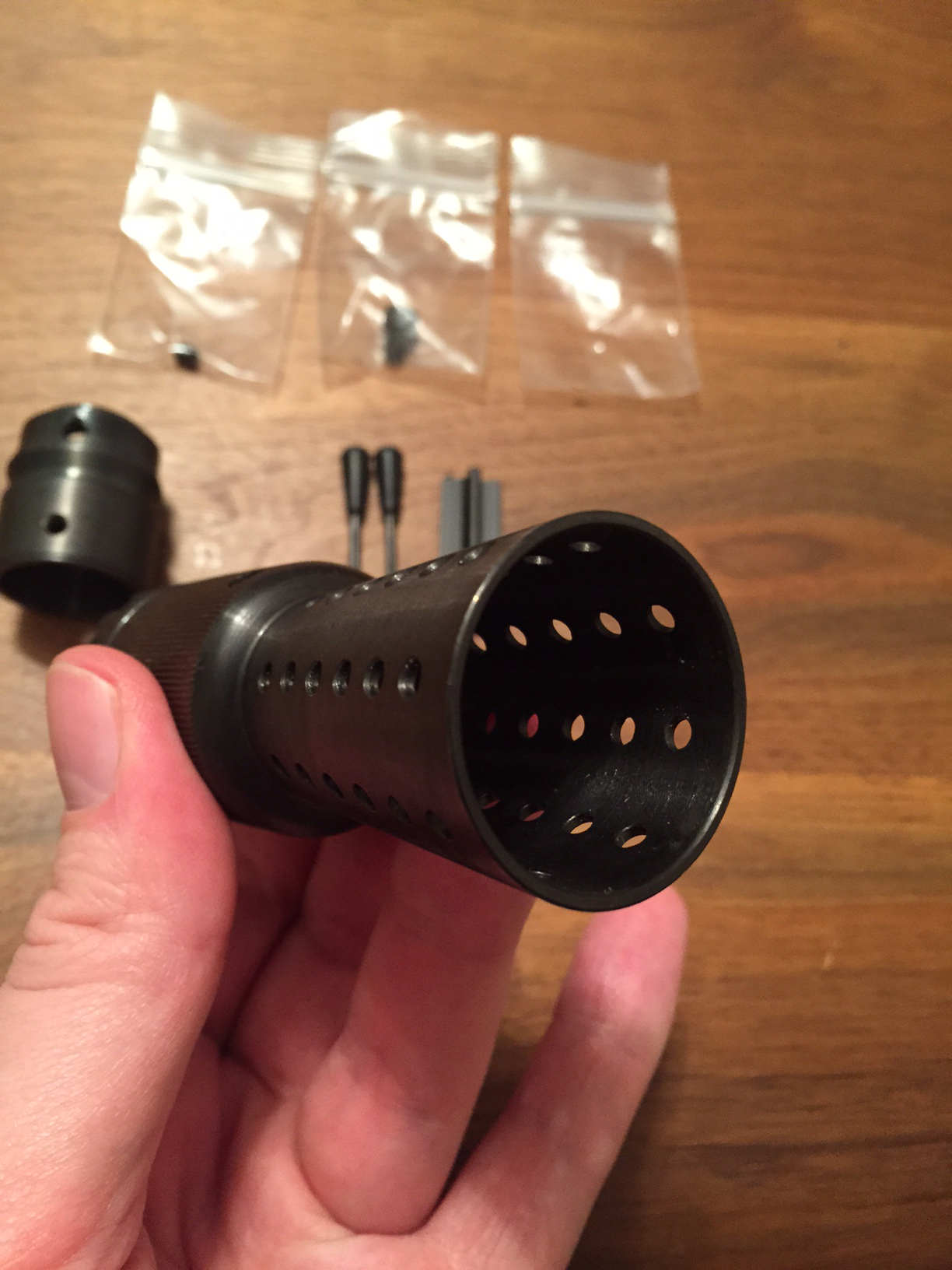

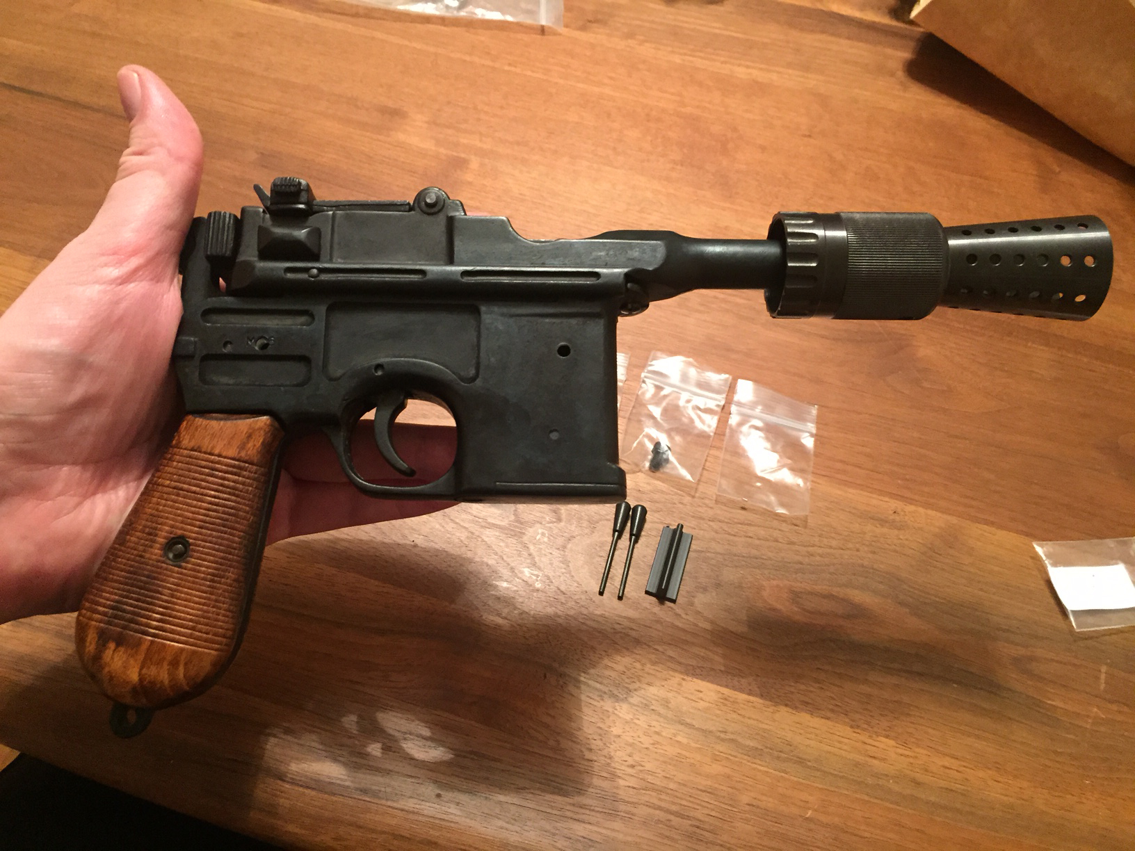

Today's delivery brought a flash hider and adapter, and the sight greeblies for an ANH DL-44. The flash hider and adapter seem to be very good quality, the adapter fit snugly on my ROTJ machined Denix and the hider snugly over that. The greeblies look good to my eye, and the T-track looks like a similar profile to Roy's a little narrower, and the curved bottom channel is shallower (see pics below).
I received three little bags, two with screws and the third (furthest to the right in the top pic), a very tiny metal dowel.... that I have no idea what it's for.

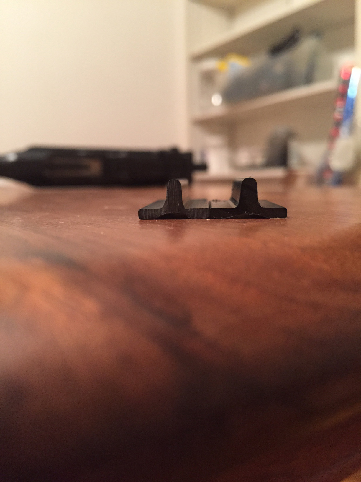

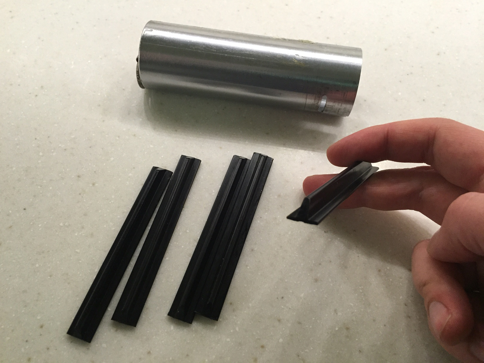

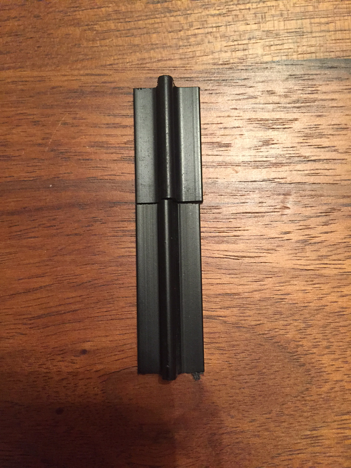

And here is the comparison of the T-track to Roy's.
Roy's is on the right side in this pic.
Roy's on the top.
http://newmagrathea.com/forumimg/parts/IMG_2972.JPG
Roy's on the top.
http://newmagrathea.com/forumimg/parts/IMG_2973.JPG
Where did you get the flash hider from? I've been looking into picking up some parts for multiple DL 44 builds as well
Re: My on going lightsabers and blasters thread
todds costumes or DEC?
looking good!
Todd's Costumes
Todd's Costumes. So far they are only doing parts for the ANH DL-44 and they don't even have all of the parts available yet.

I think Todd really nailed the t track. If you really study pics of the original profiles it looks like he really nailed it.
I had no idea that Todd's was doing t-track now. It might be a little narrow, but still not bad for the price.
I like Roy's T-track better myself. While Todd's is nice, it has some inconsistencies. If you look at the profile Roy's is smooth and consistent, Todd's on the left side of the rib where it connects to the base is too sharp and doesn't match the right side. Also the right side is not a smooth curve, it has a couple small angles. But, in the end it's such a small difference that it's super hard to tell unless you really look at it and have something to compare to. We don't have or know what the real material is, we just have some pics to compare to so it's hard to say who's more accurate.
Oh yeah, I think Roy's is better overall too. For the price though, Todd's is worth consideration for a budget build.
I'm not sure what the deal is with the asymmetrical profile; Todd's claims their track is "Slightly asymmetrical like the original stuff" but I've never noticed that on any of the original props...
There's photo evidence to support his decision to do it that way actually. I never saw it until he pointed it out
That's very interesting. I've looked through my reference photos and I can see one pic that does look like the profile sorta, but there are others that don't appear to have that profile. Old photos are unfortunately not that clear. It could be another clue as to what the t-track really is. Maybe it's something that was used and the irregular shape is worn from use, or the shape is deliberate for what it's used for.

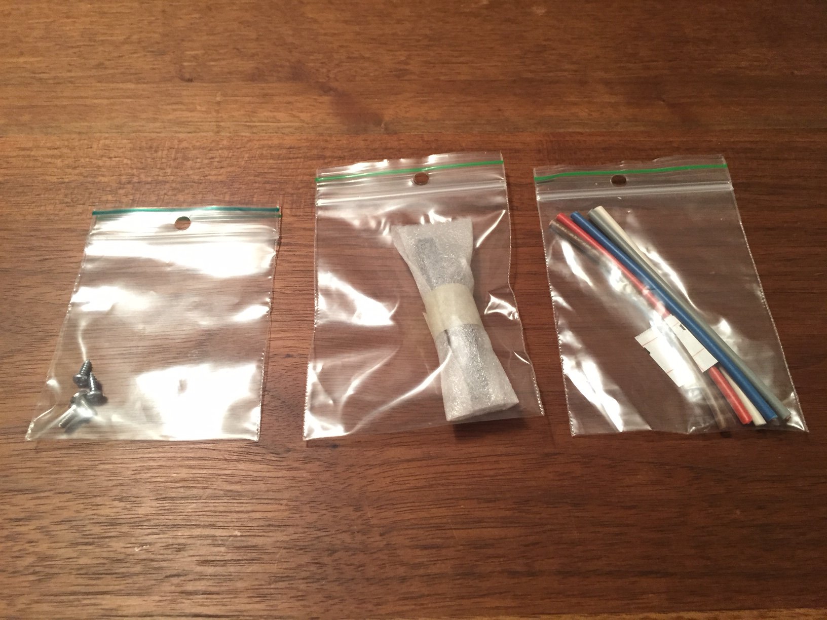

So I've gotten a few packages, anyone what to take a guess at what I'm going to make with all this? I am still missing one kit for this project and it looks like it won't arrive until January.... stupid holidays. Your one clue is: this is not for a blaster or lightsaber. GO!
